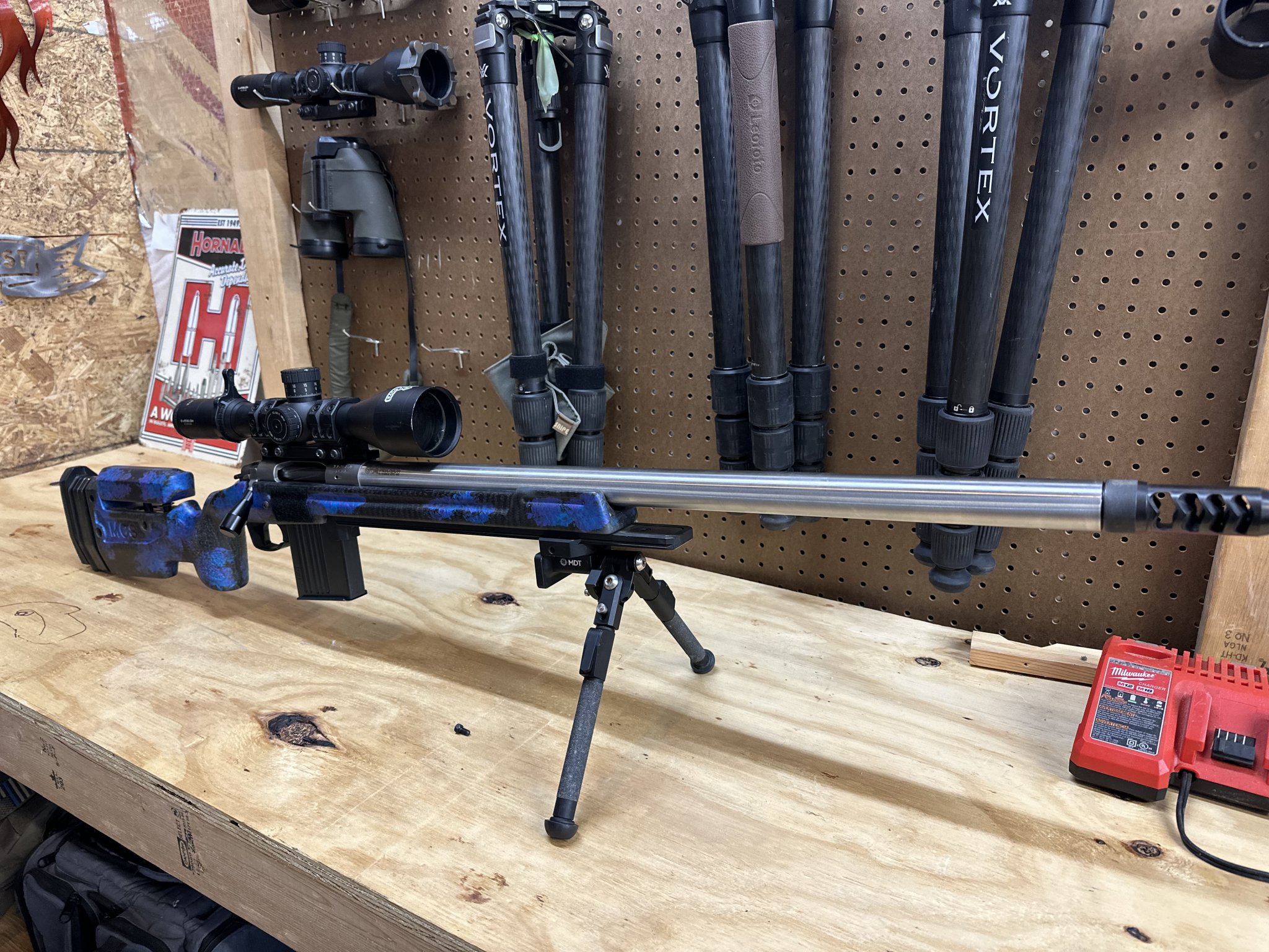

6mm BR
The new 6bra is ready for season.
- impact 737r
- ks arms 1:7.5 twist 26”
- spearhead 5 port tuner brake
- tt diamond flat
- Vision Pro chassis
- apex rival 4-32x56mm

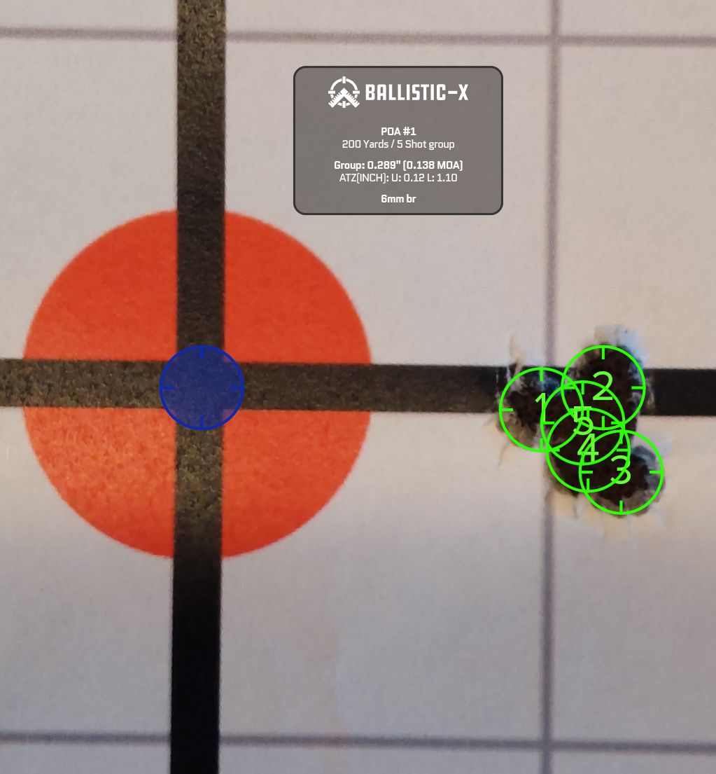

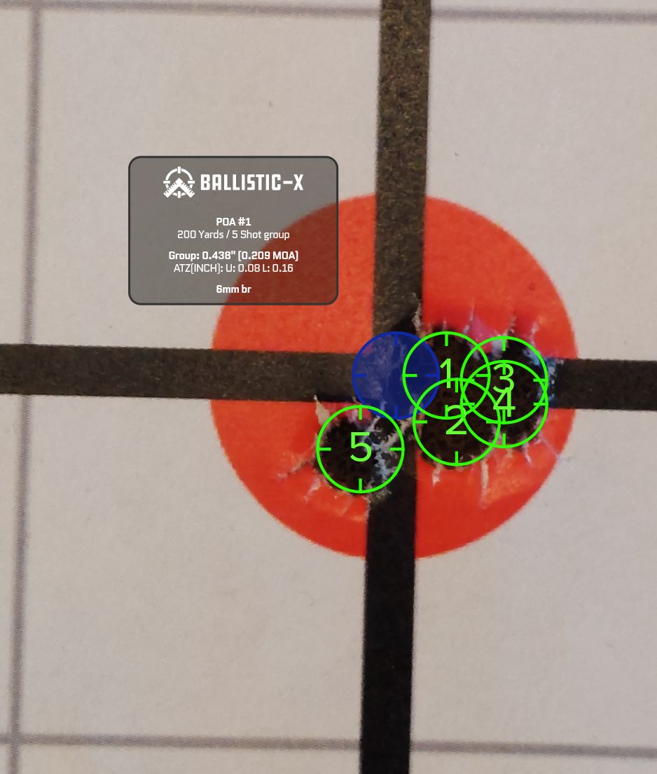

Finally built a 6BR and I'm extremely impressed. Just loaded up 30gr of Varget with a 105 Hybrid and went to the range.

That was my experience too with a 28" Straight Krieger and similar load (30 grains Varget / 0.070" jump with 105 hybrids).
6BR is just easy.

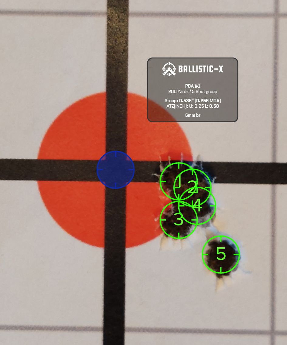

Yep definitely wished I would have done it sooner. Shot it at 300 yards today and was just as impressed. Meant to shoot five but apparently primers are needed lol.

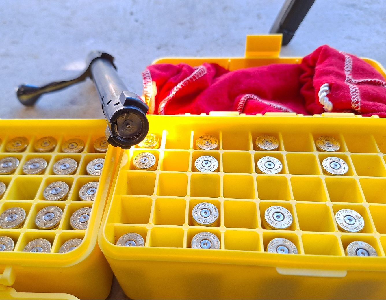

28inch Lothar Walther barrel, 6BR Norma chamber, Norma brass, RUAG primers. Howa short action. Holed a primer at only 27.5gr Varget/2208 with 108ELDM about 20 thou off lands contact (measured with barrel off). Gunsmith had bolt face laser welded drilled smaller and ground and polished firing pin.
Once I got the bolt back:
Initial pressure testing I went up to 30 grains from 28gr in 0.5grain steps which gave 2799fps, single digit SD for 30gr. Case head just off extractor cutout measuring approximately 0.0015 growth.
Out of curiosity I loaded 108ELDM and 110atip (Atip loaded round measured about 25 thou shorter at Ogive with hornady comparator seating without adjusting forster seating die) in 0.5 grain increments up to 32grains, powder was in bottom of case necks, 108 tail Junction was forward of case neck Junction, 110 about level, I'll have to buy a neck reamer to make sure I don't have any donut problems down the road.
Clear but not significant ejector marks towards 32grains, which was about 2940fps, slightly heavier bolt lift, case head growth significantly more, worst may have been 0.004 or 0.0045 from memory.
So I will run with 30 grains varget. That velocity seem reasonably standard and best I can tell I should get reasonable case life with that load. Primers clearly work fine once firing pin was sorted out.
Will get a proper seating depth on the Atips once I have fireformed all the cases.

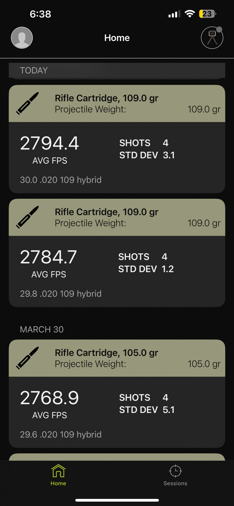

I’m still using Varget in my Br but bought 4 8#’s of N150 for next couple of years because of the increased price of hodgdon powders. My load is 30.2 Varget, Lapua, 450’s, 112MB’s @ 2820 out of a 27.5 barrel. Brass 7x as of today and no issues.

Nice! I really like N150. I’m running a 26” barrel. I played with the 105 hybrids and they shot great but I happened upon these 109’s and wanted to try them. Also im running a 1:7 twist.

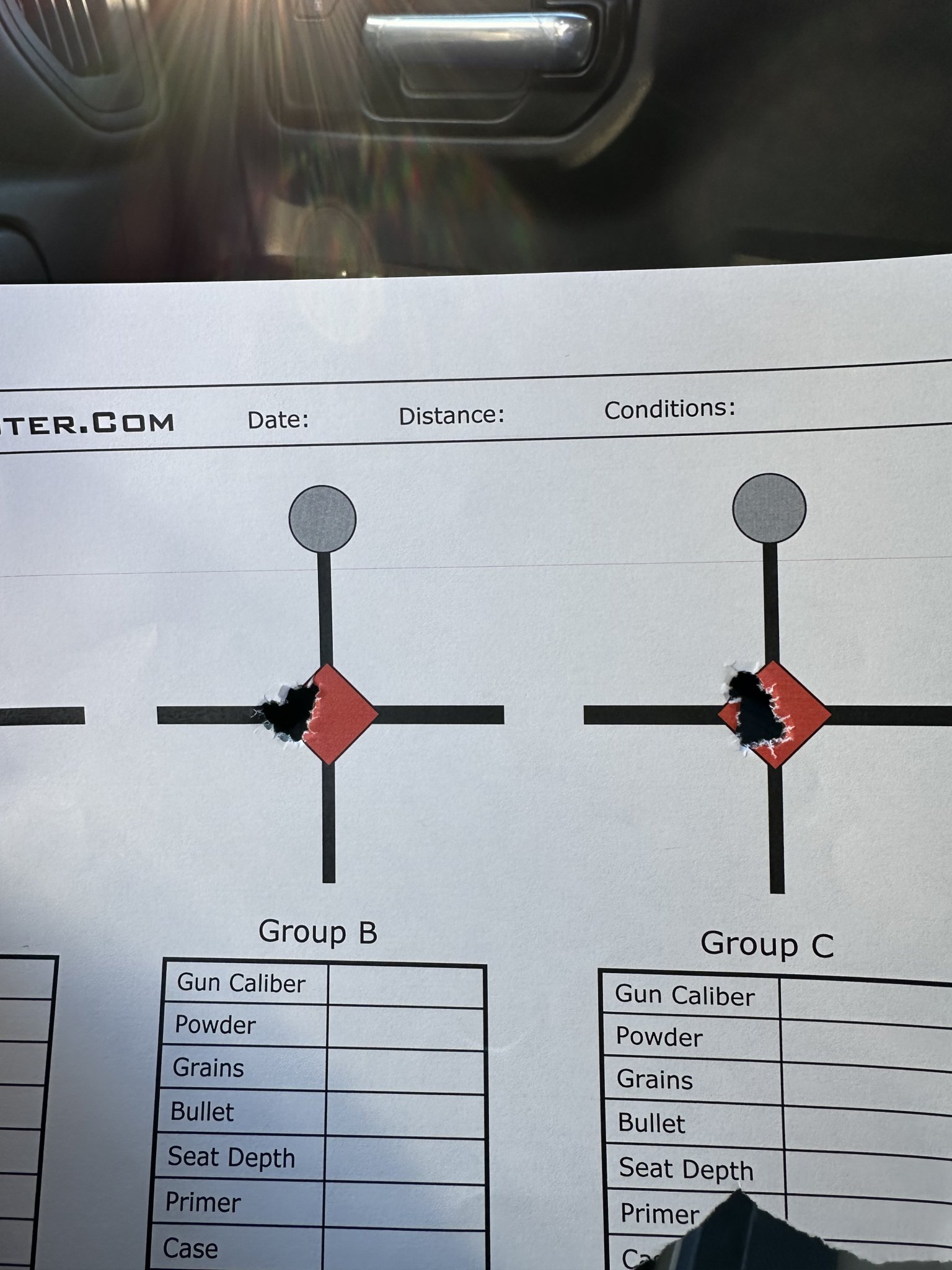

First time loading 6mm BR

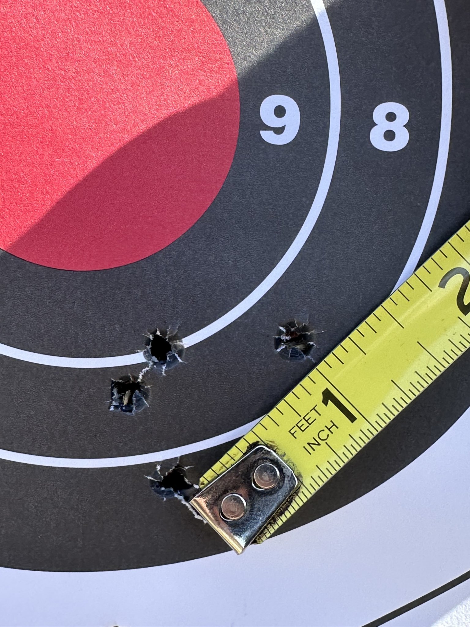

Loaded new Lapua brass, SMK 107, 28 gr Varget, CCI 450. Figured good starting for the first firing. What are you guys using Varget wise?

Congrats on your build, results are impressive.
I have a 6BR and shoot 105 Berger Hybrids with 30.4 grains on Varget. I did a little testing and of the 4 powder charges I tried all 4 shot awesome, in the end I went with the one that was closest to the speed I desired (2850).
I settled on 0.060" jump after reading Mark Gordons article on the testing he did and its been a solid 0.25 MOA gun since.
