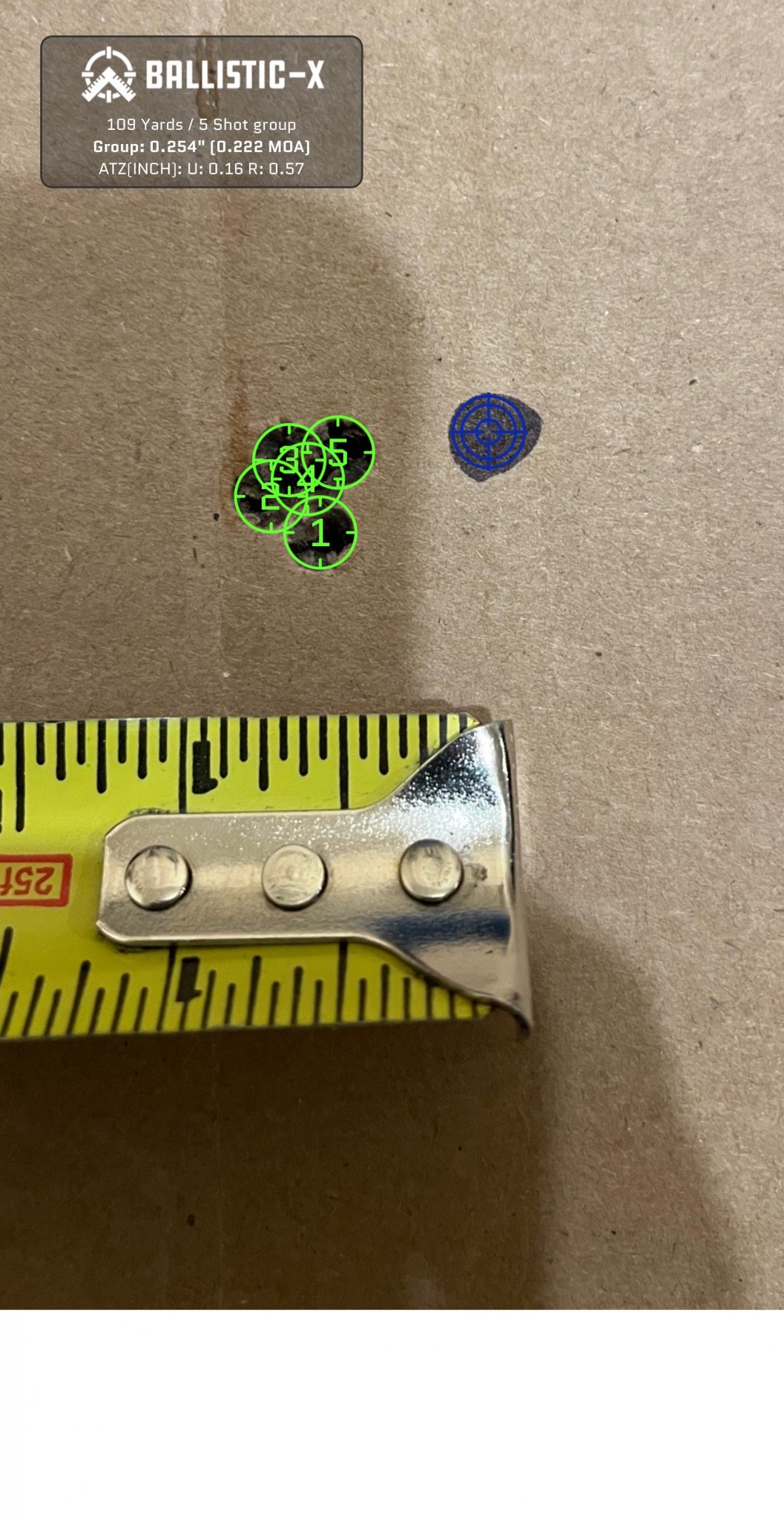

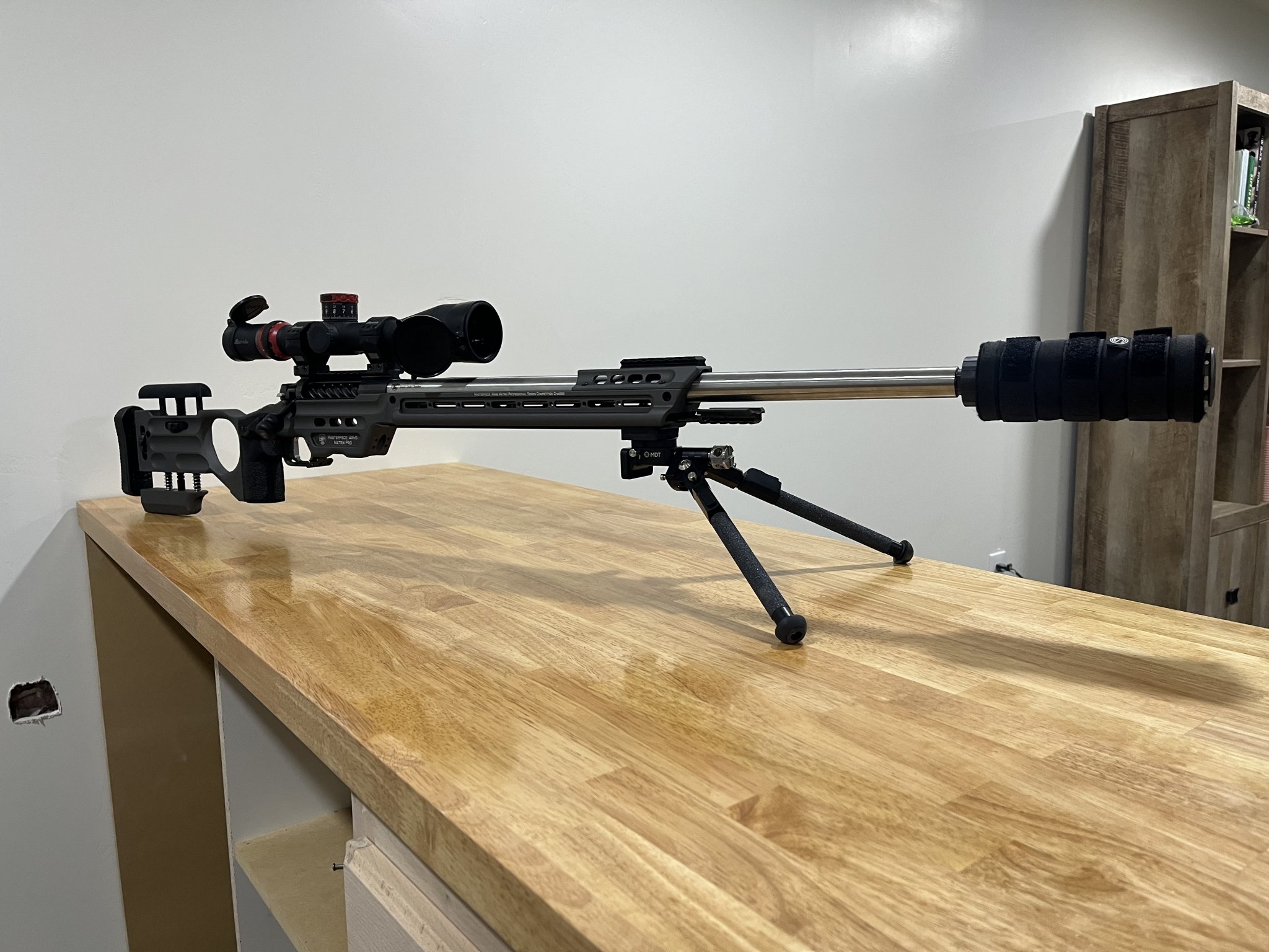

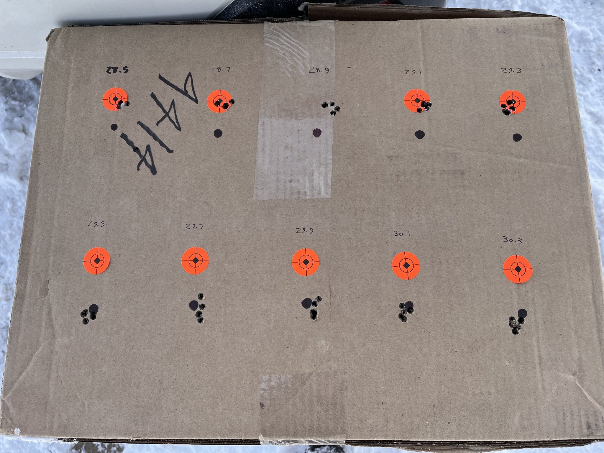

The new MPA PMR Pro II hammers.
6BR
26” Match Contour PVA Barrel, 1:7 twist
ARC CDG SA
MPA Matrix Pro
Bix’n Andy TacSport Pro Trigger set at 1#
Burris XTR Pro w/ Burris XTR Signature Rings
Load (SD: 3.9, ES: 10.5)
30.3 grains N150
0.021 off lands
Berger 105 OTM Hybrids
Lapua Brass
CCI 450 primers
First picture I was just messing with different powder charges (it still shot lights out) and now I’ve got it dialed in with the seating depth as well and shot two sub 1/4” groups to wrap er up. First time reloader and glad I went with the BR.
