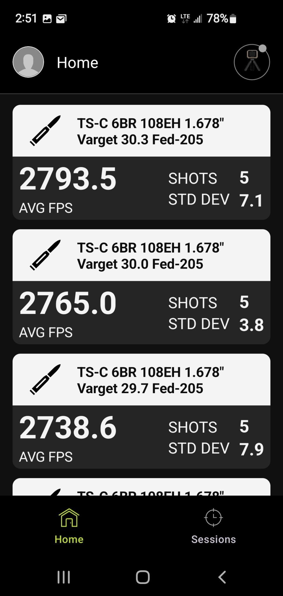

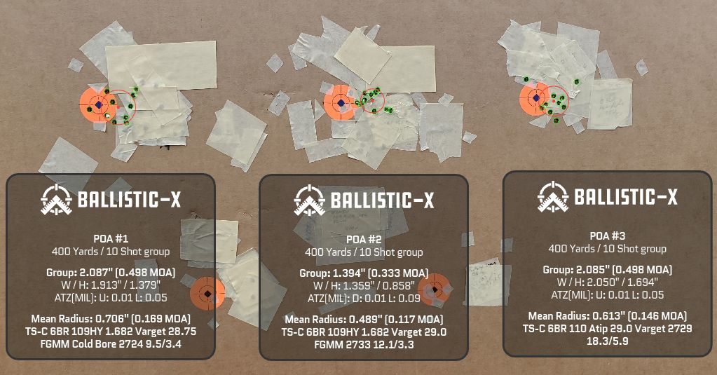

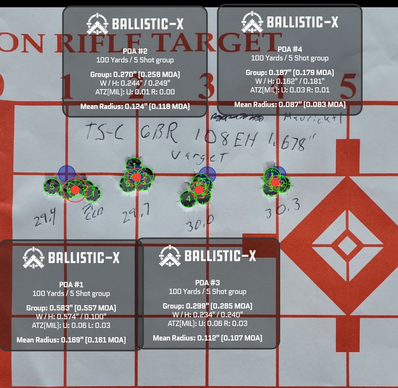

Berger 108EH jumped 55-60 thou and Varget... 30.0 grains look good considering I watched the reticle on shot #4 drop low left just as the shot broke. 28" Benchmark.
109 Berger, Viht N150, jumping 60k, L group is 30.5 going 2860, R group is 30.0 going 2815. Both 10 shot group. UPS man dropped barrel off yesterday, had a bunch of virgin brass to FF, loaded up 105 and 109s with Varget and N150, did some jump tests for break in.

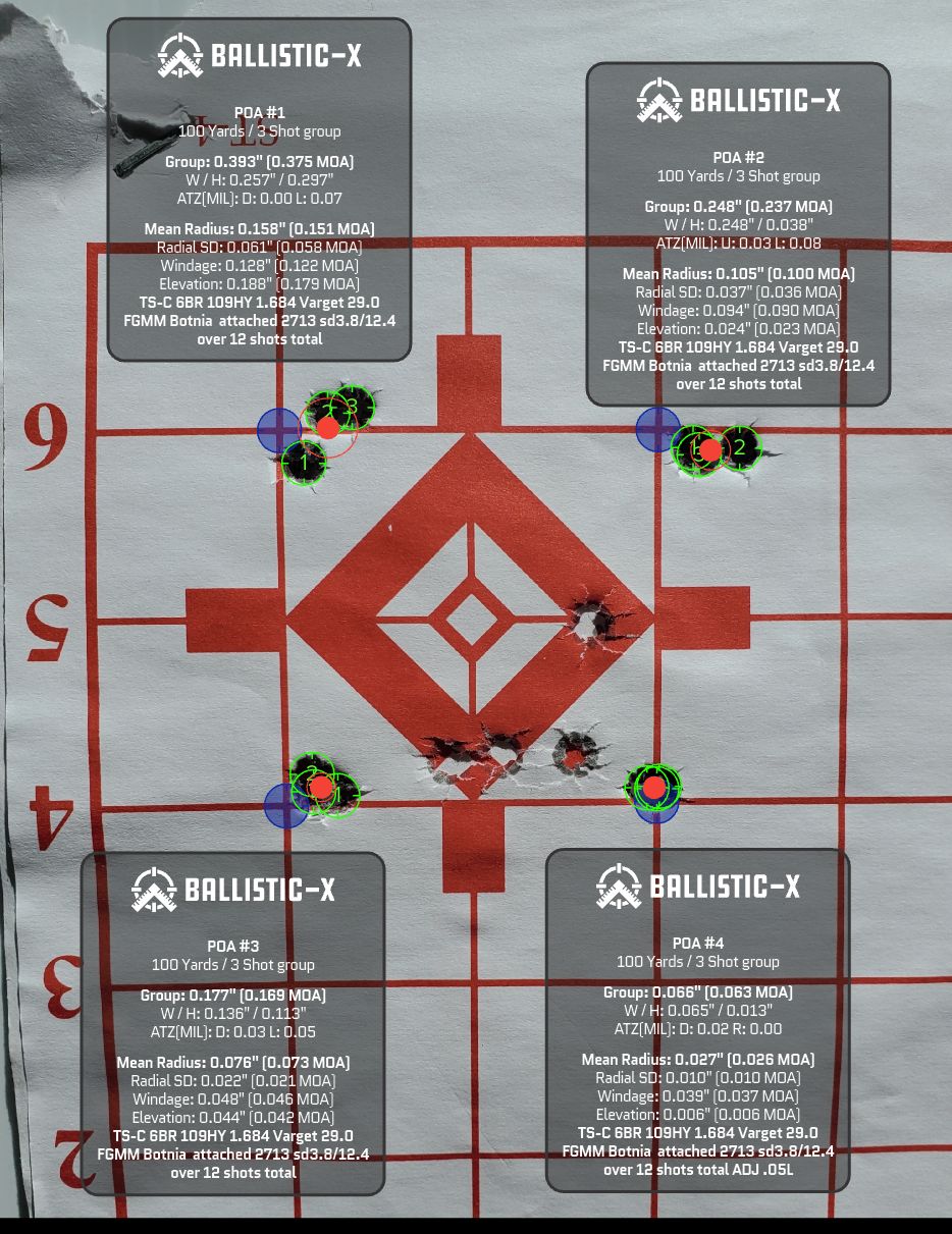

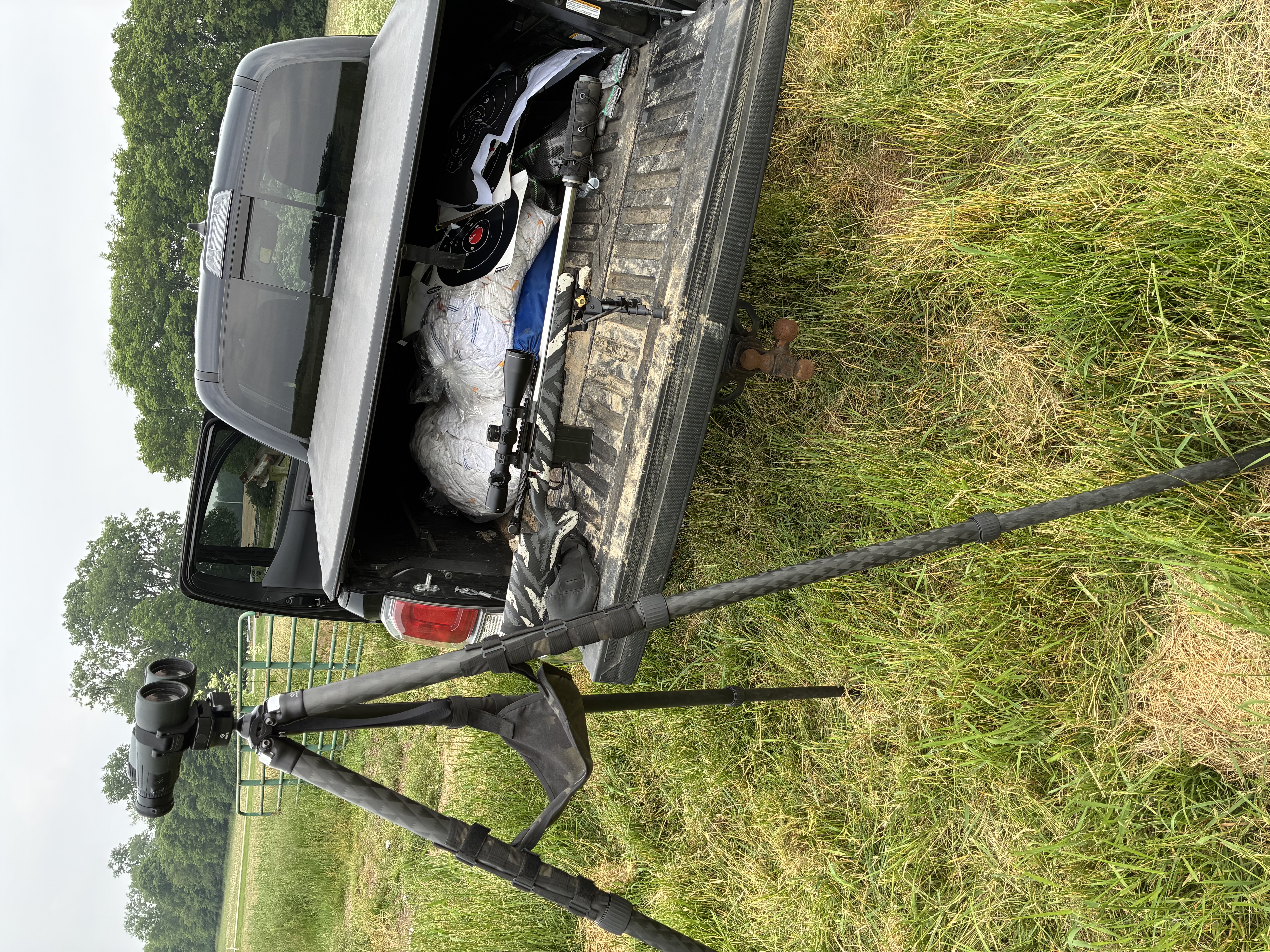

Took my Maverick off to try a Botnia on this beast. Zero only moved about a half tenth right. Top two groups where with my lite fill rear bag. Bottom two with heavy fill rear bag. Bottom right was after adjusting .05L on the scope.
Should be all set for the Positional Punisher in a couple weeks.

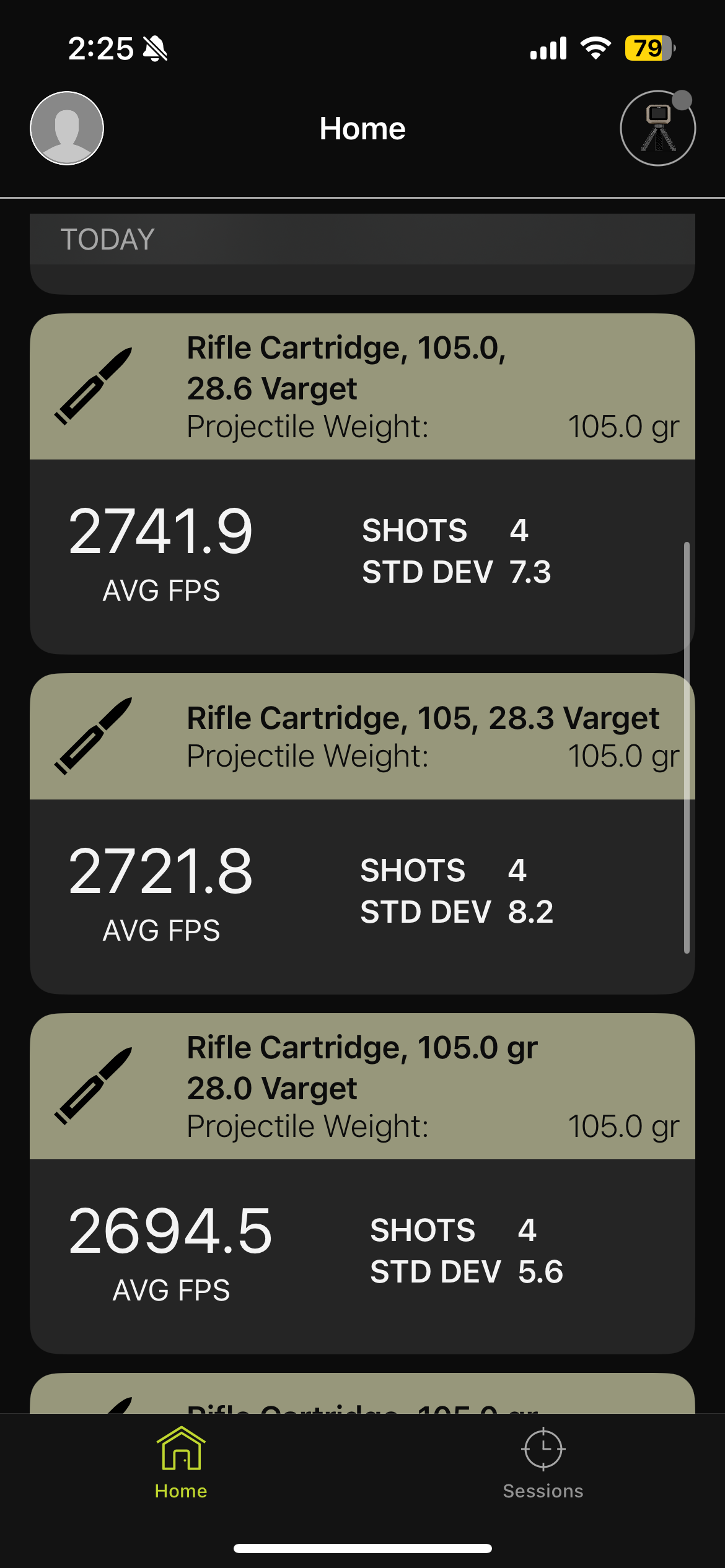

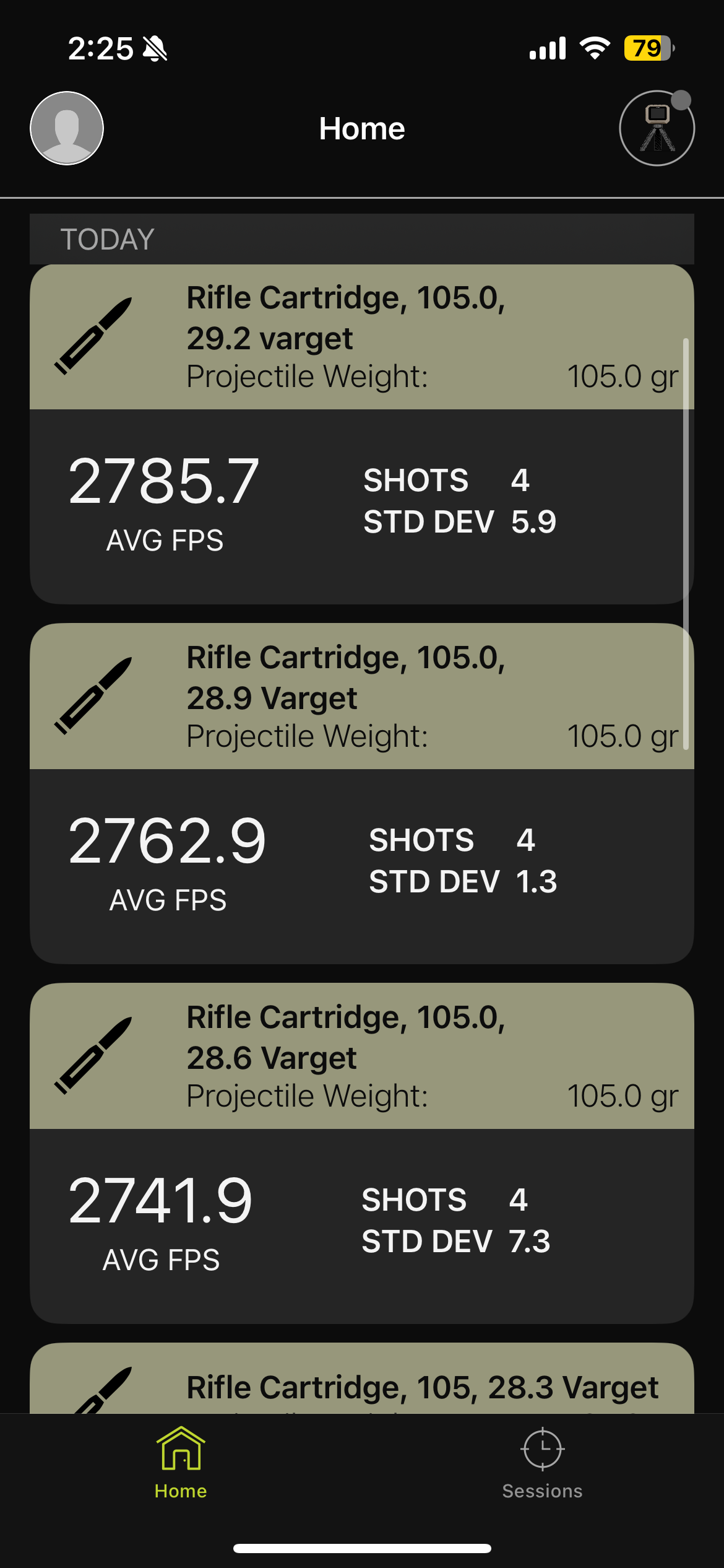

I finally jumped on the BR wagon and ordered a prefit for the ATXC. 105 hybrids and 29.5 GR varget. New lapua brass and a cci br4 puts me at 2745fps. It’ll definitely speed up, but it seems to be pretty happy at that speed so I may stick with it. Started at .020 off and it shoots well under half moa right away. Going to test seating depths tomorrow and see if accuracy changes.
