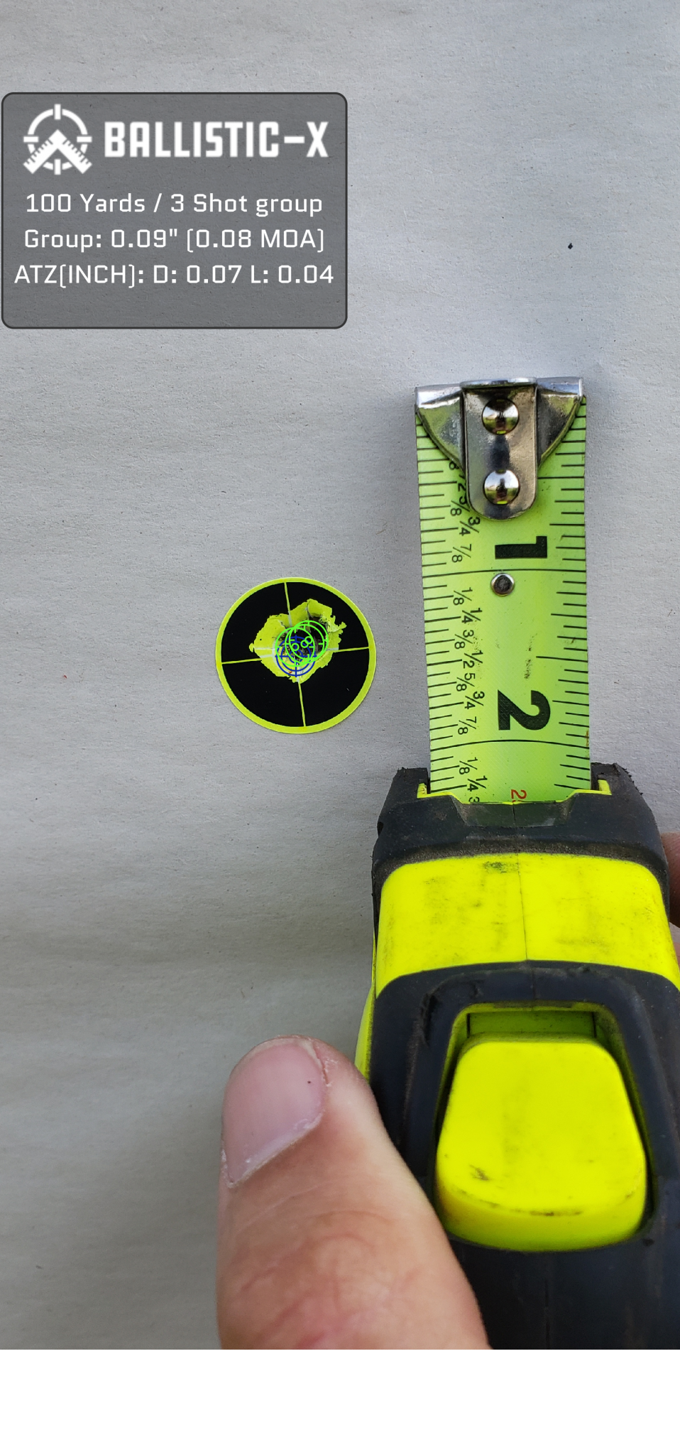

I swear. This gun/caliber/load never ceases to amaze me. I havent shot this rifle or any groups with any rifle since April. Cold bore, cold shooter, 1 year old ammo. Shot these 3 rounds then went 2 for 2 on a 6" square plate at 511, then put the damm rifle away. I wasn't even sure if the scope was zeroed for this barrel when I shot it. I believe the zero is good.
Ballistic-X-Export-2021-08-27 16:18:37.570180.png

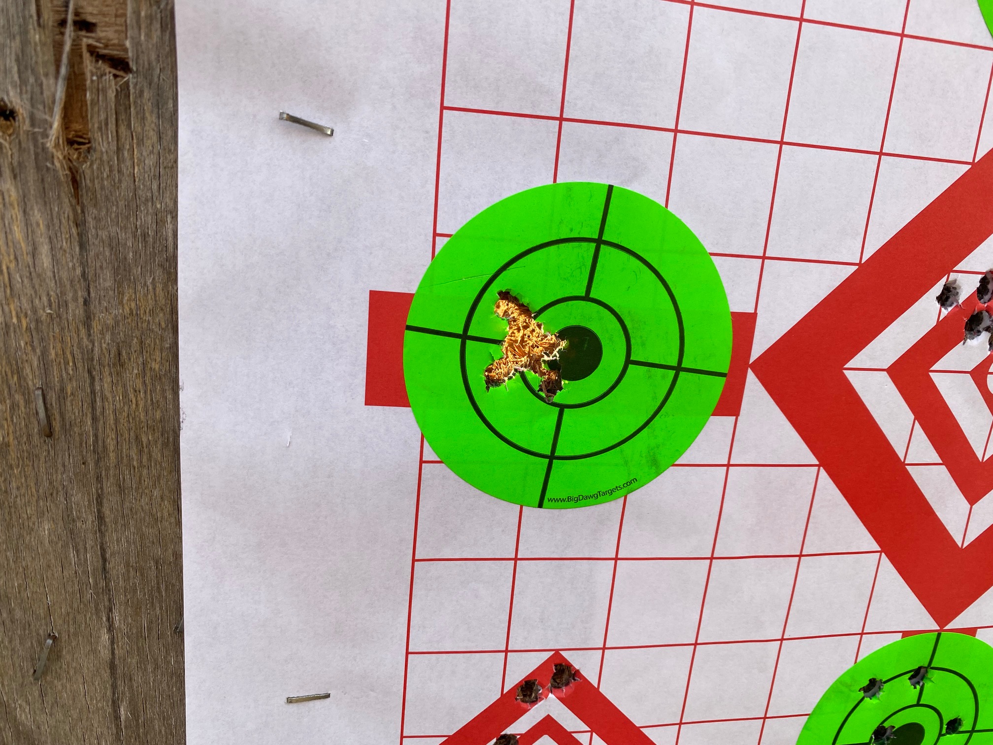

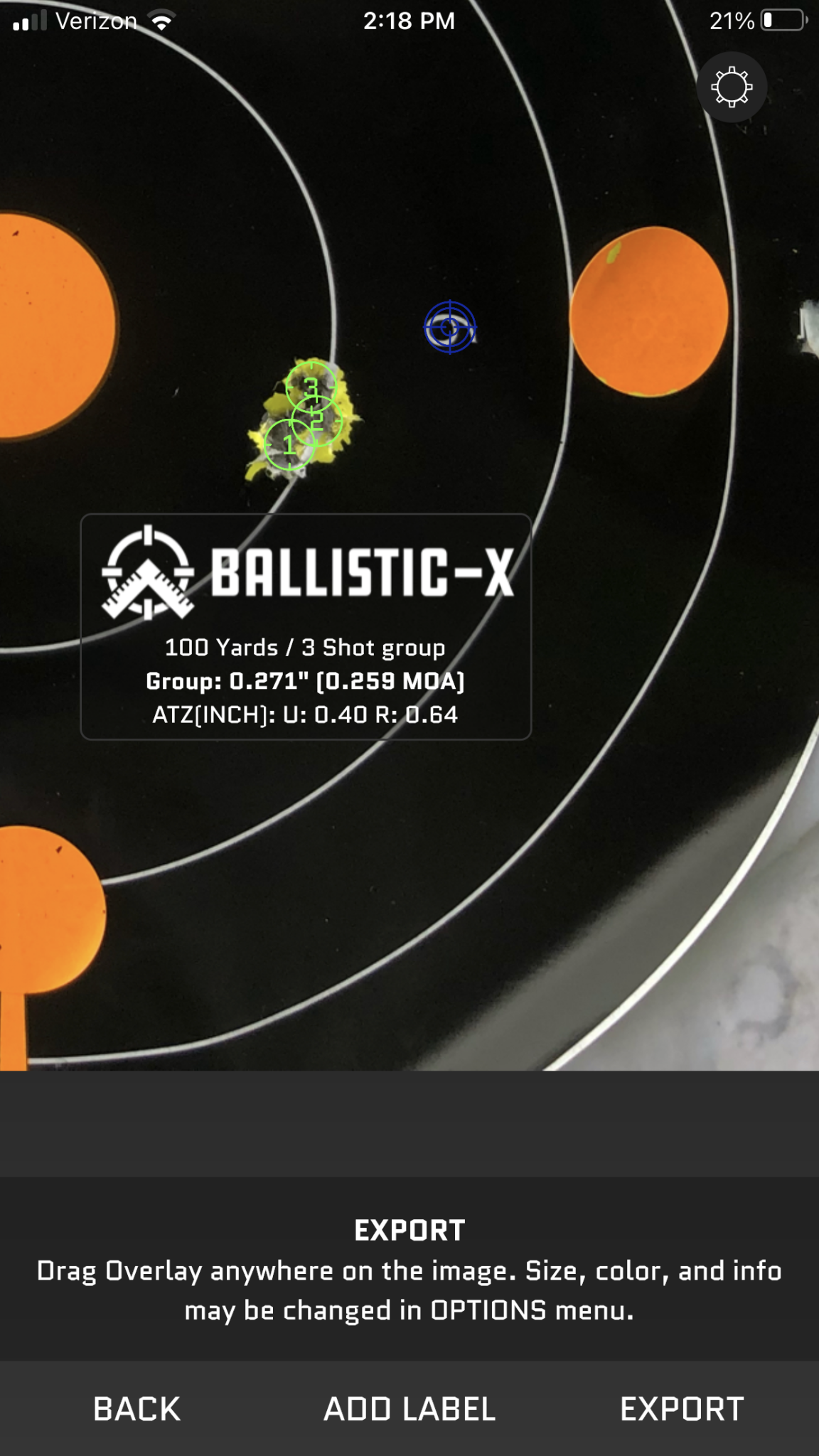

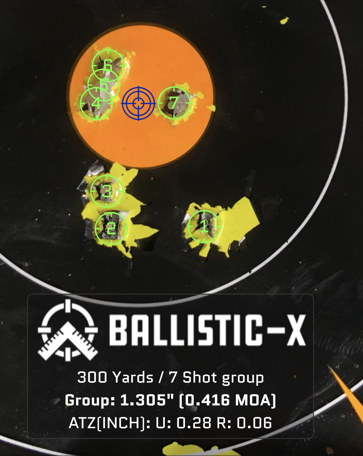

I finally torqued on my dasher barrel so it seemed only fair to post some results. These are ~100 rounds in so chances are there will be a bit more evolution on the barrel before it becomes 'stable', though I've already seen a ~20 fps speedup with HDY 105's. I'm also running virgin alpha brass so that's going to change things a touch as well after I get onto the second firing.
  • 112 Matchburners over H4350 are looking like the standout so far for my goals, 34.3-34.5gr yielding right about 2800 fps with a pretty good SD of 8 (for a very small sample of 6 but good enough to revisit). These loads are just slightly compressed, it's about perfect.
  • Staball looked great with 112's at 2600ish fps but seems to have fallen apart after reaching the 2800's, both in terms of ES/SD and groups. I have enough other promising powders that I'm probably going to stop with the staball testing.
  • IMR-4166 gives great speeds and has been pretty accurate with all kinds of 105-109's (Berg hyb 105 and 109, 105 HDY BTHP, sierra 107) but I'm having trouble getting good ES/SD. It also gives great speeds with 112 MB's but accuracy above the mid 2700's was meh and also had poor ES/SD.
I see a few mid range loads in this thread with IMR-4166 (mid range being 31.something) and that's about the speeds I want to be for now. Do folks running 4166 in that range do anything special to get your ES/SD down? I've been running a .242 mandrel through the necks with a touch of oil before seating to loosen the necks up, but maybe they're too loose at that point.

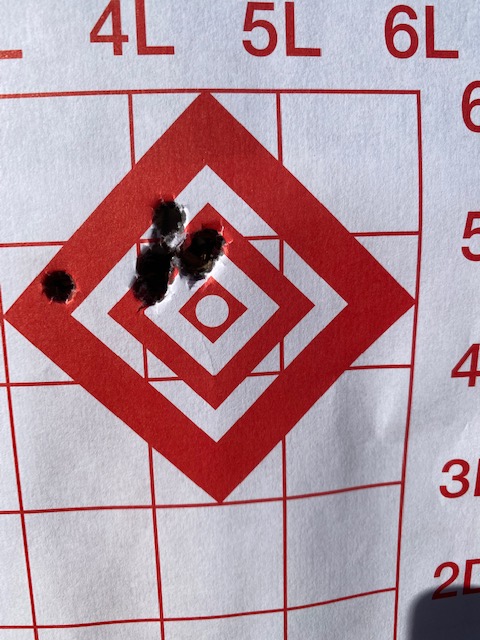

First 6BR variant
6 Dasher
28” Brux 1:7.5”
Alpha OCD brass
Br-4 primer
105 vld target
SWP 32.9
2868 SD 8.8 (20 shot set)

not running mine real hot, 32gr H4350, Berger 105's. 2707fps. SD's and ED's nothing super 34/11. 10 shot group which is what i shoot. 75 seconds total string first to last shot. Was kinda on the cold side when i shot these, around 38degrees with north wind off to my right about 10MPH. left shot was the cold bore, then the next 9 stayed together. Had my barrel chambered for Norma brass by LRI. I have some Alpha brass OCD, i'm thinking of loading up and shooting out of this setup to see how it does. Second picture was from the evening before, factory new brass 10 rnds, then I took the brass, wet tumbled it, FL sized, bumped the shoulder .002 , necked it back to .242 and shot it again. Wanted to see how they 2 groups compared with once fired brass

You should be way gtg all the way up to 34gr. I started at 35gr and as my powder eventually dried here in Colorado I kept having to back it down. There's no pressure with 4350. You'll run out of case capacity first
switched over to 32gr of varget as i just couldn't get a good SD with the H4350.
