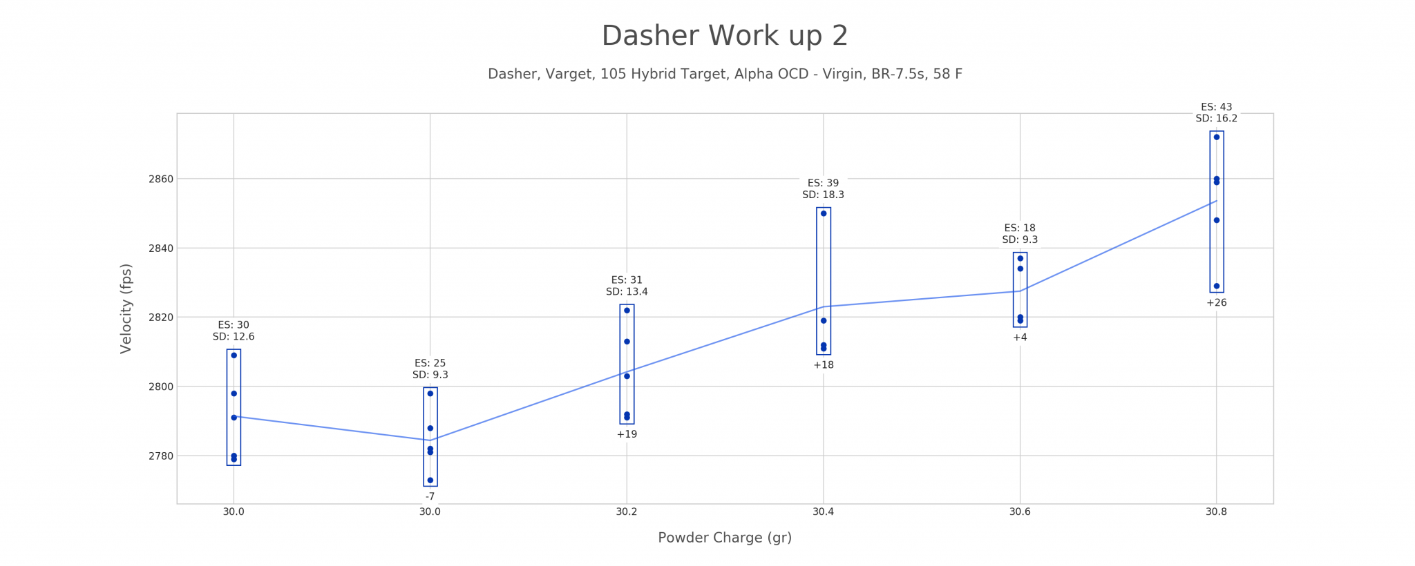

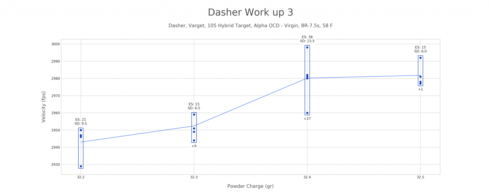

Working up a load for my Dasher- had a lot of nice 100 yard groups- but the velocity nodes is what I am looking for here
Varget / 105 Berger Hybrid Target / Virgin Alpha OCD Brass / Remington BR-7 1/2s
CBTO: 1.776" COAL: 2.394" jump of .005 based on measurements. Tests are with rounds 198-248 so barrel should be up to speed now.
no pressure signs in the primer/brass/bolt lift - but surprised at the results. Any thoughts here?

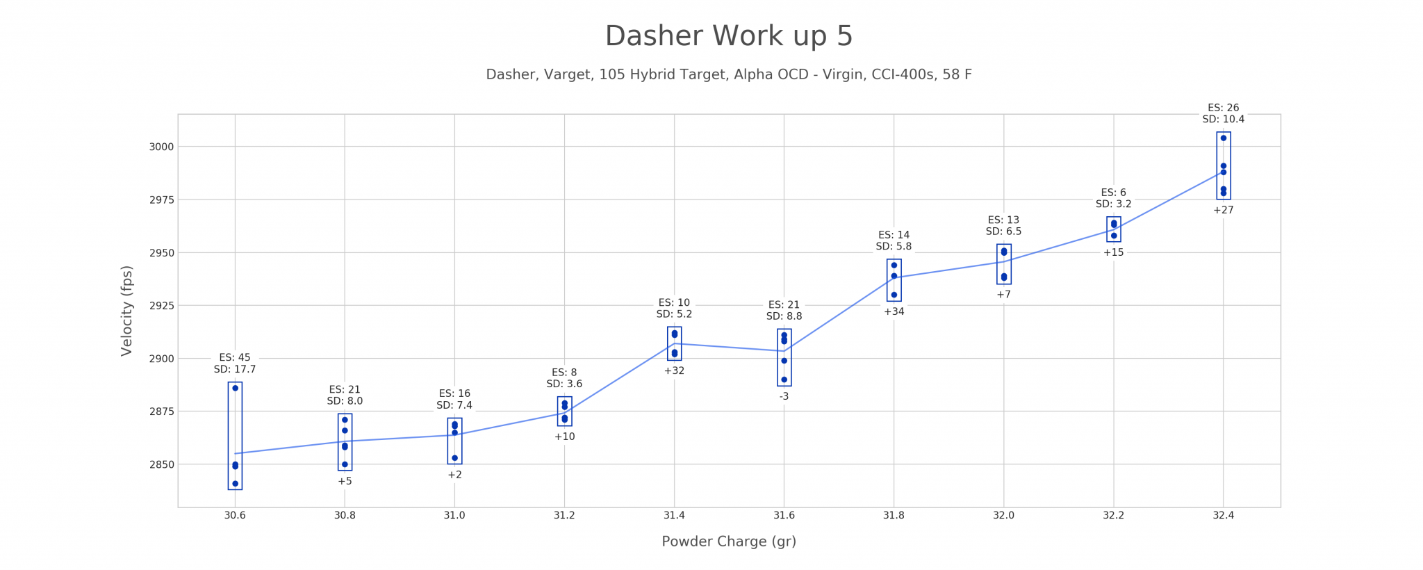

I am shooting 32.1 -32.6 again this weekend in .1 increments (again in fresh alpha brass) with BR-7.5s to confirm that node.
plus I am doing the 30.6 ladder in .2 increments with CCI 400s (alpha OCD brass, Berger Hybrid Target 105s, Varget, CCI 400s) to see if there is any difference to be found. More to follow

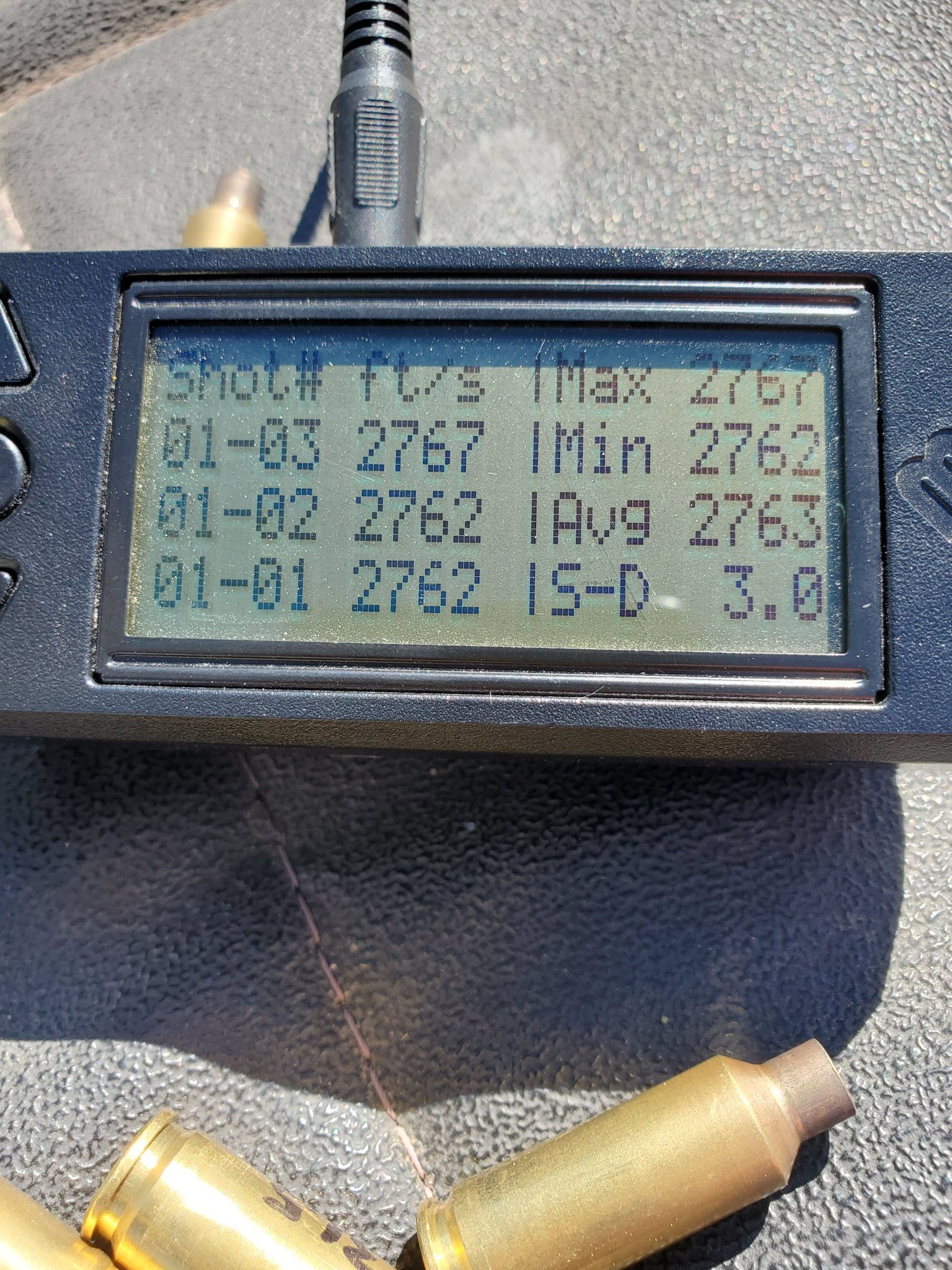

I got to the range today with my new 6 dasher 26" Hawk Hill chambered by Ice Rifles on my Tikka action in a KRG Bravo with a Hellfire gen 3 brake. I have Lapua brass that has been Hydro-Formed by DJ's. I previously put 16 total rounds on it in order to send 3 cases that were fired 3 times each off to Harrels Precision for a sizing die. This time I brought 20 cases with 105 Hybrid Bergers, CCI 450 primers loaded 40 thou off lands with Varget ranging from 30.5 grains up to 32.4 grains.
I tried to maintain even timing between shots so the chamber was not overly hot. Found that 31.8(2892 fps), 31.9 (2898), 32.0(2894), looks like a good target speed for this barrel. The speed went up from there 10 fps 32.1(2904).
So I guess now I will load some more up at 31.8 grains and try various base to ogive distances centered around 50,000 off in groups of 5 and test them at 200 or 300 yards. I realize some of you probably prefer to find the jump first before the speed but I had to start someplace and this is what I figured. I am guessing the barrel may speed up a bit once it gets more rounds thru it.
I think the rifle is very accurate from what I see and am very happy with it. I am pretty new to this load development process and do not have much experience other than a couple of 6.5 CM barrels. This Dasher is going to be nice. I may even shoot a match with it next weekend if work does not get in the way of my time to get ready.

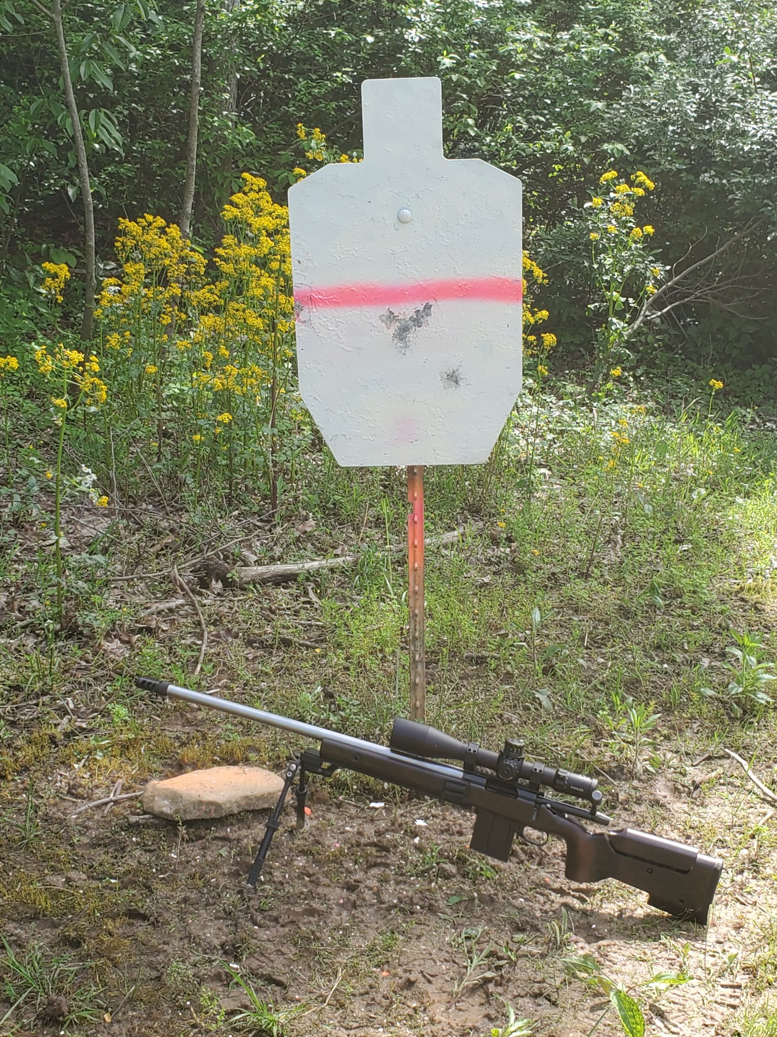

Got lucky and shot this group today at 1092 yards while checking dope for the Vortex Rampage this weekend. Don't pay any attention to that little guy on lower right, they can't all be winners. First shot was left edge also, but corrected wind call after that. Looks like it would have been in there also.
6 dasher
Lapua brass
107 Sierra
32.3 varget
2930fps w/ es of 4 over 5 shots

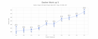

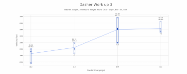

Started playing with the dasher again after screwing around with the GT and being let down. Had my proof barreled GT set back and rechambered, so barrel length is around 23 3/4" with an ultra 7 suppressor.
Varget with a 110 atip shoots really well with a great node at 31.5 grains, but it's a little slow. Went up to 32.1 grains and started to see some glinting of TL3 ejector. Was just doing 3 shot velocity tests to check SD while I was working a load up.
