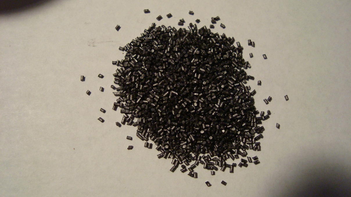

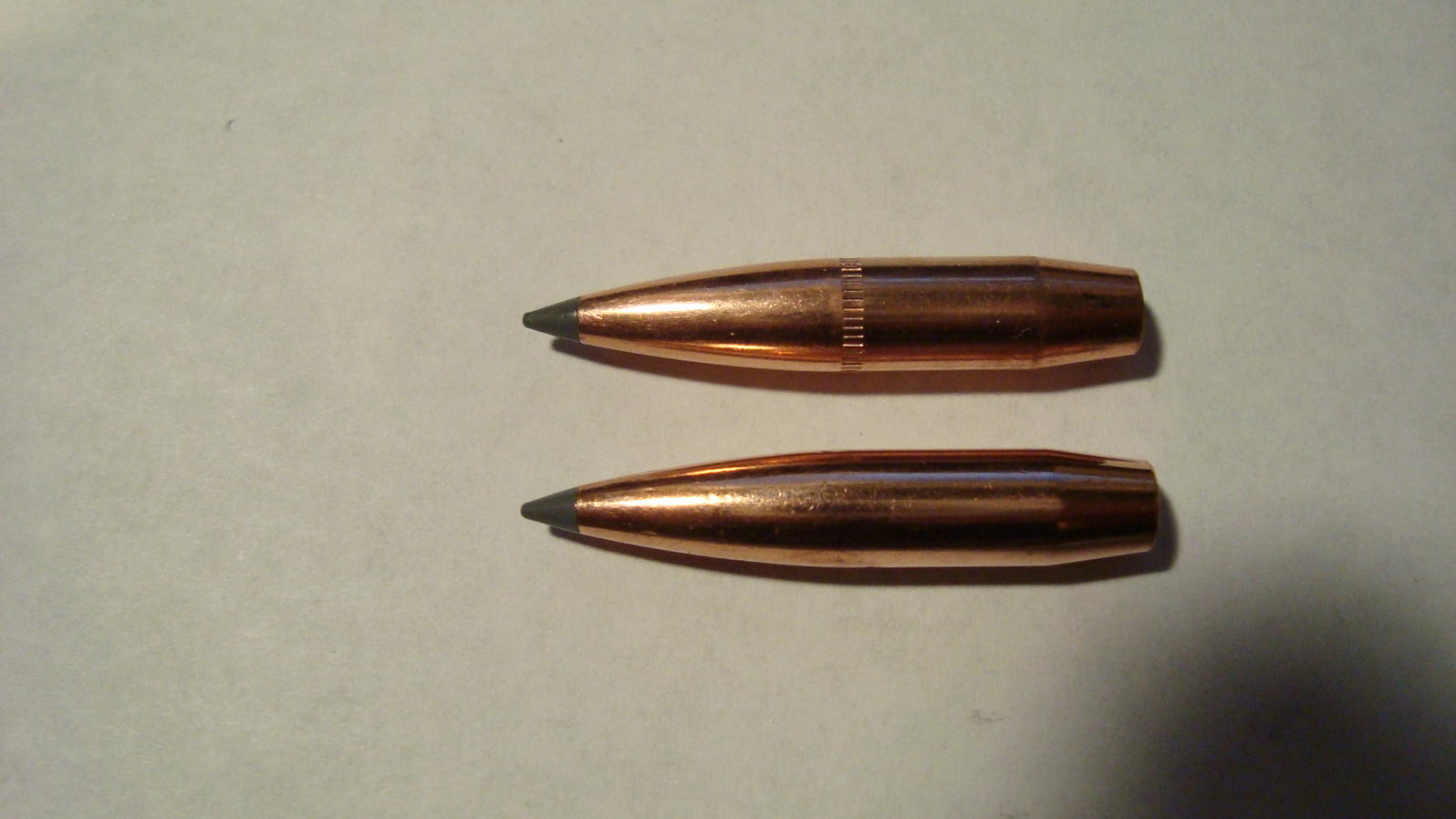

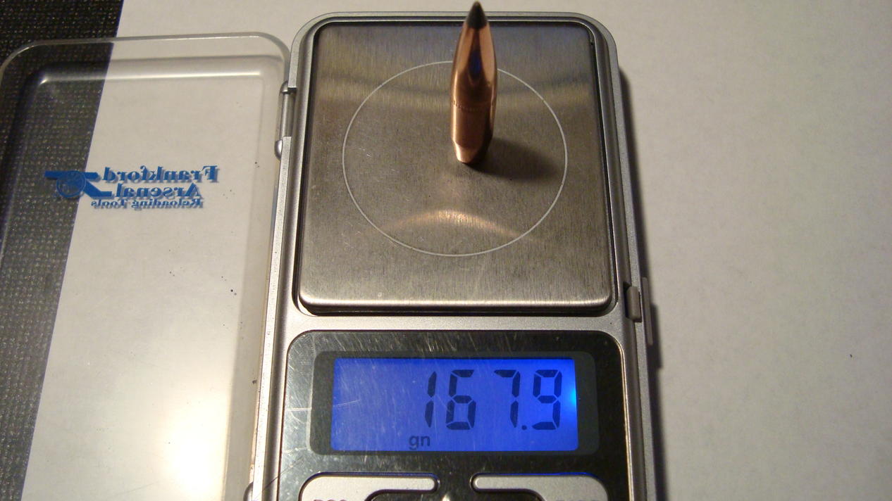

Anybody load up the new Nosler ABLR 168's over Ramshot Magnum? I emailed Nosler last week for some info, but they have not gotten back to me. The only info on their website is for 168 CC's. Given the ABLR is much longer than the CC, I am sure loads will have to be on the lower end.
I ran some numbers through QL and the starting load of 68 gr puts me at 54,440 psi and 2880, which should mimic the factory load.

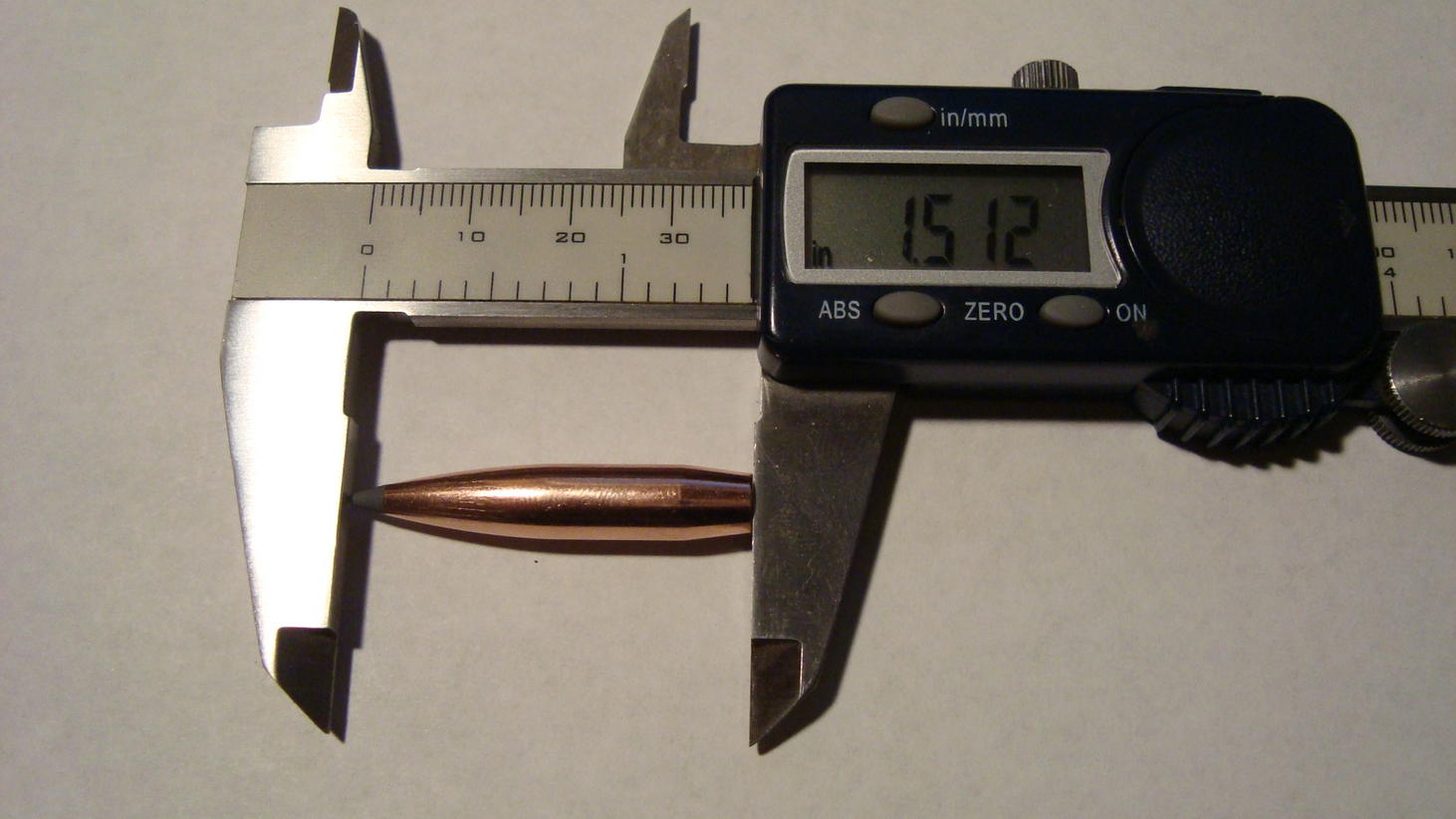

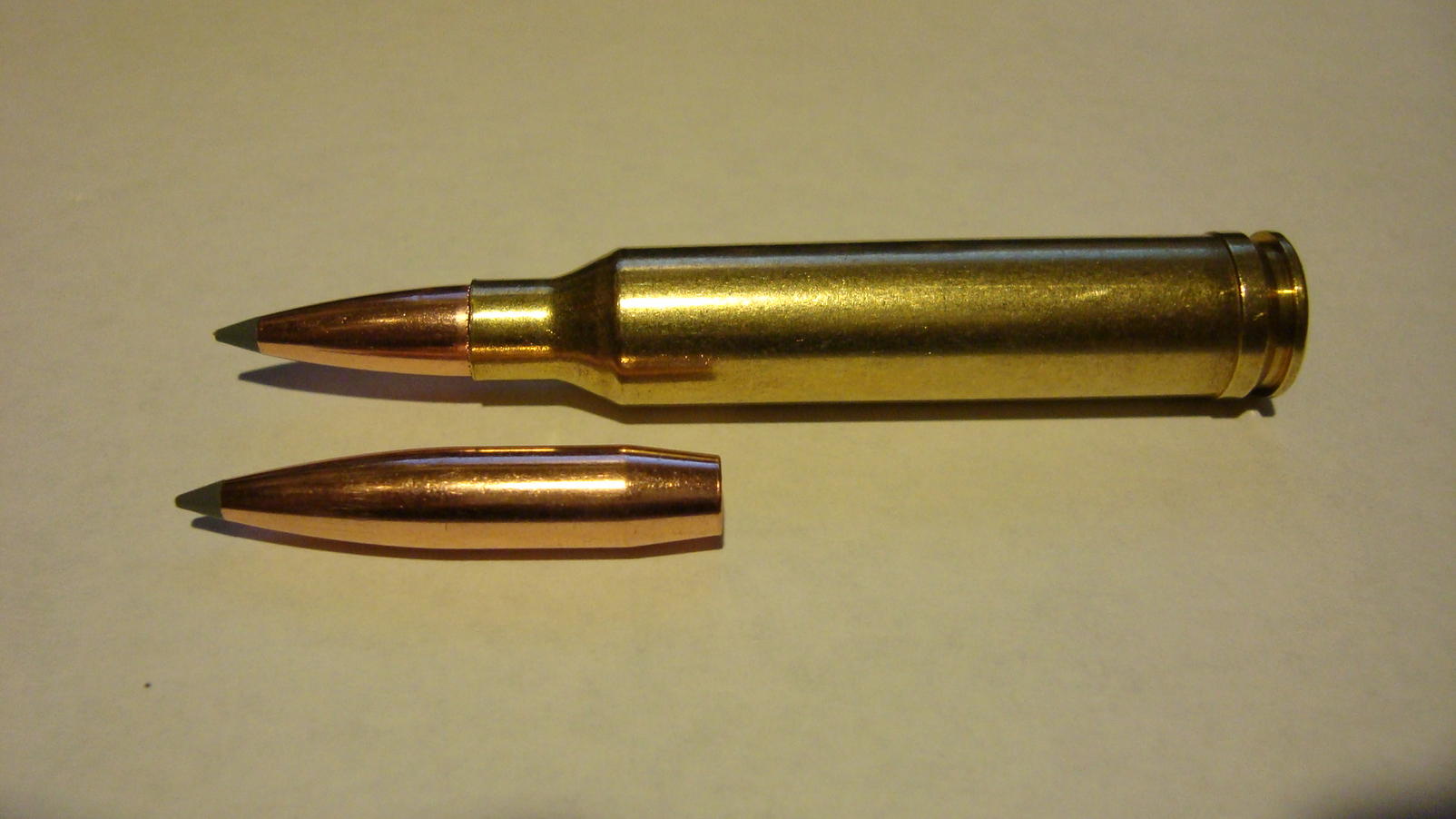

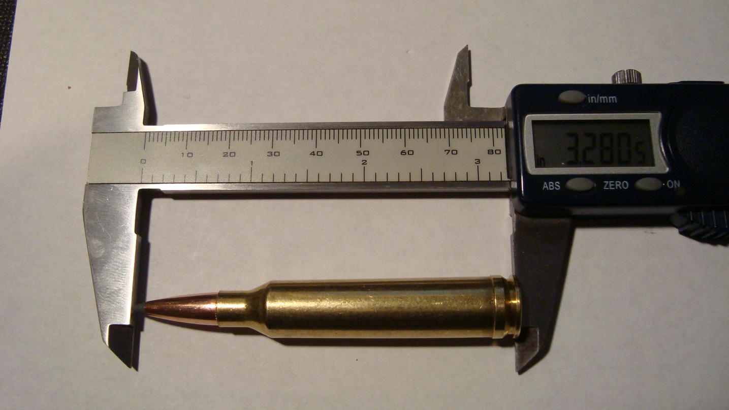

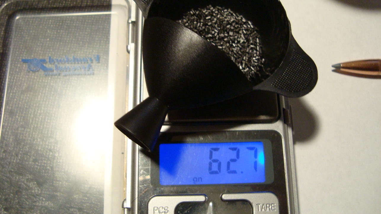

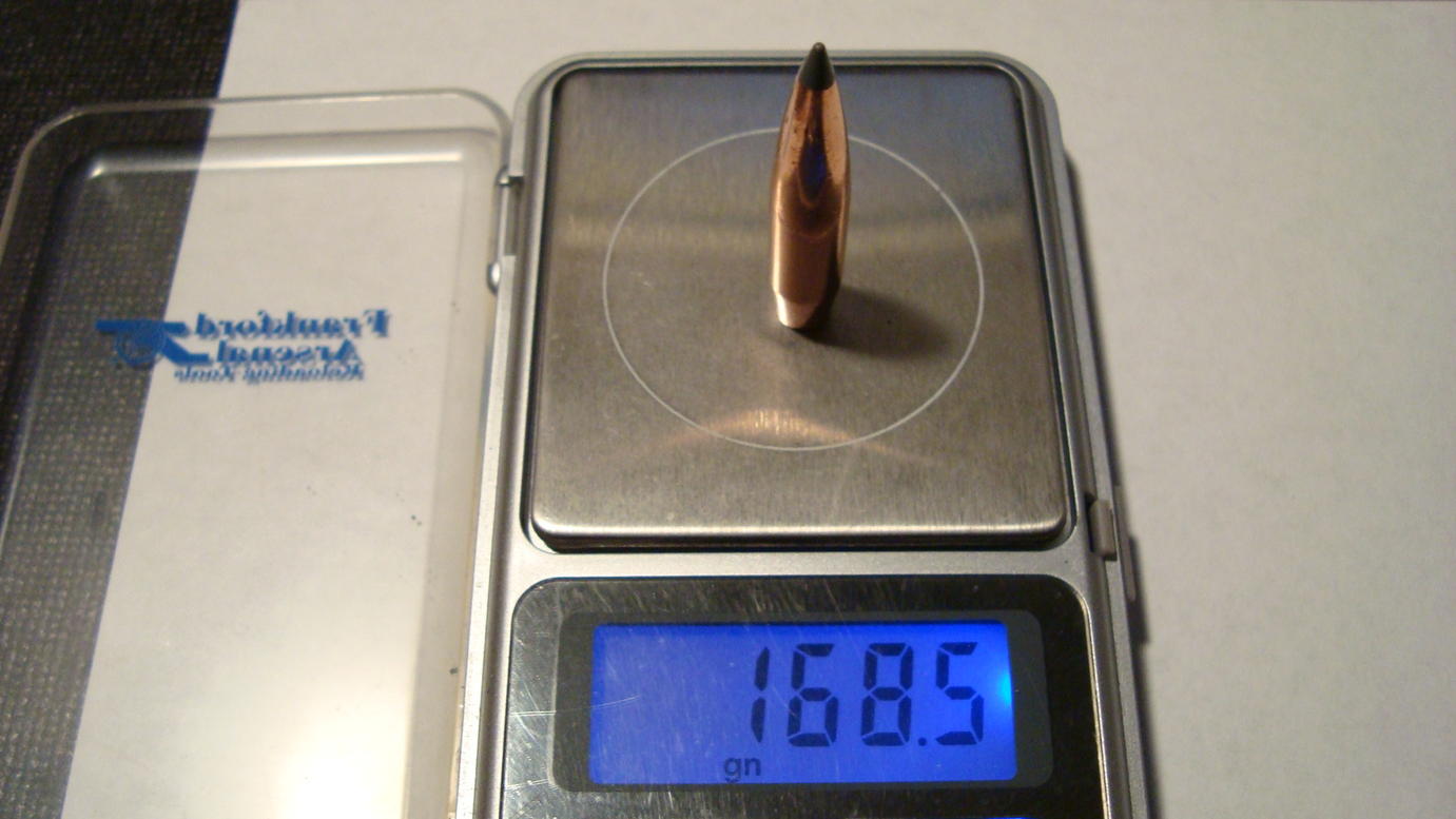

I dissected the factory 7mm mag 168 ABLR, just for the heck of it. The loaded bullet was darn close to 168. According to the website, the handpick the components , debur chamfer, work over the primer pockets , etc.
I did notice the bullet has a cannelure vs the loadable bullets. Either way they shoot sub moa in my Tikka, so I will hunt with them next week and work up loads as I gather data.
I am not gonna try to guess what the powder is, it is quite dark, short cut 62.7 grains.

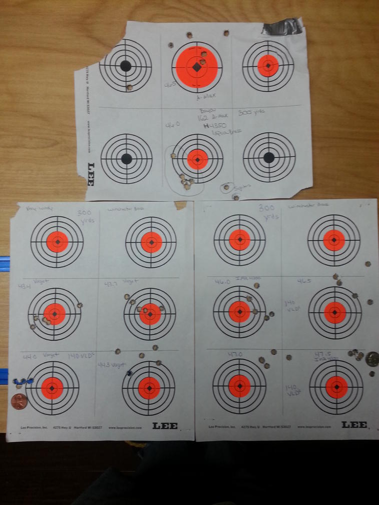

7mm-08,
Winchester Brass,
fed 210M,
24'' barrel,
150gr SMK's Varget 41.0 41.5 42.0 42.5 Winner (42.0) AOL 2.236 with Hornady AOL guage,
162 A-Max Varget 39.0 39.5 40.0 40.5 41.0 Winner (39.0-39.5) Next outing 39.0 39.2 39.4 39.6 Winner (39.2) AOL 2.194 Hornady guage,
140 VLD's Varget 41.5 42.0 42.5 43.0 43.5 44.0 Winner (43.5 44.0) next outing 43.4 43.7 44.0 44.3 winner 44.0 AOL 2.200 HG (very windy)
162 A-Max H4350 44.5 45.0 45.5 46.0 46.5 Winner (46.0) New resized lapua 308 brass, still playing with this load.
I also tried 140 VLD's IMR 4350 46.0 46.5 47.0 47.5 Winner (47.5) This was one of my best groups. I need to recheck some of these loads because of the mirage/wind..Here are some of the last targets from the last few outings. I hope this helps anyone loading the 7-08. I never noticed any pressure signs on any of the loads. 300 yards.
