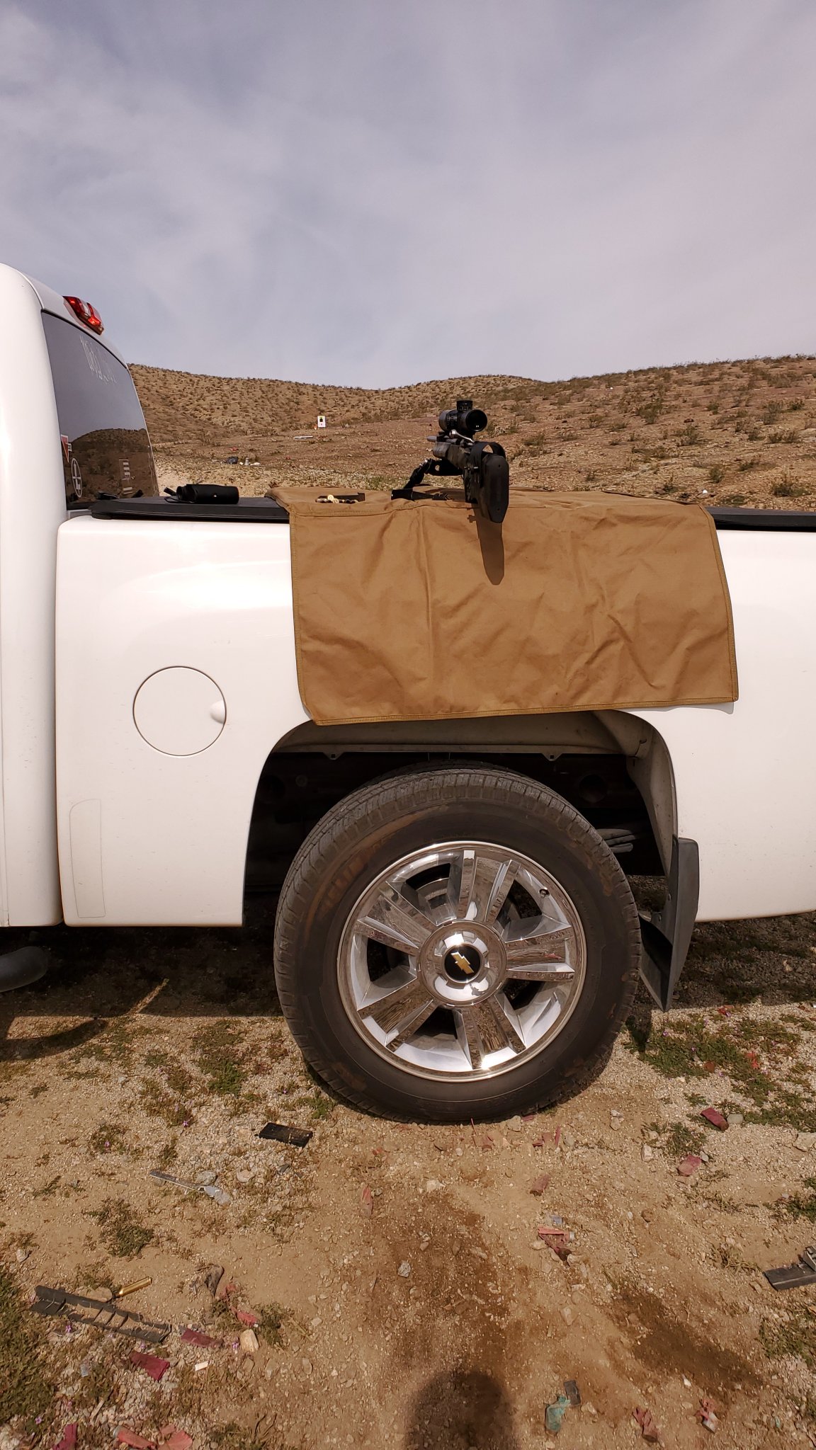

Rifffle: 7mm RemMag Tikka T3x Lite, 1:9.5, 24", factory configuration dropped into a Manners T4 MCS, CDI bottom metal. About 1500 down the tube.
RP Brass (3-4 firings, Lee Collet Die neck sized.
FED 215M primers
68.5 gr Reloder 26
168 Berger Classic Hunter hybrid
.020 jump
Lee dies in my old Dillon RL450
I think I did something right ?? 106 yards shooting from this position:
Made an adjustment, Changed point of aim, this happened:
Velocity.... no clue. When I shot Berger VLD 168's, Sierra 168 Matchkings it was 2985-3000. I suspect these 168's are moving with about the same sense of urgency.

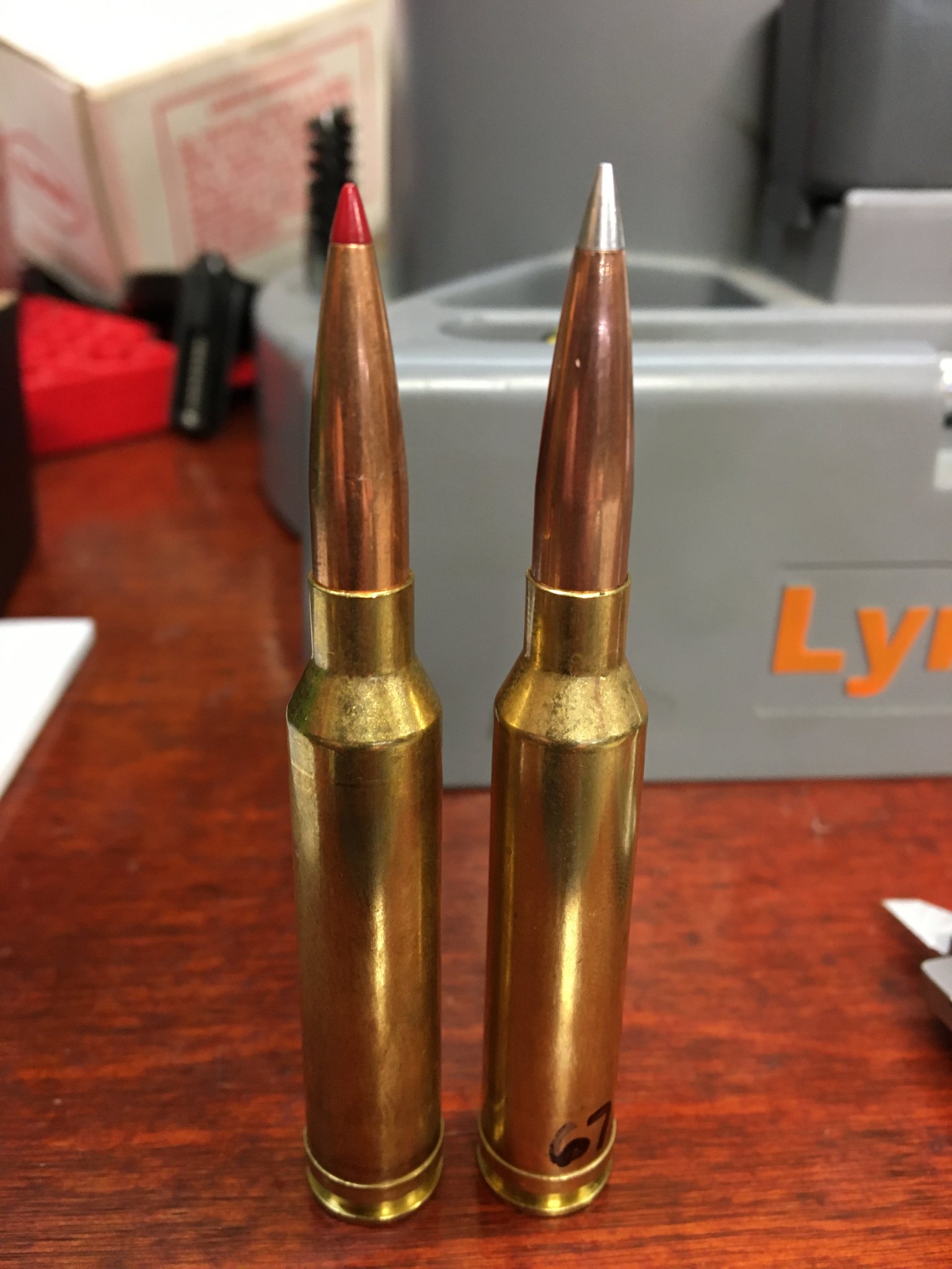

Anyone try 190 Atips yet in 7RM?
edited Update: I tried some got them around 2945 with 67.7 grains of RL26. No signs of pressure gonna work up a little higher and see if I can find the next node or pressure signs. If I can get them up to 2960 safely they would gain me around 1 mil of elevation and .1-.2 of wind better than 180 ELDM’s at 1760.
