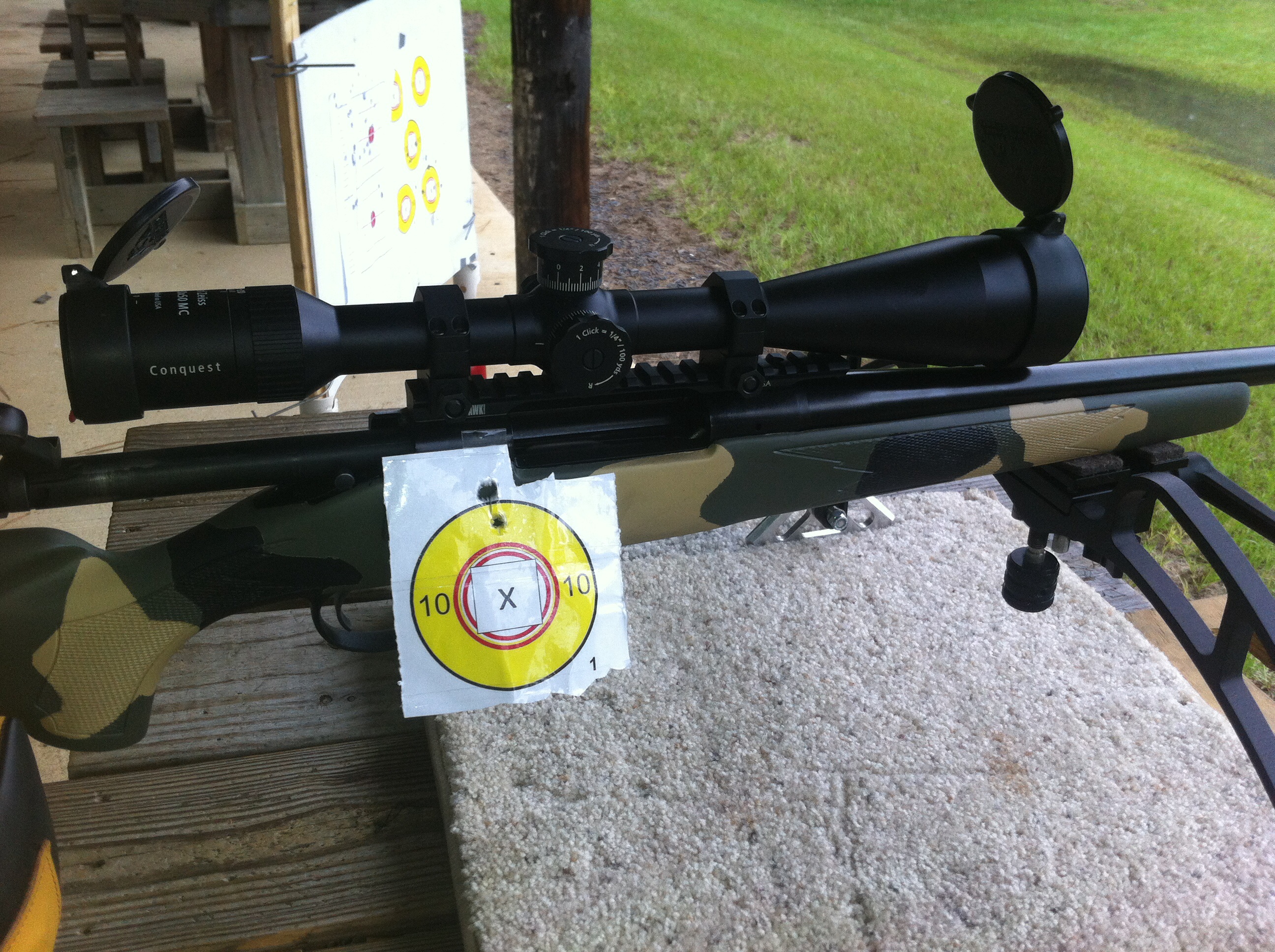

7mm-08
Trued Remmy action
26" rock creek #3
mcmillan stock
Power pro 2000mr 44.5 grains
Wolf primers
Nosler cases
5 shots, 4 in one hole. Wind blew target stand backwards on the 3rd shot.

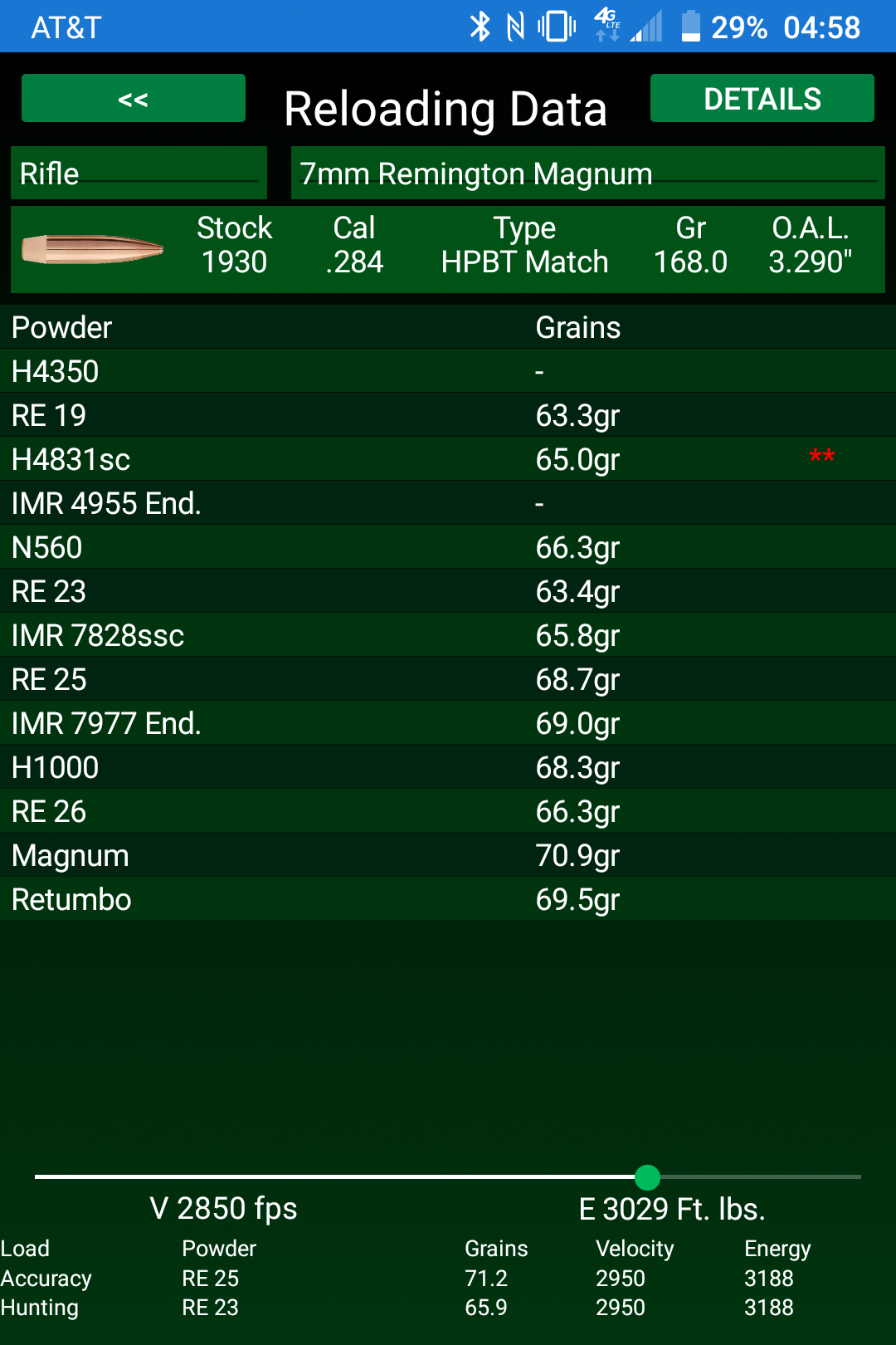

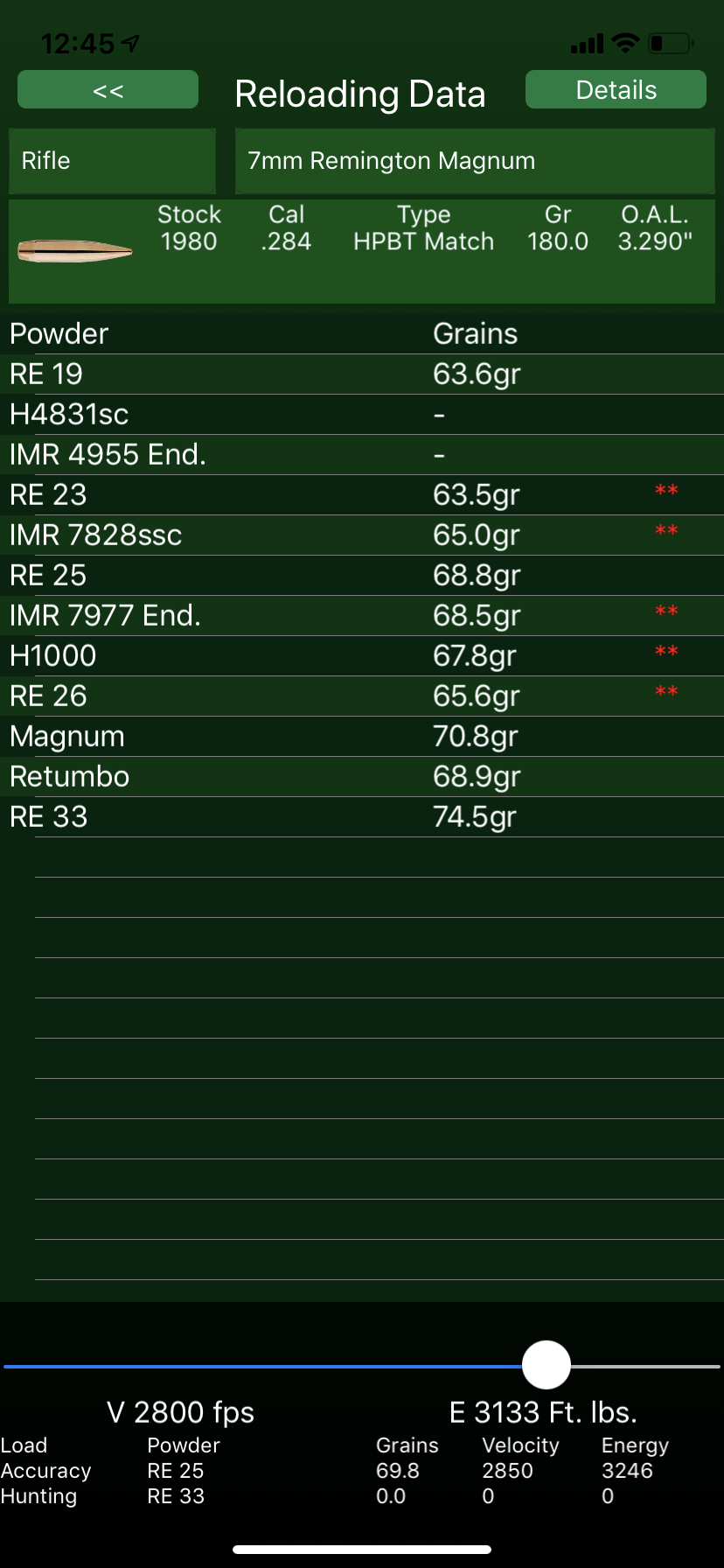

When you put ".047" headspace", does that mean .047 of bullet jump to the lands?
Try downloading the Sierra app on your phone. I have an iPhone and it works great.
Pick the caliber, then bullet (limited to Sierra bullets though). Use the slider on the bottom for your desired velocity.
