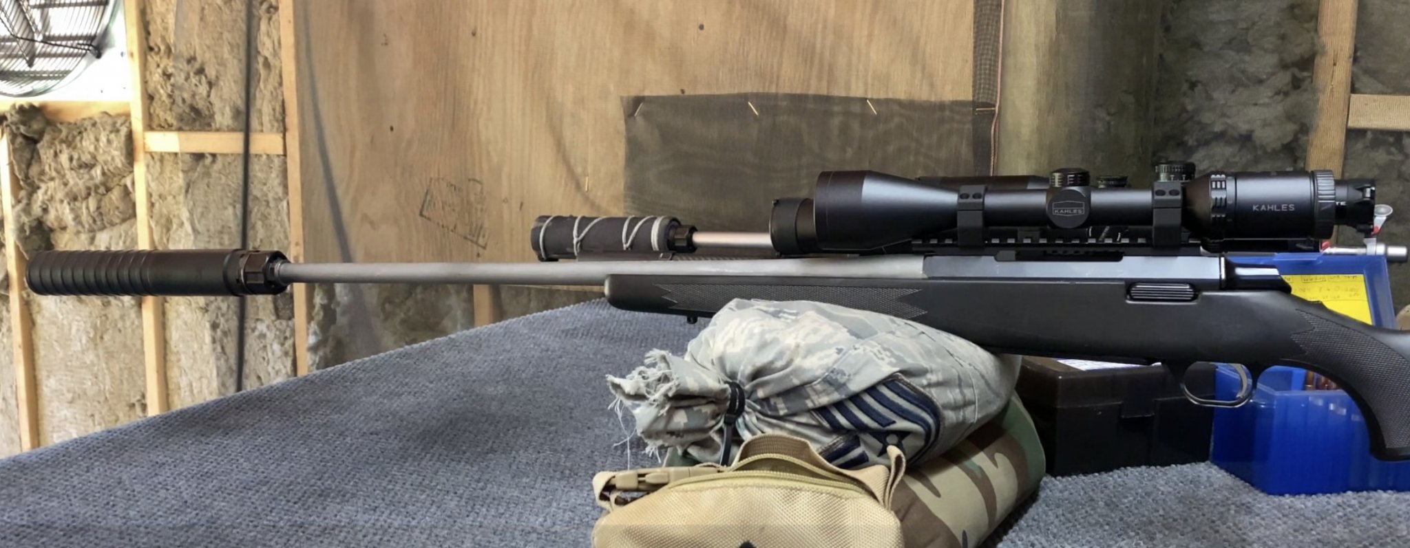

New video is up with the brand new Otter Creek Labs Hydrogen-L on my custom A-Bolt II 7mmRM. This is going to be one awesome lightweight (and QUIET!) deer hunting rig. I hope my stamp comes back before deer season. 👍🏼
Reactions: forthehunt
I’d say I’ve gotten that new Berger 168 VLD & 7977 load dialed-in pretty damn well, after hacking and threading the Browning 7mmRM down to 22.5”.
These were shot with the Otter Creek Hydrogen-L with the ZR0-DTA mount.
Normally I shoot 5-shot groups, but with magnums I typically only shoot 3-shot groups, due to the extra heat and wear on the throat.
Plus, my magnums are only for hunting, and are not range toys. Therefore, I normally would never need more than 2 shots in a row on deer. Typically only 1, as I don’t miss, also by law we’re only allowed a 2 deer per person, per day limit. So, hunting inside of 500 yards, that’s only 2 shots max for me.
Hydrogen-L w/ KeyMo setup.
Hydrogen-L w/ OCL ZR0aDTA mount.
Not counting the fliers (caused from me adjusting between shots)
With fliers (after making an adjustment)

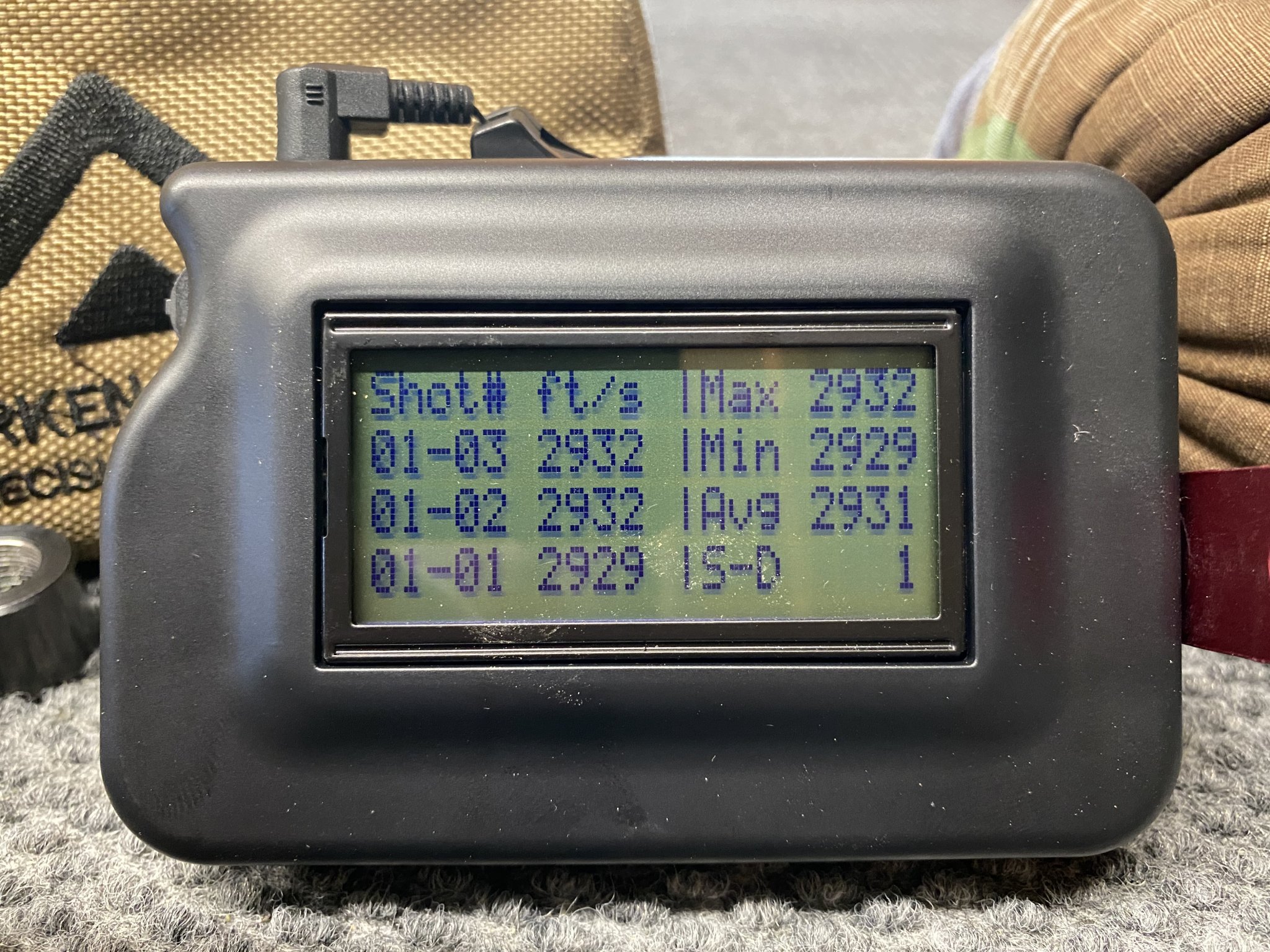

Magnetospeed V2 data shooting through the suppressor for exact real-world ballistic data.
Avg. MV: 2,931 FPS
ES: 3 FPS
SD: 1 FPS
Wow. That's a good speed for a 22.5. Have to wonder how hot is that load.
I guess barrel life doesn't matter. 2 shots a weekend should still see the rifle last you a few decades.
It's a VERY hot load. I wouldn't recommend it without very carefully working up. The A-Bolt II action is a 3-lug design and distributes pressure more equally than a 2-lug like the Remington 700 style actions. Therefore it handles pressure a bit better, as well. That said, max recommended charge for that load is like 68.5gr on Hodgdon's digital reloading center (none of my manuals are new enough to have 7977 in them). So I worked up and found the best nodes, and in my rifle found one at 68.5gr and then again right on the money at 70.0gr. And since I had no excess pressure signs, and the chrono data and groups at 70 were amazing, I figured I'll let it ride.
I've probably got over 350 rounds through that barrel, and she's still putting 3 shots in the .350" range... Hopefully she'll be around for a long long time. 👍🏼

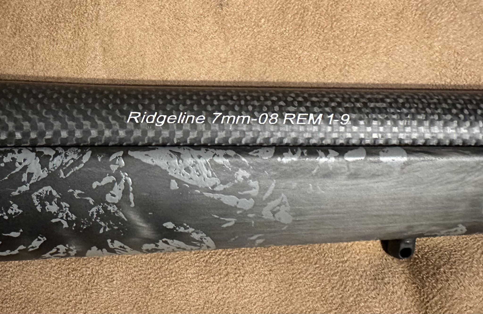

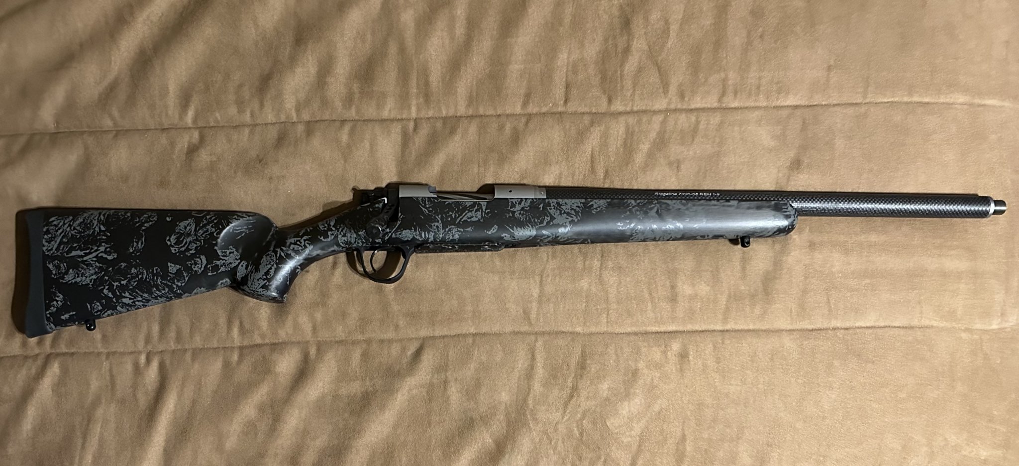

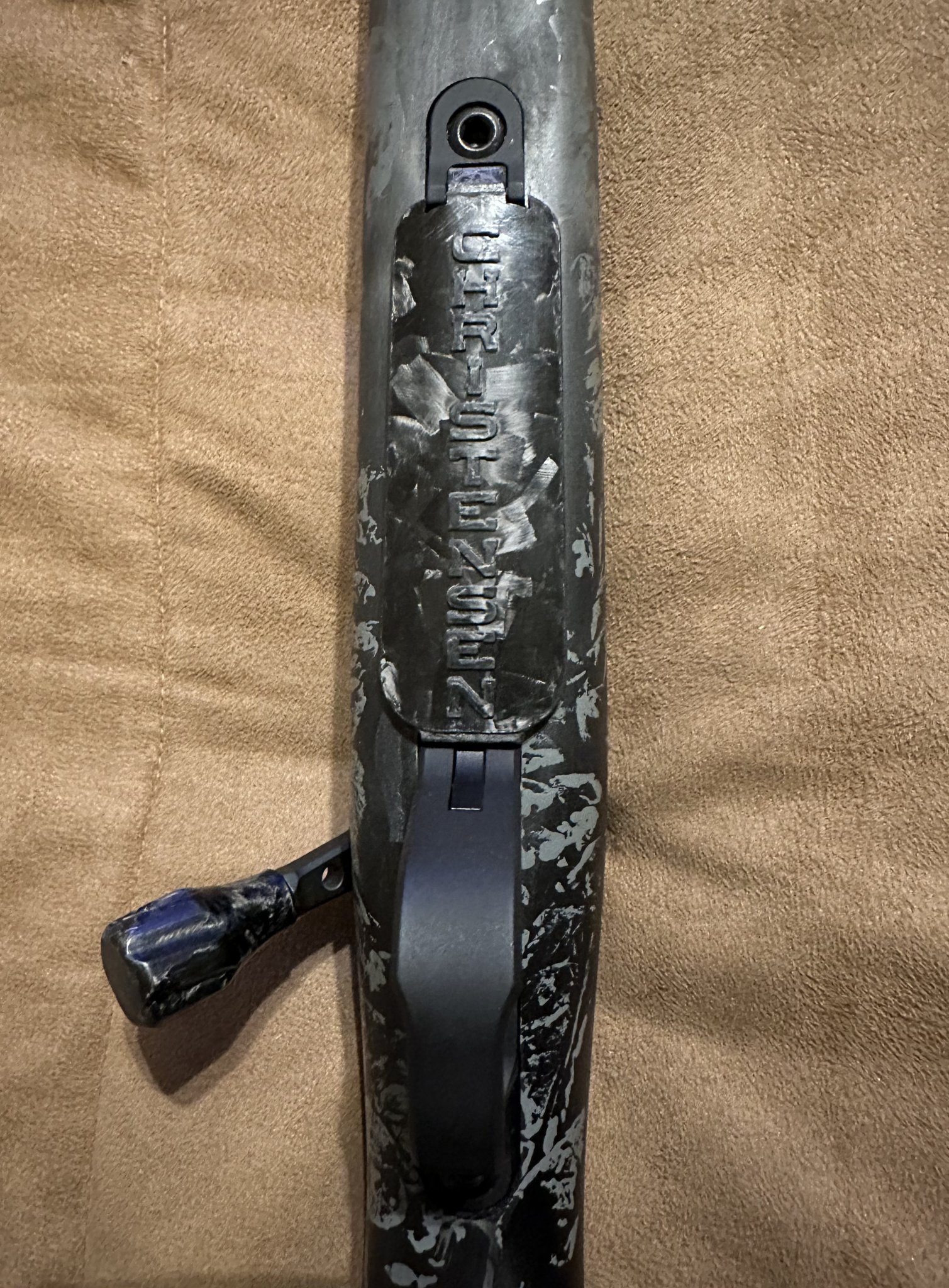

Fucked around and went into the local store after work… 🤦🏼🤦🏼🤦🏼

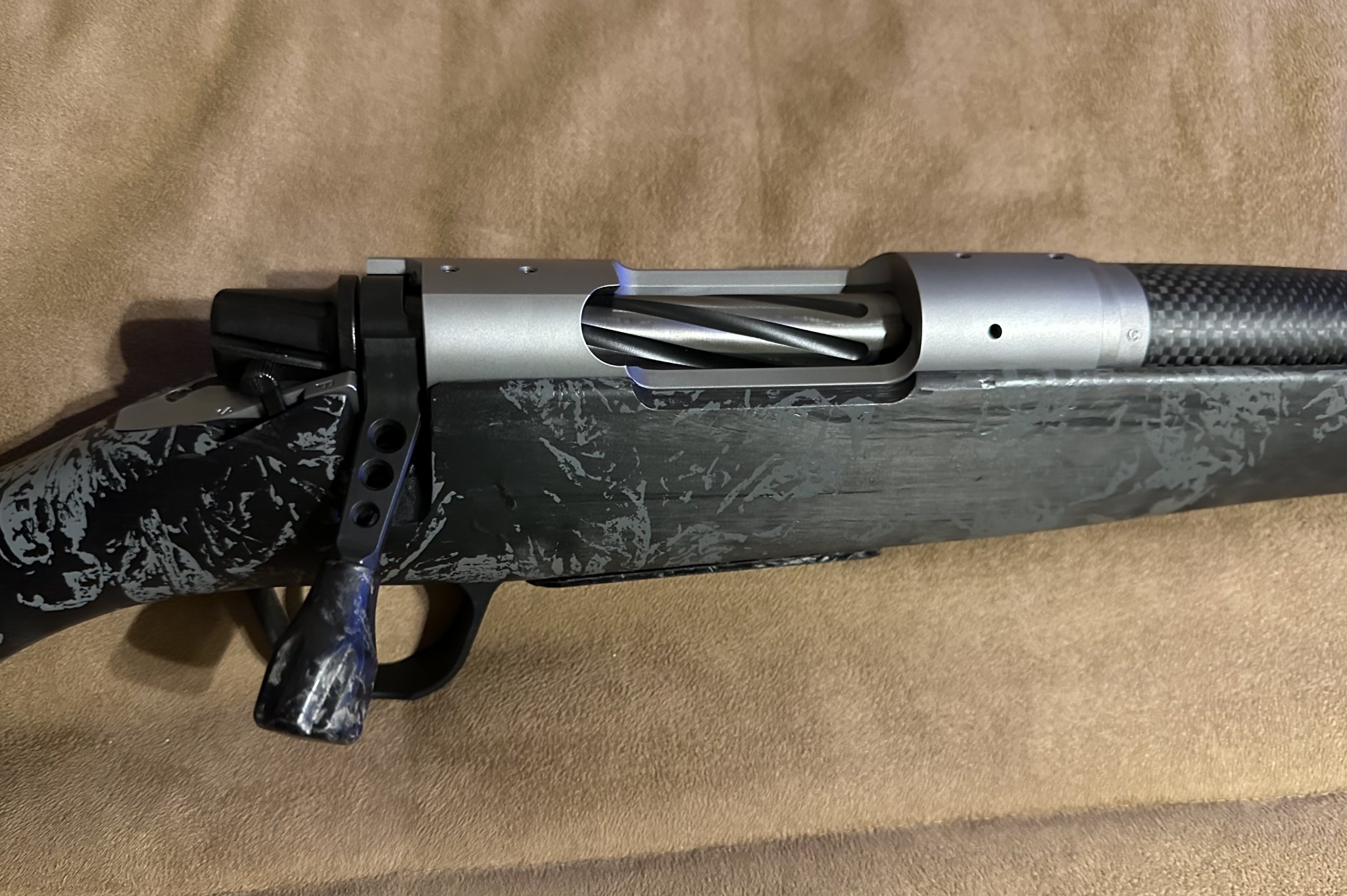

Christensen Arms Ridgeline FFT 20” 7mm-08 Rem. This thing weighs nothing!
Reactions: Modoc
Reactions: hseII and FuhQ
Dayum! Now that would kill the 6.5 itch that I’ve been having! What would be one more 7mm-08 when you are already loading for 5 others?🥴
I’m looking forward to the range report on this one.
I have to order a base for it, and then I'll slap an extra scope on there for now, and start working up some loads for it. Probably going to run the Berger 175 Elite Hunters, since it's a 1:9 twist. 😏 I'll probably hit up the range this upcoming weekend if my base shows up in time.

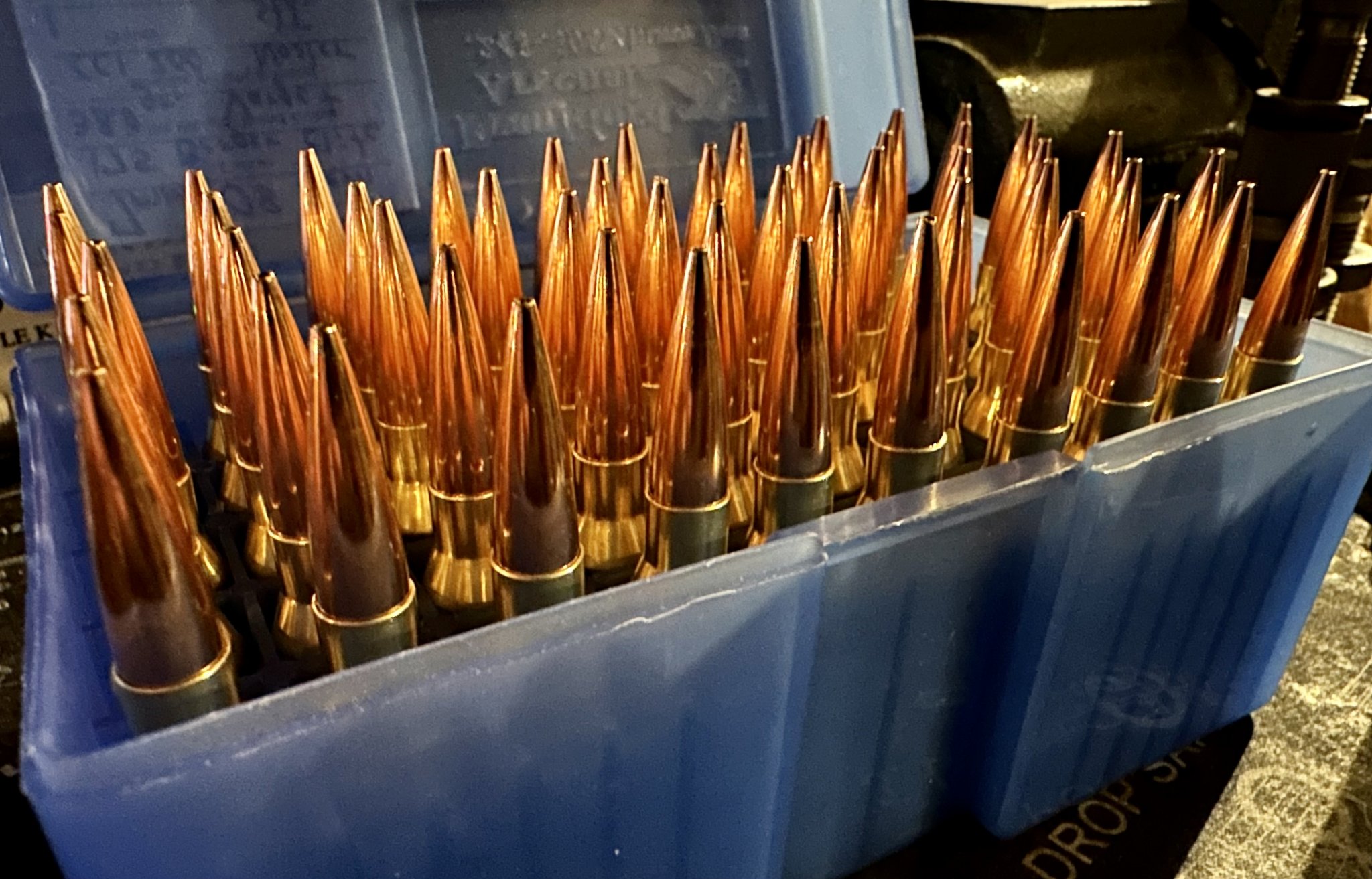

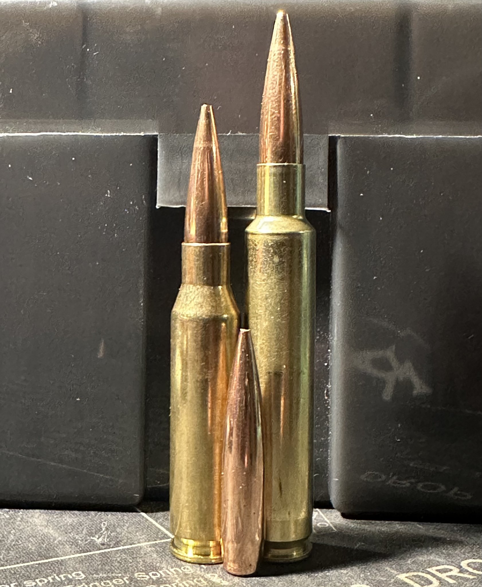

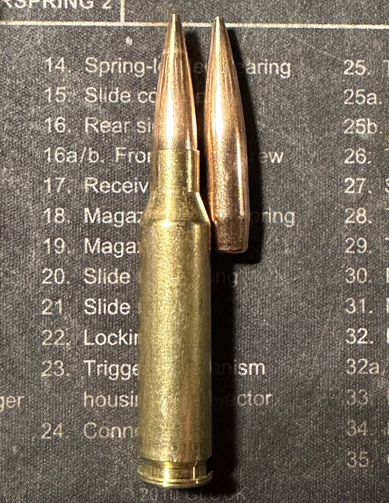

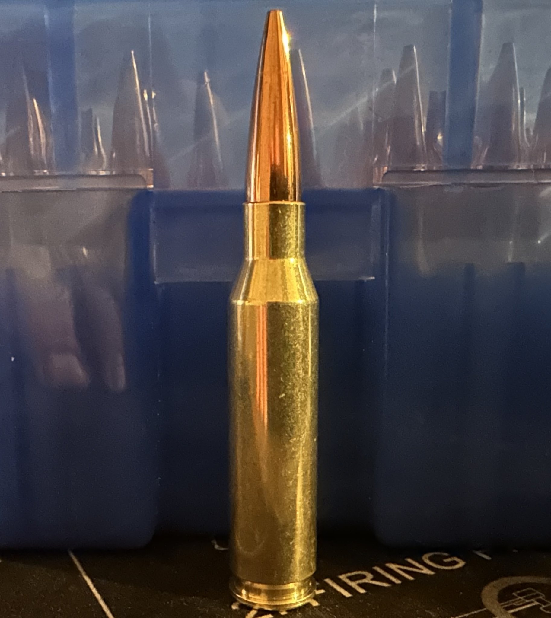

Well... They're loaded, but I won't be able to test them until next weekend thanks to my range deciding to close today and tomorrow (when I'm off work 🤦🏼)... So, they're not opening back up until this coming Friday (they're normal days are Fri-Mon only). So, it will be Saturday at the earliest, maybe Sunday, depending...
I loaded up some 140 Accubond test loads over 10 years ago for my old Ruger M77 MKII All-Weather Ultralight Mountain Rifle in 7mm-08, but never tested them... And I found them in my dad's safe when he passed a few months ago. And after purchasing a more modern 7mm-08 this past week, with a 1:9 twist, I decided to try some Berger 175 Elite Hunters in it, since I'm having great results in my .280 Ackley 1:9 twist. Unfortunately, they are VERY long, and I had to seat them 0.130" off the lands just to get them short enough to magazine feed (this is a hunting rifle, so I need this function). Luckily they're Hybrid ogive, so hopefully they won't be SUPER picky, and I'll find a node that will work well for this rifle. I'm loading them with Varget in new Nosler brass, with CCI 200 primers. Hoping I find a good load, or else I'm going to have to backup and punt...
Next to my .280 Ackley 175 Elite load…
Profile to show how deep they are in the case at magazine length.
140 NAB & 175 Elites ready for testing…
Reactions: hseII and Modoc

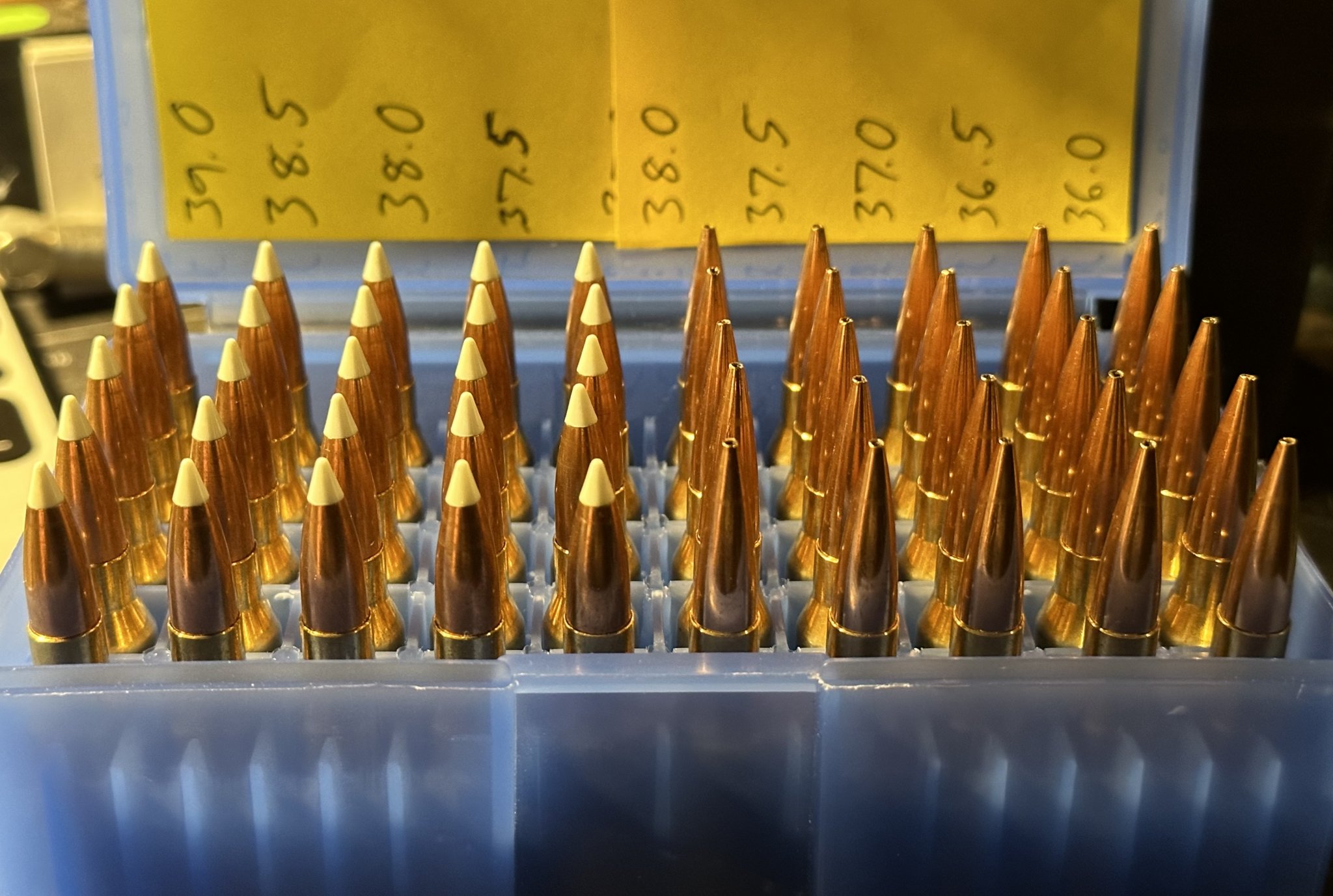

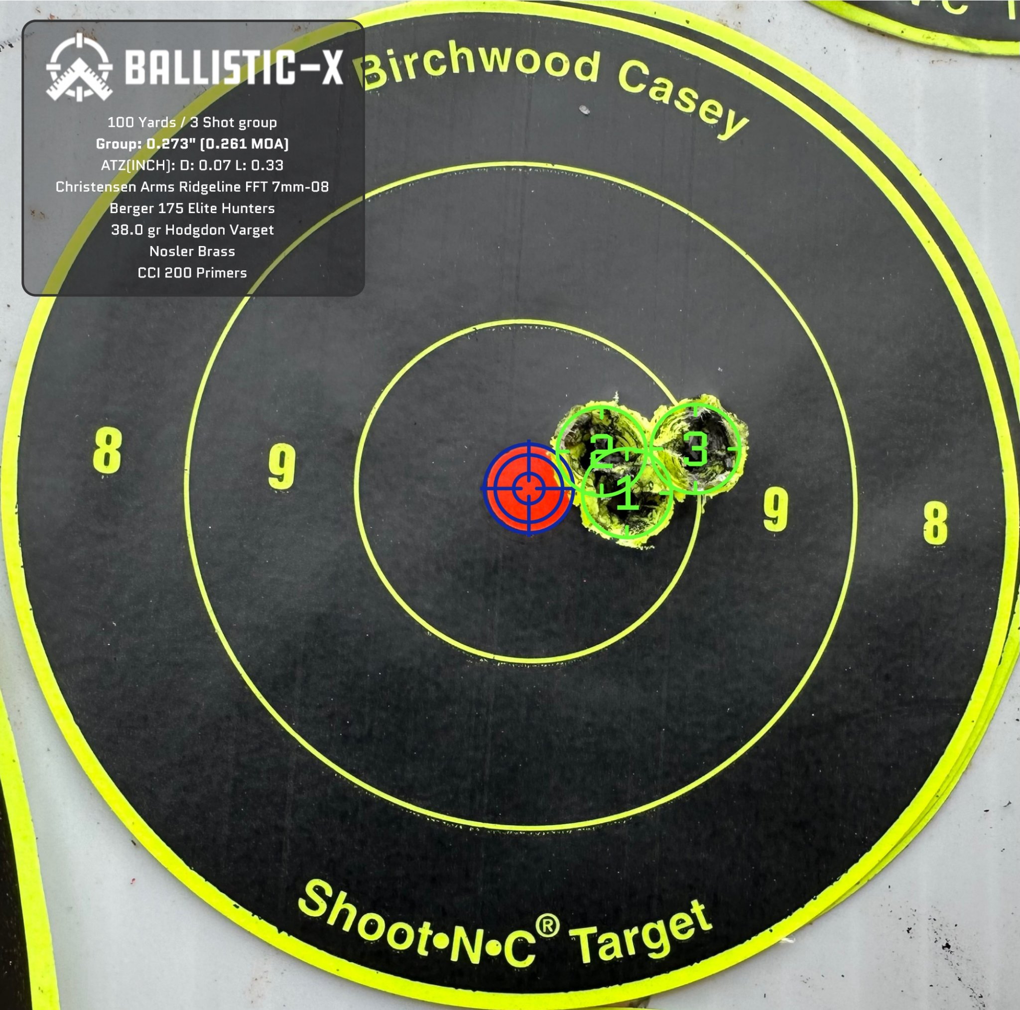

Think I found a great node with the Berger 175 Elites in my new 20" Ridgeline FFT 7mm-08... No pressure signs other than slightly flattened primers, no ejector swipes, so I'll probably stick with 38.0 grains just for that extra 1/2gr. of velocity. 😏

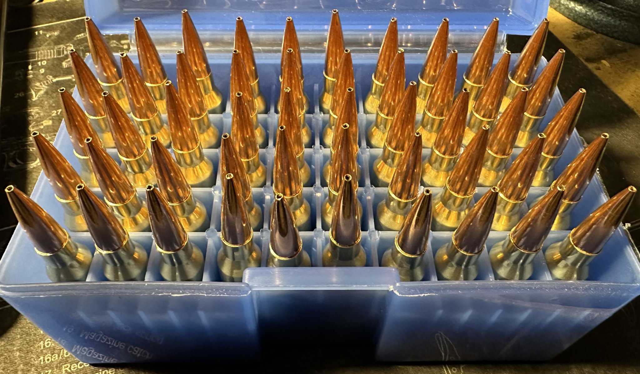

Loaded my first batch of the hunting ammo for the 7mm-08 w/ the Berger 175 Elites last night. I will be chrono’ing them this weekend to get my real-world numbers with the can on the end. I decided to go with the even 38.0 grains of Varget, because the group was only 0.020” larger, and that extra 1/2 grain will give a small velocity increase with the short 20” barrel. 👍🏼
Reactions: XTREM HTR16

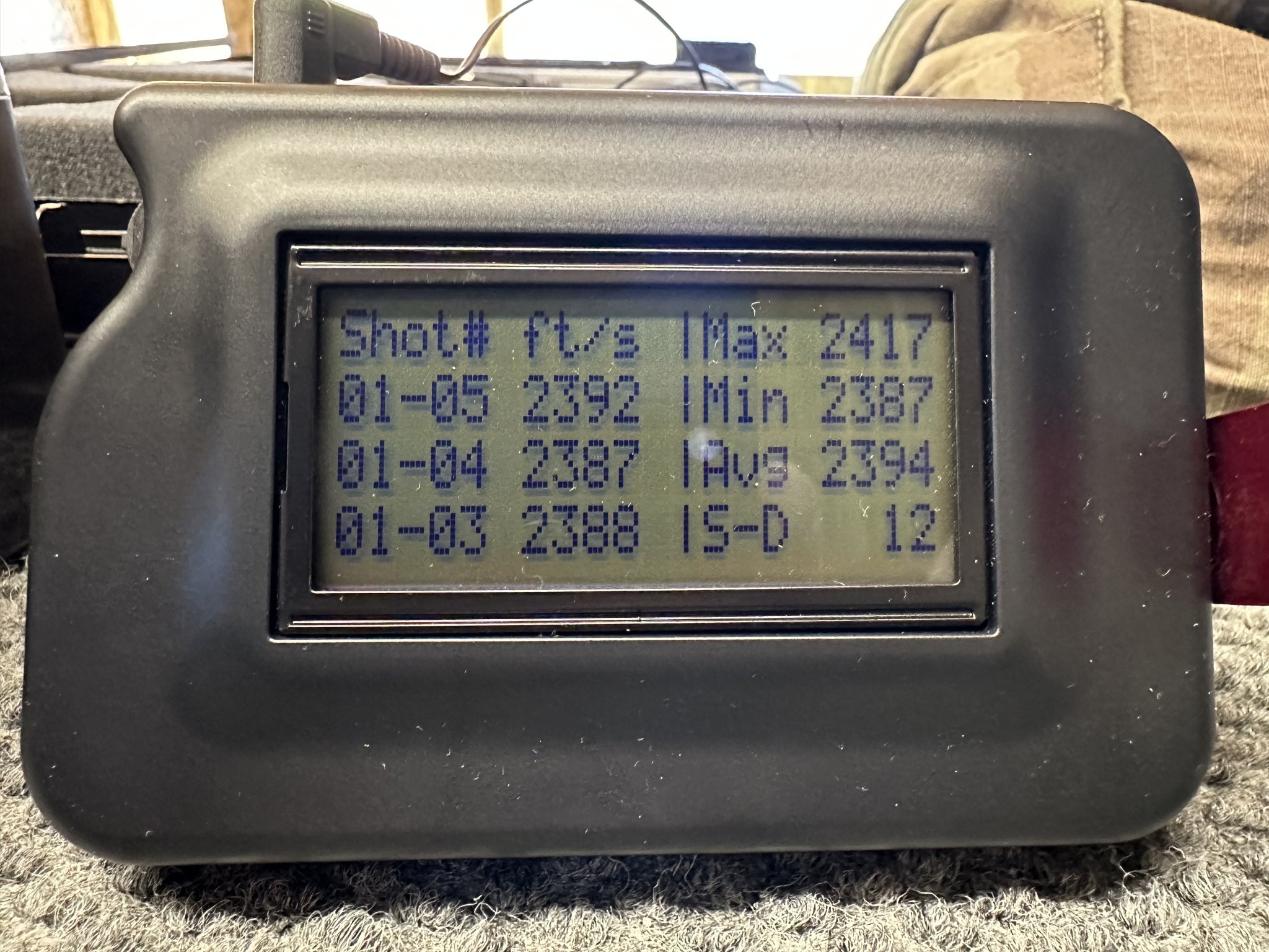

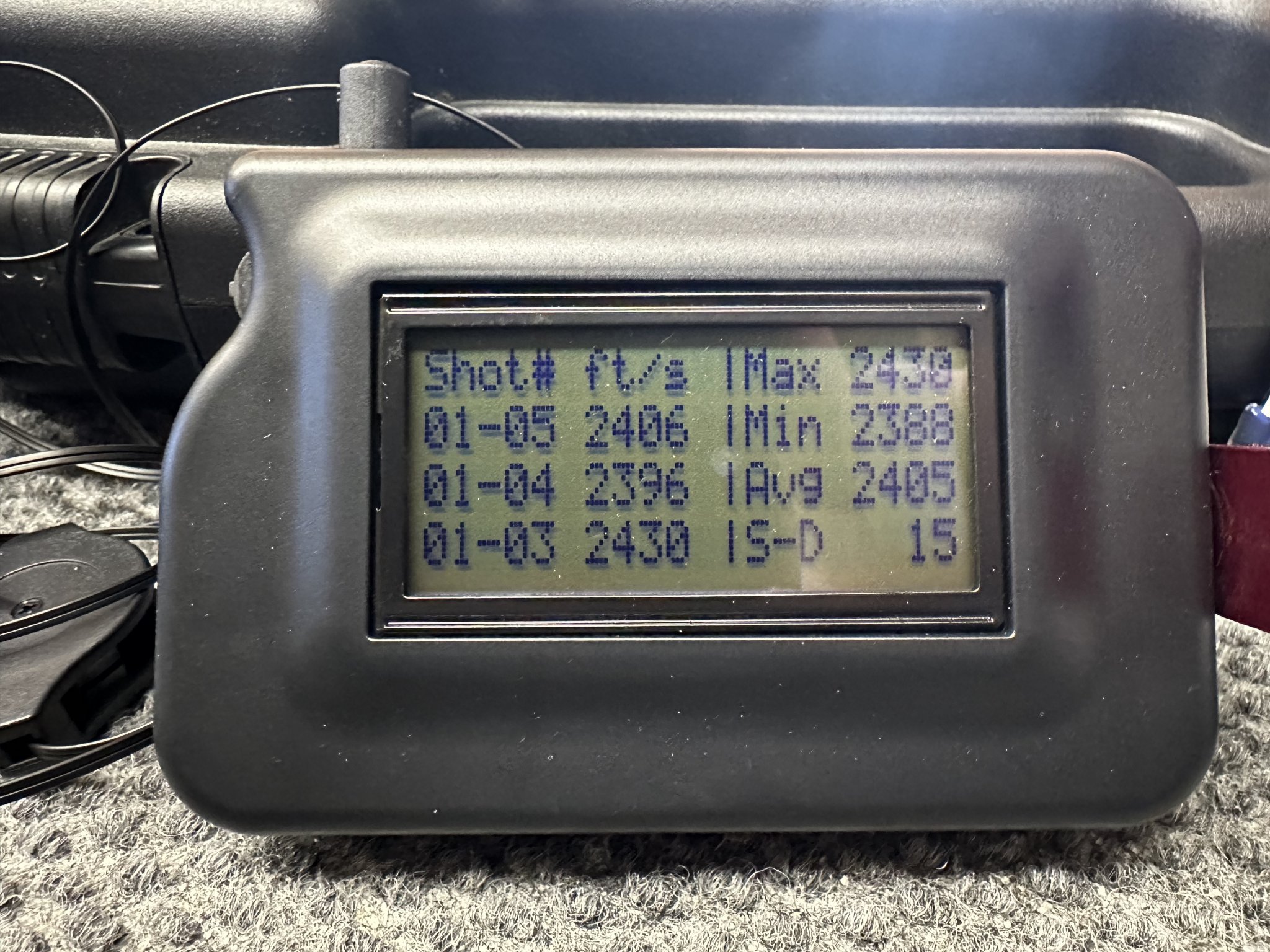

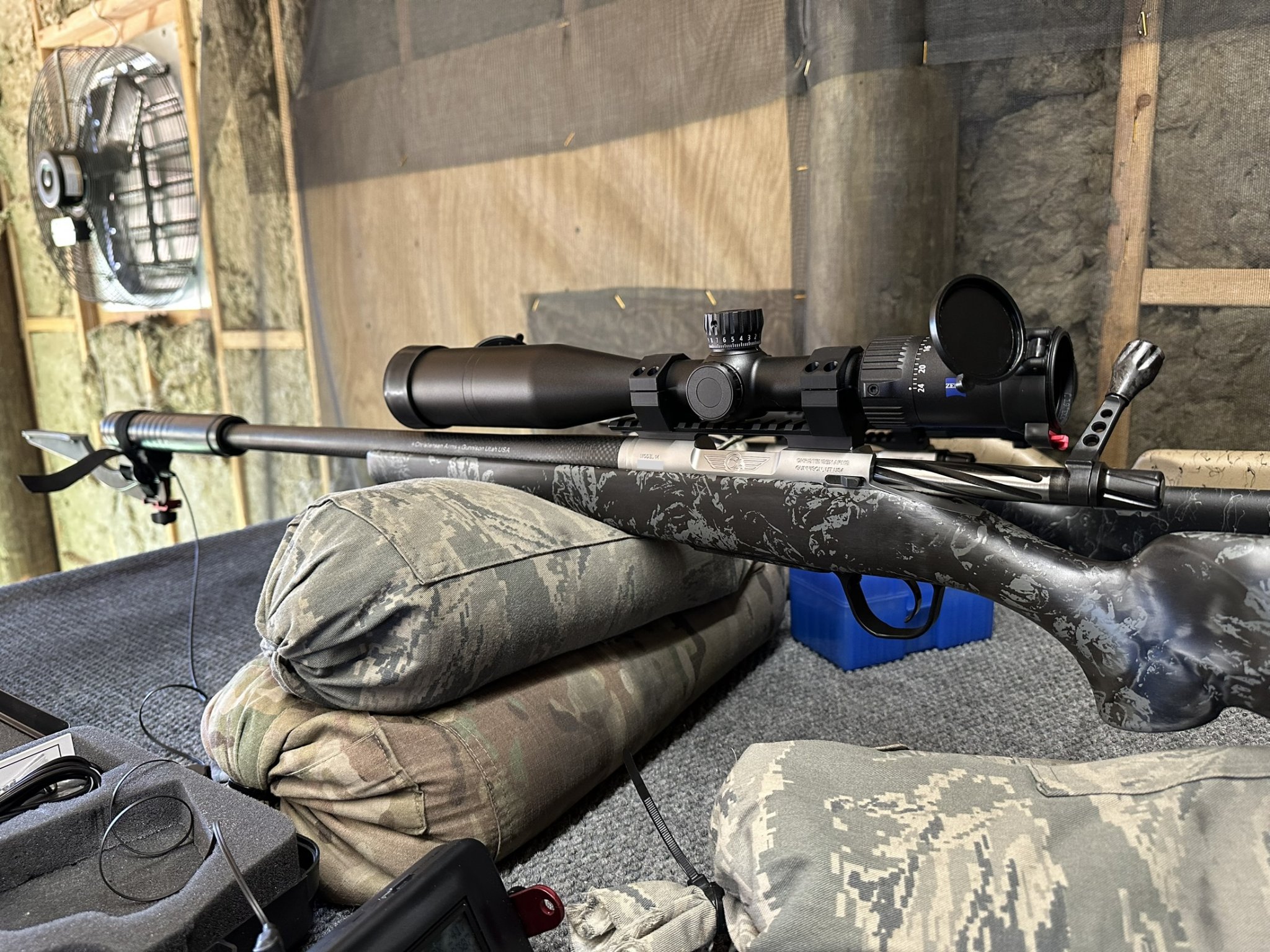

The barrel on the CAR FFT 7mm-08 is still breaking in, as it’s only had about 75 rounds down it so far…So it’s still getting the grooves smoothed-out. Despite group sizes, I can tell because my ES and SD are still kind of high (for me)…But it’s putting down some great groups with this Berger 175 Elite load!
Yesterday’s testing…
Today’s testing…
View attachment 8049602View attachment 8049601
Today’s testing…
View attachment 8049603View attachment 8049604
What Chrono are you using?

I have a 20” 7-08 1:8 that I ran 180 eldms up to 2590 at Hodgdon book max for a 175. They don’t show data for 180’s unfortunately, 2.950 coal, .020 off lands in a saami chamber. OCW test produced a load around 1 gain below book max, with velocity still around 2530.
162 eldms were at 2770 at book max, 2.930 coal, .020 of the lands. OCW test also showed promise with charge weights about 1 grain below book max, velocity was still around 2720.
This was in Alpha brass, and had no signs of pressure on the brass and perfect extraction. I ran it up a little higher, but velocity started to spike about .5-1 grain over book for both bullets.
Groups were in the .6-.8 range. I might try messing with seating depth a little, but for a hunting gun it would be fine as is.
