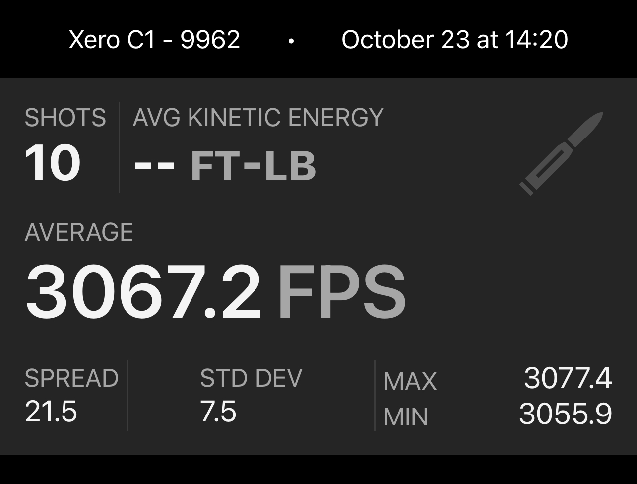

For example (just making up numbers that are common):
It's mathematically impossible to have a 5sd and a 15es. Your sample ES might be 15, but with a 5sd, your ES will be at least 30fps in the long run. And a very, very small amount of the time it will go up to 40fps and sometimes a bit more (provided that your sd is actual 5).
So, anytime anyone references an ES that is less than 6x their SD, they almost assuredly don't have the proper understanding of how to use the numbers from their chosen chronograph.
If we take your 2sd over 5 shots and extrapolate it properly, it's just as likely that your SD is 6fps that it is 2fps. Which would give you up to an ES of 36fps. And with sample sizes as small as 3 and 5 shots.....there's a very likely chance it will be higher than that.
When we choose not to properly extrapolate our Sample SD (ES is all but meaningless.....so much so that almost no one outside of the shooting industry cares about ES), we end up either wasting components or having a false sense of exactly what can/will happen over the life of a rifle/barrel.

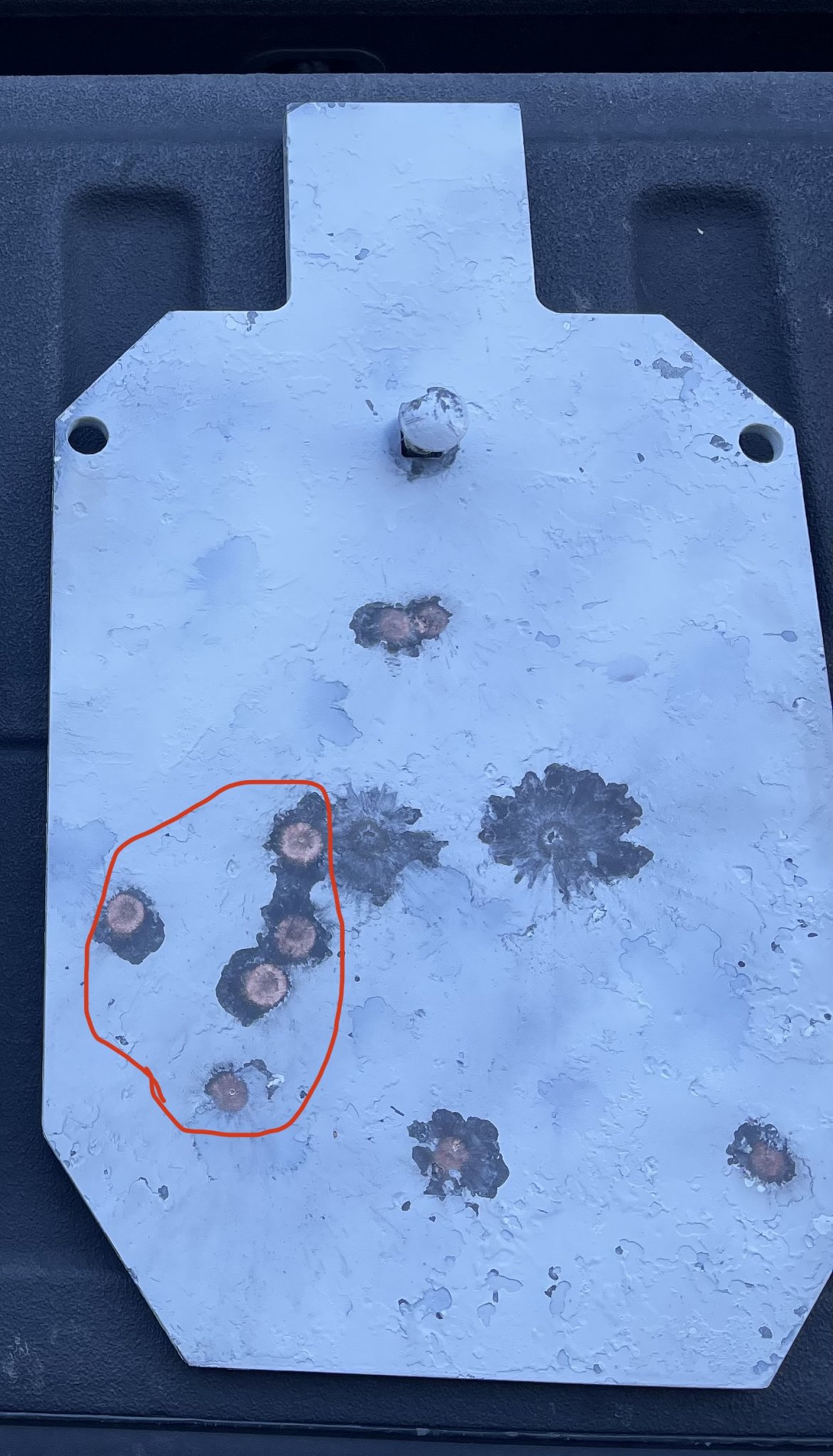

Ok let’s get this started because there ain’t shit out there and this was an absolute headache to load for;
Surgeon 1086 LA
Proof carbon 24” 1:8 w/ 419 Hellfire
MDT HNT 26
TT Diamond
Mason reamer
69.4 - H1000
FED GM215M
ADG Brass (fired, bumped .003)
160gr McGuire Copper Rose Solid
-.020
SAC dies
Zero press
The flier was 100% me. Was shooting a 2 stage 308 waiting for this to cool down, then jumped back on the gun which has a single TT diamond at about 1.5 lbs. I was definitely not settled as I started to pull the “slack”
560 yard group in red circle on 2/3 ipsc (11x16)
Hopefully this is helpful for someone.
Surgeon 1086 LA
MDT HNT 26
TT Diamond
Mason reamer
69.4 - H1000
FED GM215M
-.020
SAC dies
Zero press

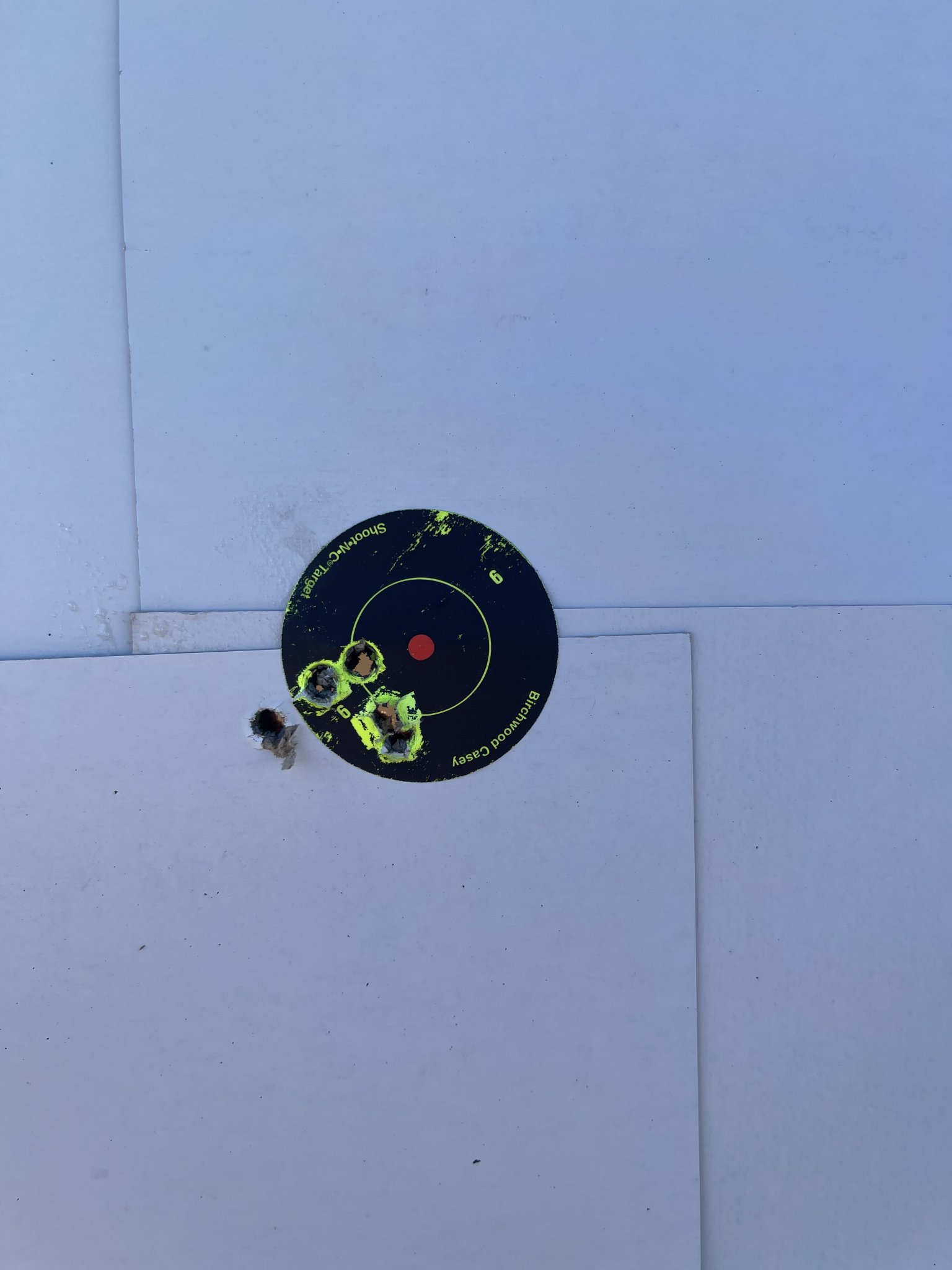

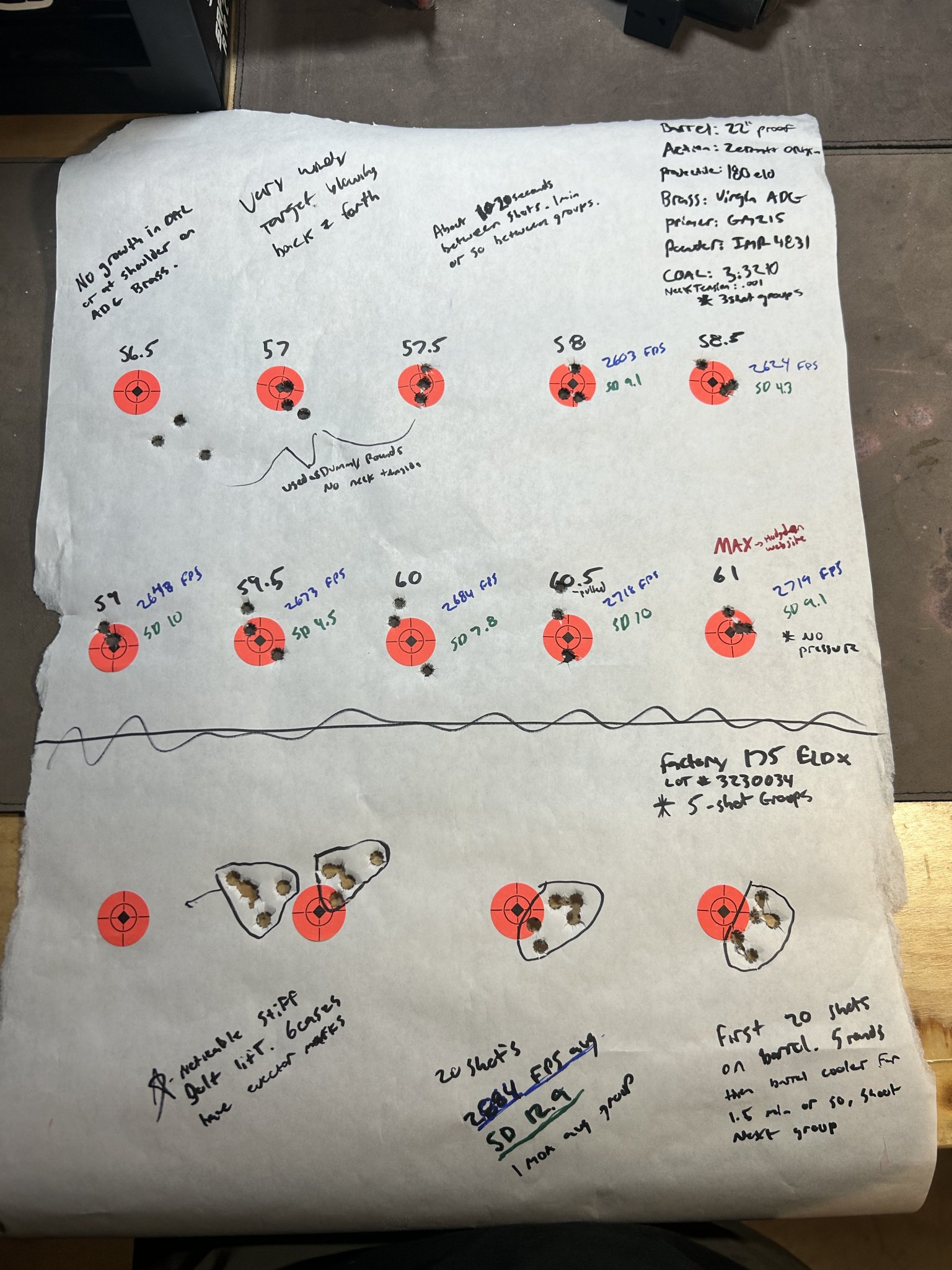

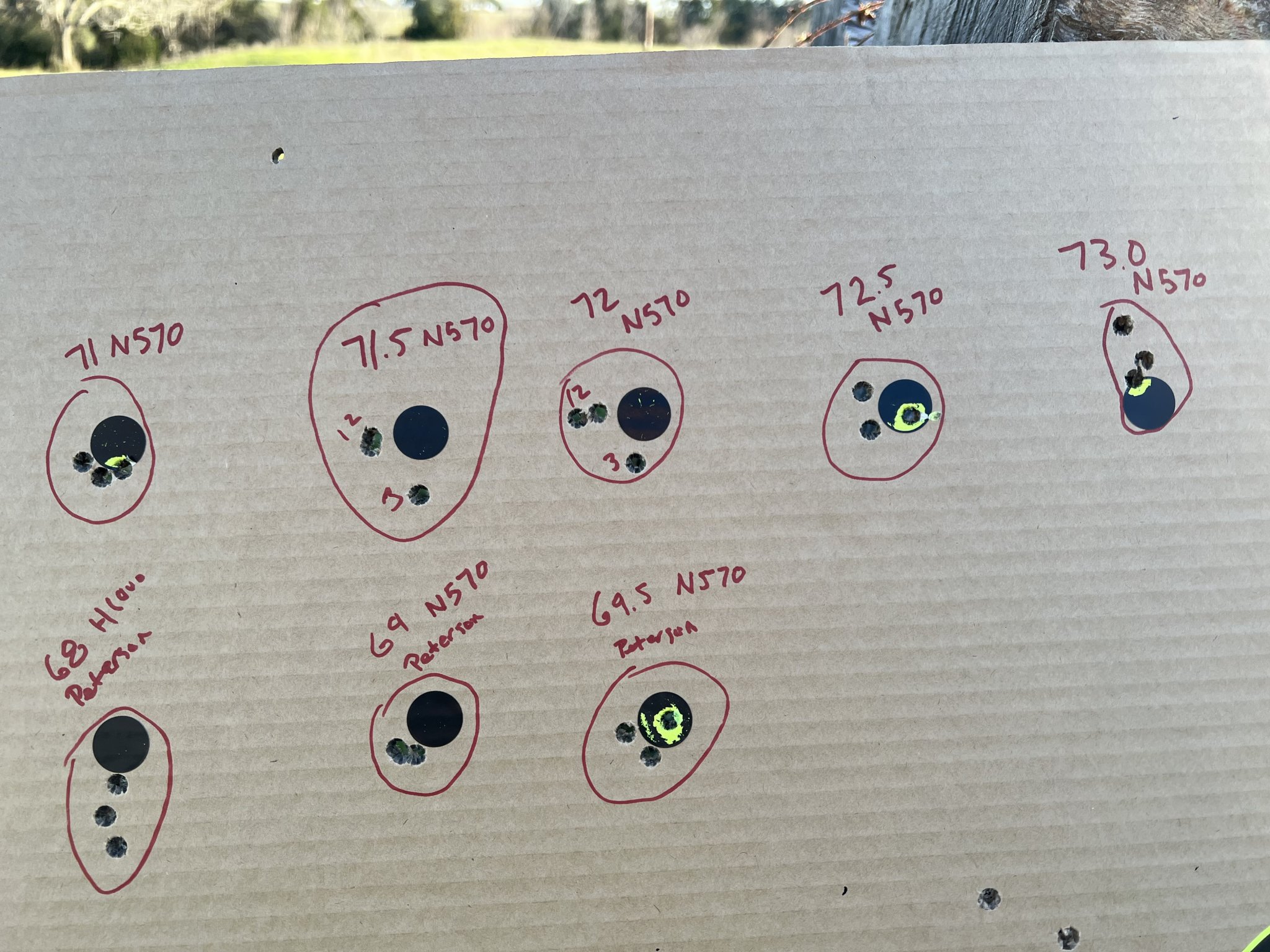

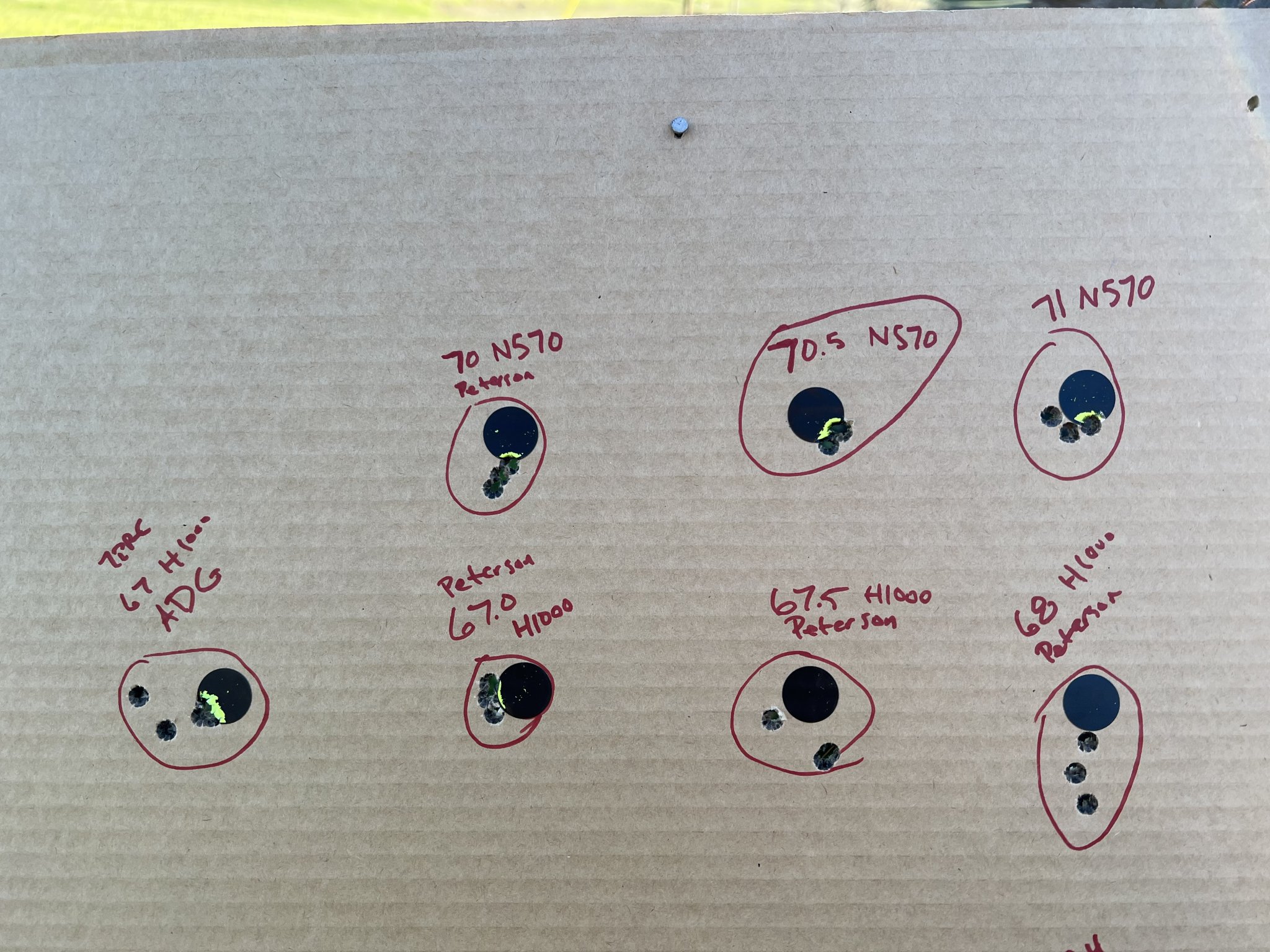

First 50 rounds down the barrel today. Instead of typing too much below is a photo of target with some details.
Of note a little more than half of the factory 175 ELDX I put through it had noticeable stiff bolt lift. Lot number in the photo. I still have 2 more boxes of it.
I have a jug of IMR4831 sitting around that I picked up during the Covid era and a 100 gm215 primers from a diff lot I need to burn off. Figured good use of the primers, and powder to get a firing on all the ADG brass I have and get the barrel broke in/sped up.
Plan of attack is shoot all the factory 175’s I l have left and the remainder of the IMR4831 and gm215 primers, check velocity to see if barrel has sped up and then start a load work up with H1000 and H4831sc.
I had pressure issues with some of my first factory loads also. The ELDM loads in particular. Check out the 7mm cartridge guide on long range only or on YouTube. My favorite load is with H4831SC. Good luck!

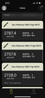

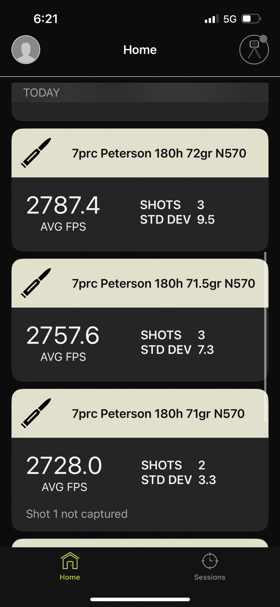

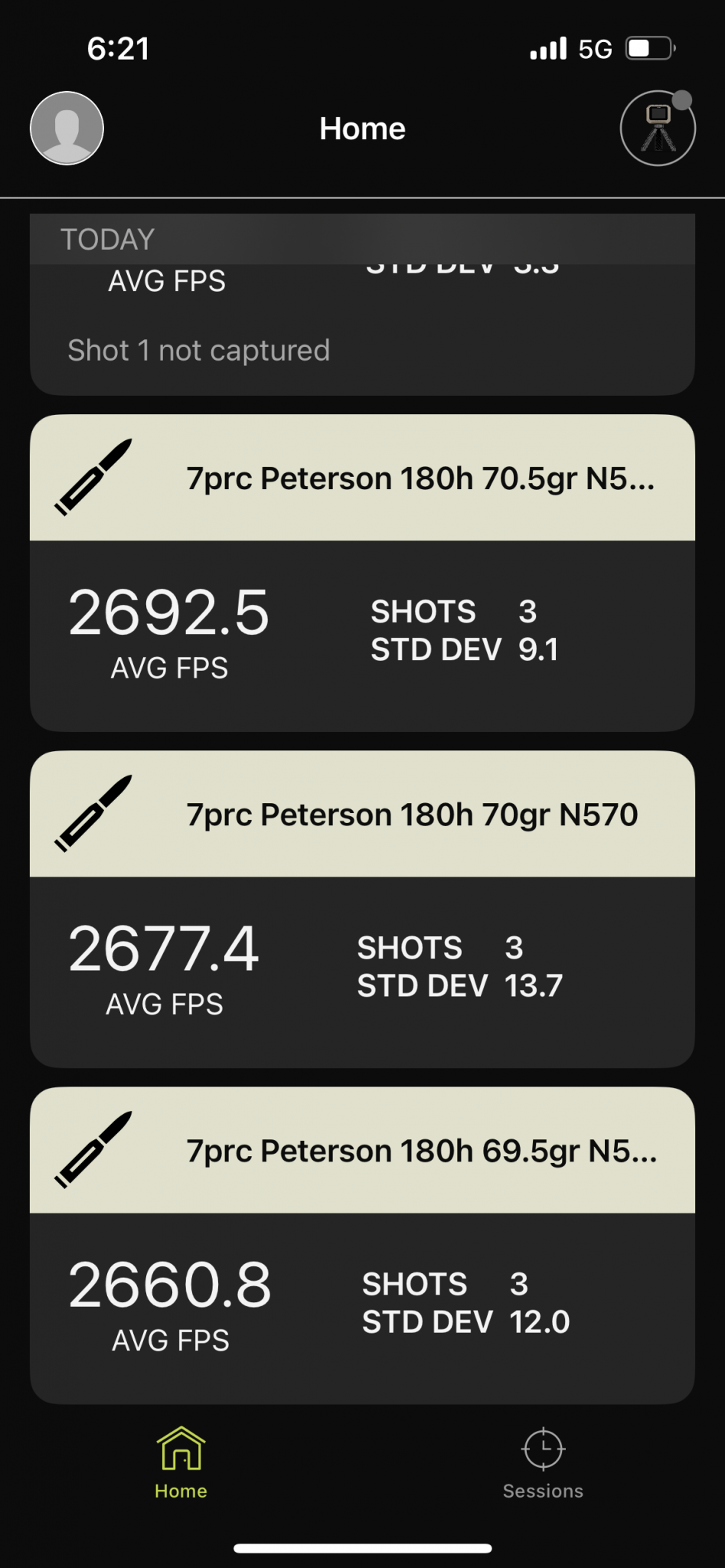

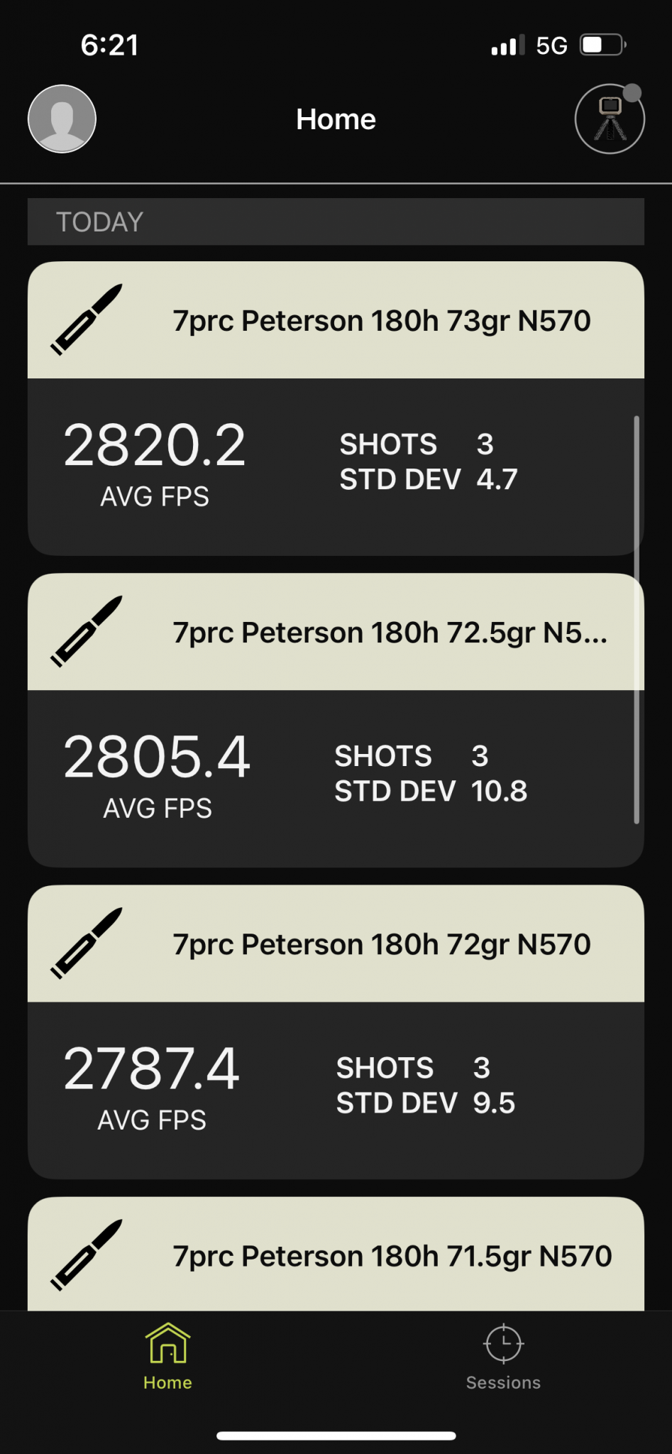

Following up with my N570 results.
18” barrel, 2820fps with a 180 hybrid.

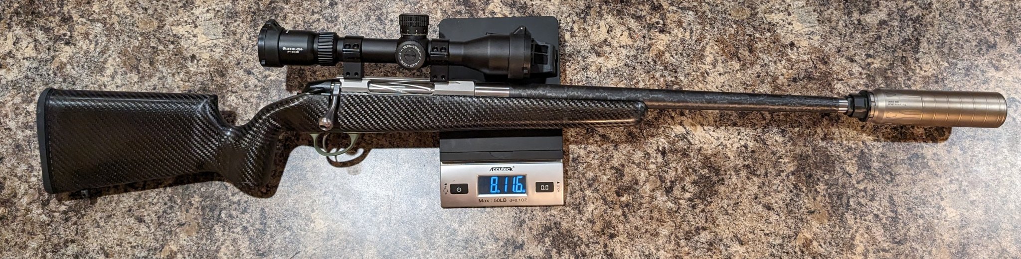

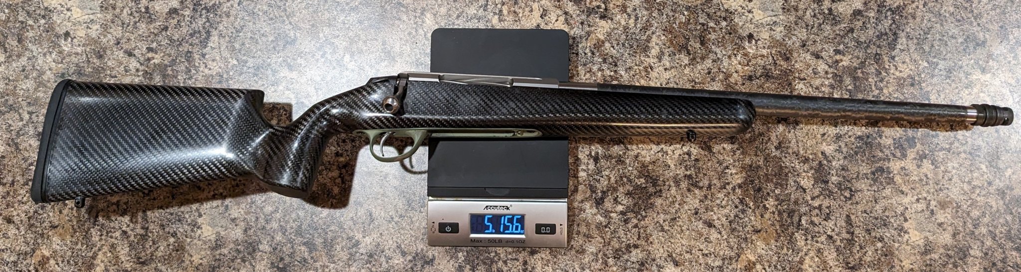

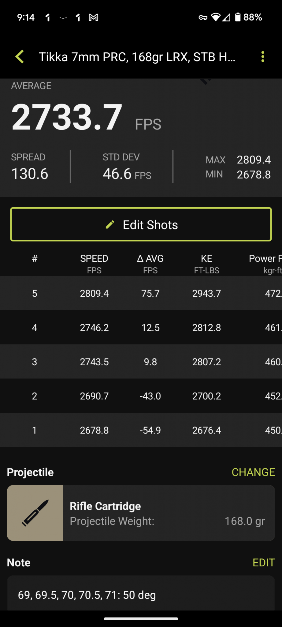

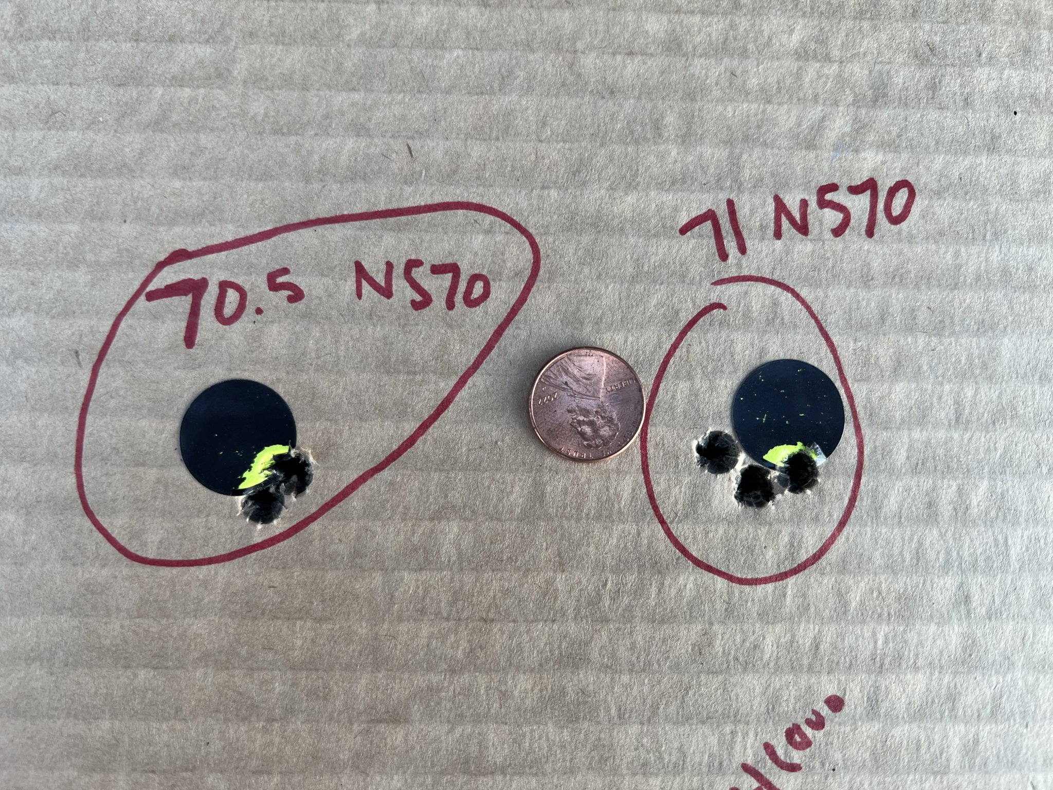

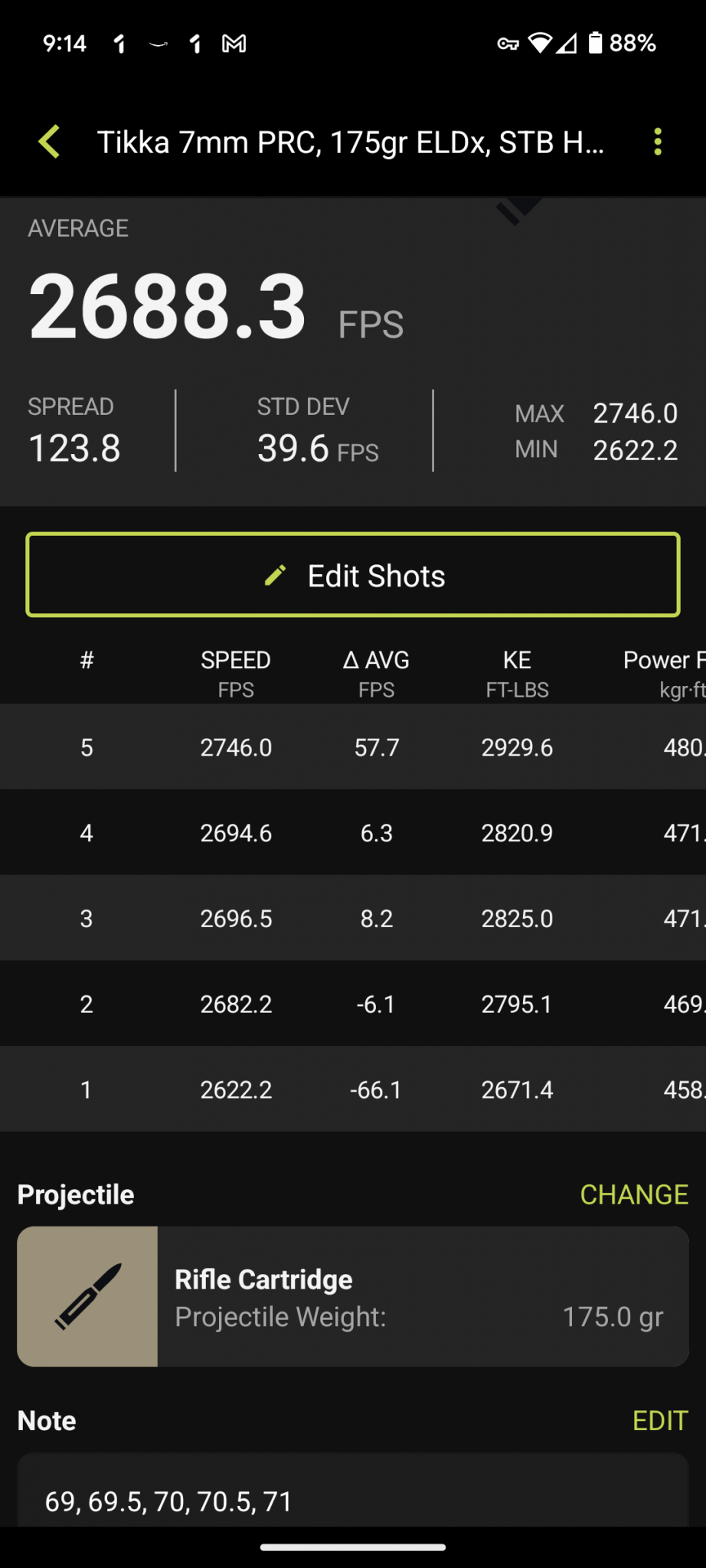

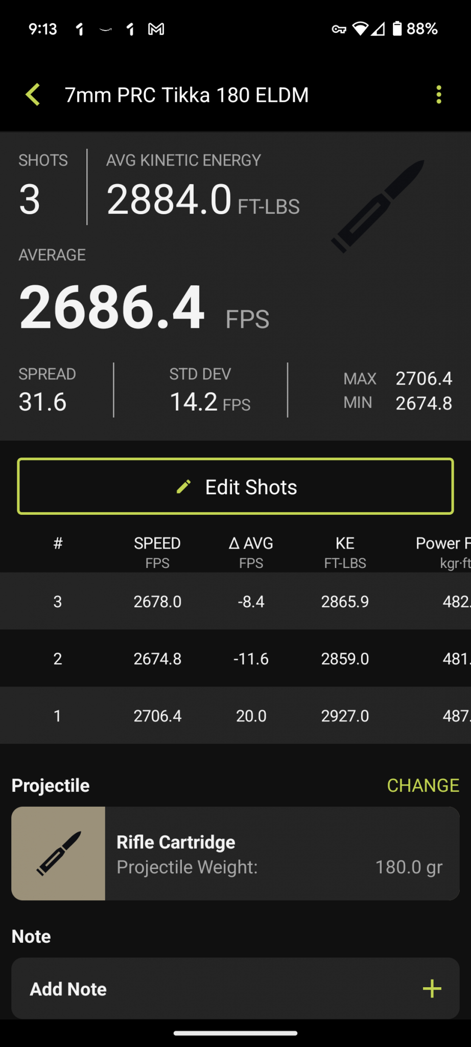

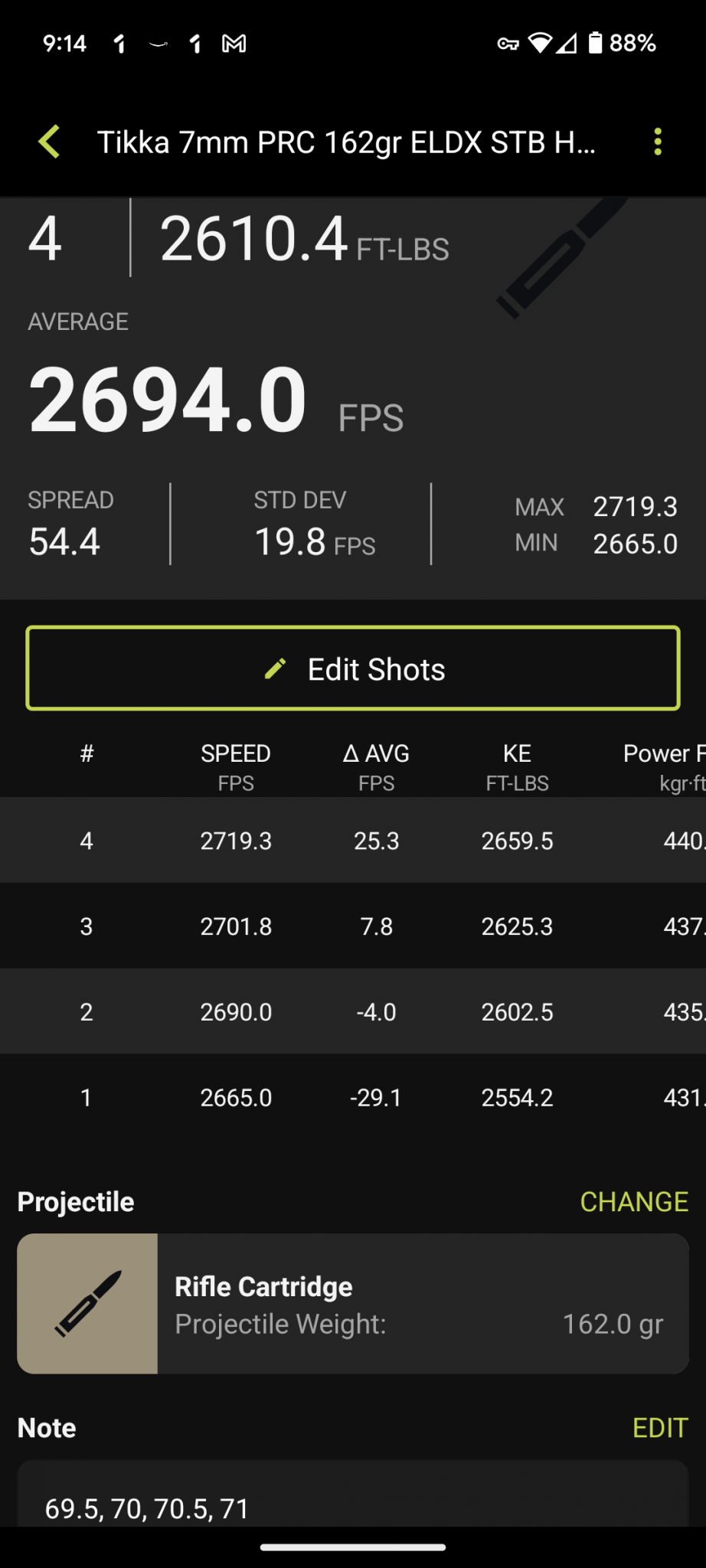

I finally got my Tikka 300 WSM converted over with a 19" Carbon six 7mm PRC barrel and took it out for the first 20 or so shots.
I shot some 180gr ELD Factory which turned out pretty slow, then shot spreads with 162gr ELDx, 168gr LRX and 175gr ELDx and Staball HD.
