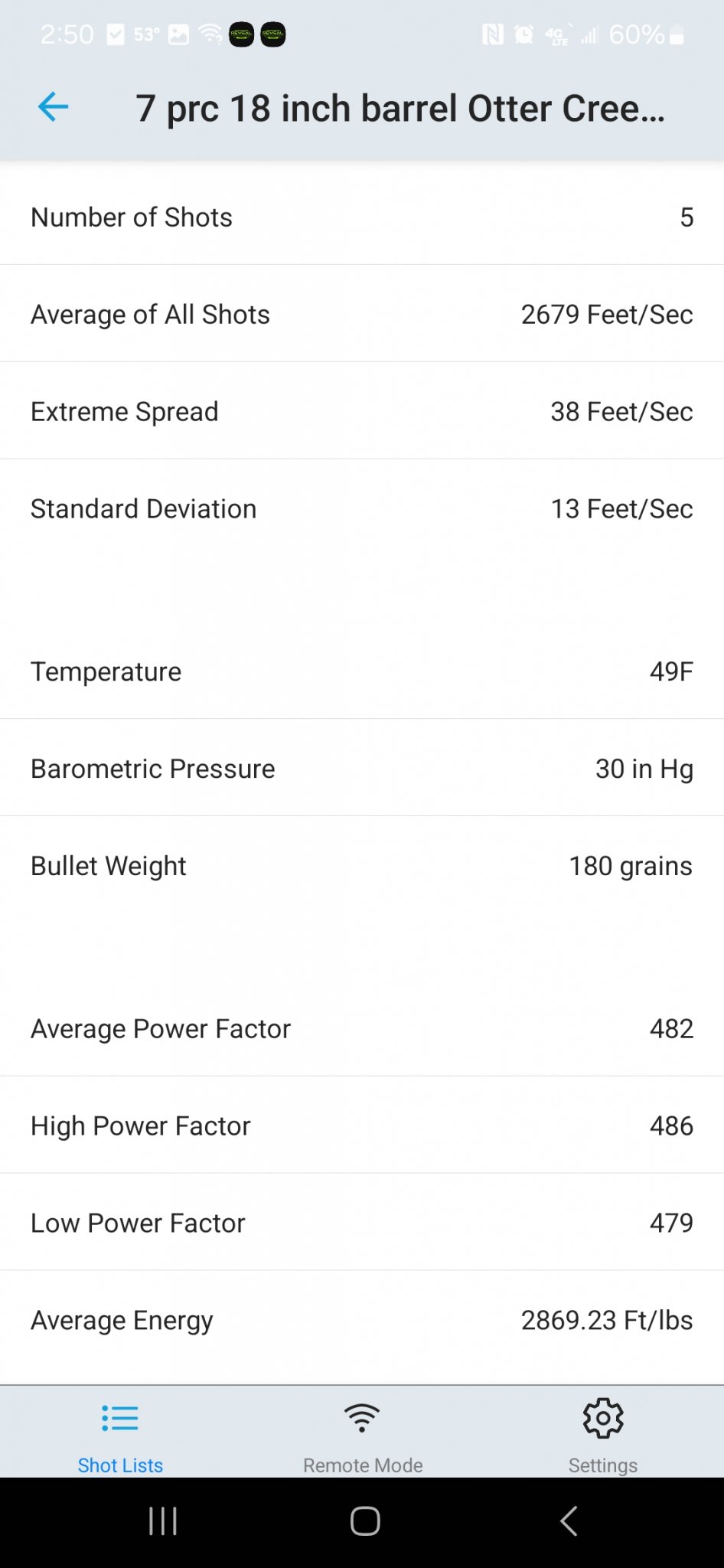

Being a lefty not as many options as what I'd like. Wanted a short barrel an stayed budget friendly since I was gonna cut it. Savage Apex Hunter. Weight is with Otter Cree Labs Polonium 30 on the end. Gonna do some development this week with 4831sc,560,RL23 an 565 maybe RL26. Peterson brass 162ELDM gonna use Federal Large rifle match an magnum match. Probably start .30 or .50 off

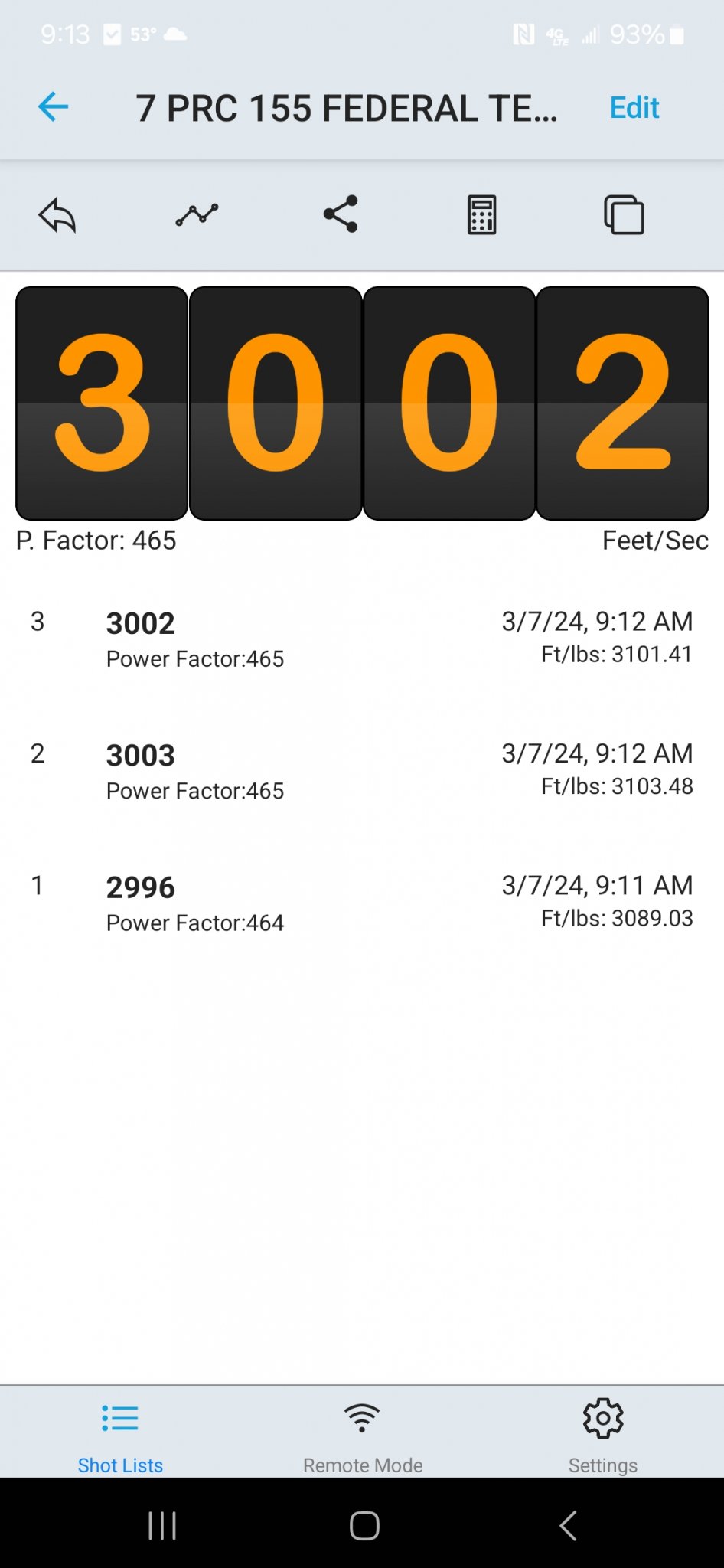

Definitely interested in your results with the 162 ELD-X. I don't have RL26 on hand but plenty of H1000. 20" barrel on your rifle?
18 inch. I have 2lbs of RL26 I want to see how the faster burning powders do first. If I don't get what I like for velocity an accuracy I'll probably try h1000 an rl26 then I hate to use the 26 lol. I'm hoping does good with the other powders since their more available. I got 3lbs of rl23 already so high hopes for it.

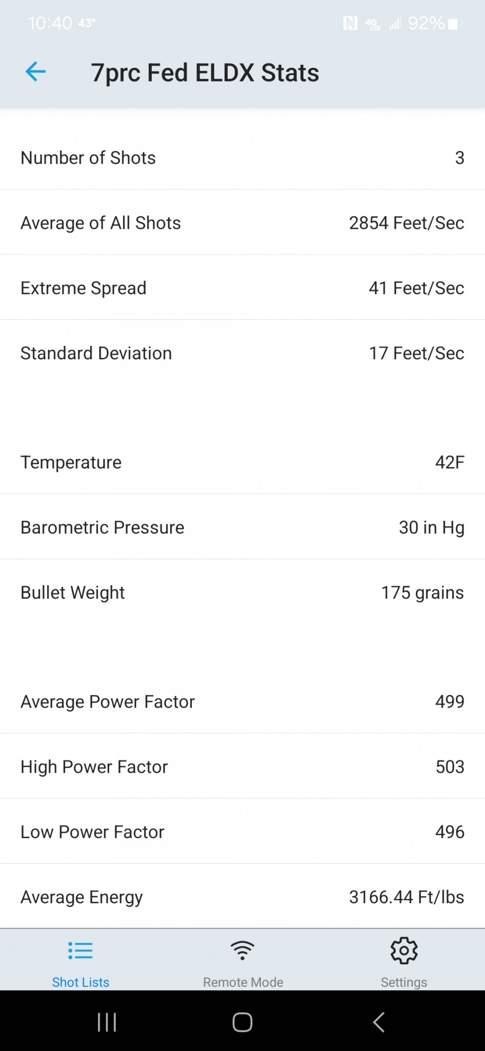

If you don't hand load I'd only buy Federal. 3100fps for 24 inch barrel on box. 18 inch barrel 3000 thats impressive. Testing powders with 162ELDMs this morning working up RL23 an V560 look pretty good over 2800 an no pressure signs. Just under book max.

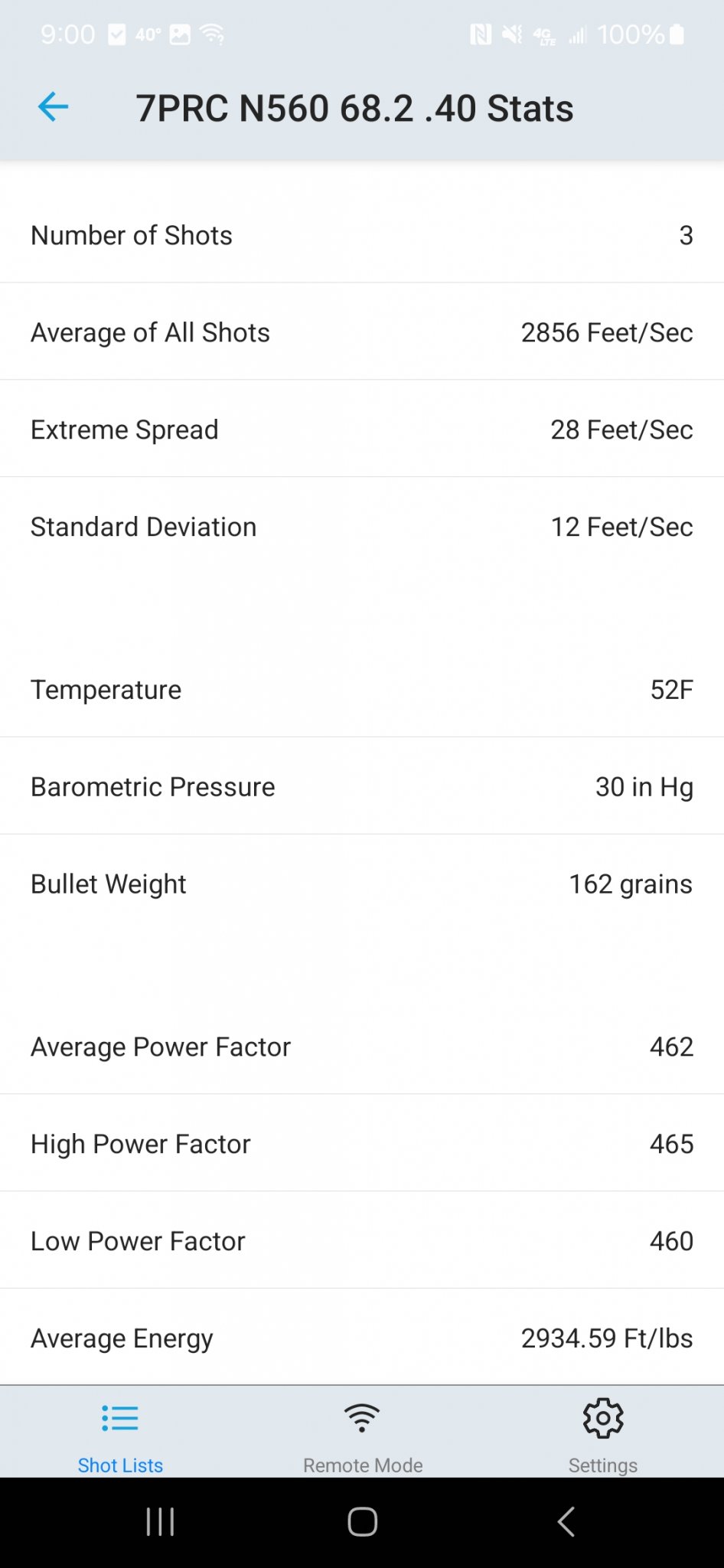

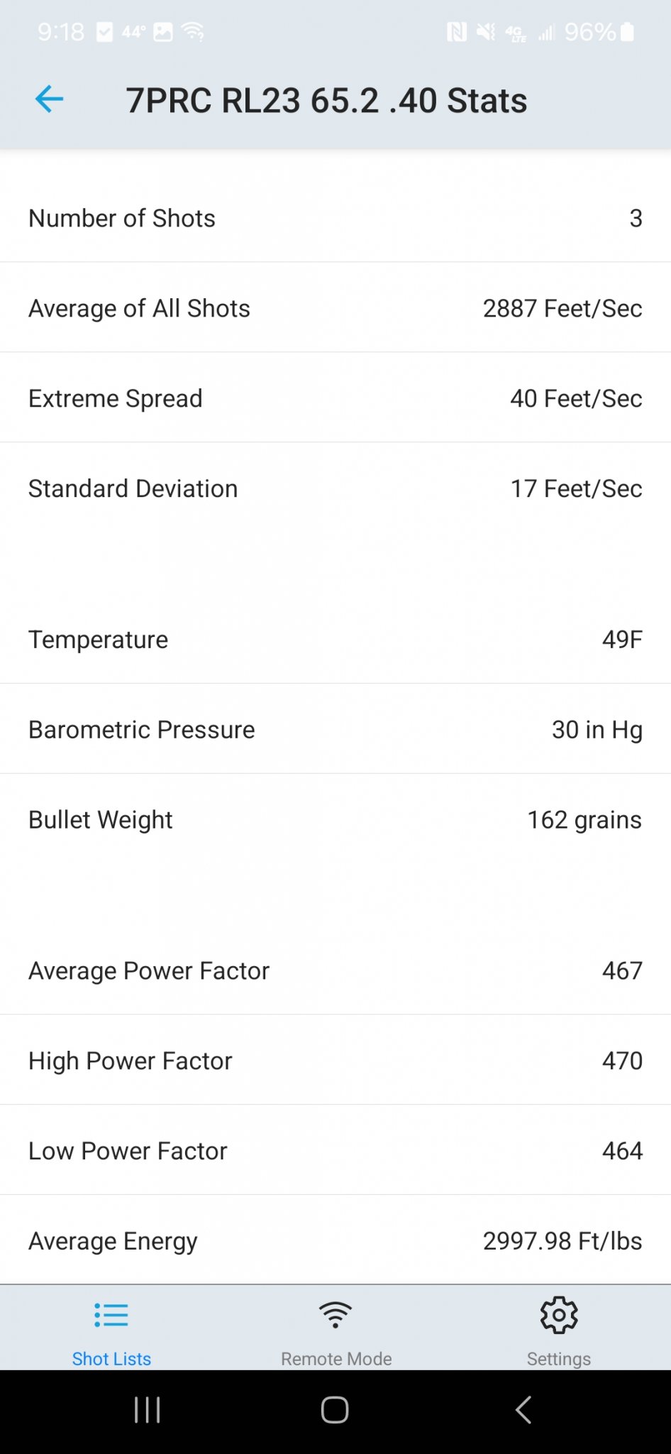

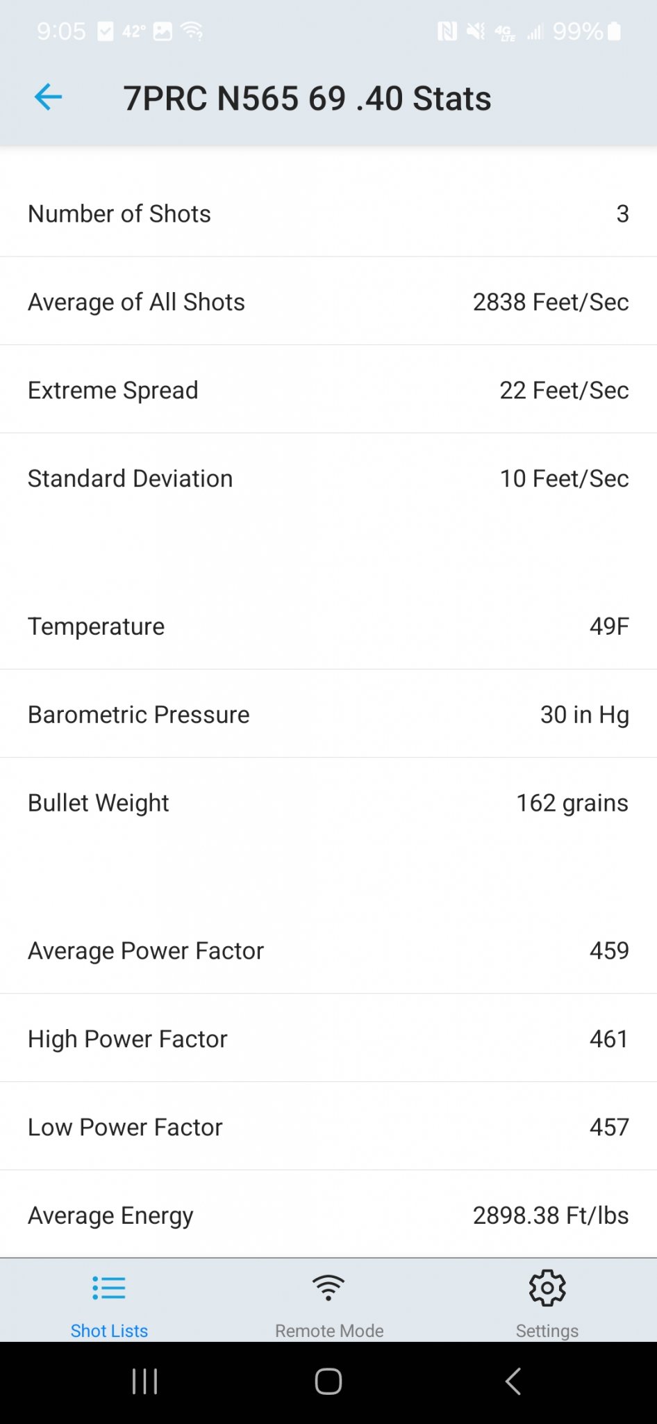

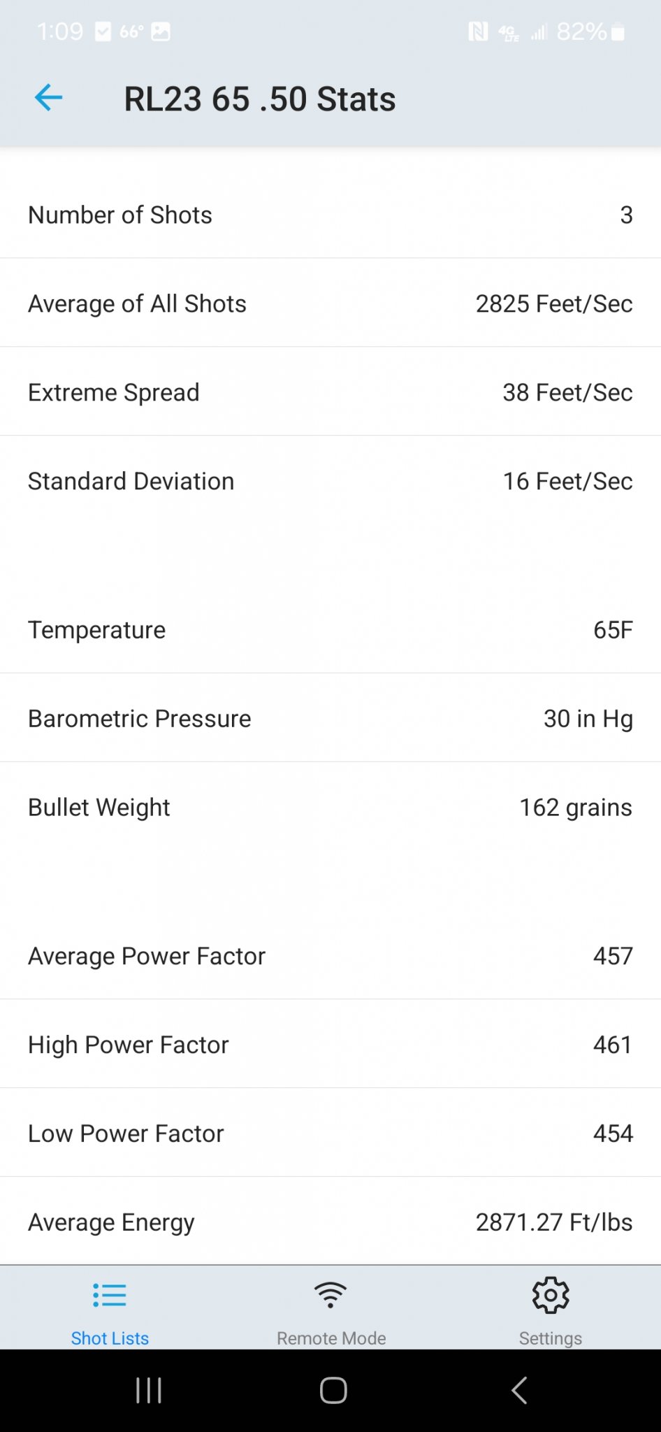

Idk if ita setting depth or short barrel or what but I thought RL26 would of did a little better than 23. Still not accuracy I'm looking for got 139 rounds down barrel now so Idk if it'll speed up anymore I'd like to get it about 3/4 inch. 1 inch has been it so far might be all I get. Federals were about .90 an did decent idk may go out further. Only got ELDx left now gotta clean some brass then try again. Wasting powder an primers that you can't find right now lol

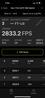

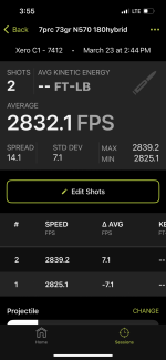

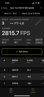

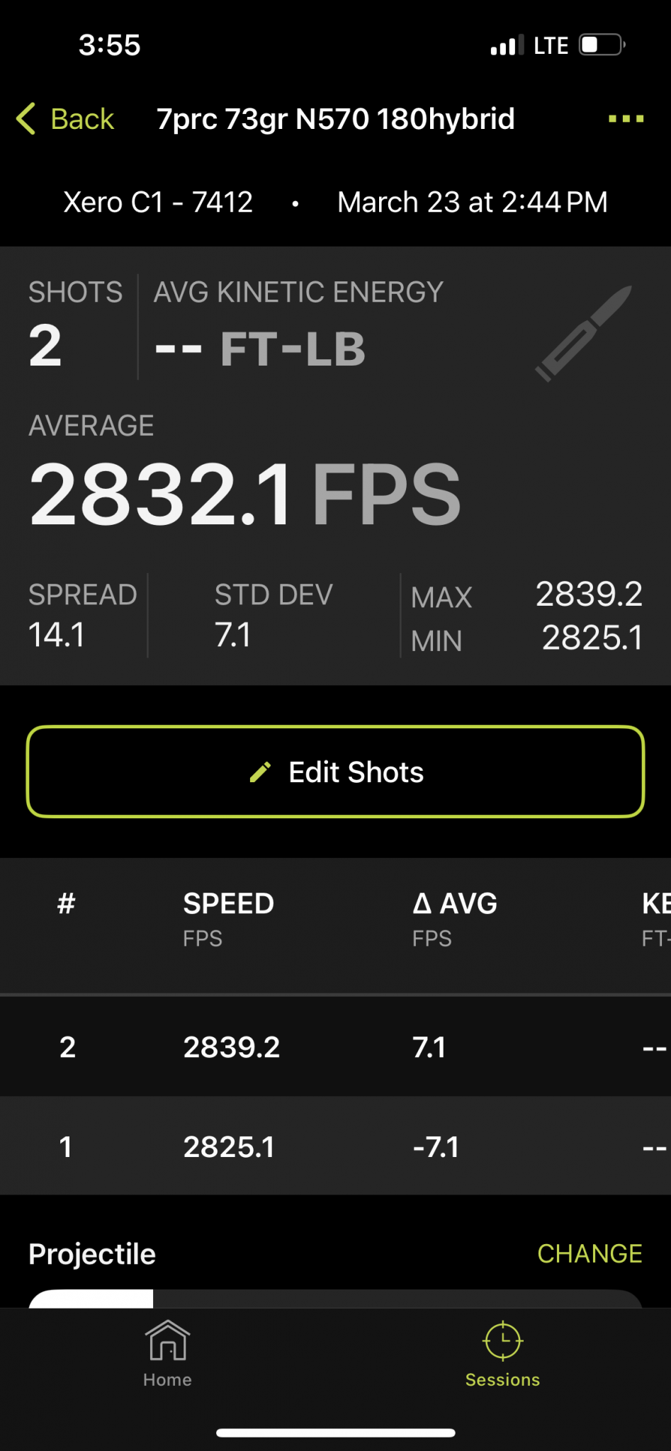

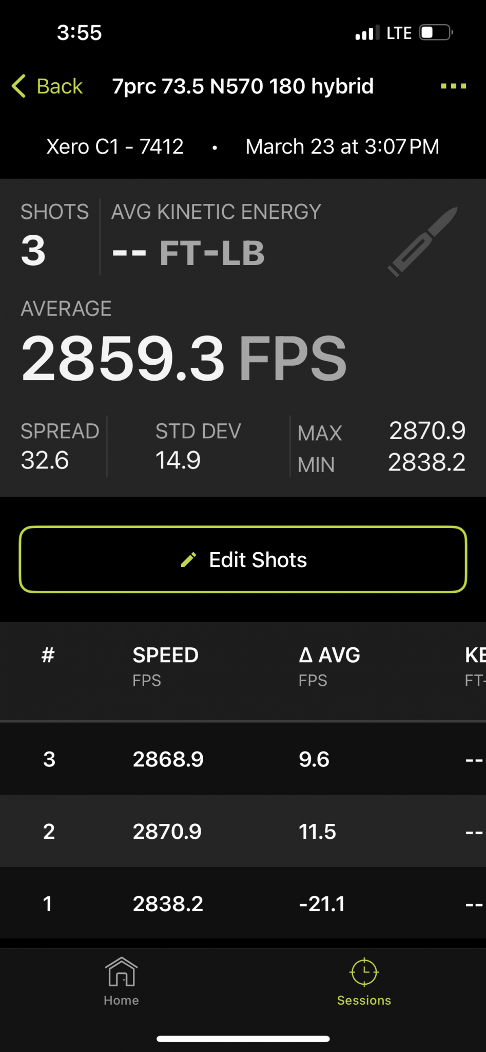

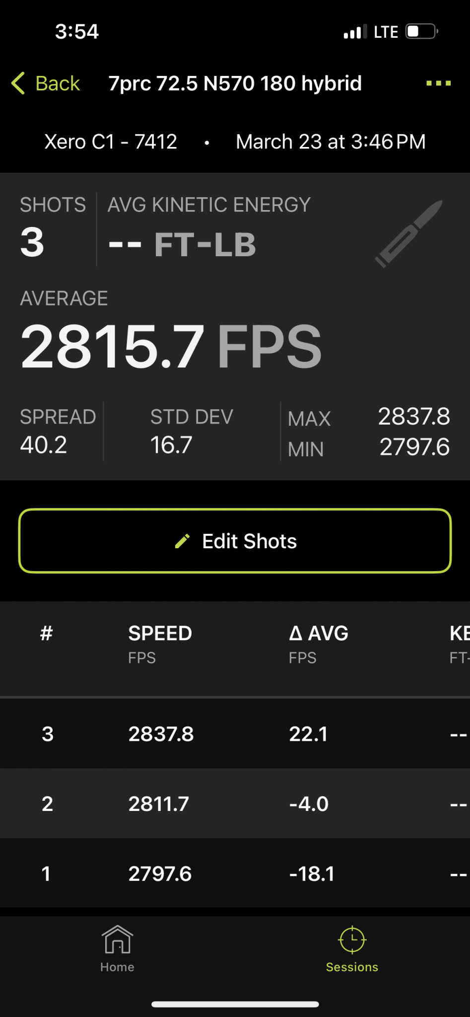

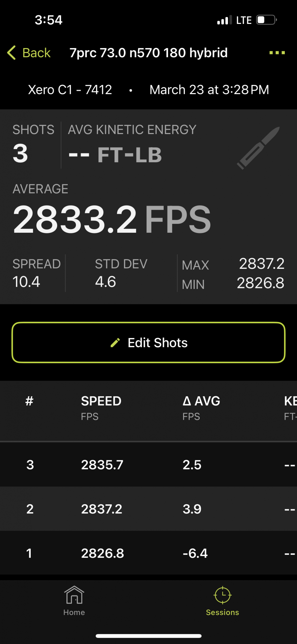

Following up. Got time to shoot again today. 18” carbon six tikka prefit, 180 hybrid, Peterson brass, N570.
73.5gr average 2859. 73.0gr averaged 2833. Groups from today list today’s date (everything but the top left two). Used the same cardboard as last trip.
Edit- something to note, last time I shot these loads I was using a hybrid 46 suppressor. This trip was with a scythe ti.

That's sweet for 180s you liking the 570 over the 560 an 565? Groups look nice. How far off lands are you? Suppressor intrigues me I've been running my Resonator R2 quieter but had intended on using my Polonium 30.
I haven’t tried 560 or 565. I had like 14lb of 570 leftover from a 300prc I sold so I figured I’d give it a shot. So far I’m a fan.
I came up with .065 jump. 2.5935 cbto.
