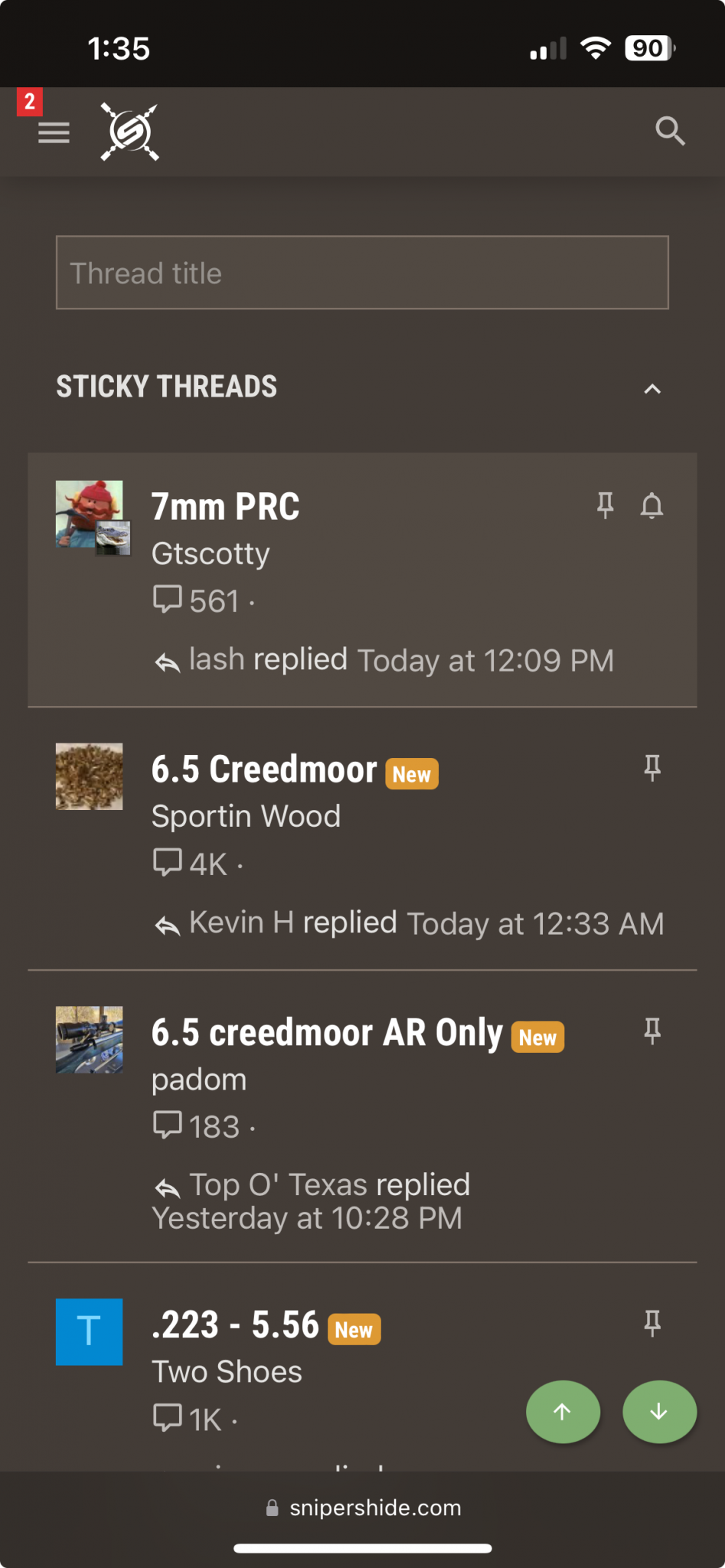

Anyone else wonder why the 7 PRC isn’t pinned at the top of the page like all the other calibers in this sub-forum?
It would be good to get this thread pinned in the reloading section as the 7PRC discussion thread. I wonder how to request that?

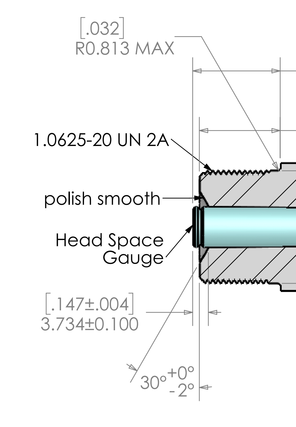

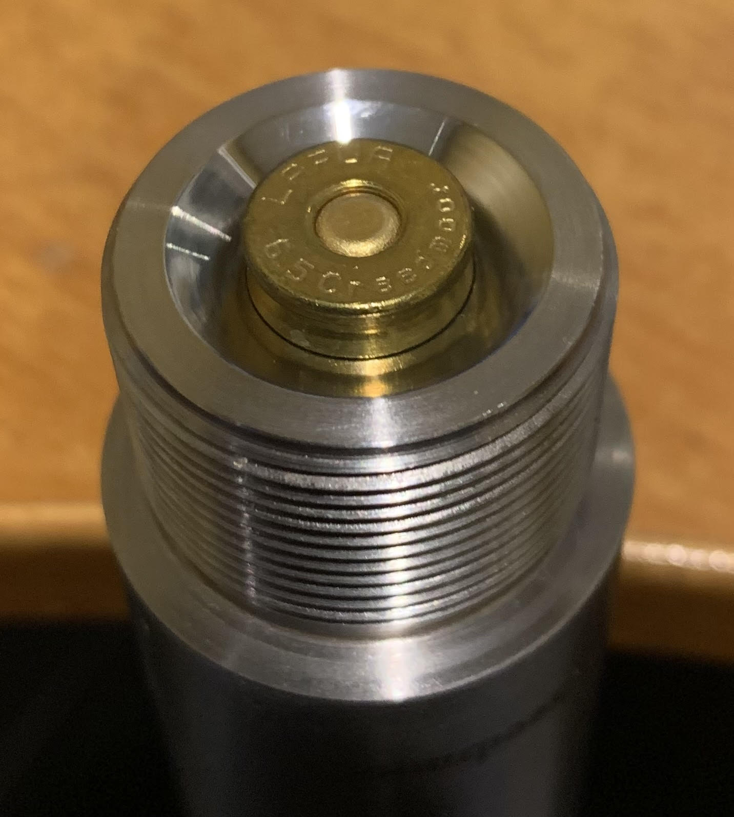

Did you go with a flat or conical breech for your barrel to CDG ? (conical wasn't needed but was just curious)
I had SPR do the conical breach as they already were familiar with it and it is a slightly stronger design due to the extra support it provides the bolt when in battery.

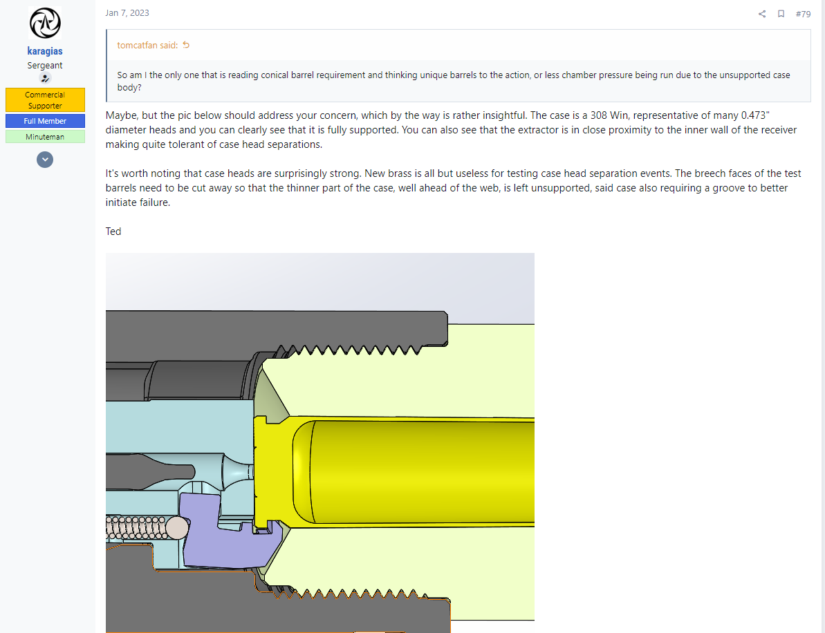

Pardon my ignorance but how or where is the extra support coming from in a conical barrel? Genuinely asking because I am building a 7 prc using a CDG.
Reactions: lash
Pardon my ignorance but how or where is the extra support coming from in a conical barrel? Genuinely asking because I am building a 7 prc using a CDG. View attachment 8394631
The case will be fully supported. Base shouldn't protrude like in your sketch.
I think the extra support @lash is referring to would be the extractor that has an angle which mates to the coned breach. It adds some additional constraint to the extractor on a closed bolt when using the coned breach.
Ted outlined this somewhere in the several thousand posts on the CDG thread.

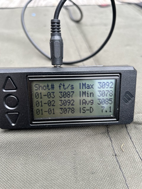

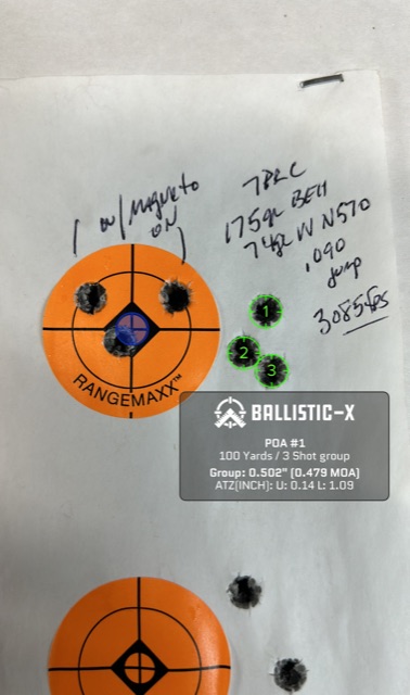

Started initial load dev today with Berger 175gr and 195gr elite hunters. Loaded 3 rounds at various charges working up toward book max with powders listed below to check accuracy and for pressure. 24” Proof Carbon prefit Origin barrel. Hornady 1x fired brass, AMP annealed, FL resized, .310 bushing, trimmed, CCI MLRP. I’ll note I’m jumping both these bullets .090. Long throat on the Proof.
Tried R26, H1000, VV N570 and N565. Winner was N570 with both the 175 and 195. Both bullets with N570 gave me an initial 1/2“ group and the best velocity with powders tested with the 175s. Still need to test further, chrono the 195s and test both at distance, but happy with results so far.
Berger 175gr EH
74gr VV N570
3085FPS, SD 7.1
Berger 195gr EH
70.4gr VV N570
Berger 175gr EH
74gr VV N570
3085FPS, SD 7.1
Berger 195gr EH
70.4gr VV N570

I’m interested to see a velocity comparison with the 4 powders you tried. The n570 has been doing great in mine despite the slow burn rate.

Didn‘t chrono all charges. I shot for accuracy and if it looked descent I loaded a few more for a velocity check. I don‘t love reloading and don’t want to burn through components / barrel. Just want to find an accurate consistent load that will kill Elk. NM draw will be any day now 🙏.
7PRC w/ 175 BEH.
R26 67.1gr. 2951fps (1moa), also tried 67.5 and 67.8, which is max, but groups opened up.
H1000 67.1gr 2812fps (1moa), 70.6 is max but didn’t have enough powder to test a lot more charges. Would be worth exploring more.
N565 69gr gave me 3/4moa. 70.0 is max. This powder is worth exploring more.
N570 74gr gave me 1/2moa (twice) and 3085fps. This is where I wanted to be, so I‘ll be happy if it stays consistent. I think one of benefits of N570 is the 100+% case fill. N565 is 98% case fill rate.
Wasn‘t going to try 195s, but buddy gave me a box. My bbl throat, twist and mag can take them so why not. With the 195s I tried 70.4 of N570 (max is 71.4gr), 1/2MOA and 65.5 of N565 (max is 66.5), 1.5MOA. Not much room in the case with these powders for the 195s. I’ll chrono the 195s w/N570 today.

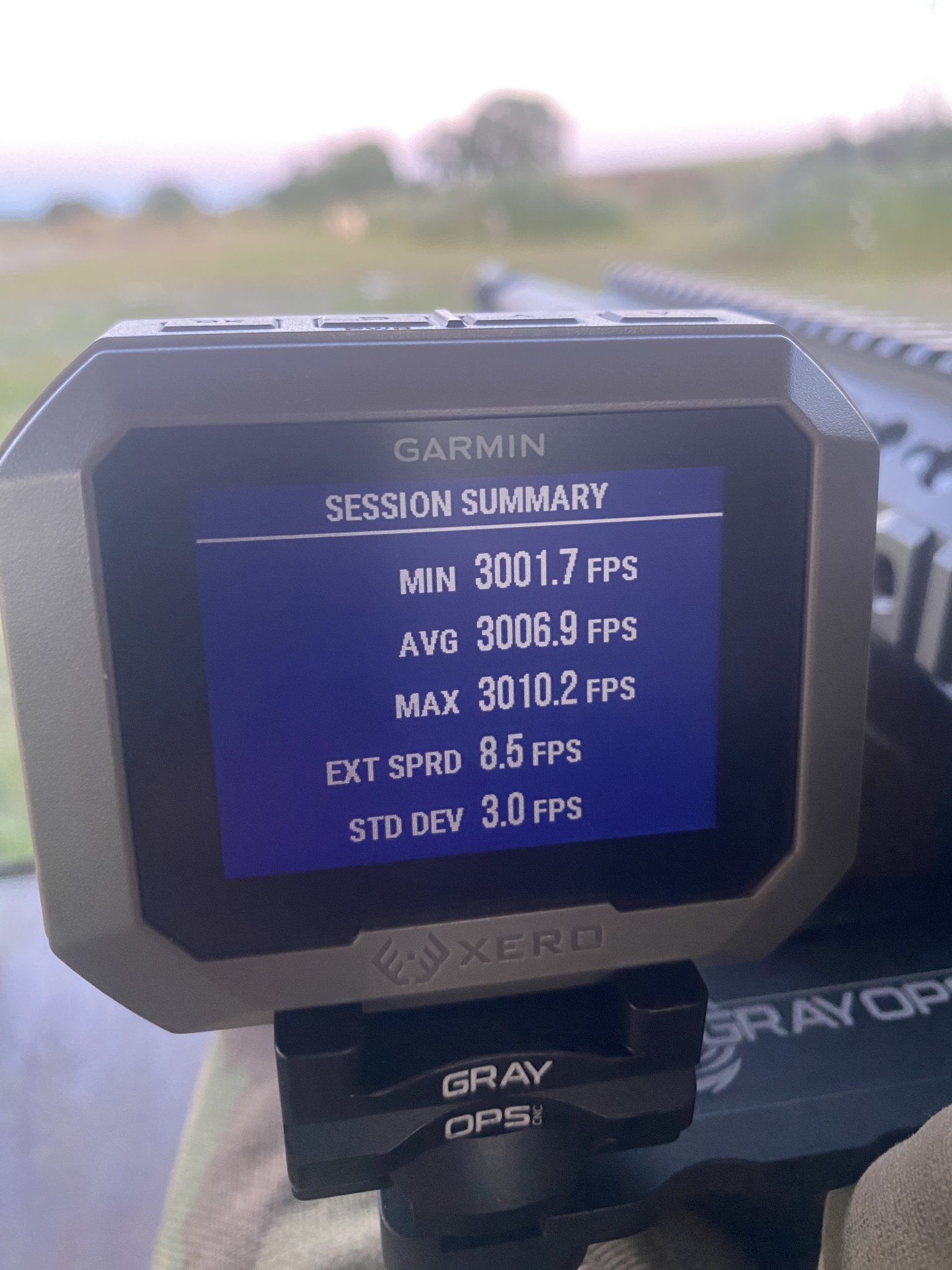

I just chronoed the 195s w/ 70.4gr N570 and I’m getting 2909fps, SD7.

Updated chrono pic of 7 shots in the node today….

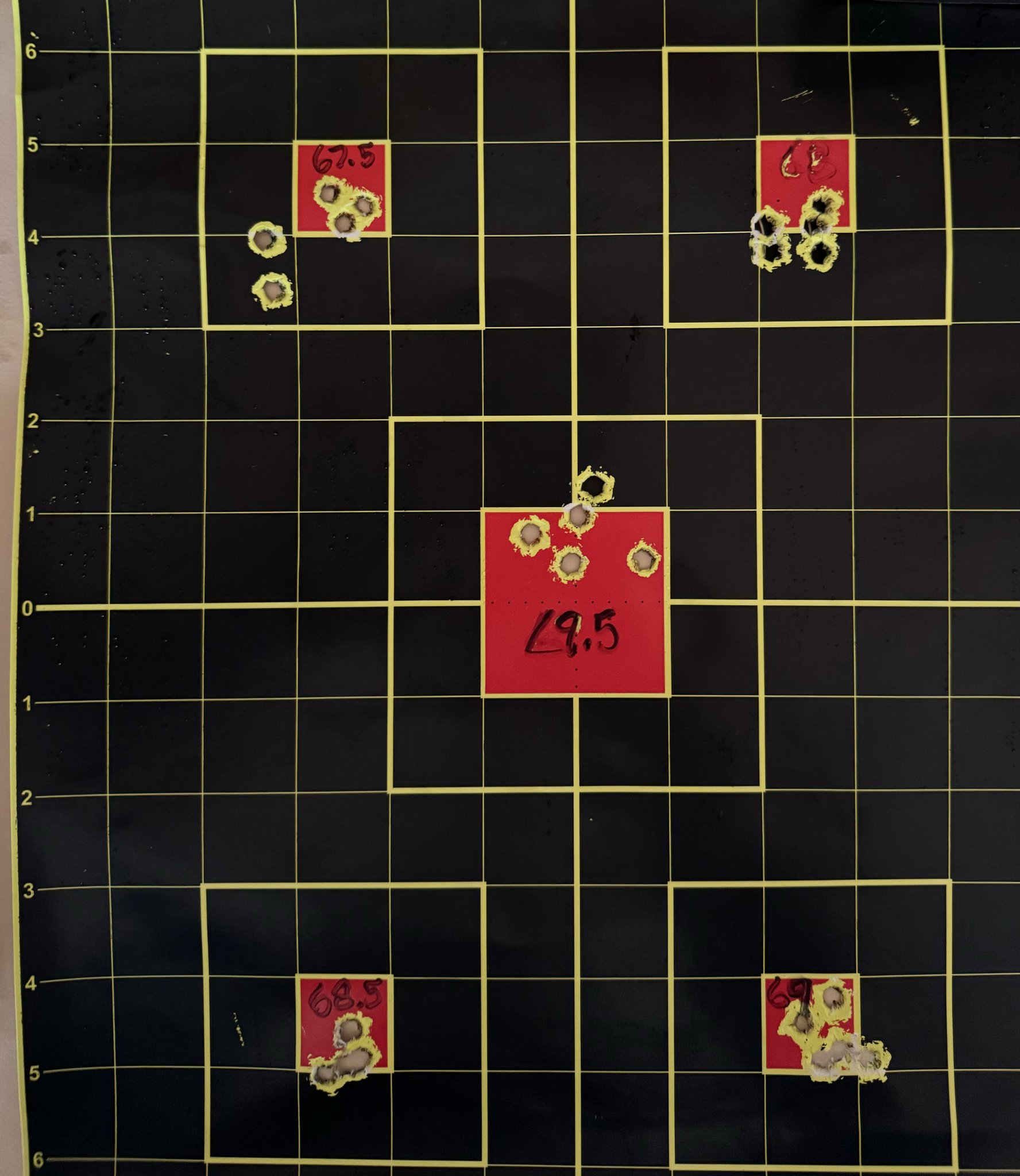

I ran 175g Bergers up to 69.5 with h1000 with no pressure signs but they didn’t group well. I settled on 68.5g. 20” barrel with a velocity of 2850fps. Good enough for me.

Yea I shoot 6.5cm and .375CT with solids. Never had an issue with either and both shoot lights out.
I’ve stripped it and shot it again(boretech copper and carbon remover). Still didn’t return to normal. Stripped it again and tried eldx’s and still wouldnt shoot.
Kind of strange, it was shooting .5 moa. Then all of a sudden stopped shooting. I will say load dev for it was an absolute bastard (see my previous posts in here). But seemed like I found a consistent performer. Then one day went back out and it was all over the place. It’s been into proof to check the barrel, it’s changed stocks, it’s had different powder, bullets, primers, switched scopes, tried different mounts, different bipods. Short of a new barrel and chamber job it’s almost a new gun, lol.
Proof had it shooting 3/4 moa with eldxs at their shop when they checked it. But I couldn’t replicate it. Might be time to chuck the barrel but I’m having a hard time coming to grips with that at the moment.
Also, I’m using SAC dies and a zero press with an fix-120i. I load 6 other calibers with all the same equipment so I’m pretty sure it ain’t my gear, haha.
