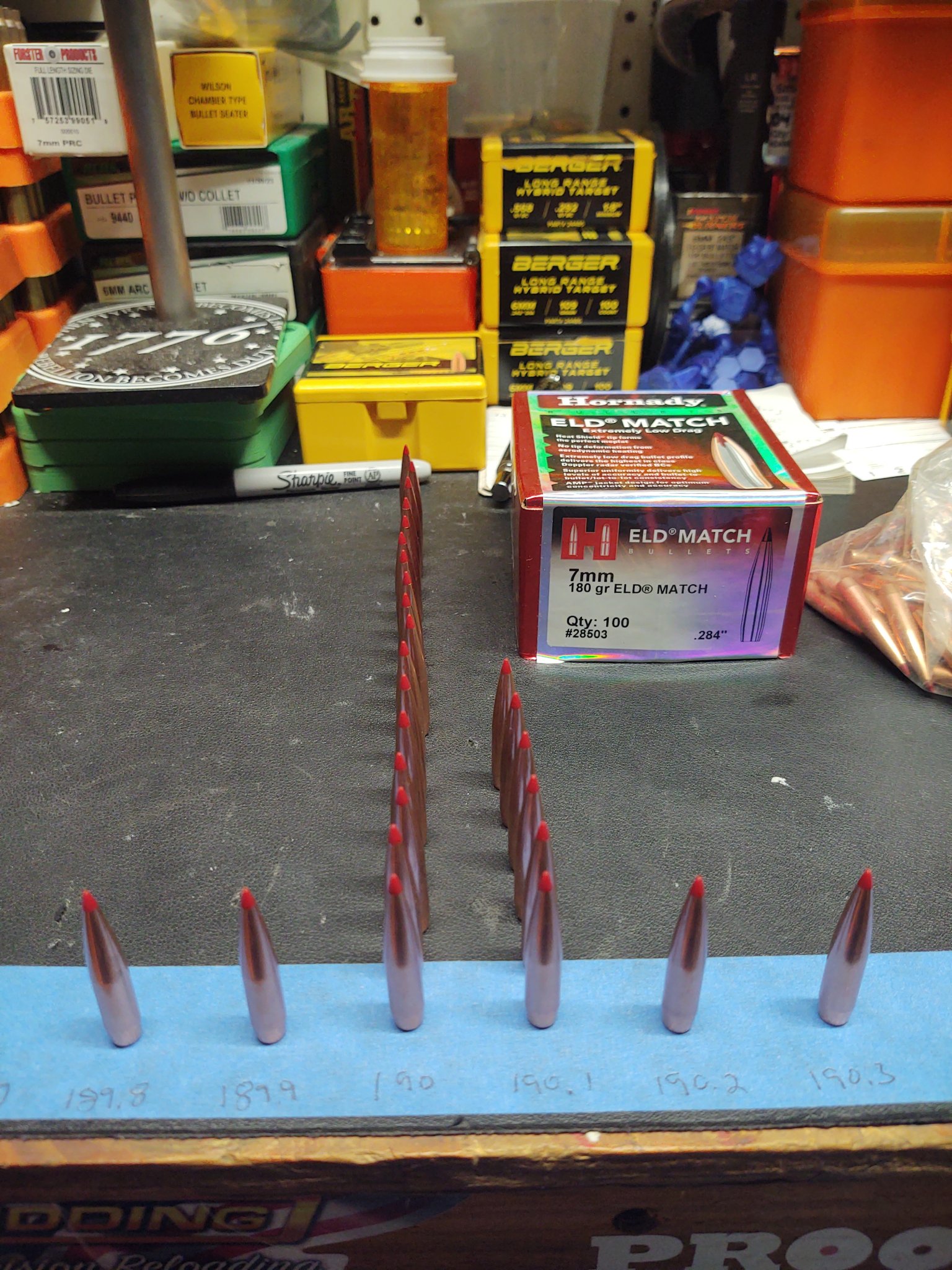

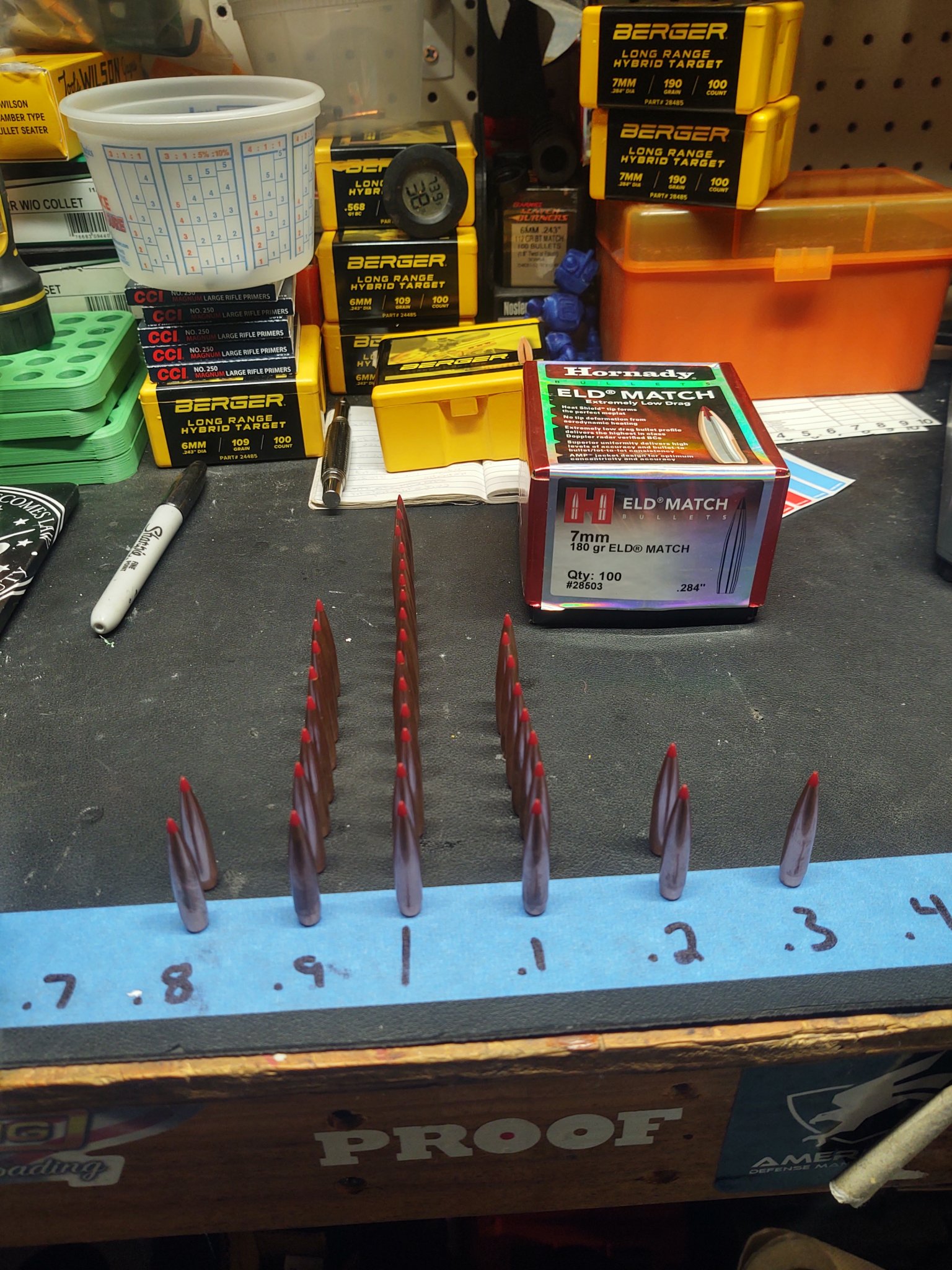

Join contestI'm sure I probably can't either but it surely doesn't hurt.I’m not a pro long range shooter, but if you’re sorting all your bullets out like that, I hope you can actually shoot the difference. How many guys can shoot the difference on a 1 gr variance? Probably not many
Seating depth is my next step actually. LolAbsolutely nothing wrong with getting in the weeds and chasing the elusive 1 hole group. I think it is preferrable to manufacture crystal methamphetamine.
People certainly group projectiles by weight. Charge weights. Even length of the bullet. Moving the seating depth. Chase the lands, don't chase the lands.
Fire-forming for your own wildcat.
Neck turning.
I guarantee if there was a way to spin and analyze bullet for distribution of mass and therefore, center of gravity, that would be the next step.

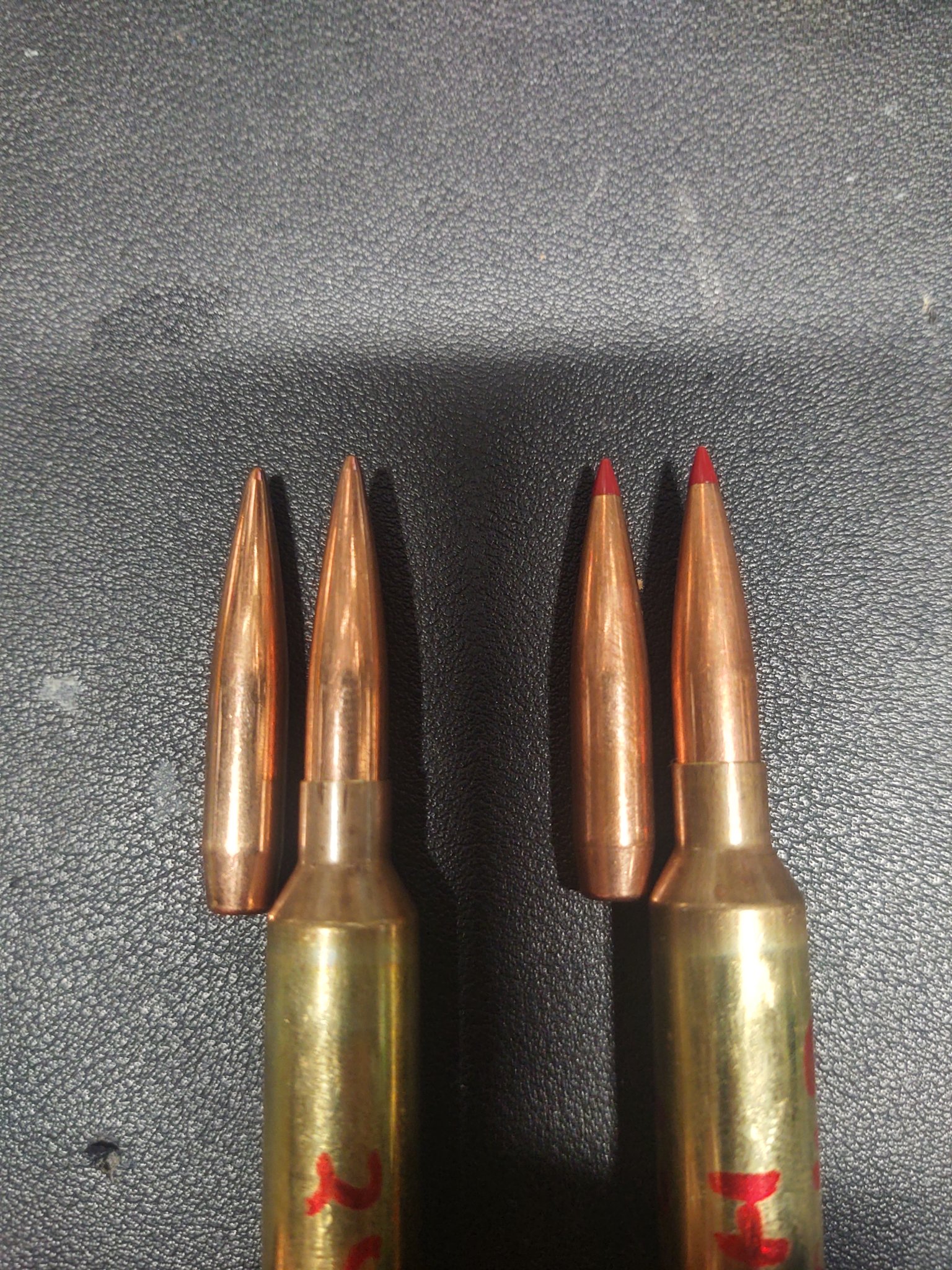

What bullet?View attachment 8441815

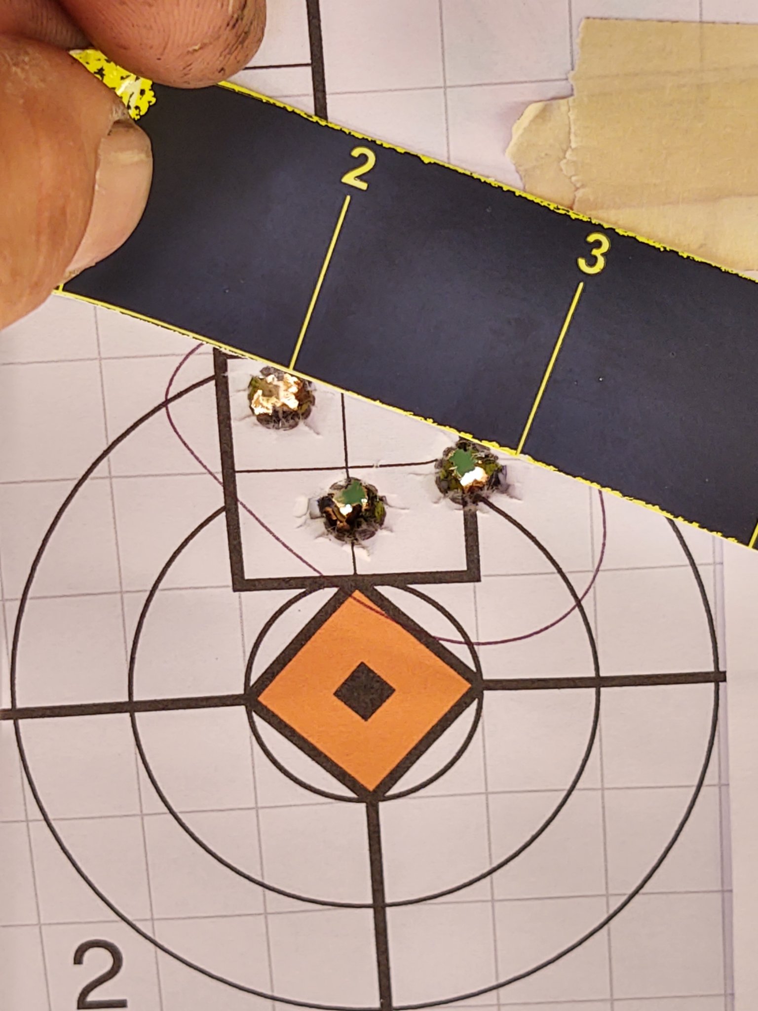

Not bad for an 18 inch barrel. Playing with seating depth some more. Hoping to get rl23 to group good got a couple lbs of it

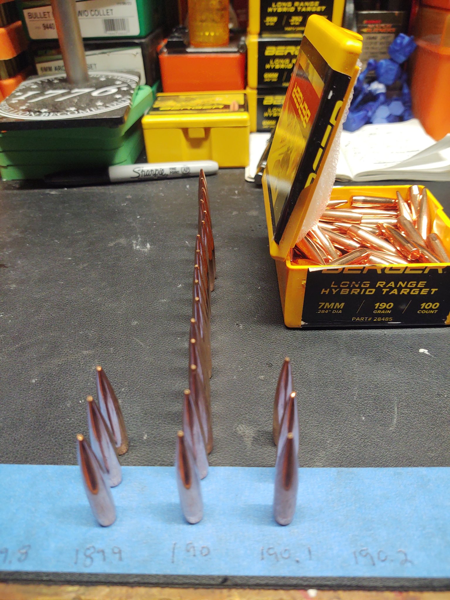

Is that tape right those weighed over 190 grains?I just can't understand the price difference between Berger and Hornady. Just can't figure it out.
I used the same tape for the 180's as I did for the 190's. That particular picture was of the 180's.Is that tape right those weighed over 190 grains?
No....I had weighed the 190's first. Then just used the same tape for the 180's.So the 180’s were 10 grains heavier?

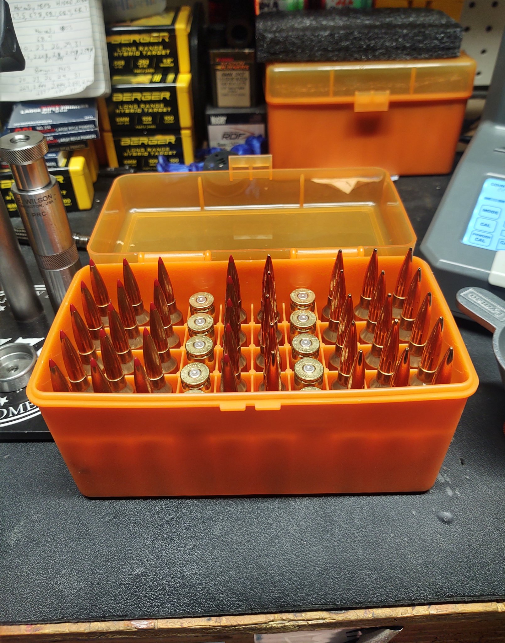

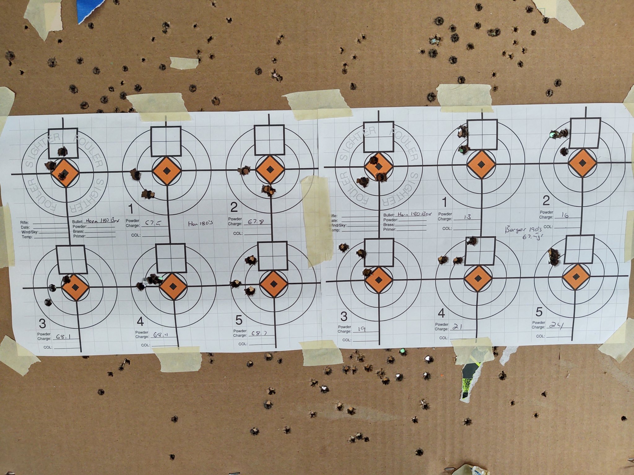

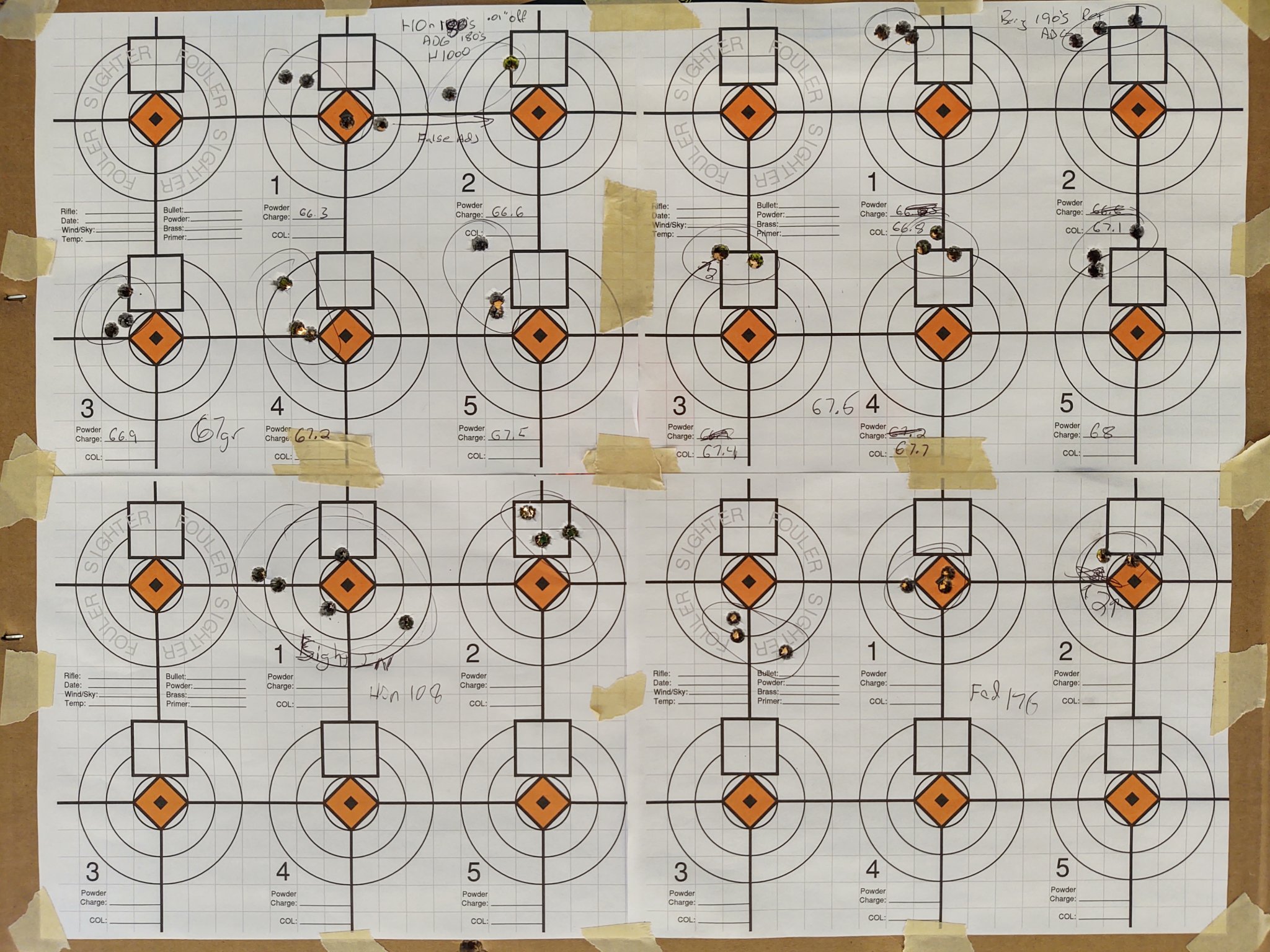

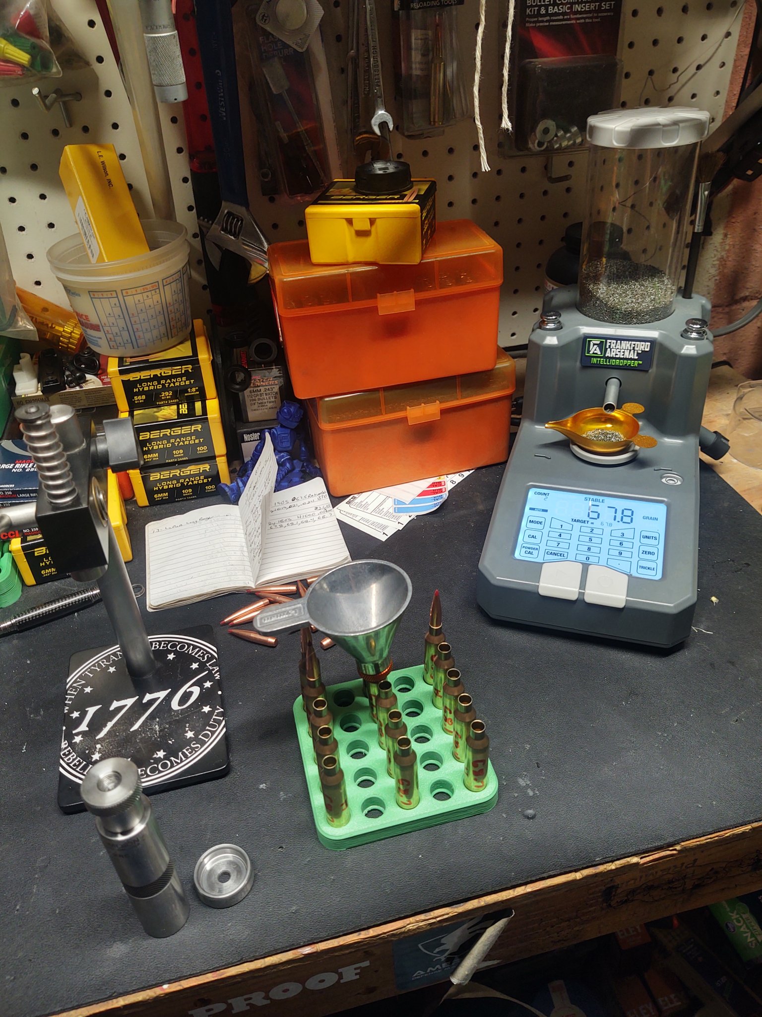

69 of h1000 under 180’s seated base of bullet even with body/neck junction works good out of my gun. 205 rounds down the tube and they avg 2947Let's see how these do...
Left are the Hornady 180's sitting on 68.4 of H1000 and CCI 250's in ADG brass. Going to run the seating from 20 off to 31.
Right are the same as above but the Berger 190's on 67.5 of Retumbo.
These will put me at 141 rounds so I figure I'll do a velocity check just to see where I'm at out of curiosity. That's what the 5 of each on the inside are for.
What barrel length, primers, brass?69 of h1000 under 180’s seated base of bullet even with body/neck junction works good out of my gun. 205 rounds down the tube and they avg 2947
22” proof carbonWhat barrel length, primers, brass?

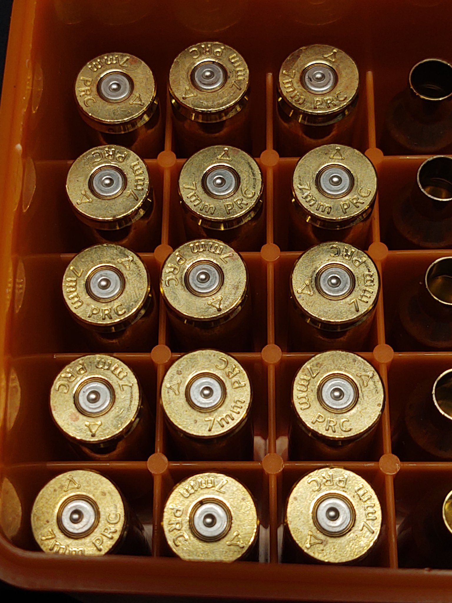

Fed215
ADG (2x firings)

Book shows 2900 out of a 24" with 64gr.

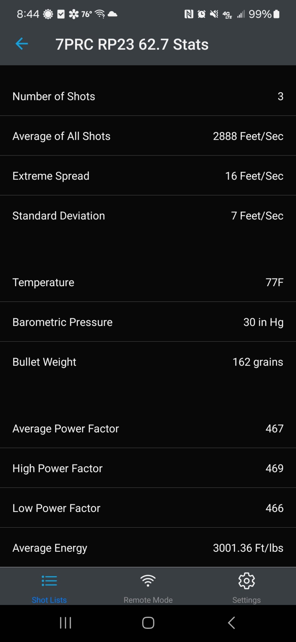

I'm at 159rnds thru my 28". Velocity check today. Seems pretty lowI have 300 rds through that barrel. I'm sure it will speed up some as I get more rounds through it.
I like the accuracy mine displays at this speed.I'm at 159rnds thru my 28". Velocity check today. Seems pretty low
CCI 250's
ADG Brass
68.4 H1000
Hornady 180's
2980 avg.

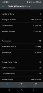

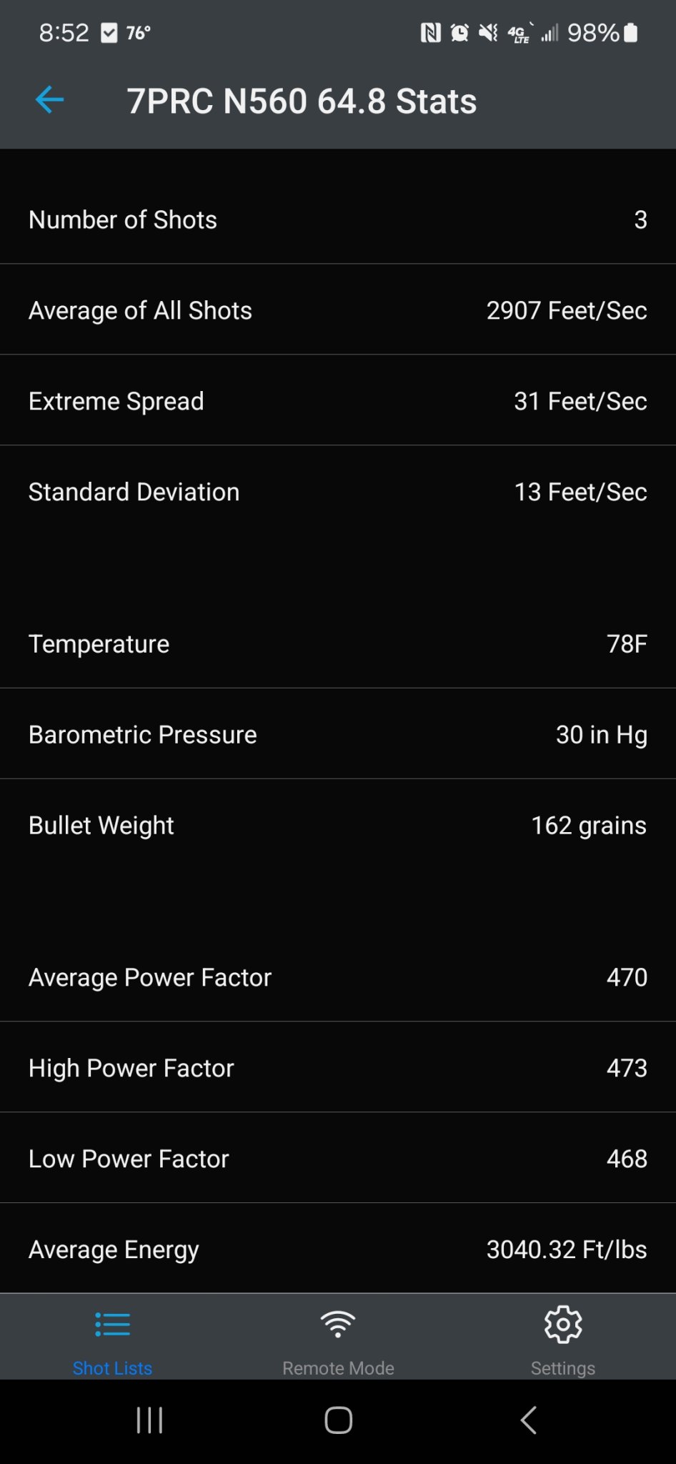

I was watching the Little Crow Gunwerks guy and he was doing chronos on the round that got me so much unwarranted heat for even mentioning. Anyway, so, Federal was slightly over the box MV of 3K fps (mono copper.)I'm at 159rnds thru my 28". Velocity check today. Seems pretty low
CCI 250's
ADG Brass
68.4 H1000
Hornady 180's
2980 avg.
LOLI was watching the Little Creek guy and he was doing chronos on the round that got me so much unwarranted heat for even mentioning. Anyway, so, Federal was slightly over the box MV of 3K fps (mono copper.)
Hornady was lower than the 3k fps on the box. So, without mentioning the round that shall be named, it seems that Hornady is having a problem with rounds living up to the published MV for rounds other than the 7 PRC.
(Notice, I did not mention the other round, trying to avoid more contention.)
