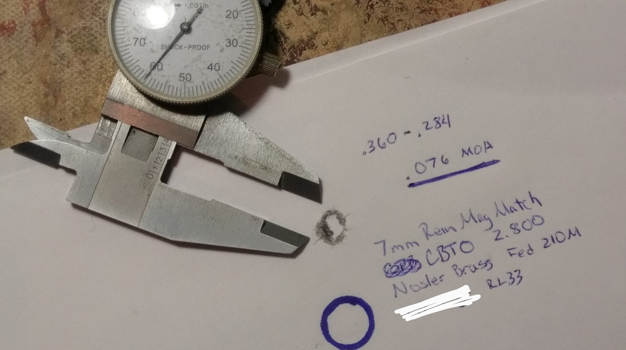

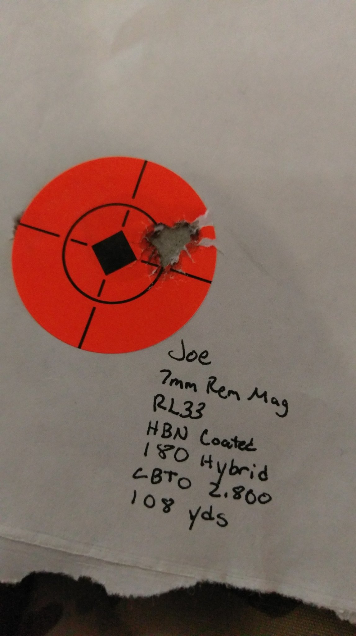

When this barrel is toast, (and it's coming soon) I'm gonna need components (at least brass) anyway.
That's the only reason I've considered the LRM and the 7-300 PRC.
LRM doesn't have the industry/market support, which leans me towards the 7-300.
