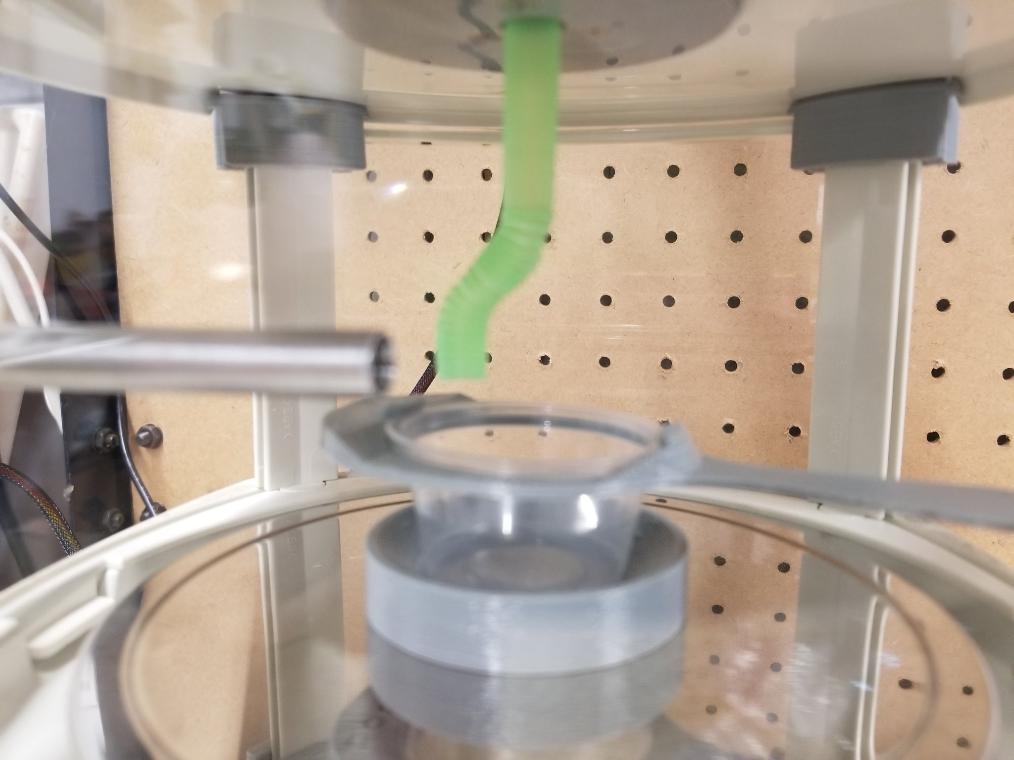

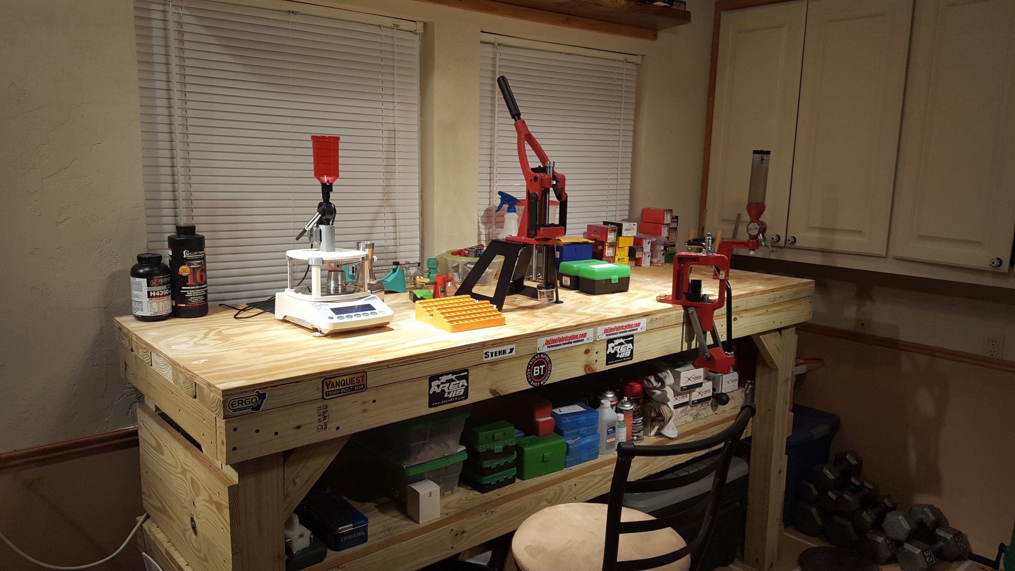

*edit* I went out to take a picture of my setup and I misspoke (mistyped?) above. I used the plastic cup provided with the thrower plus a dogleg bend in the straw. Still no kernels bouncing out of the pan, though.
Reactions: Sheldon N
I received the Kern'l Dump'r the other day. I made a Delrin 'tray' on my lathe that fits the base of the Dump'r perfectly so it goes in the same place each time. I like the heft and the handle is the perfect length. The plastic cups that come with the auto dump are just too clumsy.

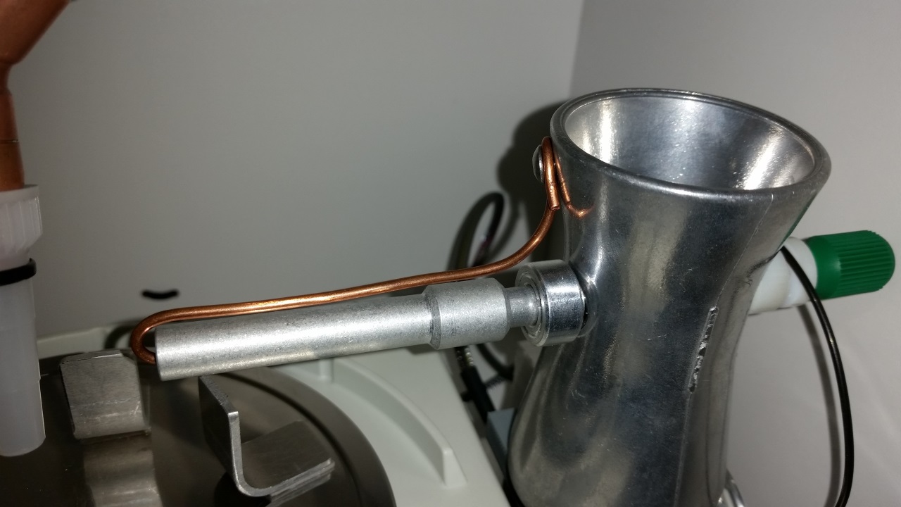

Regarding occasional overcharges... trickler finishing speed and trickler angle do play into it, but what I noticed is that many overthrows were caused by "bunching" of the powder kernels in the trickler tube and it dropping several kernels at once near the end of the ramp down leading to an overshoot of the target weight.
What I did to minimize this was to attach a piece of stiff wire to trickler, ran it above the trickler spout, and at the end bent it into a "U" and had the short leg of the "U" protrude into the trickler spout about 1/2". I bent the wire until so it's sitting slightly off the bottom (6 o'clock) position of the inside of the trickler tube. What the wire does is it hits and "breaks up" any multi-kernel piles in the trickler tube and knocks them down to single kernels riding in the grooves of the spout so it can more reliably dispense those last couple of kernels, 1 kernel at a time. Adding the wire to break up any bunched/clumped kernels significantly cut down the amount of overthrows and also made the trickler less sensitive to tilt and finishing speed.
Can you post a pic for us? thanks!
Here it is... quite simple. Any wire should do the trick. I tested it first by zip-tying the wire to the housing to make sure it worked, and when I was happy with the results I drilled and tapped the trickler body. The wire pokes into the end of the trickler tube about 1/2" and almost touches the bottom of the tube at the 6 o'clock position to break up any clumps.
I still haven't taken my V2 trickler upgrade out of the box, but I imagine it would work on it too...
