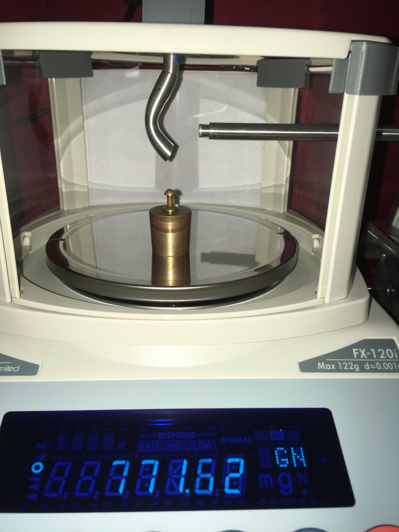

This probably wont work near as well, but I did some fine sanding on my chargemaster weight to get it to spec. 771.62gn = 50.00013g At least its a reference point to check.

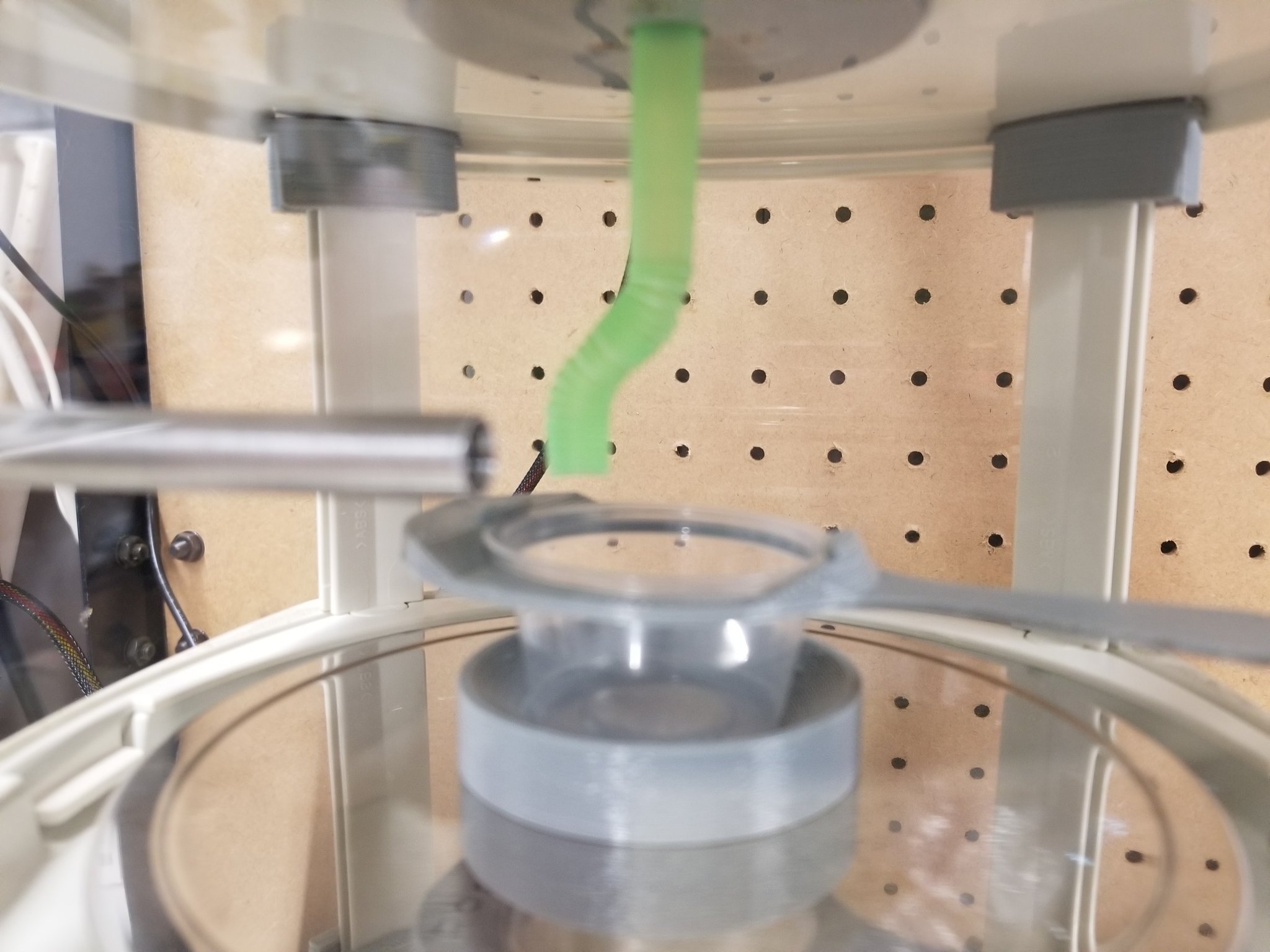

Just a piece of aluminum tubing I turned down/heated/shaped.
Yeah some type of bend is critical. I made a half ass cup out of a piece of scrap that works good. The tube seems to let me get a more consistent initial throw because all the kernels flow out and don’t get hung up in the bend like the straw. Not a big deal though. It all works. Love this machine.

I recently bought the Autotrickler, then added the dumper 6 weeks later. I never even tried to use the plastic cups that come with dumper, I just used an aluminum pan I already had. To prevent dumped kernels from bouncing out of the pan, I put a dogleg bend in the end of the tube (drinking straw) which does a great job of decelerating the powder right before it hits the weighing pan.

*edit* I went out to take a picture of my setup and I misspoke (mistyped?) above. I used the plastic cup provided with the thrower plus a dogleg bend in the straw. Still no kernels bouncing out of the pan, though.
