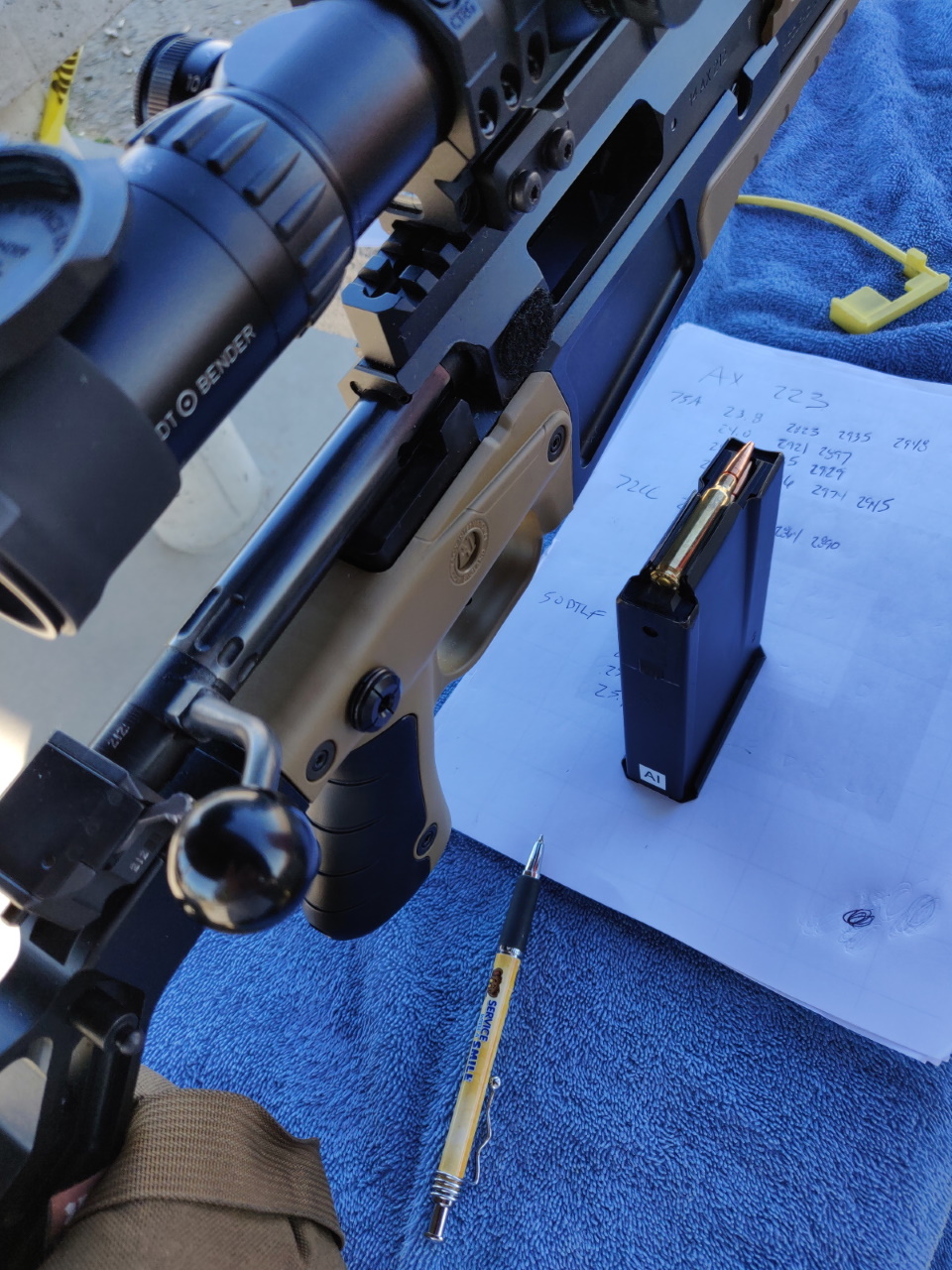

Enrique had my bolt done in a week. Took Greg a bit longer on the barrel because of his current workload, but I received my 223AI barrel from him about two weeks ago. Yesterday I finally had time to go out and get my fireforming loads dialed in. Feeds / extracts / ejects extremely well. Clever bolt nose and breech face design to help with smooth feeding with the smaller diameter 223 cases. Accuracy is great too.
Only 560 more cases to fireform, be glad when that is over... the AI bolt lug ramp geometry makes the bolt closing a bit "clunky" with the slight crush fit on the new Lapua cases. With properly sized cases after fireforming it feels like a regular AI bolt.
We have a few small changes we are implementing into the bolt head, A couple are intended to increase the smoothness of the bolt close. The original design is good, but we may be able to make it just a little bit better. Please be patient while we work through the redraw and testing. If anyone wants to get notified when we're ready please call or email the shop and we'll get you on the list. It's a tough time to be experimenting; many in the industry, including us, are currently struggling to keep up with the day to day operations
Good to hear Greg. I really like my kit, been wanting to shoot 223 out of one of my AI's ever since the AE Mk3 days...
Another possible design change to consider if you aren't already: With the somewhat large OD of the stock AI firing pin in the triple fluted area between the shoulder for the firing pin spring and the tip, there isn't much wall thickness left in the bolt head for the nipple of the sako extractor to engage into. When I got my bolt back from Enrique the nipple on the extractor was left a bit too long and was contacting the OD of the firing pin. When you would rotate the bolt handle the extractor nipple would jump up and over the 3x flutes on the firing pin, and between that and a few dry fires the firing pin OD pushing up on the nipple of the extractor and trying to force it out of the bolt ended up bending and sticking the extractor plunger. Luckily I caught it before the damage to the extractor plunger was too bad and was able to remove and replace the extractor plunger. For clearance between the extractor nipple and firing pin, Enrique said to just file down the nipple on the back of the extractor a bit more for clearance. Turns out the batch of extractors he used for my bolt were a little different than the first batch he used, and he didn't realize there was a clearance issue. After filing for clearance there's not much nipple left on the extractor to engage the bolt head, but it works and extracts just fine.
One possible design change I see that would improve this situation is If you were to grind down the OD of the triple fluted area of the stock AI firing pin forward of the spring collar where it passes through the bolt head and reduce the diameter by say .080"-0.100", that would allow for a smaller hole through the bolt head for the firing pin which would leave more wall thickness in the bolt head for the extractor nipple to engage. This means you could not only leave additional material on the extractor nipple for engagement into the bolt head but also create additional clearance from the firing pin OD to the back of the extractor nipple to avoid the clearance problem that I had.
However, this change would come with a compromise-- you would now need to modify the stock AI firing pin and have a firing pin assembly with a modified firing pin dedicated to the 223 conversion bolt, and you could no longer simply swap a stock AI firing pin assembly between say a .308 bolt body and the .223 bolt body as you can with the current design.
The other option would be to make a custom factory AI style leaf spring .223 extractor and leave the ID of the bolt as-is to use an unmodified AI firing pin-- an AI style leaf spring extractor would totally eliminate the clearance issue between the firing pin OD and the sako extractor nipple, but it would be a far more costly and involved solution on your end.
Minor issues in the scheme of things but figured I'd mention it. I'm very impressed with my 223 kit as-is.
Going to finish my loading tonight and hopefully go shoot and fireform some more tomorrow...

guys, thanks for you patience, ive got R2 on my rifle and working, trying to get the bolt close as smooth as a factory AI 308 bolt. Lots of stuff going on with the closing cams, etc and the different geometry in place with the 223 head. Its 95% right now, got mine shooting sub 1" @400Y
ready with CC 😎
