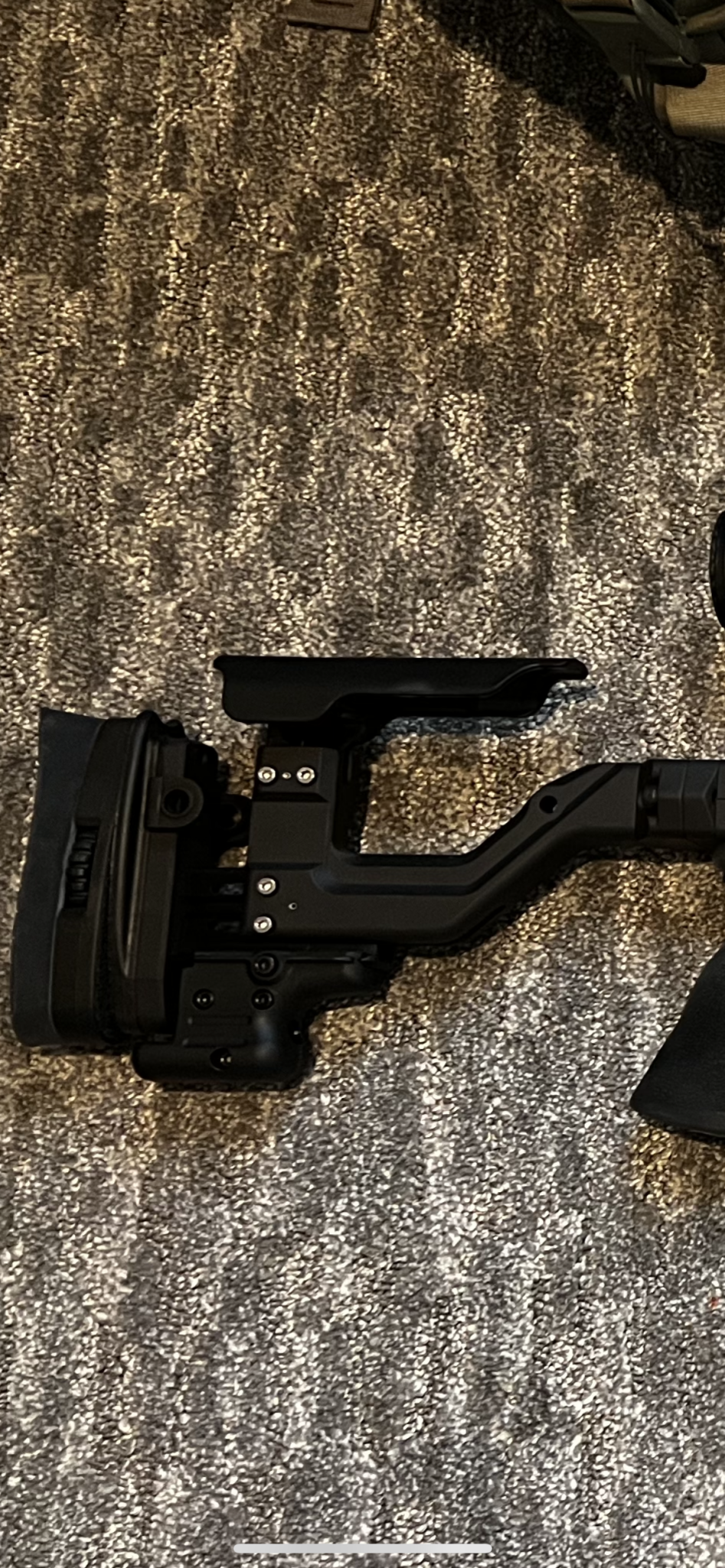

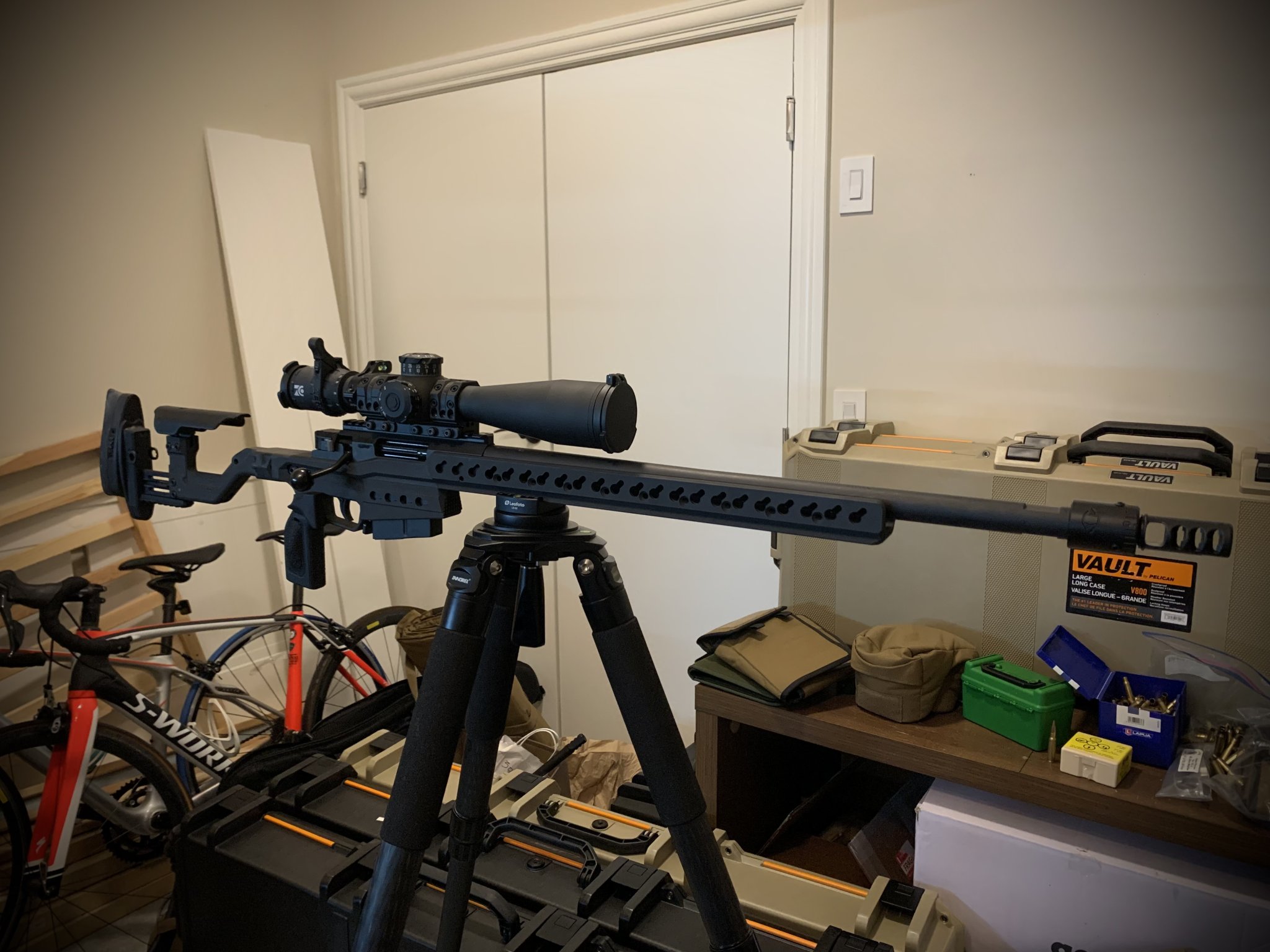

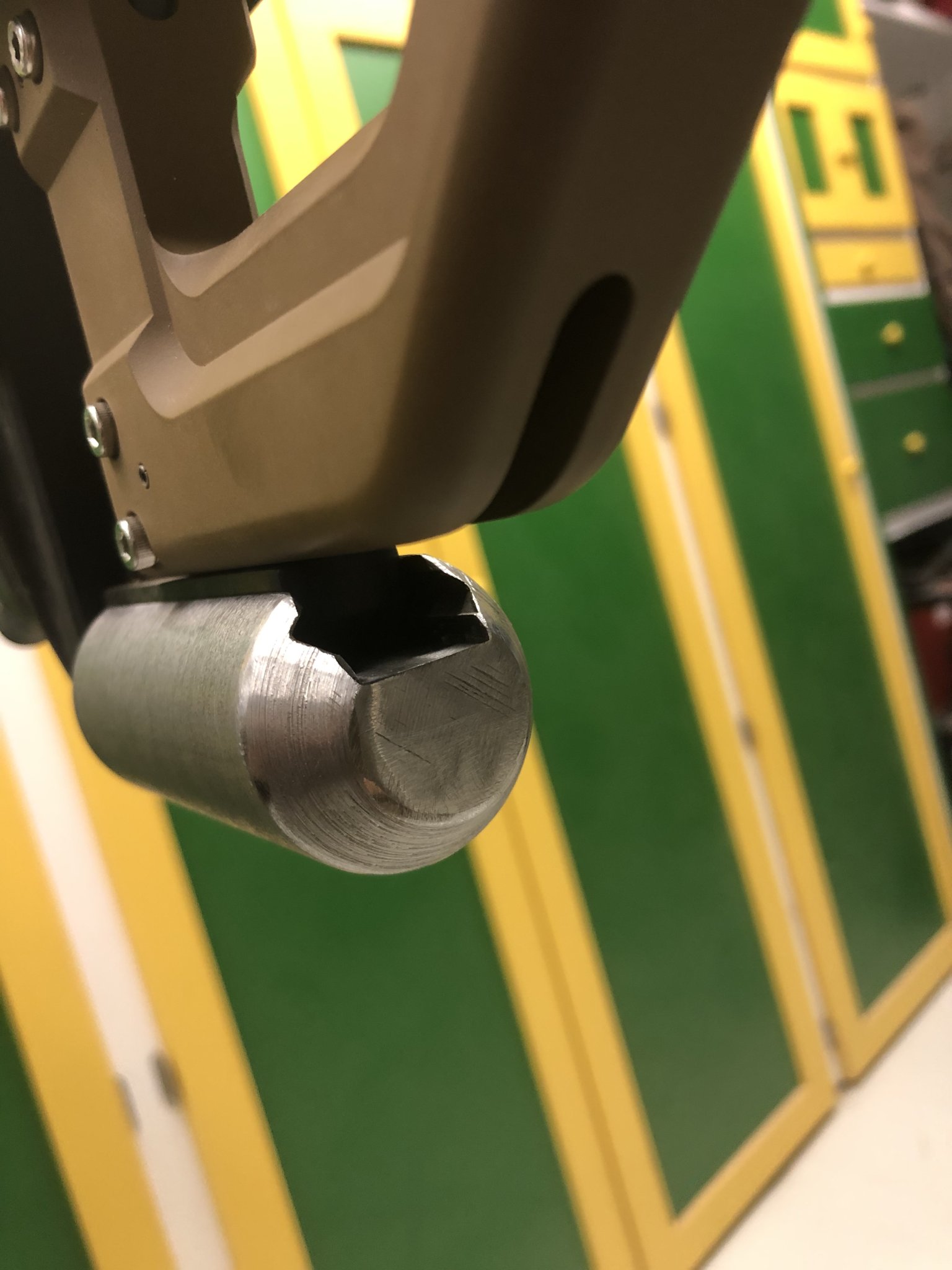

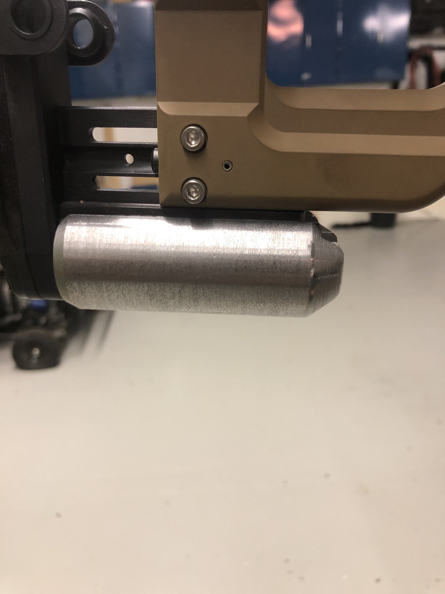

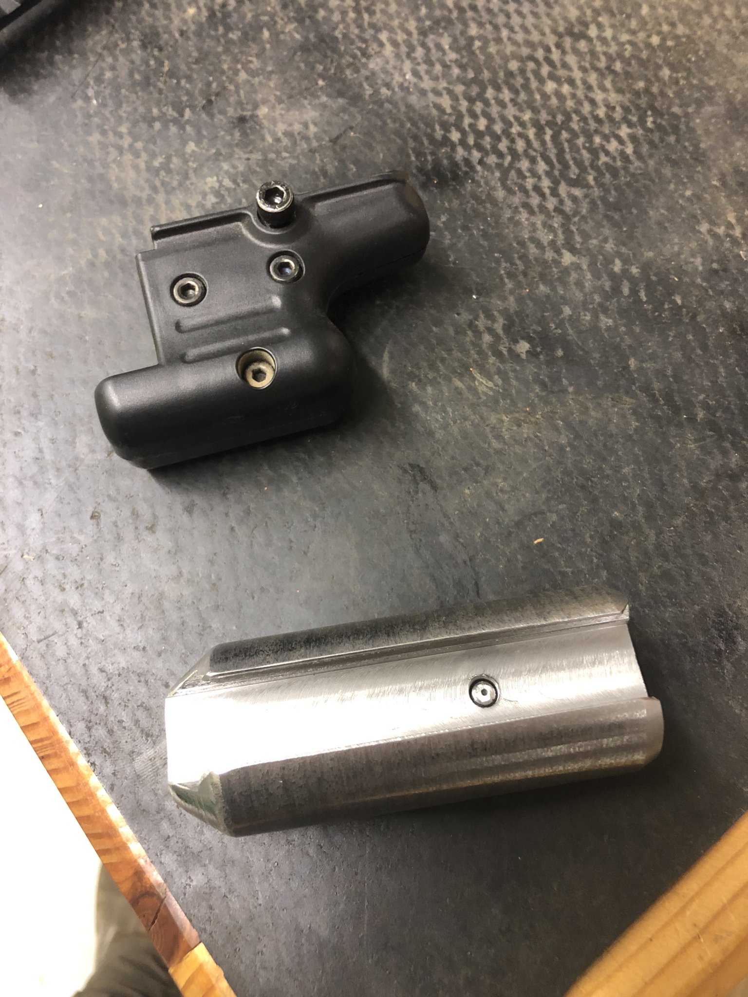

Needed a little weight on the back to balance the rifle out. Looks like it will work, just need to cerakote it now. Weighs 1# 5oz. No weights up front just a 26” MTU.

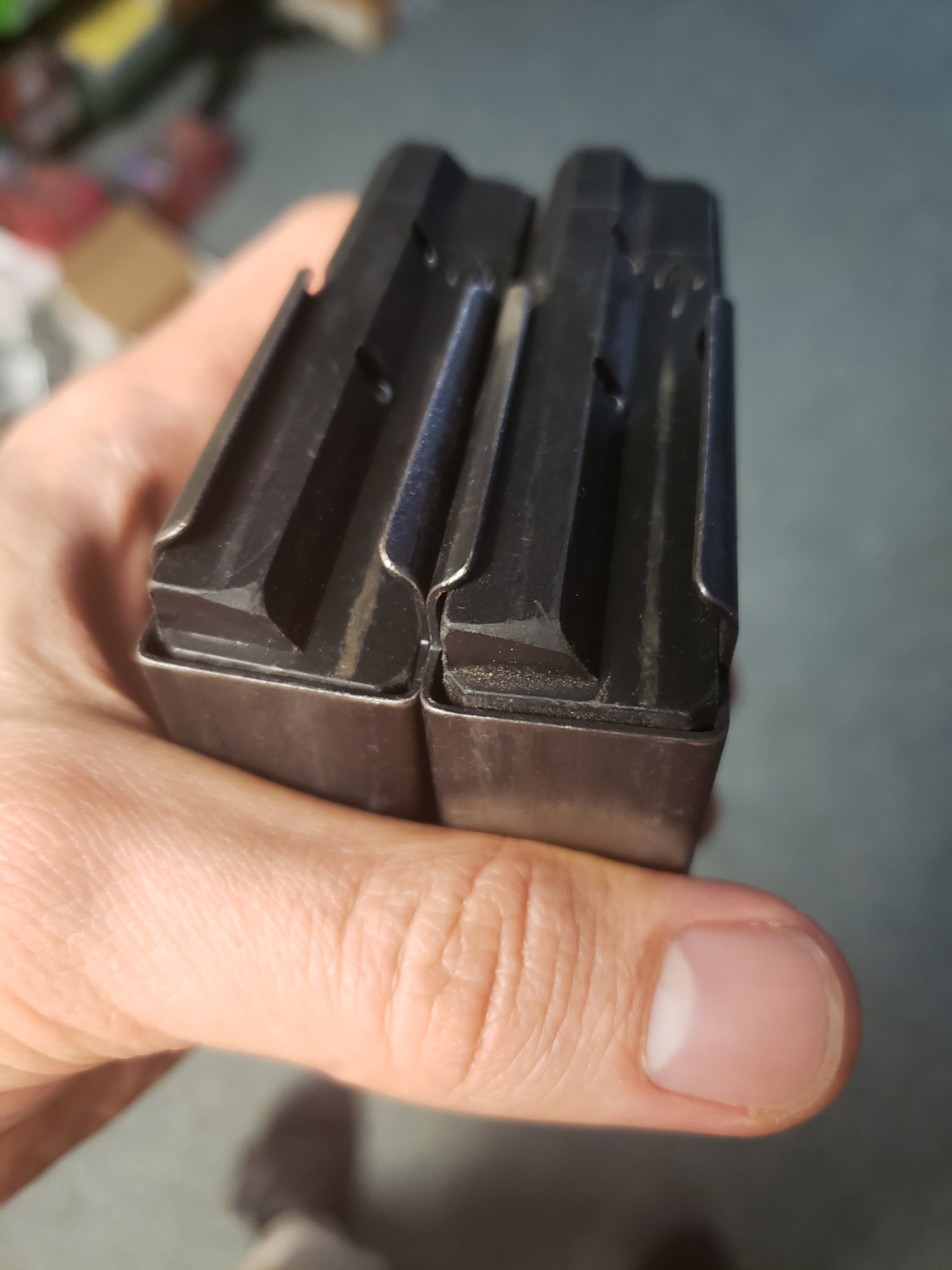

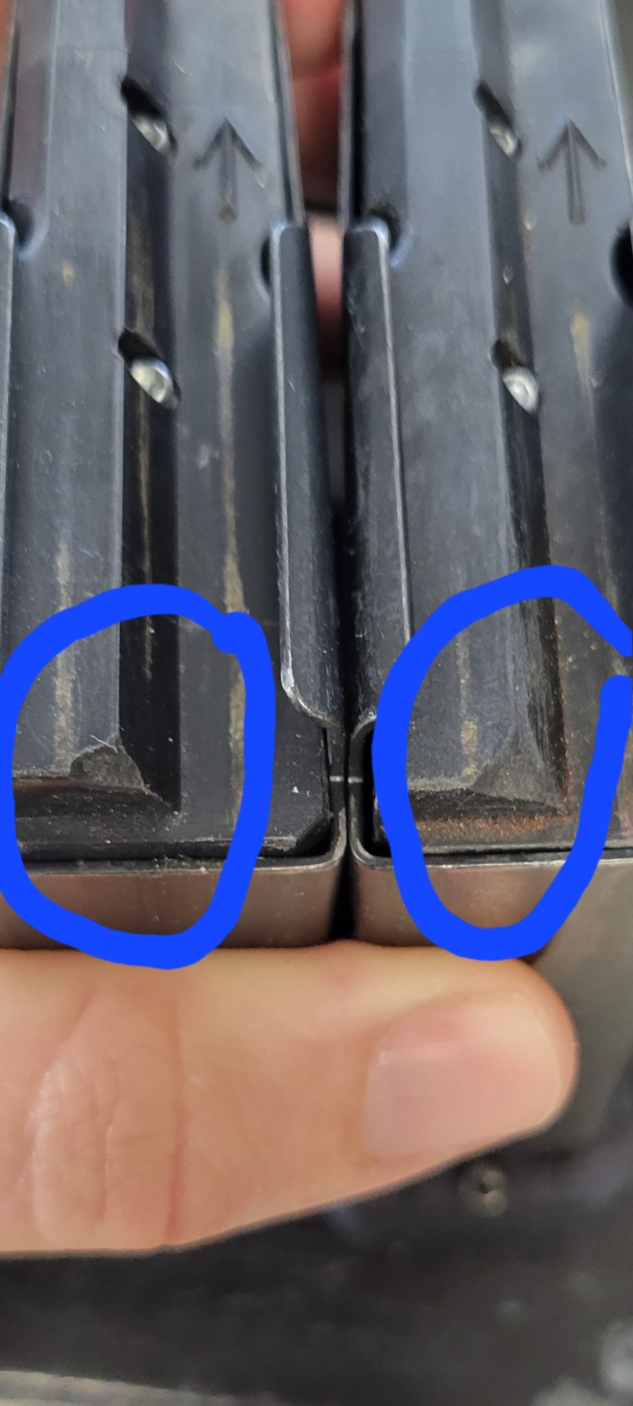

Easiest fix- put empty mag in rifle with bolt back. With the palm of your hand, hit the bolt handle forward and it will chip off the perfect size off the corner of the mag follower and you're good.
And before anybody says it will mess something up, I've done this to 6 mags without flaw. It's steel vs plastic.
I can post pics of how the follower looks if need be.

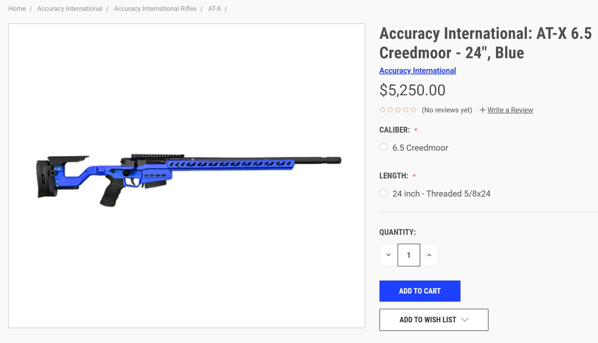

Looks like the 2022 pricing is in effect and this blue one in stock most likely doesn't have any of the new gen components. Major oof.
All AT-X rifles and AICS ordered now will be what we call Version 3 and what has been referred to here as Gen 3.

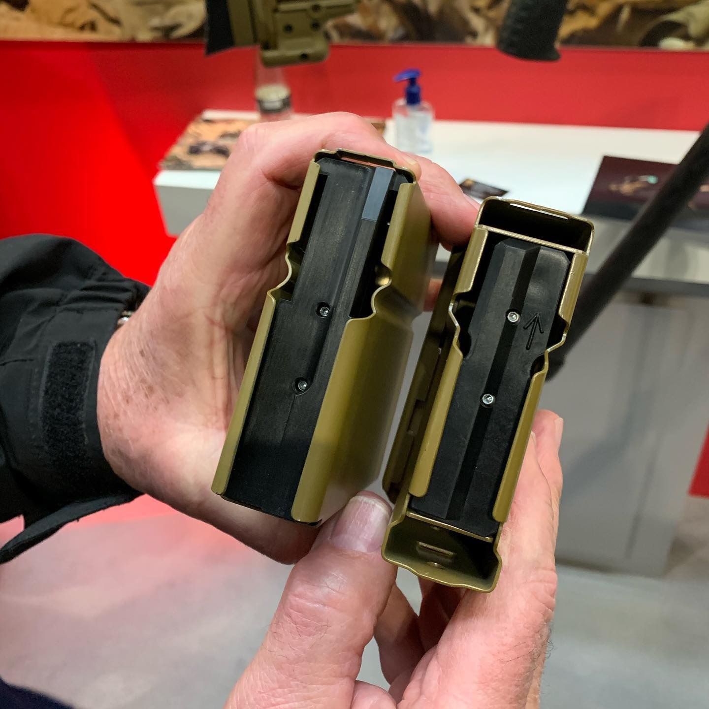

Hey mate, so do AW mags work as well as AX mags in the AT-X? I have a couple extra AX mags for the rifle when it arrives….but over here in Oz we wait a while for things and AX mags are out of stock but there are some AI AW mags still available. Cheers
I've been running AX and AW mags in my AT-X for a year without issues. @hic28 hasn't had any issues either.
@MarinePMI is just having issues with that specific AX mag. Should've had him bring it to my match last month so see how it ran on my AT-X. Lol
Reactions: MarinePMI and Heffo
I have the AX mag that came with the rifle and picked up a new AW as a spare. I have experienced a couple of issues with the AW mag of the bolt not picking up the next round.
But I haven't spent enough time with it to confirm that it is definitely an issue with the mag (most likely from pushing it into a bag) or if it is operator error on my behalf.
Reactions: Heffo
My AW's worked fine, they just don't lock up in the front like the AX mags.
