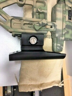

Any suggestions on aftermarket bag riders that you guys like? I'm up in Canuckistan to the north so also on the lookout for someone who ships internationally.
Ebay 3d printed, works slick as hell. Sits very low compared to 90% of chassis bad riders, gets me way up off the ground prone. Kinda thinking bout putting small pic rails on the xlr butt stocks and adding the 3d bag rider to them as well.
Checkout Sawtooth Rifles MBR. They’ll have a small batch in stock, end of next week. With a larger batch going out for anodizing.
Yes, they ship to Canada.

Also, the Gtac bag riders from Sporting Services are good. Faster shipping from the UK to Canada than domestic shipping, shit you not.
usps priority overnight took 2 weeks for me a couple weeks ago .. awesome way to go, and now the UPS pulled some crap on who can ship firearms today

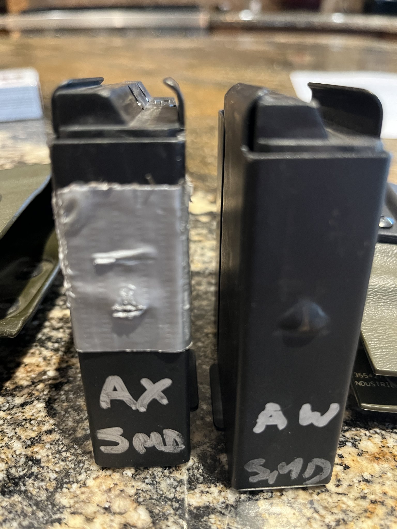

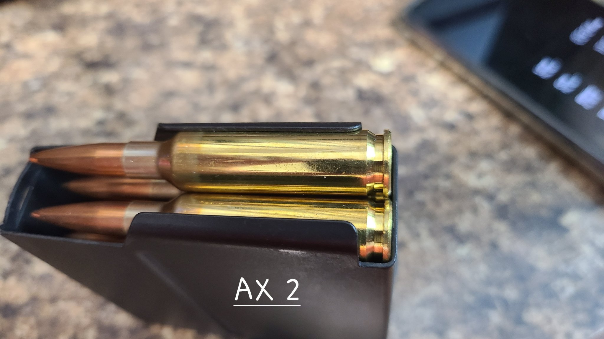

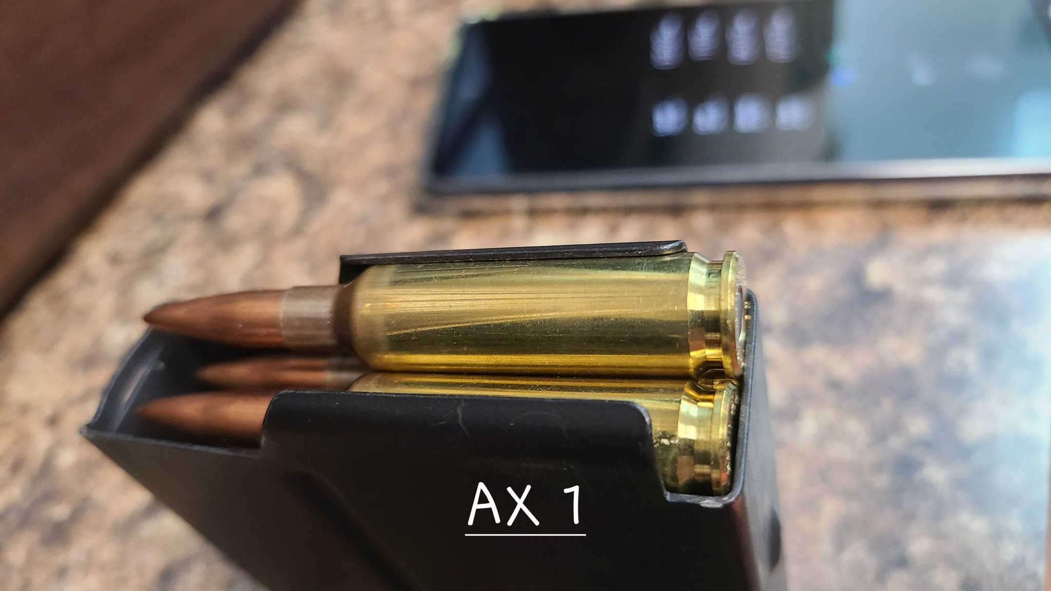

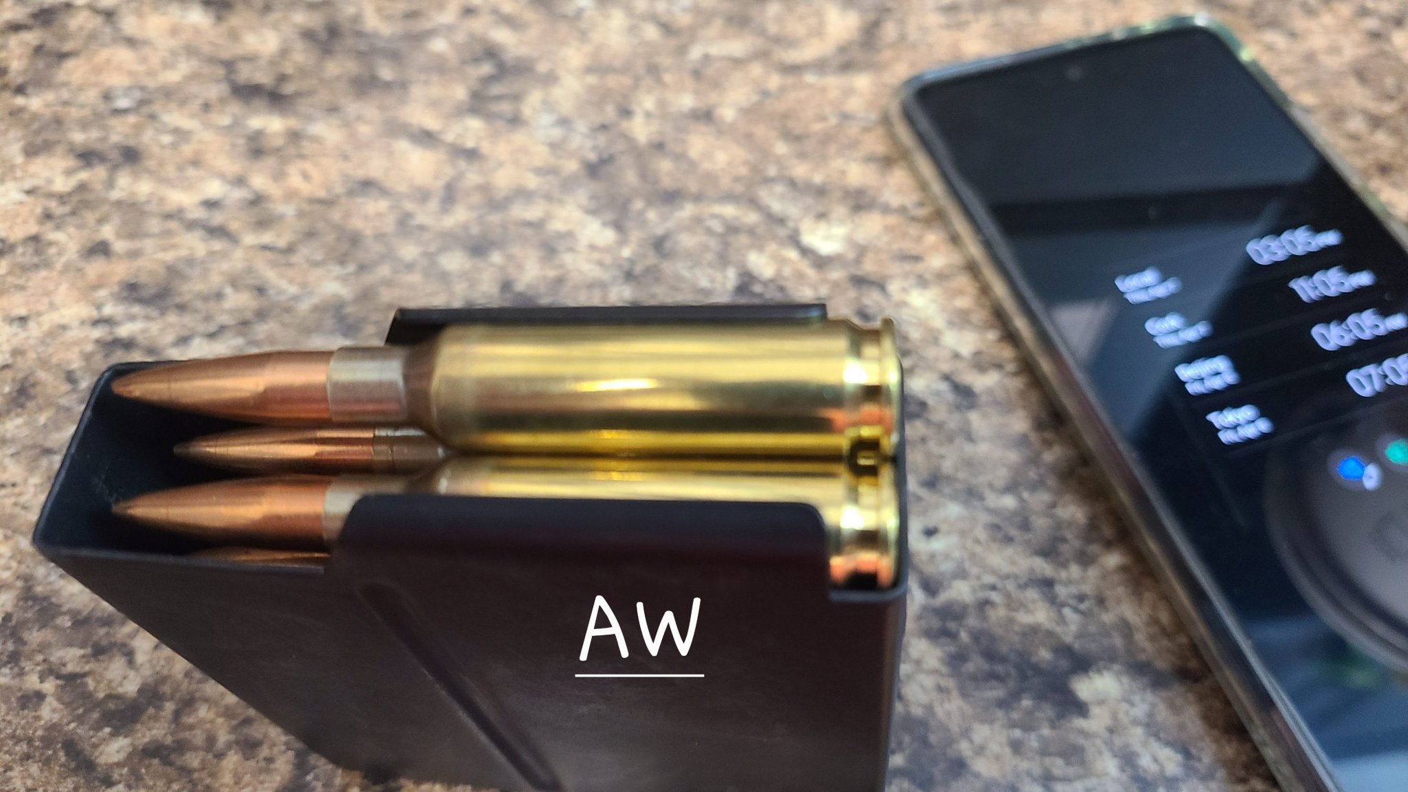

So Ii ran my unmodified AX and AW mags a few weeks back and the AX with 6GT ammo would fail to feed rounds from the left side of the stack pretty regularly. I cycled 4 mags of each the AW never failed to feed. The AX did a couple of times each mag.
Today I ran a 80 round match with a 2 pieces of tape over the back of the AX mag lifting it up, AW unmodified. Both mags ran flawless at the match. I alternated mags each stage. My theory is the AW without the front lip allows the mag to be more horizontal and inline with the bolt and less likely to have the bolt run over the top. The AW still has play and i expect if a stage put pressure on the mag lifting the front similar failure would occur. Not a fan of duct tape on my gear would be interested in shimming the mag catch.
Today I ran a 80 round match with a 2 pieces of tape over the back of the AX mag lifting it up, AW unmodified. Both mags ran flawless at the match. I alternated mags each stage. My theory is the AW without the front lip allows the mag to be more horizontal and inline with the bolt and less likely to have the bolt run over the top. The AW still has play and i expect if a stage put pressure on the mag lifting the front similar failure would occur. Not a fan of duct tape on my gear would be interested in shimming the mag catch.View attachment 7953749
Yep, same thing for me. The AX mags are just slightly off in their geometry and cause the bolt to run over the rear of the case. Like you said, if you figure out a way to lift the rear of the mag slightly, they feed fine.
If you do end up shimming the latch, post pictures of how you do it and how it’s working. I’ve found that running the cases forward in the mag (as if there were a spacer without actually using a spacer) works about 98% reliably. Still need to mess with it a little bit to see if I can get it perfect.

These are 6.5CM Prime Factory, the 6GT Hornady sit the same against the back and along the lips on both sides.
You don't need a shim mate.
This is not the same mag issue that was being discussed earlier in the thread… this is specific to GT cases.
My mags/feed lip engagement is fine, but something about the geometry of the GT sits the case heads too low in the mag when they are fully seated to the rear, causing the bolt to skip over them.
Asked AI about it and they basically said “the mags aren’t designed to work with those cases.” Hence possibly shimming the latch as a solution.

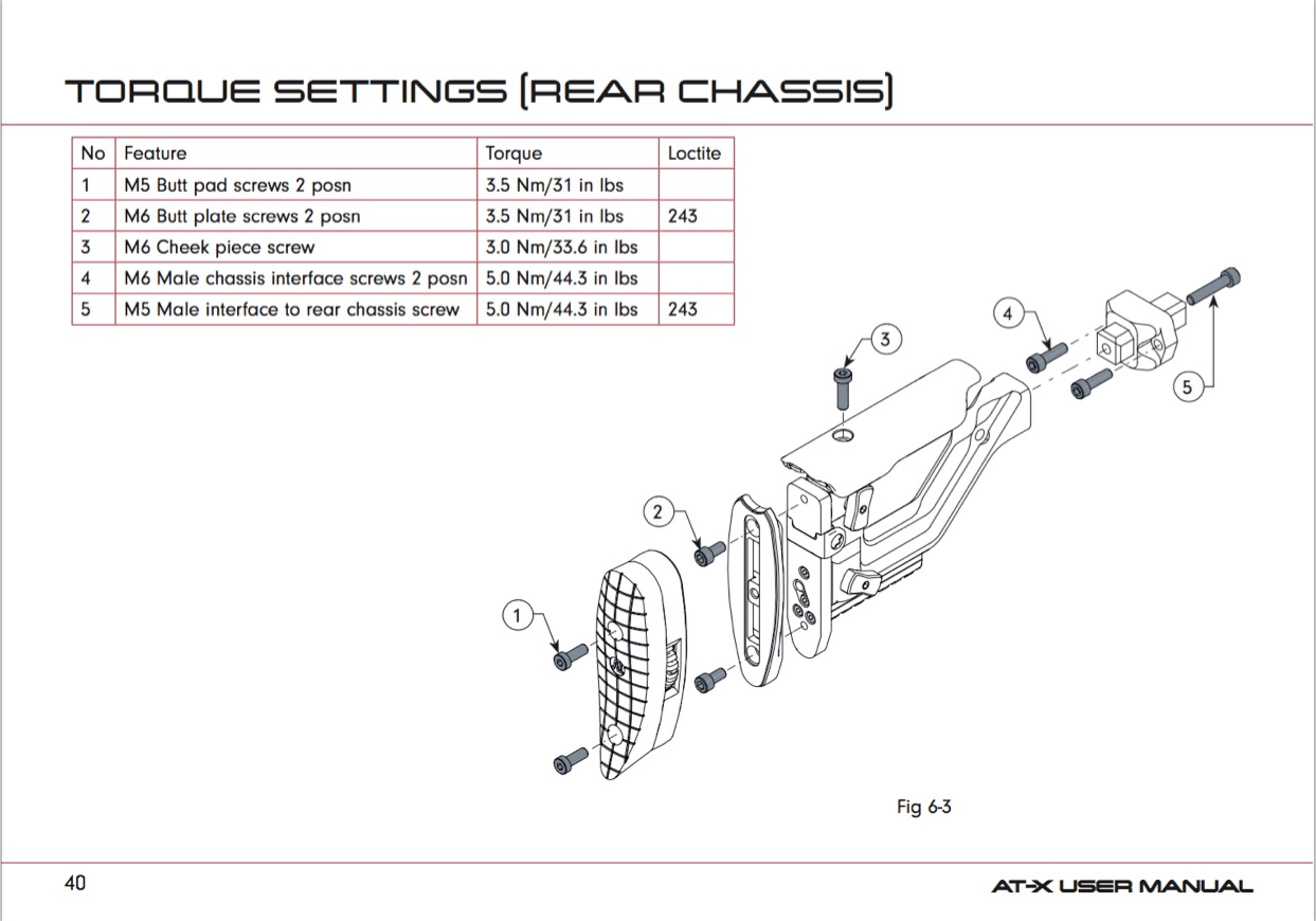

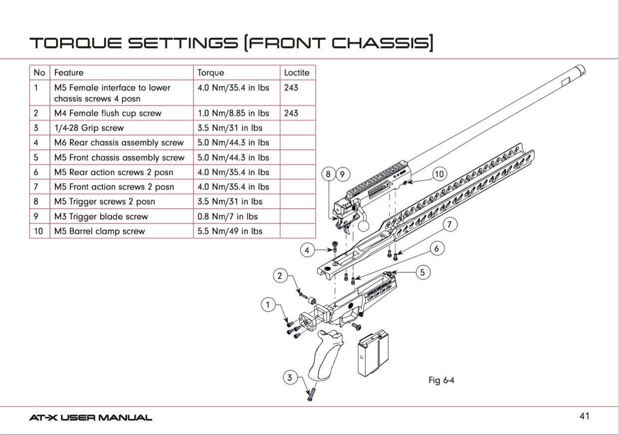

Has anyone stirpped one of these down for a cerakote job? Are there instructions anywhere?
Many have, and I would actually recommend taking yours apart and properly torquing all of your screws. Plenty of instances where they were not from the factory.
Disassembly is pretty straightforward, but these should help.
Thanks. The other reason why I ask is I have a heap lateral of play in my trigger. The dealer in Australia thinks this is normal. I’m not convinced, but this is my first AI product.
