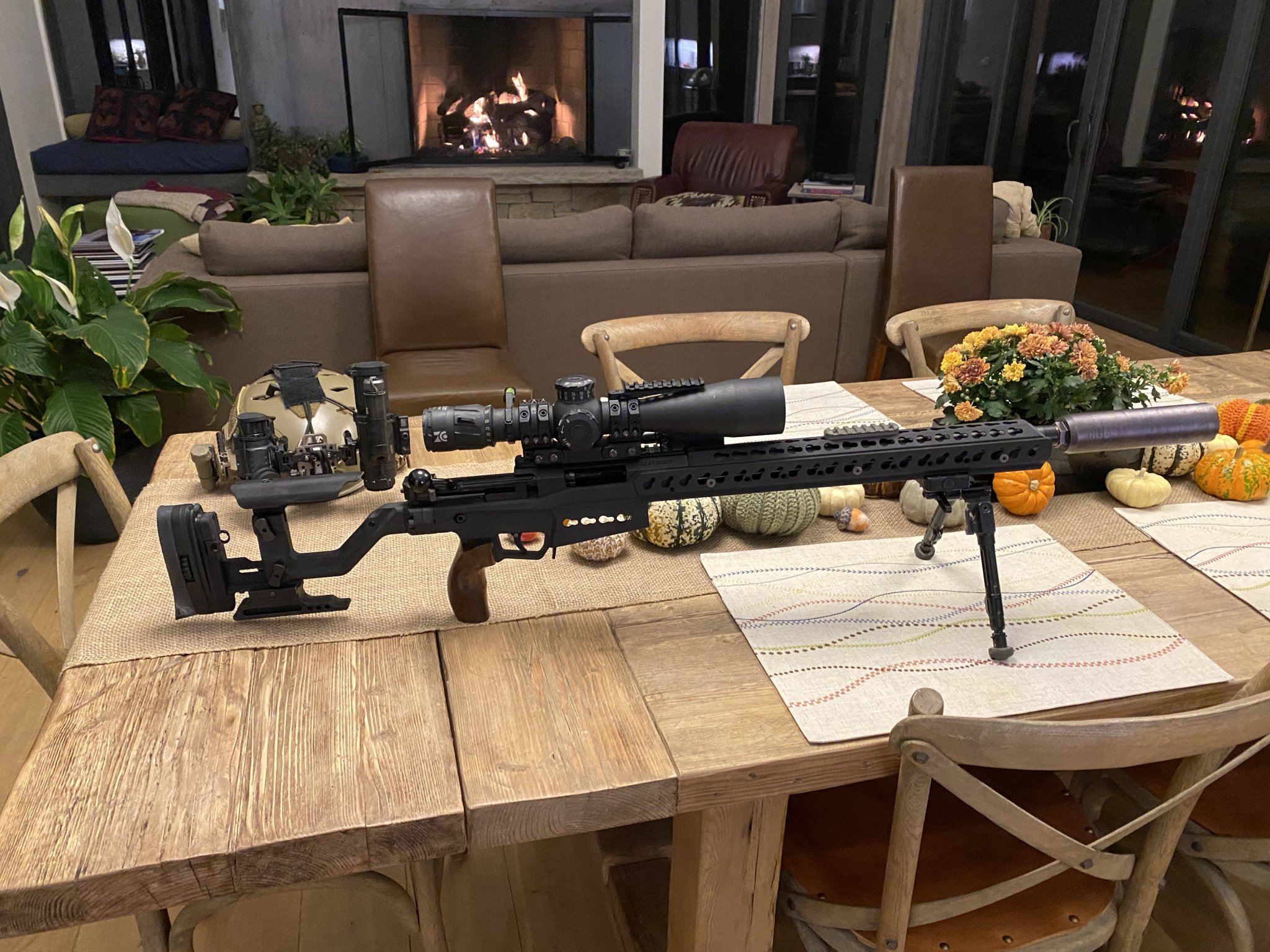

Team AI Australia shooter, we represent the Australian & NZ distributor ‘Delta Tactical’.
This is a pre-production sample to generate interest locally and to get more time on the rifle as a trainer to go with the AT-X.
This one has a Gen1 back end, Allen keys required to adjust. Suits me, my AI’s are all the way in / all the way down. They are parts compatible with AXSR / AT-X / AICS SR so you’ll be able to Lego them into whatever format you want.
The chassis is very similar to the AT-X rifle, extremely well made and comfortable. They will be an excellent option for a lot of styles of shooting from NRL Hunter, hunting, LEO with NV bridges and of course PRS.

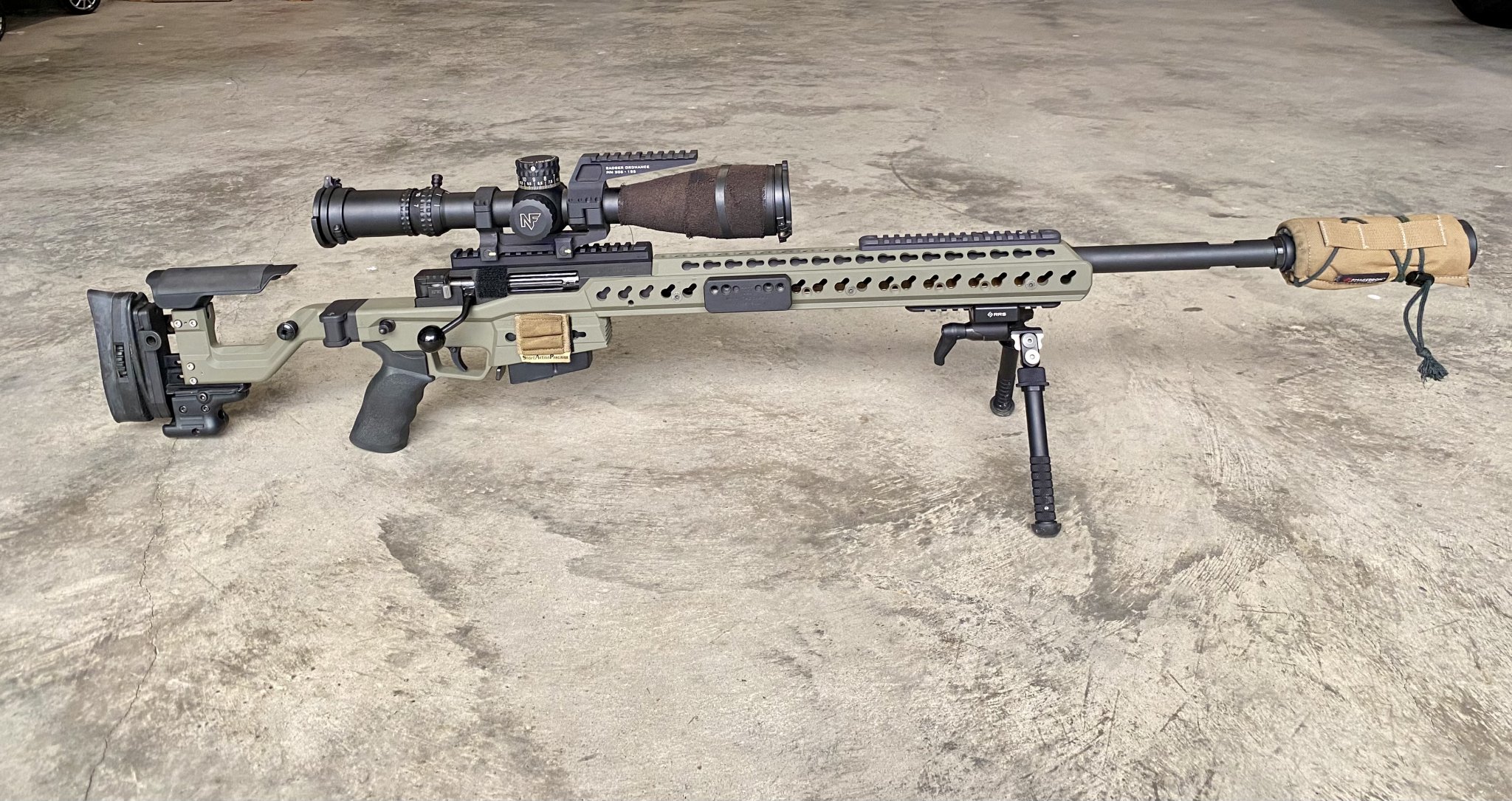

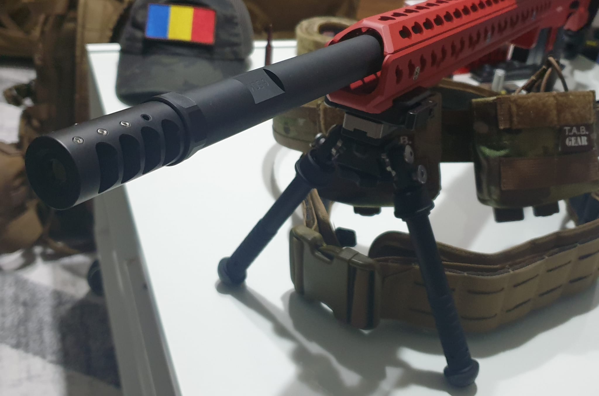

Just got new barrel for my AT-X (6mm XC). Shoots great.
Made some weights for it and realized that I overdid the weight a bit. 26 pounds now... would like to have it at 22, but well see - maybe with another barrel.
300 rounds later i had only 2 empty feeds from the mags, it was in field conditions starting the stage, so I dont know if I did not racked the bolt all way back, or it was the mag issue.
Now after 1 match, I am focused to prepare it for the next season :)
Question: What spares I should carry with myself to matches, maybe you could suggest some basic list? Longevity of stuff? I am dryfiring quite a bit.

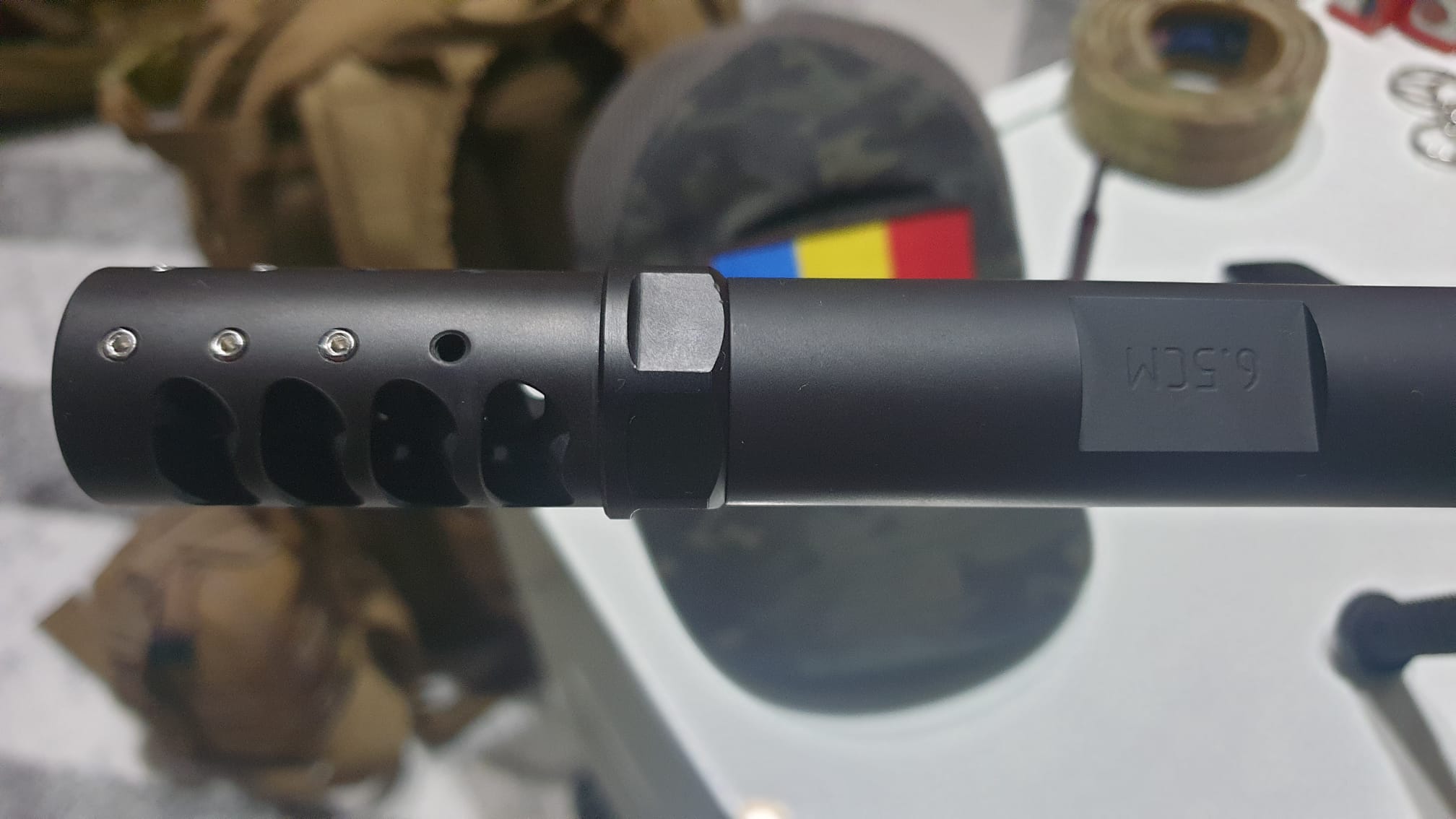

I installed a MDT Comp Brake on my 6.5CM AT-X with OEM 24" barrel. Once installed, the grouplngs opened up. I took it off and they came back to previous. Anyone have similar issues with Muzzle brakes on their ATX?
That really shouldn't be the case that it adversely impacts grouping. I installed an Area419 brake and my groups are even a little tighter than before, regularly seeing 0.3-0.35 MOA with factory Hornady 140gr ELD ammo.
Same here. I use the hellfire break on mine. I’ve got less than half .moa
Reactions: Maciej
Are you using handloads? Hornady 140gr Match?
Yes my hamdloads. 135 atip & 136 lapua sceners hpbt. I’m sure it would shoot 140 eldms as good also but the atips are better for long range (consistently). My bartlien stock barrel has a jam length of like 2.910. I have my loads seated to 2.819. So, I’m jumping about 70 thousandths.
