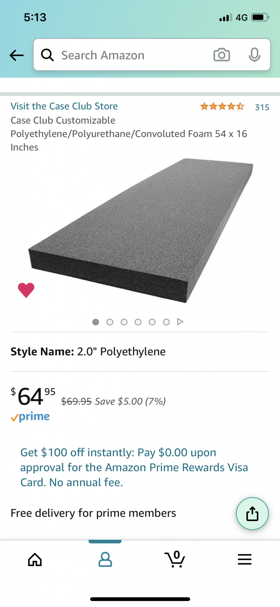

i would also like to know, as that looks like the good closed cell foam. its tough to find that stuff other than in 1" thick layers. would love to know who can and will do custom cut and fitting of the closed cell foam.
It came from case club. It seems to be several layers of the closed cell foam glued together. The case I ordered was for the AXMC rifle. I have altered it a little by cutting out some of the foam that was there to make certain items fit. I asked if they could alter the original foam a little to accommodate some other items but they could not. If I wanted one specific I had to order 10 cases and then I could specify how I wanted the foam to be cut.
Amazon prime has the 2” thick closed cell foam (the good stuff) for like $60 a sheet. Each sheet fits a large rifle pelican/storm case. This stuff was $40 a sheet last November when I ordered it.

They run about $120 with $8 "do over" insurance and shipping. They have a CAD style design program you can use on their website to design your insert. After I made the first one, I used it as a base to design others from. Which is handy became you get an idea of how the deminsions really pan out once you actually receive it and stick a gun in it. If you like I might be able to send you my saved "project" for you to use as a base design. It's nice being able to take a spare barrel with you without it rattling around.
yeah man that would be awesome.

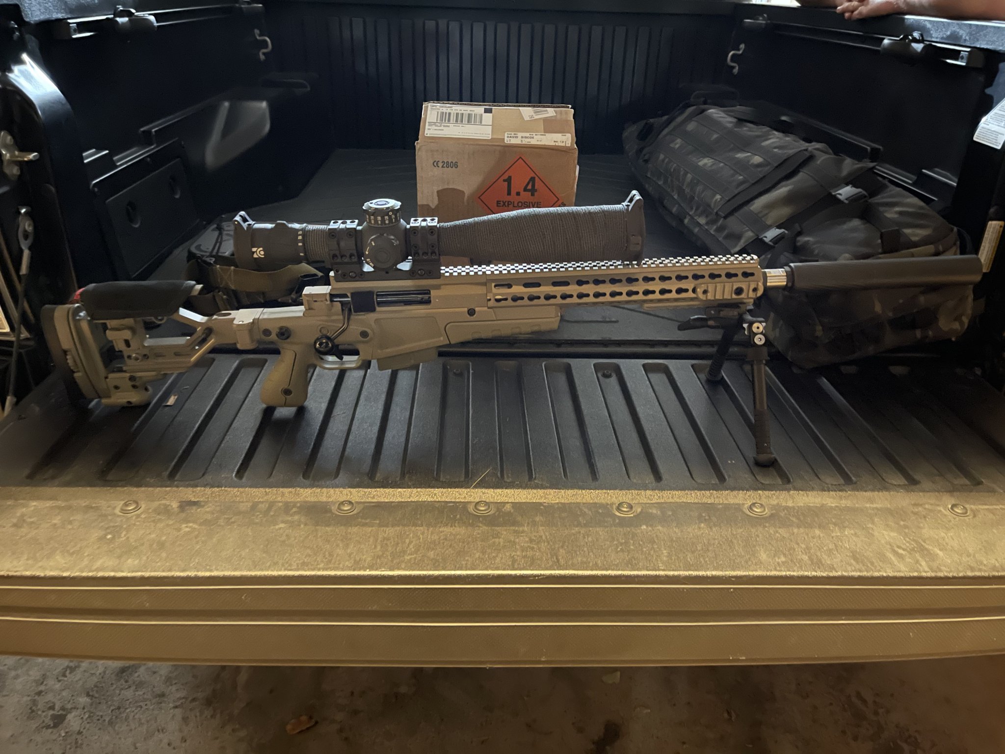

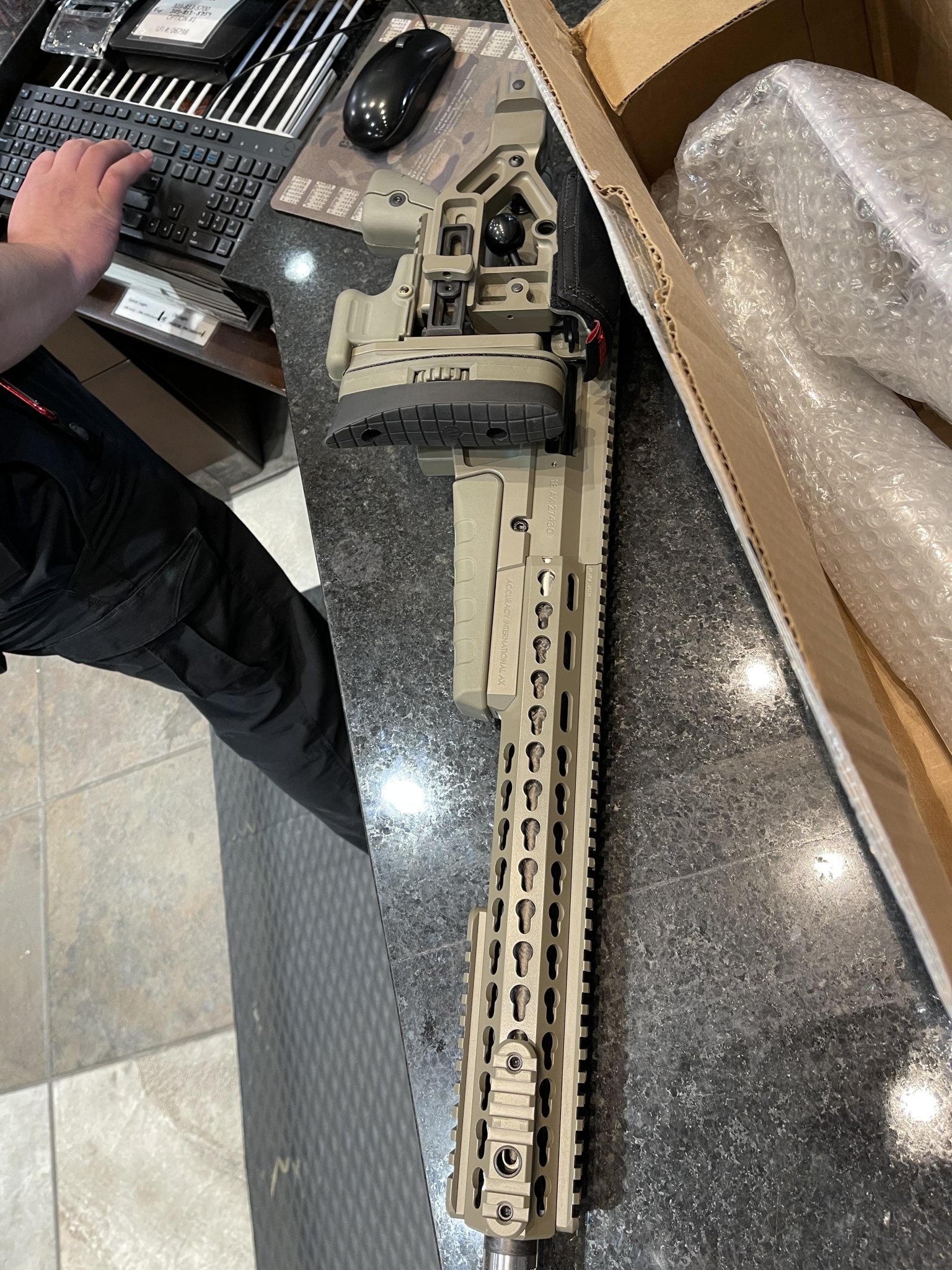

next thing, I have an AXMC, and I want to put a short(16”) barrel on it. Does anyone have one they can throw on, and get me a total overall length? Thanks
Reactions: Krob95
Sorry I’m a bit late to the hat discussion. I’ll have to find mine. I got it when I was in the UK last year. On mine, where it’s embroidered “finest sniper rifle” or whatever it says.... rifle is spelled wrong lol.
You can't run a 16" tube with the full length axmc handguard you will need to find one for a axsa which is 13"...I already went down this road last year I think you can get away iirm with 17.5 with the factory length axmc 16" handguard...I guess technically you could run the 16" tube but like only 1/8" will be sticking out of the handguard
Reactions: kocustoms
Now that you say that, I remember you talking about that. Thanks for the info. With the regular MC handguard, does 17.5 give you enough to grab on to to tighten the barrel?
Don’t you have your MC in hand? The math is easy. Measure the length of the handguard (~16”) then add the tenon length (1.5”) and muzzle thread length (0.6”). Then add however much you want to stick out.
Don’t forget with the AX series you can remove the handguard when installing and uninstalling the barrel. It’s only 2 screws, so it’s not a big hassle to remove it. That way you could have an 18.25” barrel that you could still hand tighten, but only sticks out the front enough for the threaded muzzle shoulder to clear the handguard.
What are you looking to have on the end? A brake, a threaded break ready to accept a moderator. If an independent moderator, what moderator.... is it end of barrel or does it reflex down the barrel at all?
Clubsportmark, my current plan is a 20" barrel contoured for an aem5, which reflexes about 2.5" from the muzzle.
Sam, I should have known it would be that simple. I didn't know if the handguard had a nominal length like some on the market do. Some quick math says I should be ok, but barely.

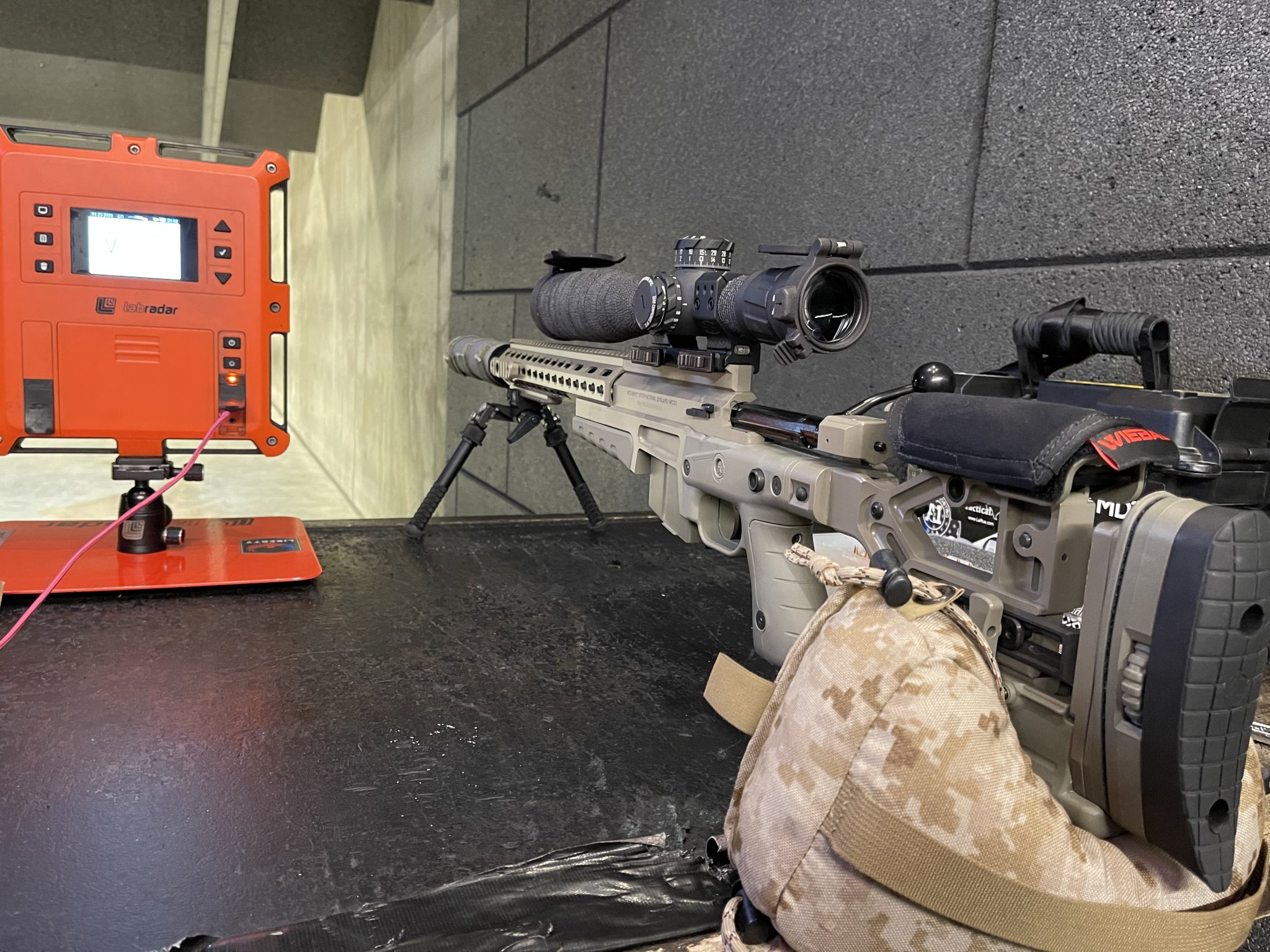

Range date with the new girl went well. I think I’ll have a second date with her tomorrow 😂 found some good nodes right where others found them so I’m gonna start the jump tests with the VLD’s. And do a ton of dry fire before hand because wow, it’s a whole different animal from the TT 2 stage diamonds I’m used to.
Range date with the new girl went well. I think I’ll have a second date with her tomorrow 😂 found some good nodes right where others found them so I’m gonna start the jump tests with the VLD’s. And do a ton of dry fire before hand because wow, it’s a whole different animal from the TT 2 stage diamonds I’m used to. View attachment 7480754
Indoor??? Wtf is this bush league?
Indoor 100yd range that I have a membership at with a free Labrador, hell yeah. Makes load dev super easy. And I don’t have to freeze to death in the harsh Colorado winters 😂 and it extends my shooting window to 8pm instead of 4pm or whenever it gets dark now
Sorry rechecked my notes...18.5-18.75" prolly to play it safe overall length would get you enough for wrench flats and .6ish muzzle threads...
I said screw it and just went back to my 20" win tac barrel

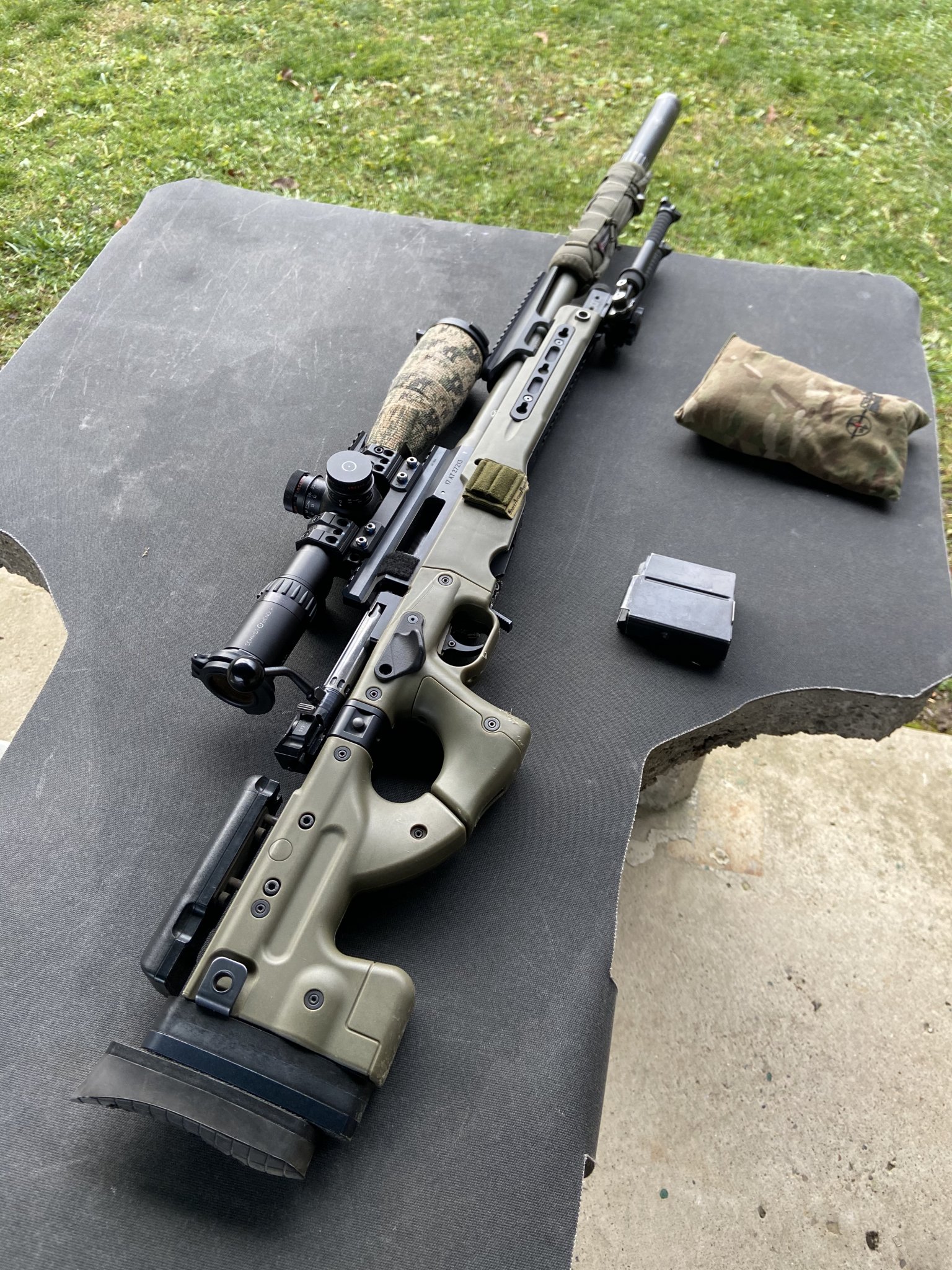

I haven’t seen it talked about in awhile, but while I had everything disassembled for my chassis conversion I swapped cross bolts out on my Spuhr. It’s a decent feature for A.I rifles because we always have a 4mm Allen on our person.
I called Mile High to get the specific size for my particular Spuhr, because there are 2 sizes, then I ordered the 4 bolts from bolt.com for less than $5 shipped.
Just wanted to bring the topic backup for some that haven’t thought about it. 🍻
Edit: I know it’s dirty, it’s always dirty 😍

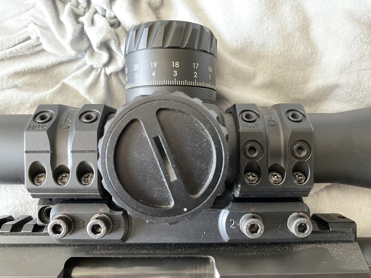

What is this scope mount ?
