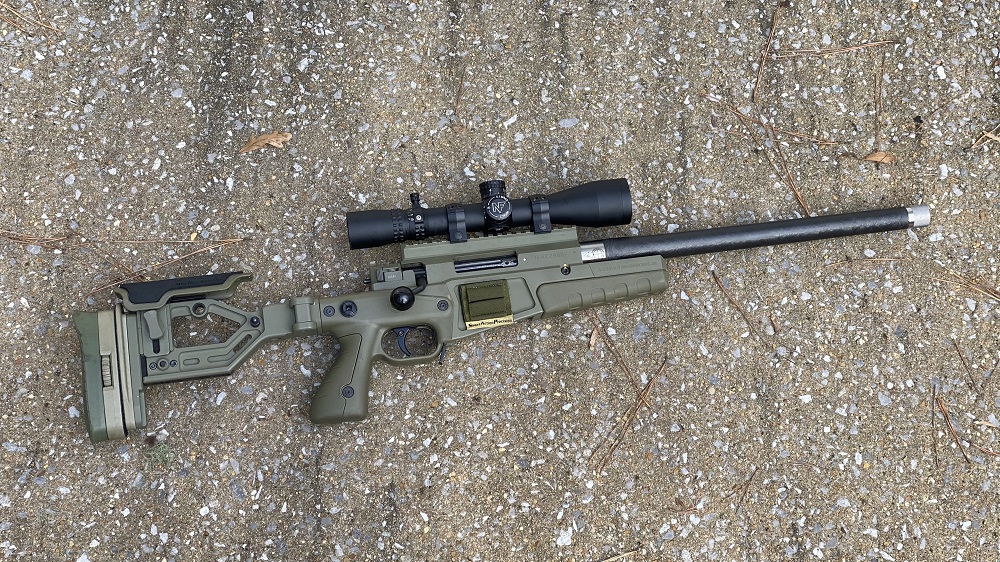

Just take it off. This was as light as I could get it with my hunting scope thrown on there. 11lb-14oz. Rings are too low to get a good sight picture, but the concept is there. From here one could 3D print a non adjustable butt pad mount, and use the low profile cheek piece, low scope rail. upper 10lb range is possible.

Any chance you could make me a simple, light weight NV rail/forend that attaches to the AX, that has the factory forend removed (like in pic)?
And a lighter weight RRS rail attachment for front plastic handguard?

I honestly don’t see the benefit, you’re talking saving a few ounces for something the rifle wasn’t really designed for. Even if you cut the weight of each piece in half, what does saving 8 or maybe 12 ounces really get you?
Anything can be designed and made for a price, but it’s likely the market for something like that is extremely limited.

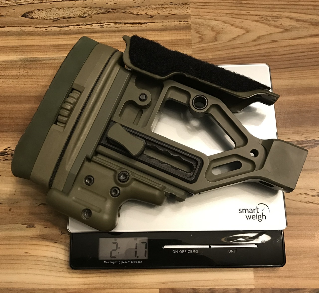

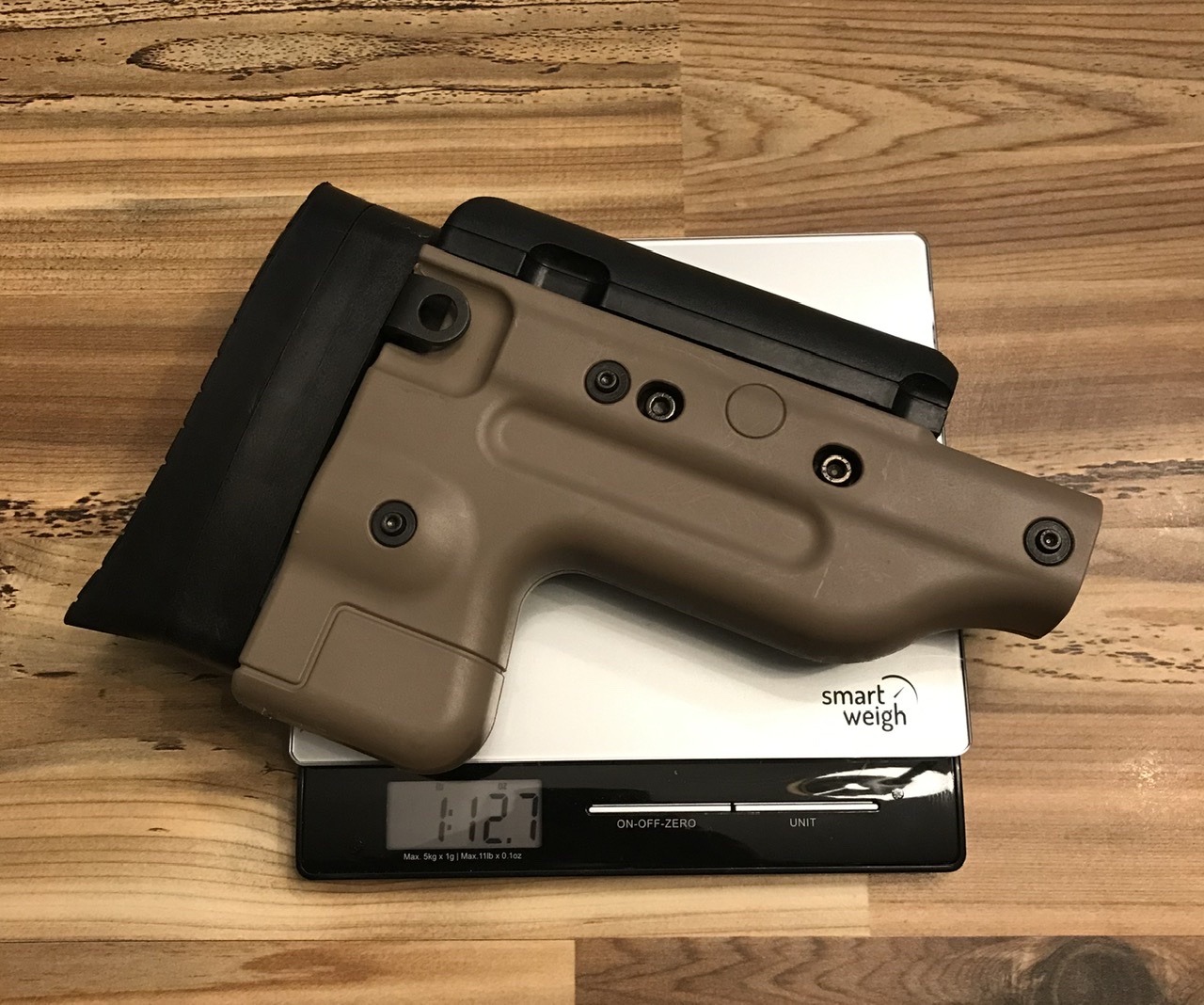

If anyone is wondering, here is the weight of the AT buttstock versus the AX. Note that these are weights WITHOUT the folding hinge, but they are the folding variants of the buttstock.
They are a lot closer than I was expecting.
AT= 1 lb 13 oz
AX = 2 lb 2 oz
The hunting market is Yyuge... And giving that market a bomb proof hunter I think would be the cats meow. The AI has never failed me, even hunting in -30°F weather. Frozen and snow covered the AI keeps shooting. Now if you can save me some ounces here, it adds up to pounds in combination with thinner contour barrels, lighter scope, etc. For unsupported positional (hunting situations), field movement, and conserving energy in the field those ounces are a big deal, especially when fatigue sets in.
Curious, what's that AX stock weigh with plastic bag rider and pic rail removed?
The hunting market is huge, but I don’t believe there is any sort of market for stripped down, $6500 AXs made as light as possible by removing the majority of their components. They’re just not lightweight hunting rifles; even if you strip it down to the action alone it’s going to be heavier than any normal hunting action. And I would much rather design my AI chassis to be lighter than try to cut 4oz from an AX tube.
Without it in front of me I’d guess that the pic rail and bag rider are 3-4oz total, if that.
