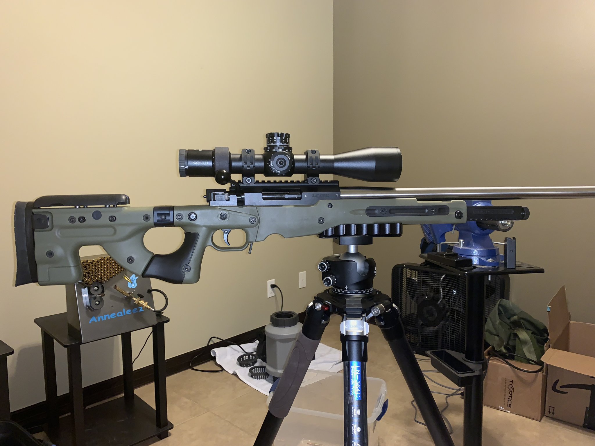

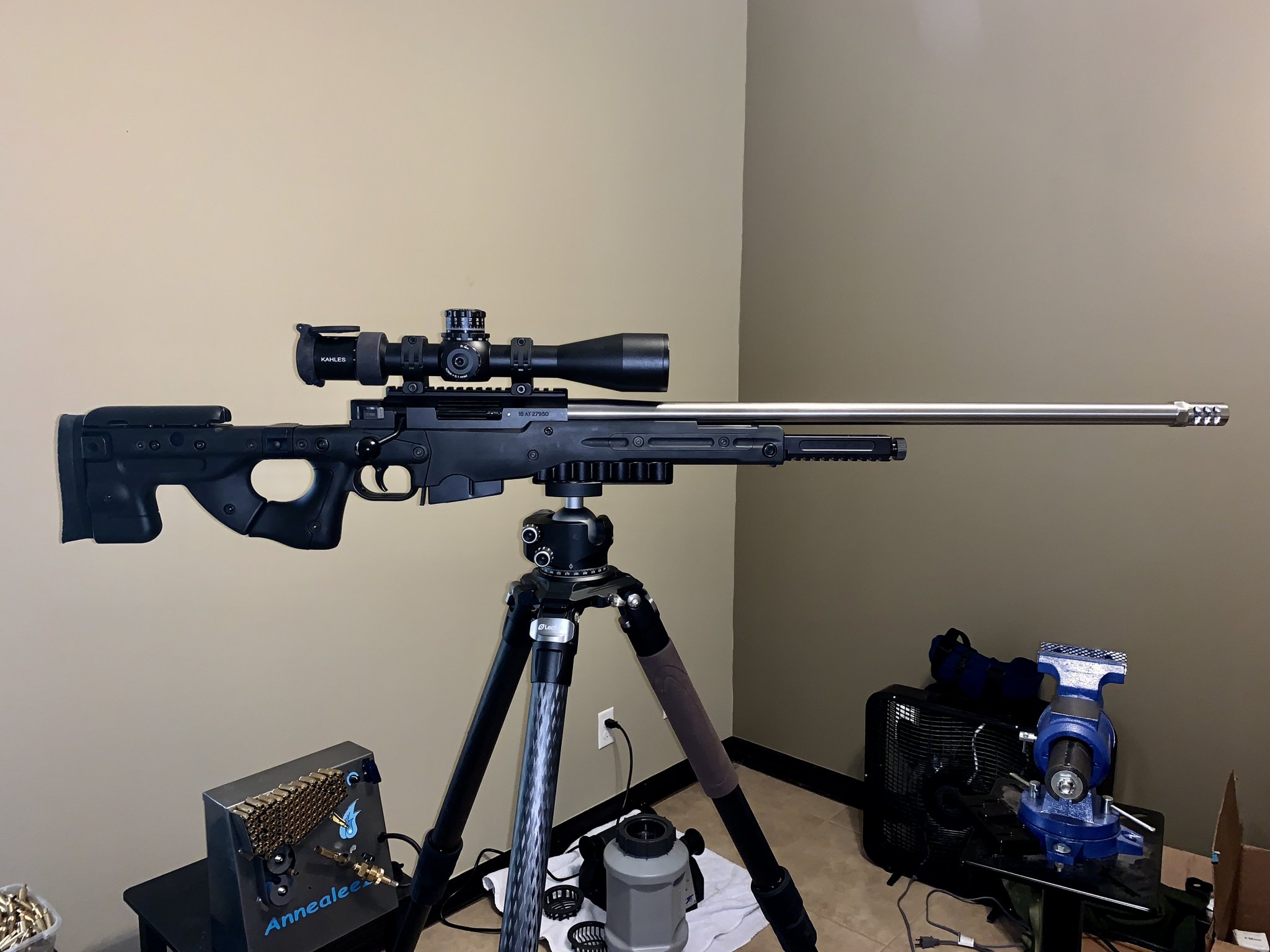

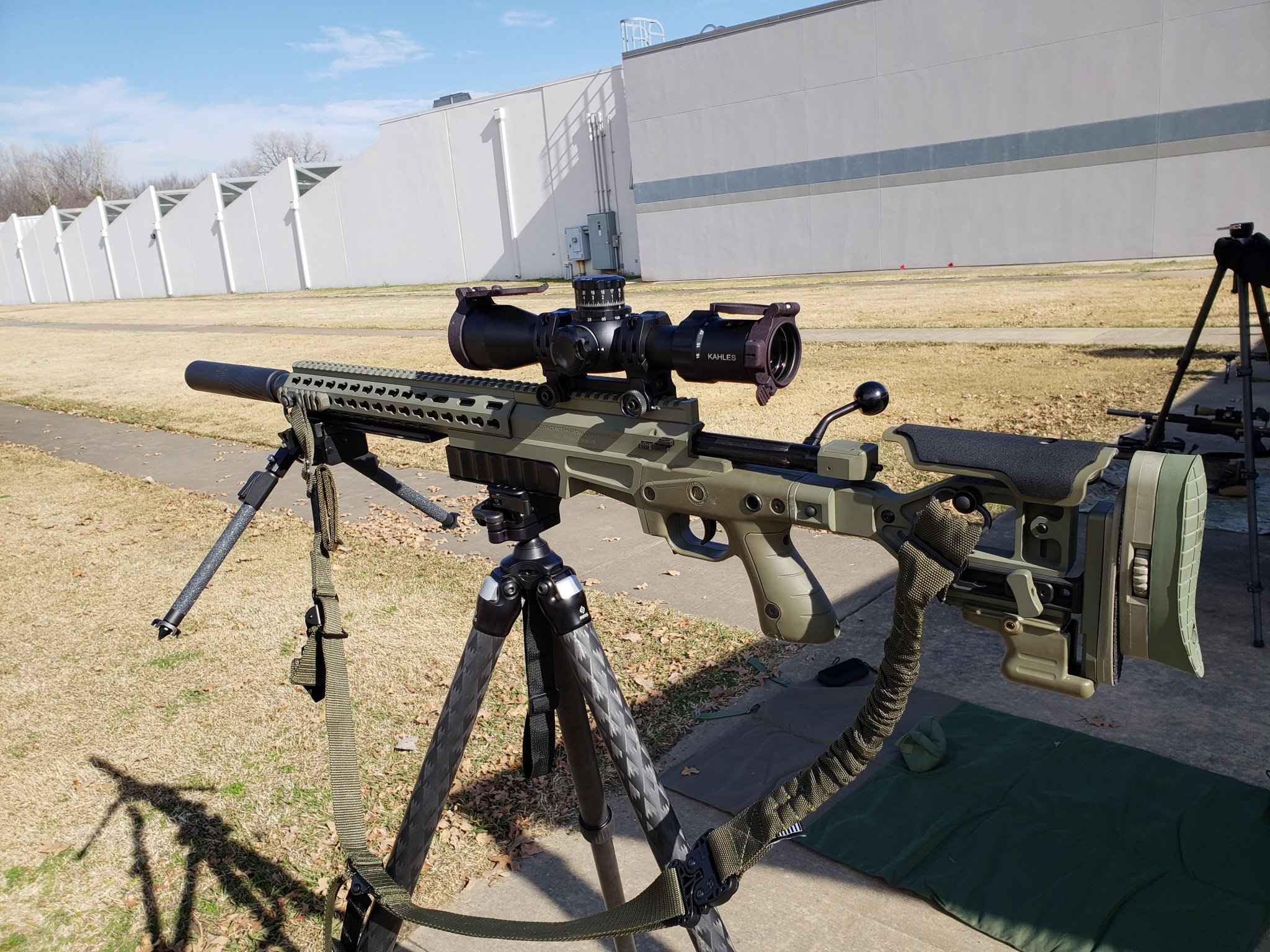

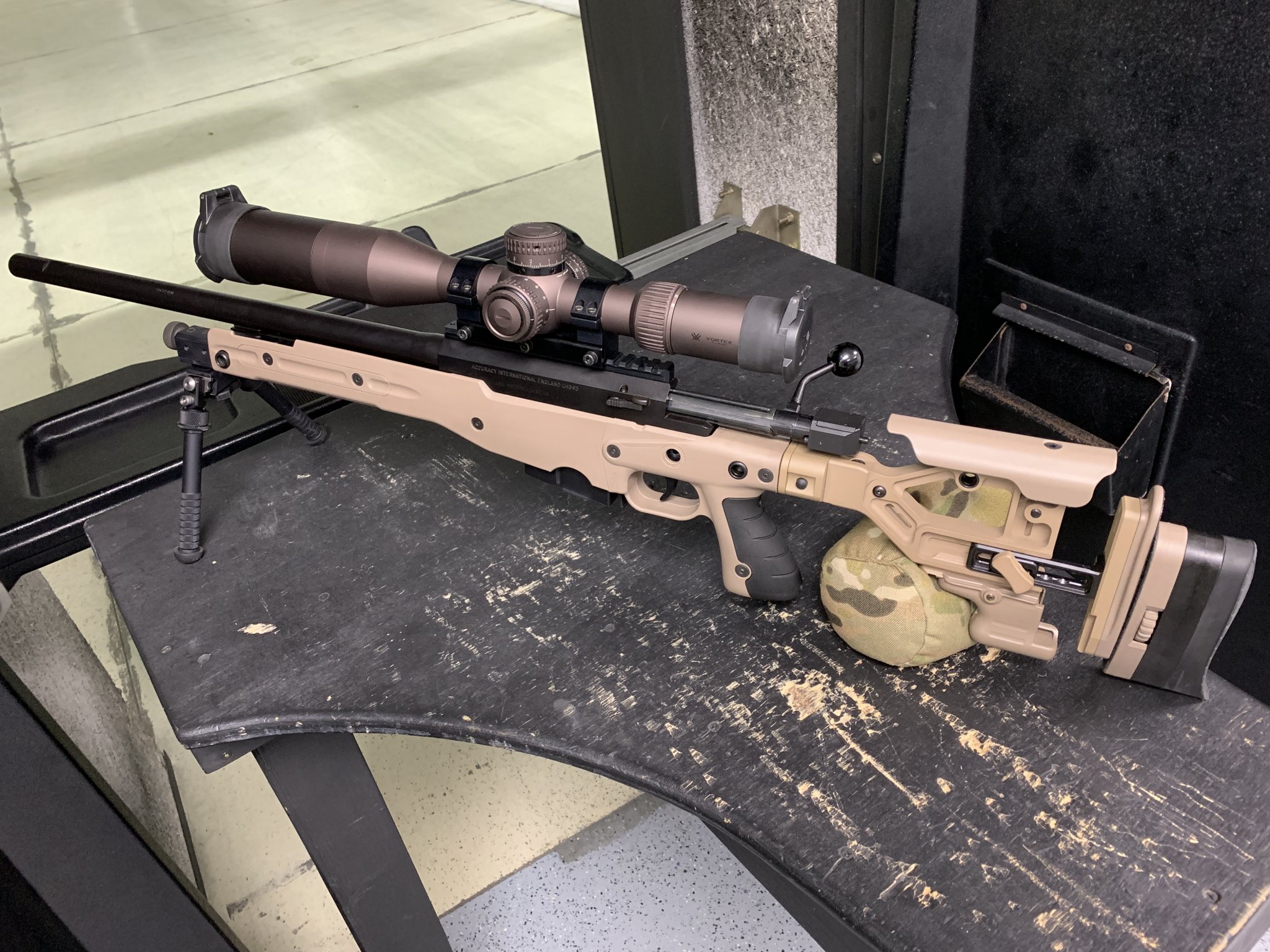

Just got back from my shake down cruise after doing the AX stock conversion. It’s a little pricey but I’m glad I did it. The rifle fits me even better now.
Now to work on tightening the nut on the trigger. Shot this 10rd group with Hornady 178gr match at 100

It looks great! Was it worth it and did you have to mount your scope higher?
Reactions: Luvman
I think it was. My AT was a factory folder so I sold the stock I took off, which can be used to convert a non folder to folder, to offset part of the cost.
I am running an AI scope mount on the low rail. I believe the mount is listed as the 40mm height (which AI says won’t work for a 5-25 PM II on an AX). It appears to be 30mm height by everyone else’s standards. With the cheek rest bottomed out it’s perfect for me. If it were any lower I would need a new mount. A 34mm height mount with the low rail should work fine.
I tried to make a cheek rest cushion out some 1/8” closed cell foam weatherstrip and it made the cheek rest too high. It’s that close.
If I had known when I bought my AT that a non folder could be converted to an AX stock I would have bought the non folder and converted it.
As it stands I’ve been waiting for the AX conversion to be in stock for almost 6 months.
Reactions: Badfinger
Thanks for the response I thought the stock looked a little higher but glad it worked out.
5c5b7f8c-3fa7-4072-93e9-6ca7fe434eee-jpeg.6991027

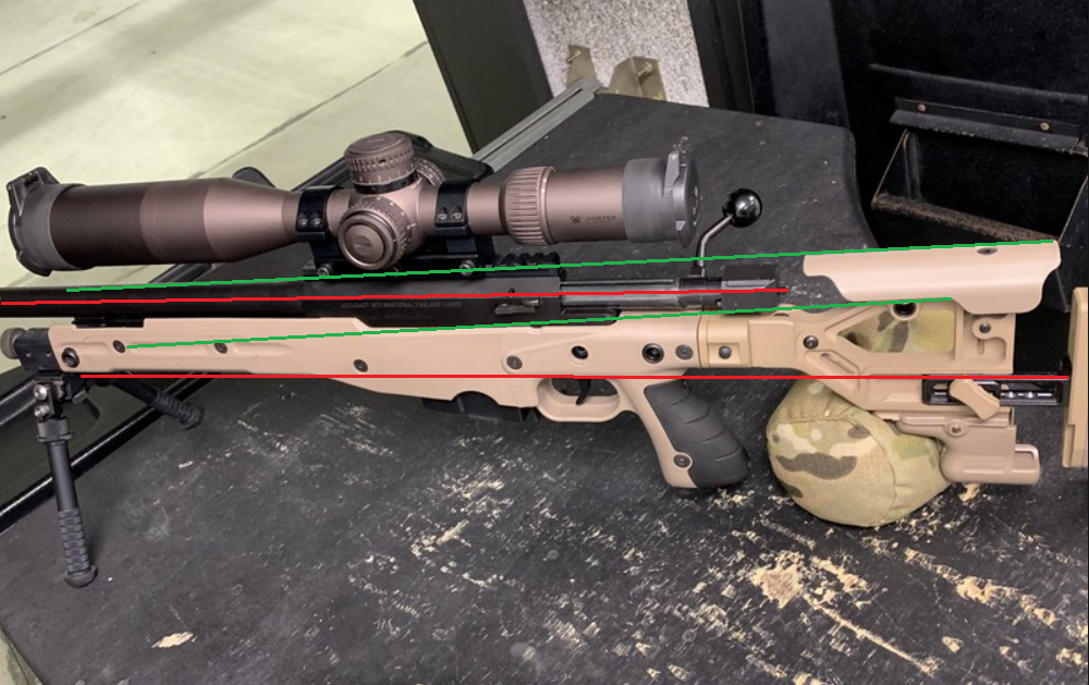

Not sure if it’s an optical illusion, but it looks like the cheek piece is angled downward toward the front? Looks a bit odd.
I mentioned on the other threads that I’ve got something in the works to lower the cheek piece on the AX buttstock. It nets about 0.350” lower than the lowest factory setting. I don’t want anyone to wait just on me, but I’ll be trying to get these made soon.
It does seem to angled down. I haven’t dug in to figure out why because it works as is.
@samb300 im interested to see what you come up with. I would like to get the cheek rest down a hair lower to run a soft cheek rest on it. Price depending of course.
I think it's just an illusion, I levelled the stock in Photo Shop and then the scope and the cheek rest look like they're leaning forward. I like it but it's not necessary for the shooting I do. I love to tinker but I'll pass on this one.

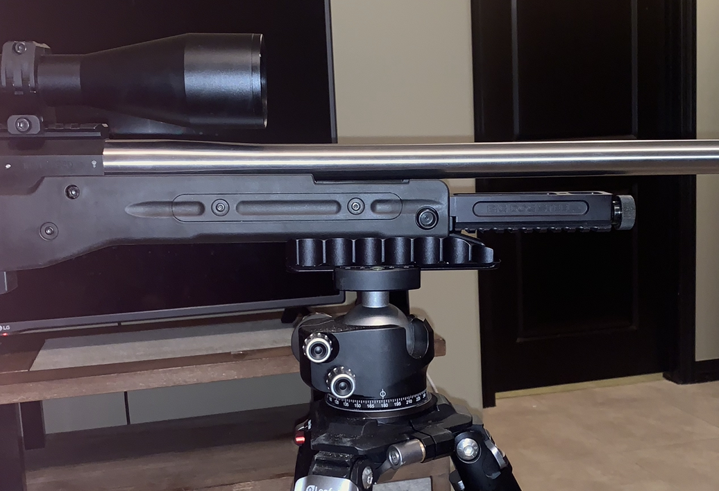

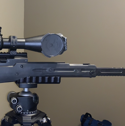

Anyone ever put 2x gen 1 RRS plate on an AT?
I like how far back the gen 1 sits and the finger grooves. And I like the gen 2 full length.
Seems like there is enough room to back 2 of them up to each other.
See pics for direction each on would face.
From the marks I made, there would only be about 1/8” gap between the two and enough room to mount them both.

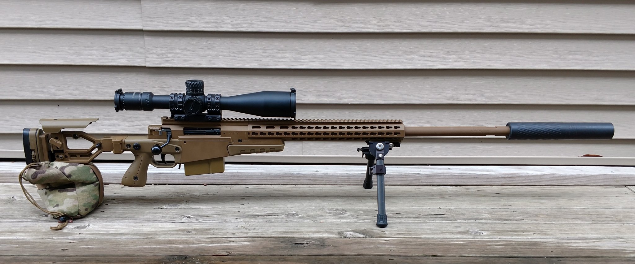

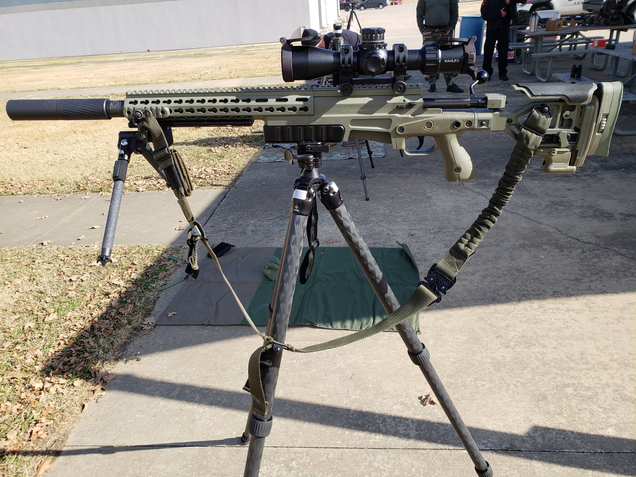

Here’s some more pics of the Tungsten AX with the 16" .308 now that I have the AMG and Venom on it. Shooting .308 sub sonics with the Venom is a hell of a lot of fun. I’m patiently awaiting arrival of my Proof 6.5x47L barrel, I ordered it in October and they said mid to end of December ship date, but everything I’ve heard said around 5 months is average, so I guess I’ll see.

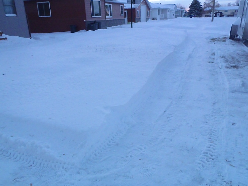

This is of what I speak;
We got a 6-8" dump of white stuff last night. Spent 6 hours today moving it out of the way. The photos not so good, that's about 12" in front of the place I live.
This is the stuff that has me seriously considering a tripod. My AT is a .308, 175 SMK's reach1,040 yards with about 11 mils up. Wind sure plays havoc out that far. That's what makes it fun.

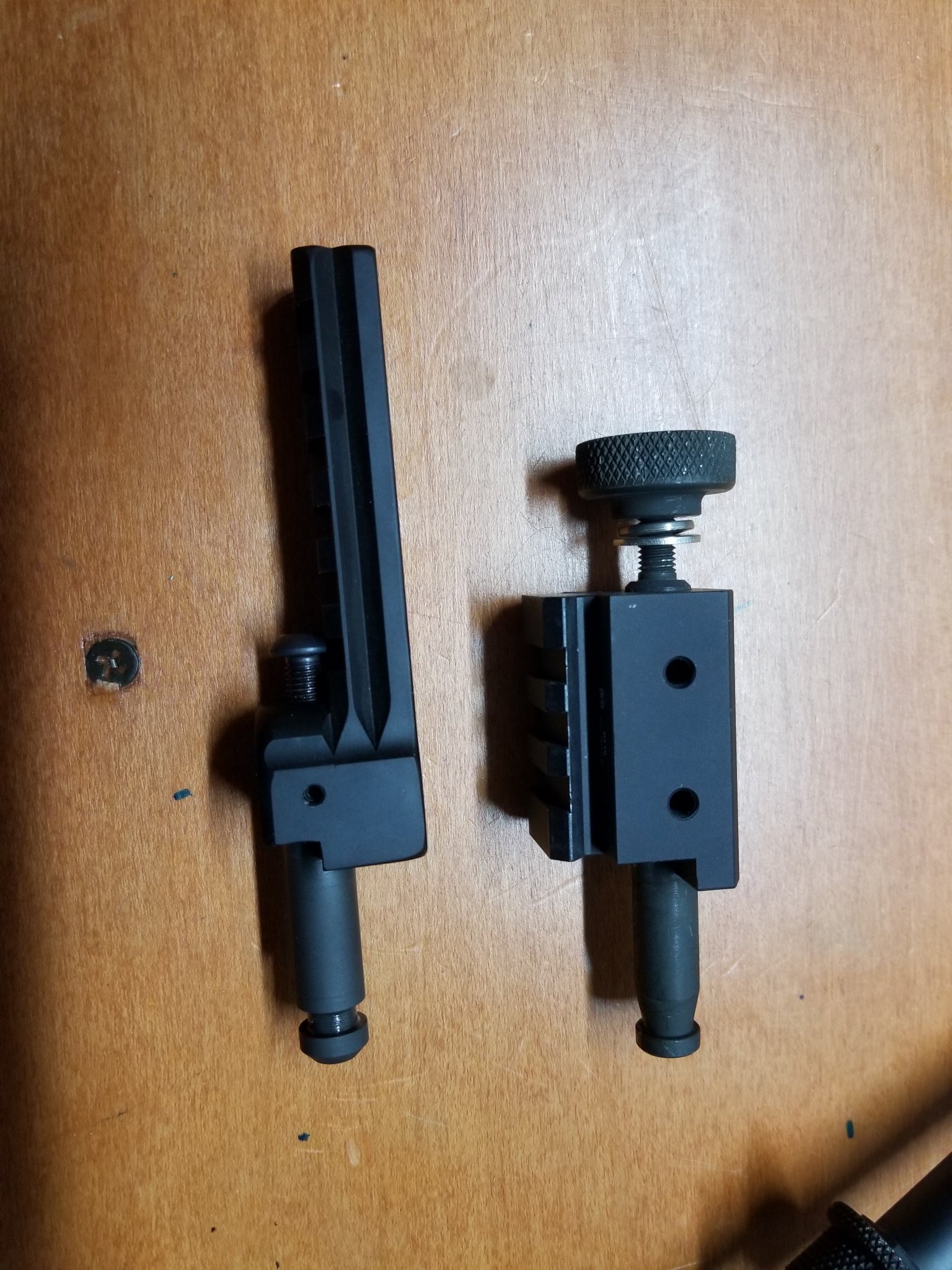

I got pretty much everything sorted out except the spigot mount. I plan on running the RRS BAI-AT so I can’t use a full length ARCA rail. Is there an issue with the newer gen BT19 and BT20 that spawned the need for the Sam Burns spigot mount or the Big Dog Steel Mount? I have heard of the BT19 not locking up tight and rotating. Supposedly the second gen fixed this.
Anyone with preferences on AT spigot mounts please let me know.

I have a bai-at gen 1 currently with another on the way.
I also have the gen 2 that should be at my door when I get home.
Going to experiment with 2x gen 1 backed up to one another and the gen 2 full length.
I figure the key slots are pretty fast to take off, so on a small port hole stage, just drop one or both gen 1 plates off before the stage

The reason I originally created the replacement bipod mount was because I couldn’t get the BT19 to lock up completely tight.
My bipod mounts will be happening again, and soon. Both picatinny and Arca Swiss versions, for the AT and AE systems. Stay tuned, I’ll keep you guys updated with an official announcement.

I almost (almost) cant wait until my AX needs a paint job. Loving the tungsten and black combo.

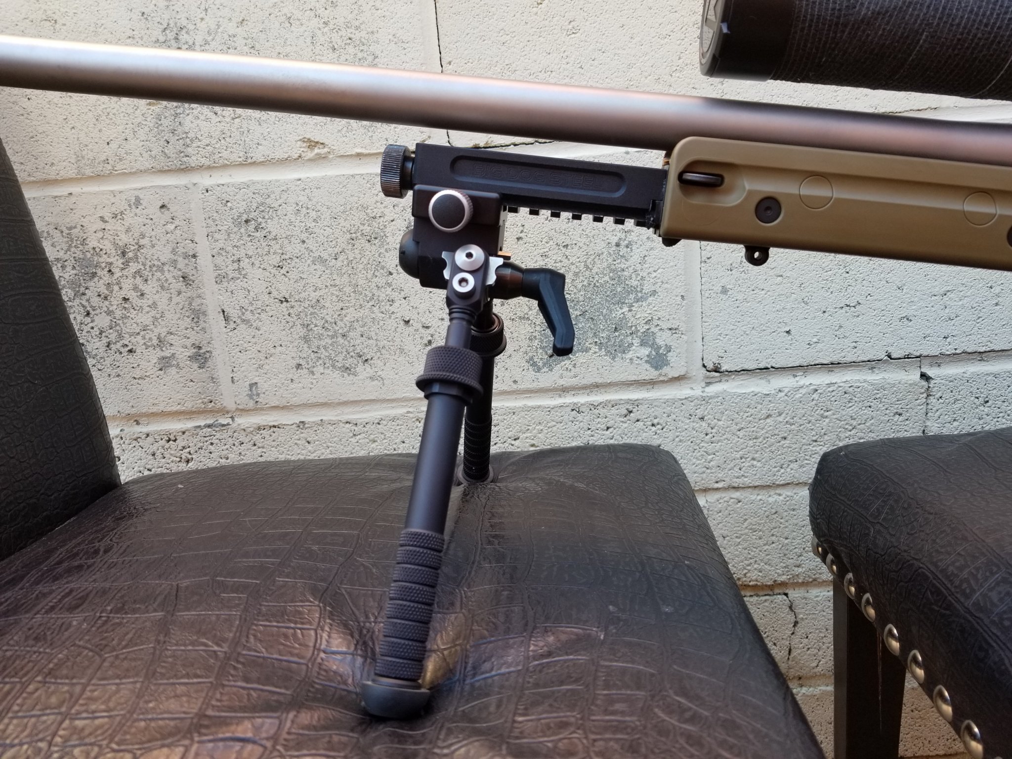

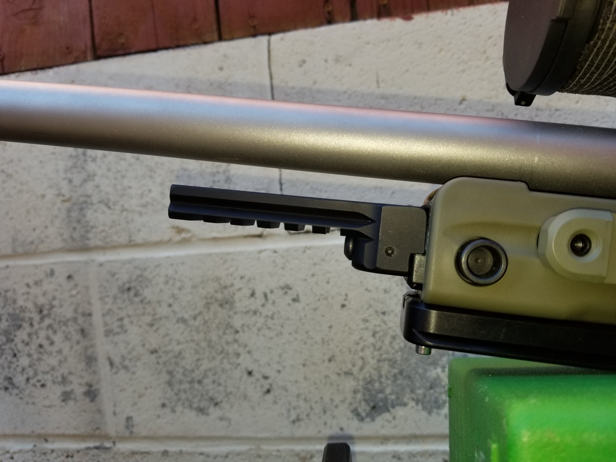

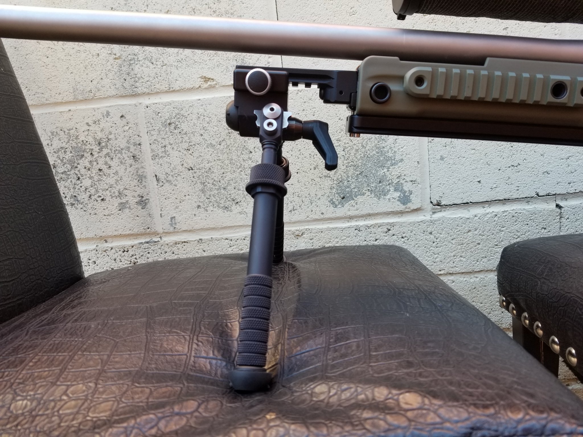

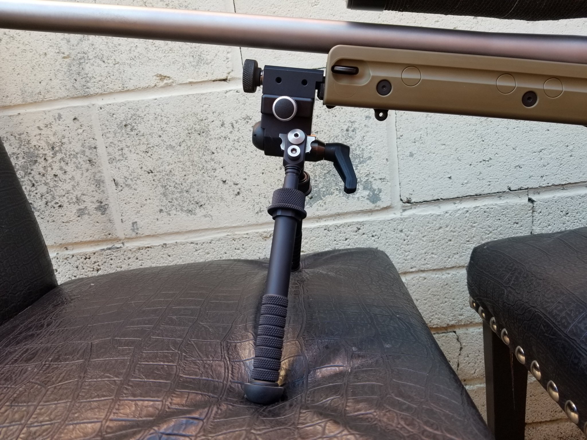

I have the BT19, Big dog gen2 and Elite Iron and prefer Eliteiron. Locks up tight, and the bipod attaches closer to the barrel.
EI
Atlas
BIG Dog
Reactions: blbennett1288
Interesting. No wobble like you see with the BT19 or Big Dog? I've been waiting for Sam to bring out another run of his, but I like how this raises the bipod up about half an inch closer to the bore or so. I may have to spring for both and just keep the better of the two. Sam's mounting system seems far more secure overall, though. Choices, choices...
