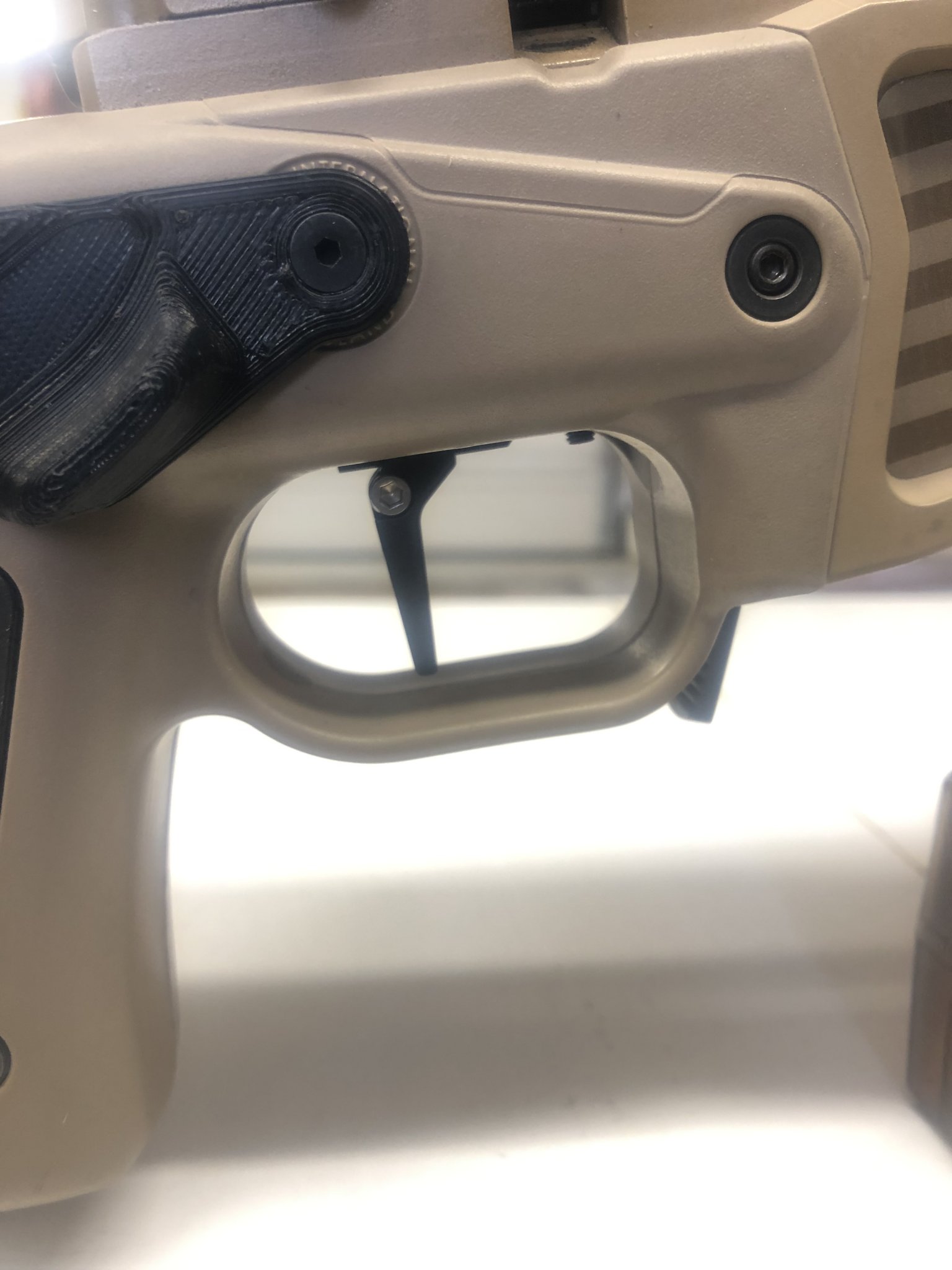

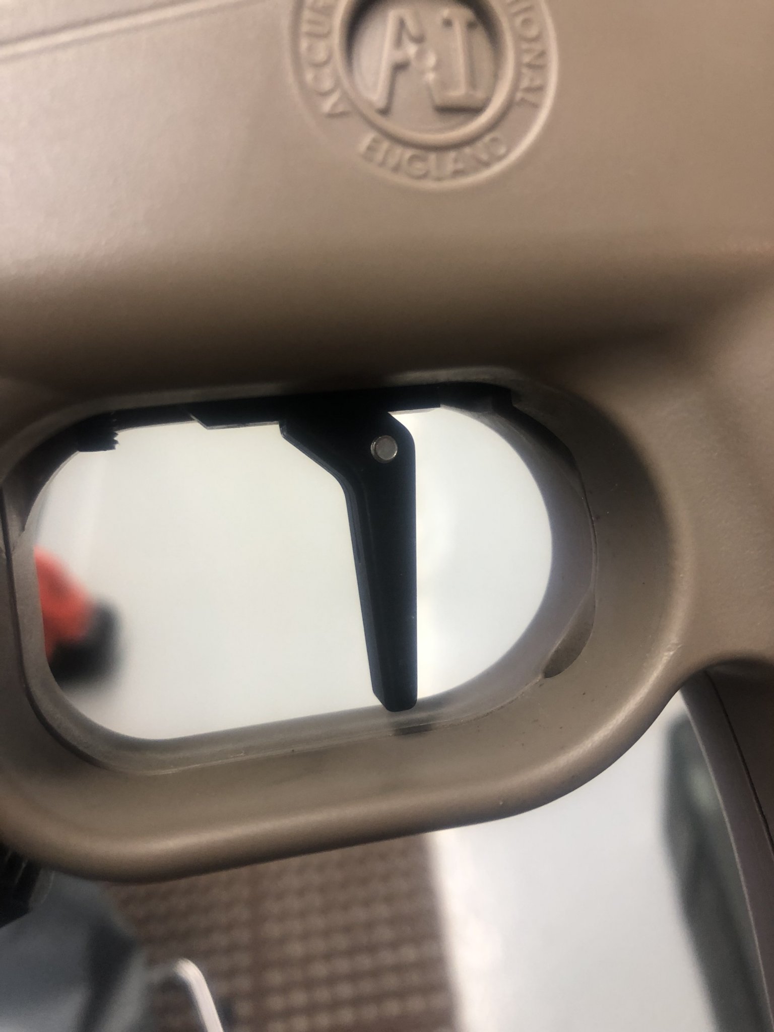

Got my flat trigger shoe from eurooptic today and the fit is perfect. My finger placement on the trigger feels better now and trigger pull feels ever so slightly lighter now that my finger is lower on the trigger.
do you have the comp trigger as well or just stock trigger with flat face?
Awesome. Just like mine from back in post #2,202!
Enjoy.
Guess I didn’t know they have been available that long. I recently checked with two other suppliers and they said they weren’t available yet.
Nope, you're right, they weren't. I got a prototype back in February to try out.
Ergonomically it feels good.

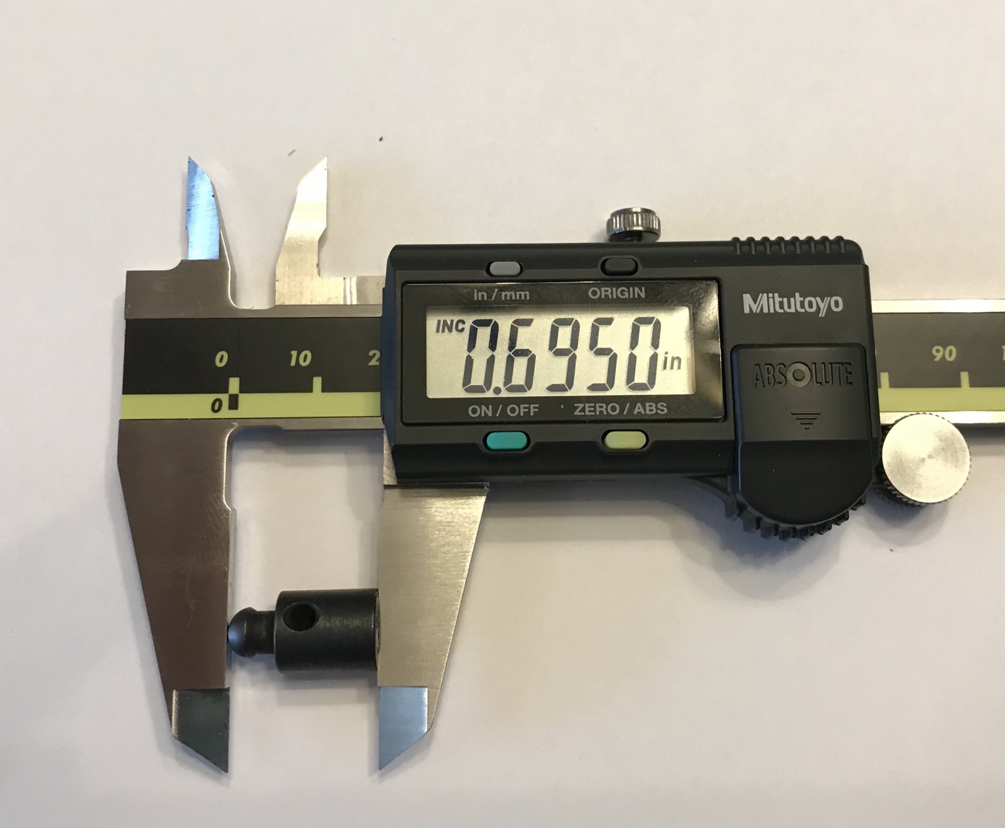

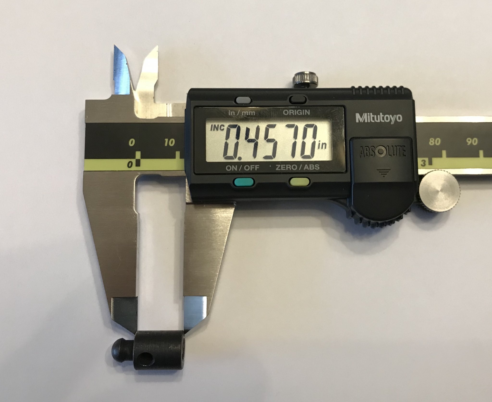

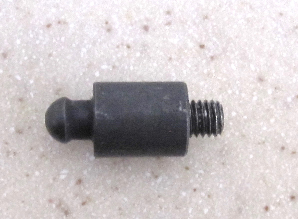

Could someone with an AT take a few minutes and do a favor for me? I’m trying to confirm if the AT ‘male’ stock catch is the same part as on the AX. This is to allow the non-bolt side stock folding on the Obsession chassis I’m working on.
You don’t need to remove the part from the chassis, all you’d need to do is remove the grip skin panel and confirm the height of the part with a micrometer. The base of the part sits flush with the surface of the chassis.
Thanks!

Gents,
Thanks!
Sam
View attachment 7048425View attachment 7048426
Are these pictures taken on the nipple on your pre-14 or post-14 AX?
Pre-2014 AX's nipple (at least that's what I suspect). It screws directly into chassis.
Interesting. They must have changed it on the AT and new AX. The AT has an unthreaded hole in the chassis so I know it doesn’t thread in like that one does.

It’s hard to tell from this angle but is that threaded portion part of the nipple or is it a stud that’s threaded in the back?
The threaded portion is part of the nipple itself- an extension. the body of the nipple doesn't have a hole for cross bolting.

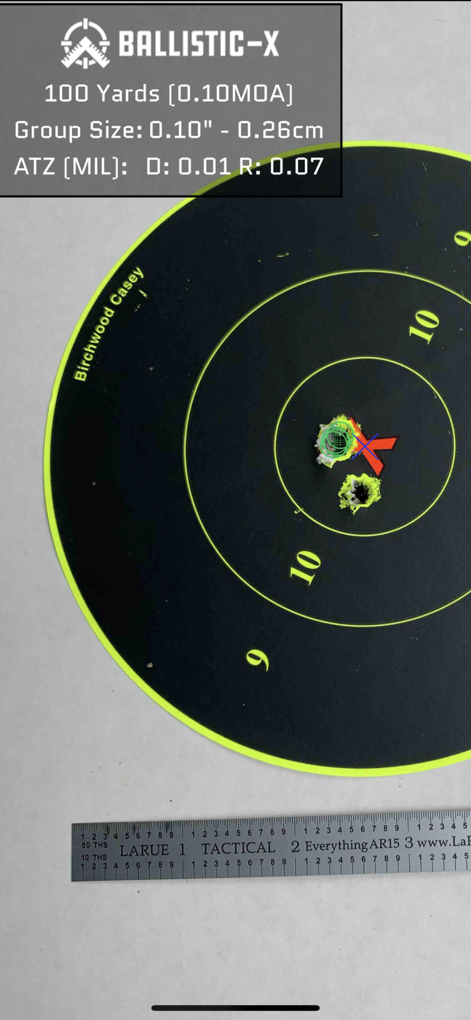

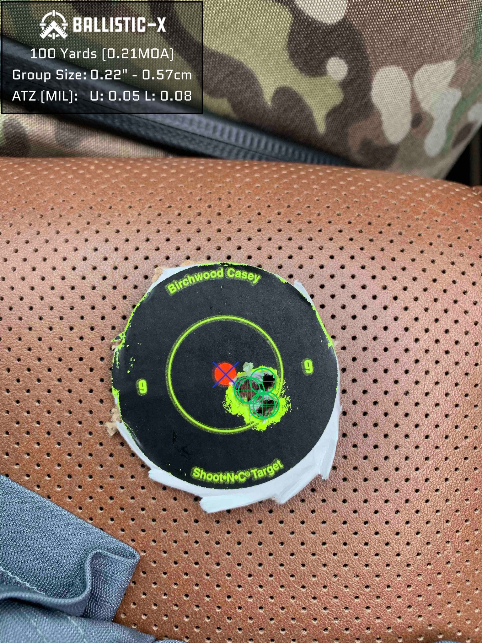

Nice shooting, I'm still amazed by these rifles! I walked out on my patio last Wednesday and shot my best group ever with my AIAT $350 .260 barrel. Also liking the Ballistic-X app (y)
You sure you chose the right caliber in the app? LOL. Those 'impact marks' (green circles) should be the same size as the impact of your actual bullet on paper.
Example below, 1st pic was prone 5 shots (.21moa)
2nd pic off barricade using only gamechanger. 4 shots was .10moa, but the 5th shot made it .52moa lol. Yes, I have witnesses. It was at Rifles Only before the Brawl Match haha. Damn fliers.
Sawtooth Rifles 6x47L Barrel. 115gr DTAC RBT
Not hating. Just trying to figure out why it's bigger haha
Good question maybe I left it on .308?? I'll check. I know the red dot is 1/2" and the next ring out is 1". And I know I shot it with my .260....
UPDATE: I found my mistake, I was used to my other software and used an inch for reference instead of a half inch! I did it over using the corrected number. Thanks! :rolleyes:
