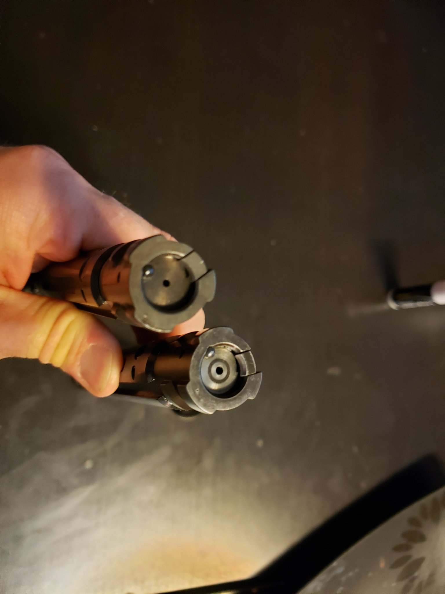

Not entirely accurate in my opinion. I get pretty good primer flow back into my firing pin hole using factory ammo and extremely mild loads on my 6.5 Creedmoor. If I were to try using a hotter load on my AXMC I'd probably pierce a primer.
That is easily solved with protrusion adjustment. Ran all sorts of SRP and LRP in AW's (and a pre-2014 AX) for years. Not a single problem. Just takes a little knowing how to solve things.
I've even ran them out of an AXMC. Granted, not SRP, but LRP, yes. No issues.

What is your firing pin protrusion on your AI’s? I have a 2014 AX with LFP and it seems to crater pretty much everything. I’ve never thought much of it cause it’s never pierced or blown primers but if I can get it close to out that would be great! Lol. I just watched a full disassembly video and realized it’s a pretty easy adjustment. Tomorrow I’ll have to check to see what it’s currently set at and wait to hear back from you!
Looks like across an AW, AXSA and two AXMC's the protrusion varies. All within spec though.
AW - .055"
AXSA SFP - .046"
AXMC A - .052"
AXMC B - .055"
I have to give @RoterJager credit though as his post above does have a good bit of validity to it. Some people still experience issues after adjusting protrusion, so the SFP does indeed have a place. Obviously getting it too short is a reliability issue.
Helpful hint: Half a turn on the firing pin will adjust the protrusion by .010 - 0.012.

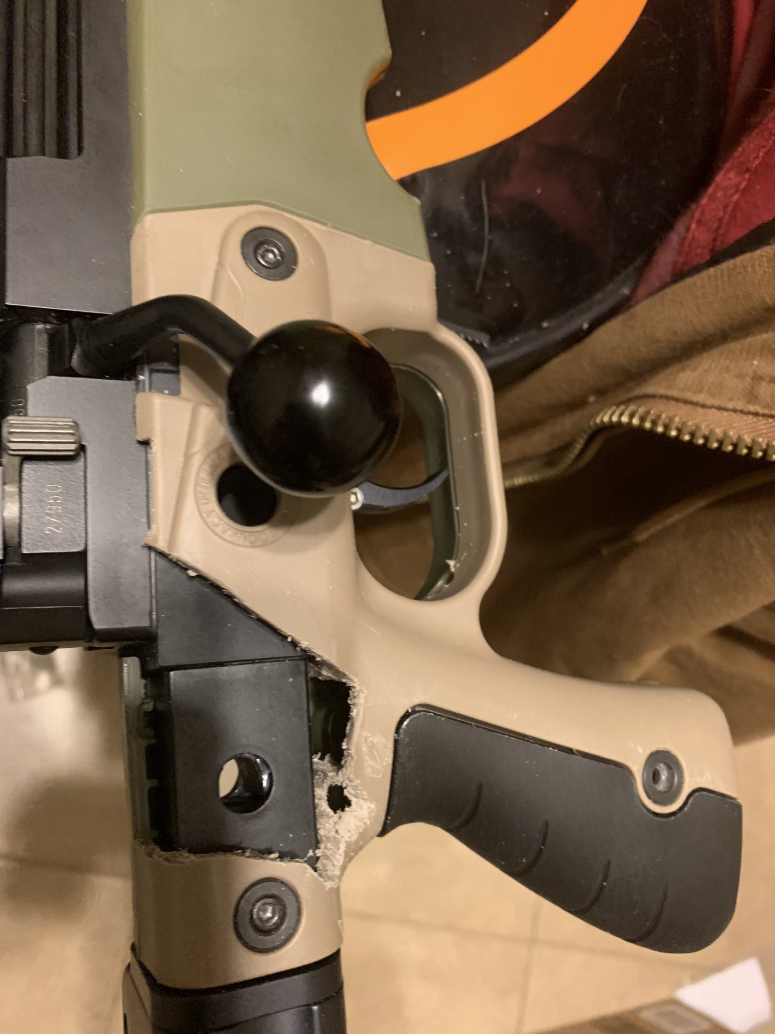

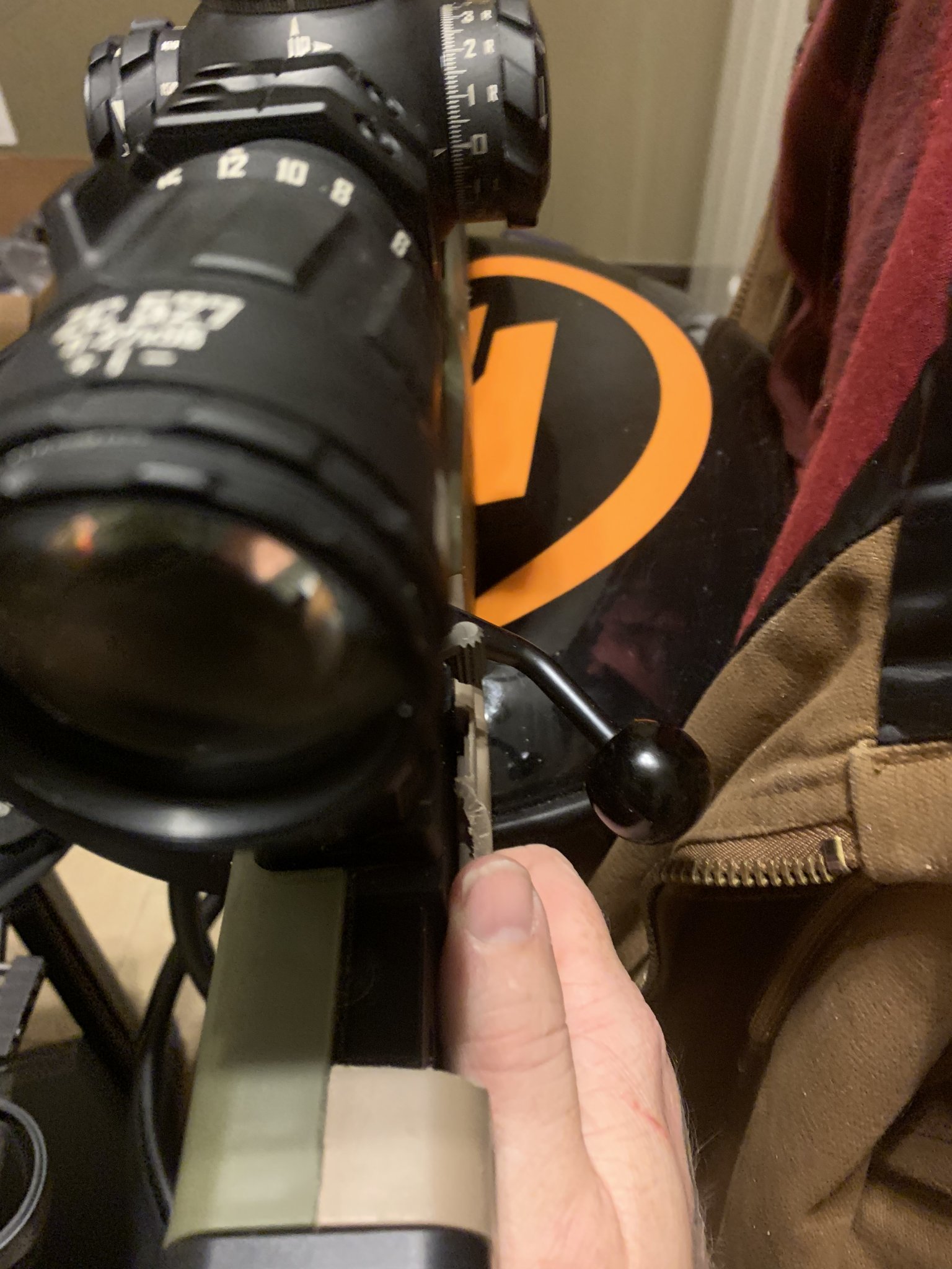

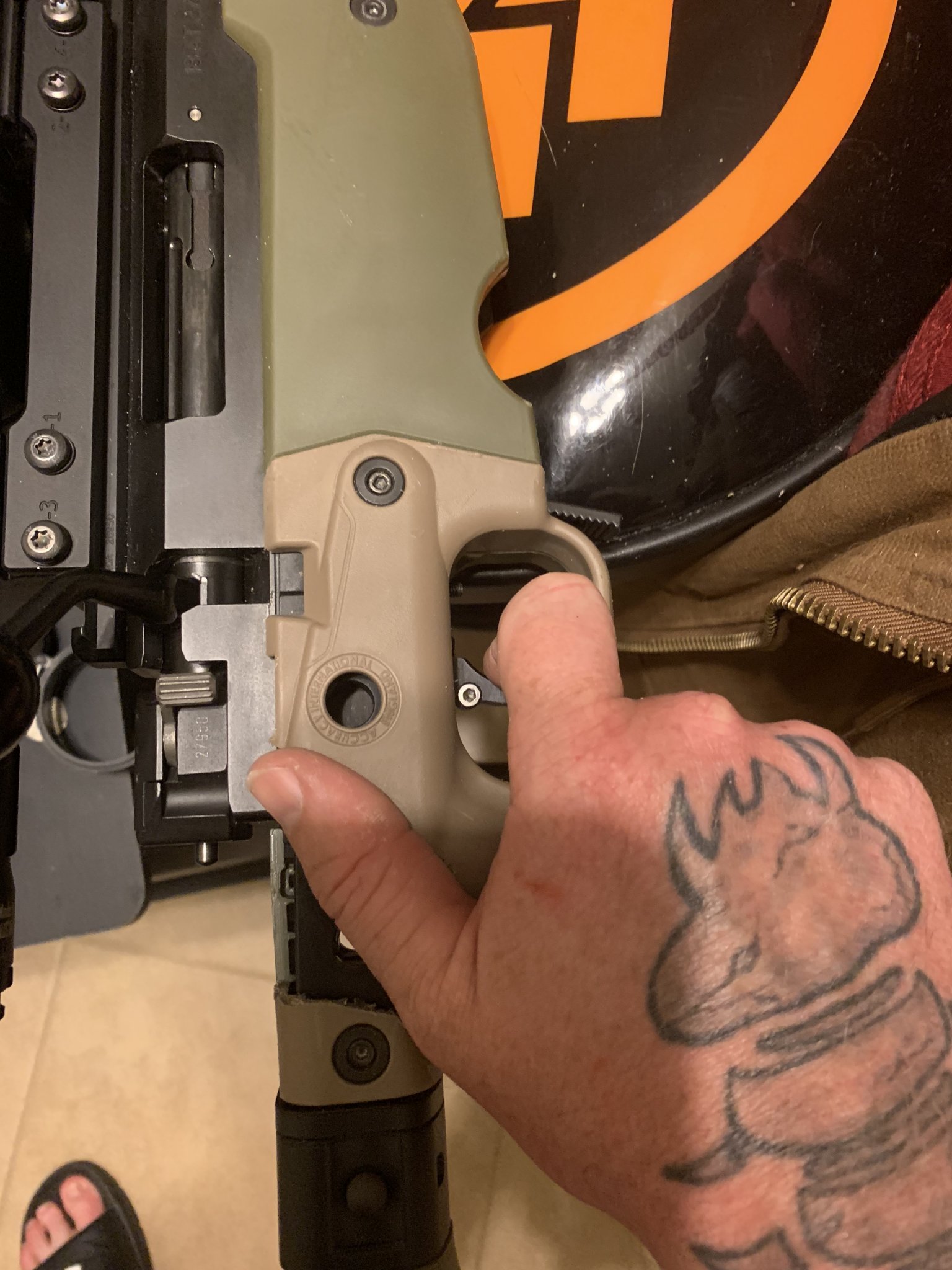

So, I’ve had and issue with the skins being too thick for my small hands to comfortably float my thumb. And with sam’s thumbrest (which is awesome in general), it makes it even thicker.
Feels like my thumb is being pushed out to the side away from the rifle.
I had pretty much decided I was just going to wrap my finger as that works fine too.
Then I watched the ASR shot release where AI said they made that area thinner for that purpose.
So, I made mine thinner. Lol
This was a test/sacrificial skin. Next one I’ll draw out and dremel up smooth. It’s actually pretty comfy.
Just another idea for those of us with small hands. And it’s just a cheap skin if you screw it up.

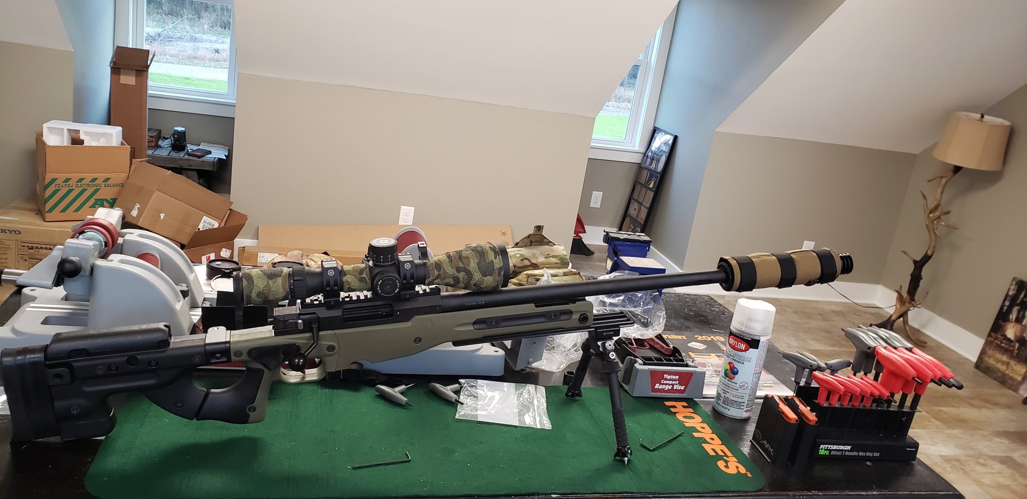

Well..... she shoots. The 168gr fgmm seems to do all right. Need some higher rings though. Both of my gen II razors wont be here for a while so this will do until then. The 6.5 and .25 creedmoor barrels should be here in a week.
Edit: these 3 groups were rounds 5-14 down the tube.
THANKS MIKE AND MIKE HIGH!!!
