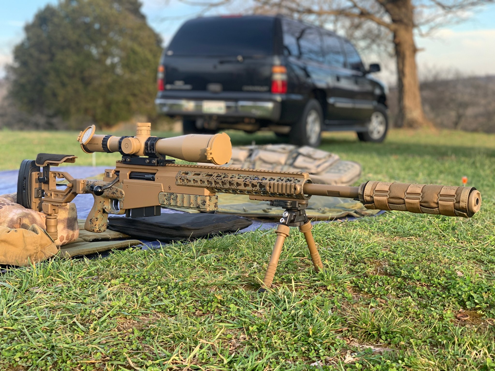

That is fast!
I only get 2650 from my RPR 6.5.
What barrel do you use? Length? Twist?
My bolt will be here tomorrow, all I need is a barrel for 6.5cm :)
If I had to guess that's a factory ai 26" just like mine :)

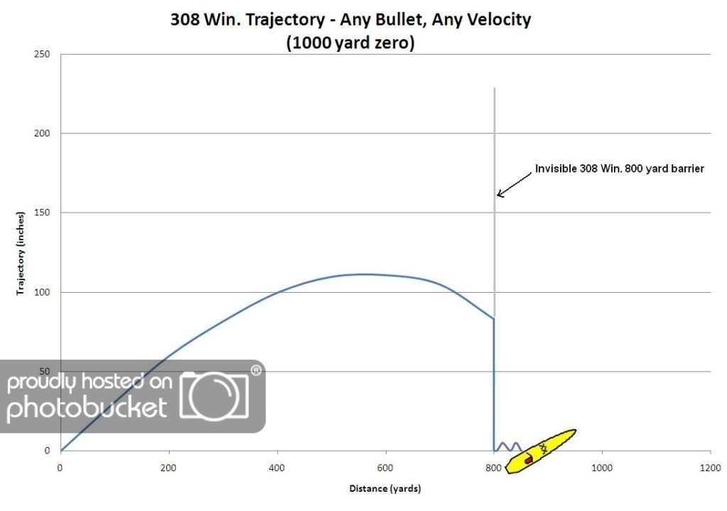

My 24" factory Bartlein 1:10" 308 barrel on my AX is a hammer as well, shoots 175 FGMM sub 1/2 MOA, and have made hits out to 1200 yards with it in a match. Never measured brass growth though, plan is to only shoot factory 308 (save time reloading) and either sell the 1x fired brass or use it in my SCAR which will chew it up anyway.
False... Everyone knows 308 goes transonic at 876 yards and immediately falls to the Earth....
@Huskydriver haha yup. The reality though is I got my ass kicked because I sucked at all the close/fast/positional targets. Definitely (for me at least) I need to practice with a 308 in order to be even remotely proficient at a match. Laying down prone wasn't too bad because even at those 800+ yard targets I could see my splash on misses, and make adjustments, whereas the small 6mms weren't seeing anything. And that's coming from a mild 6.5x47L as my primary match caliber; I'm sure going from a 6BR to a 308 would be quite the shock.

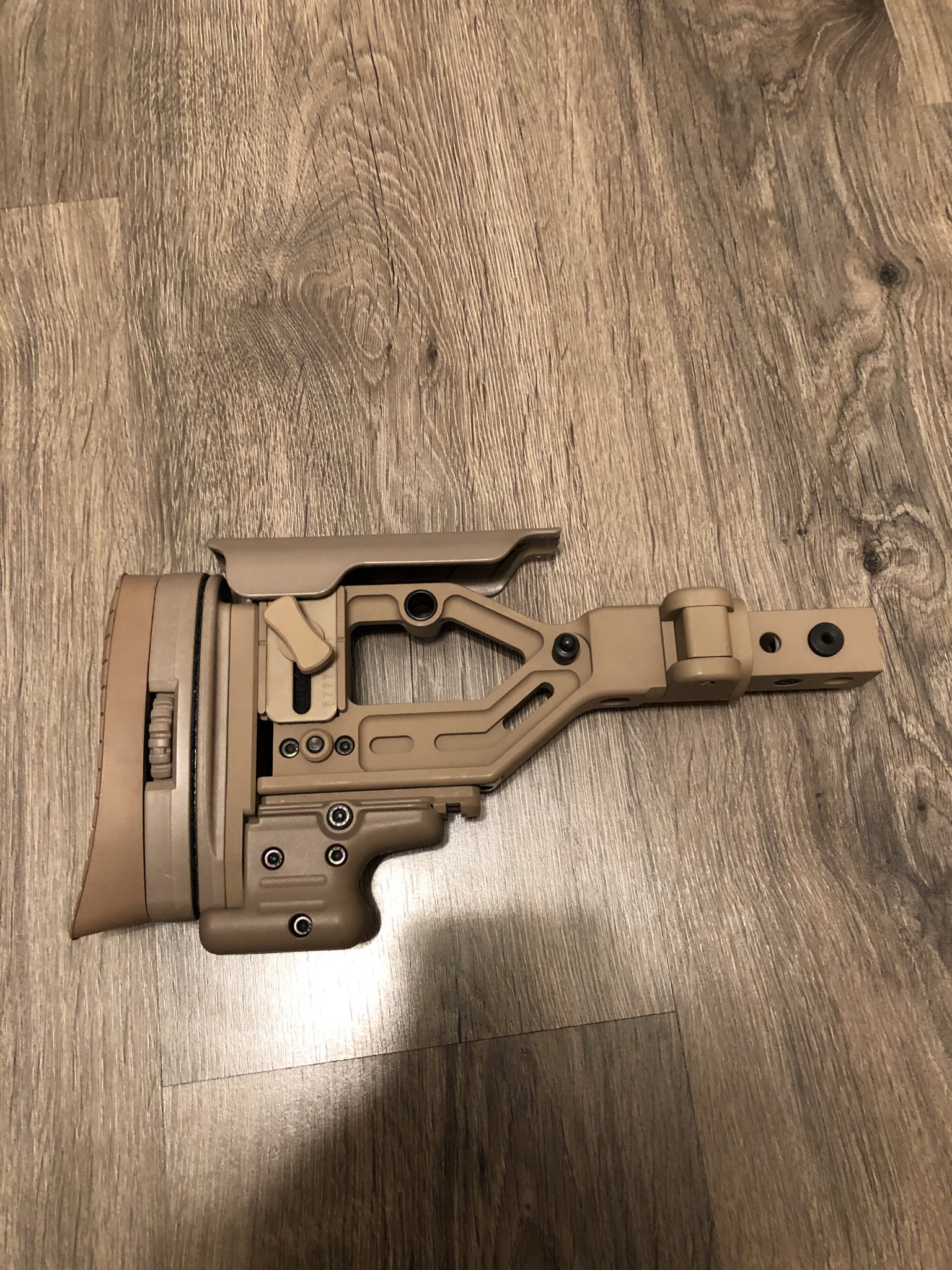

Unrelated,
Anyone want to “downgrade” one of their AX’s for an AT (I’ll cover difference in cash).
Picked up an AX last week, and I feel like I should have two of them ?‍♂️
Why not drop an AX stock on your AT?
I prefer the open top style chassis to the tube on the AX
I might do this. I have found I prefer the AX tube and whatnot over the AT.
Except for the handguard, the AX is “shorter” than the AT.
