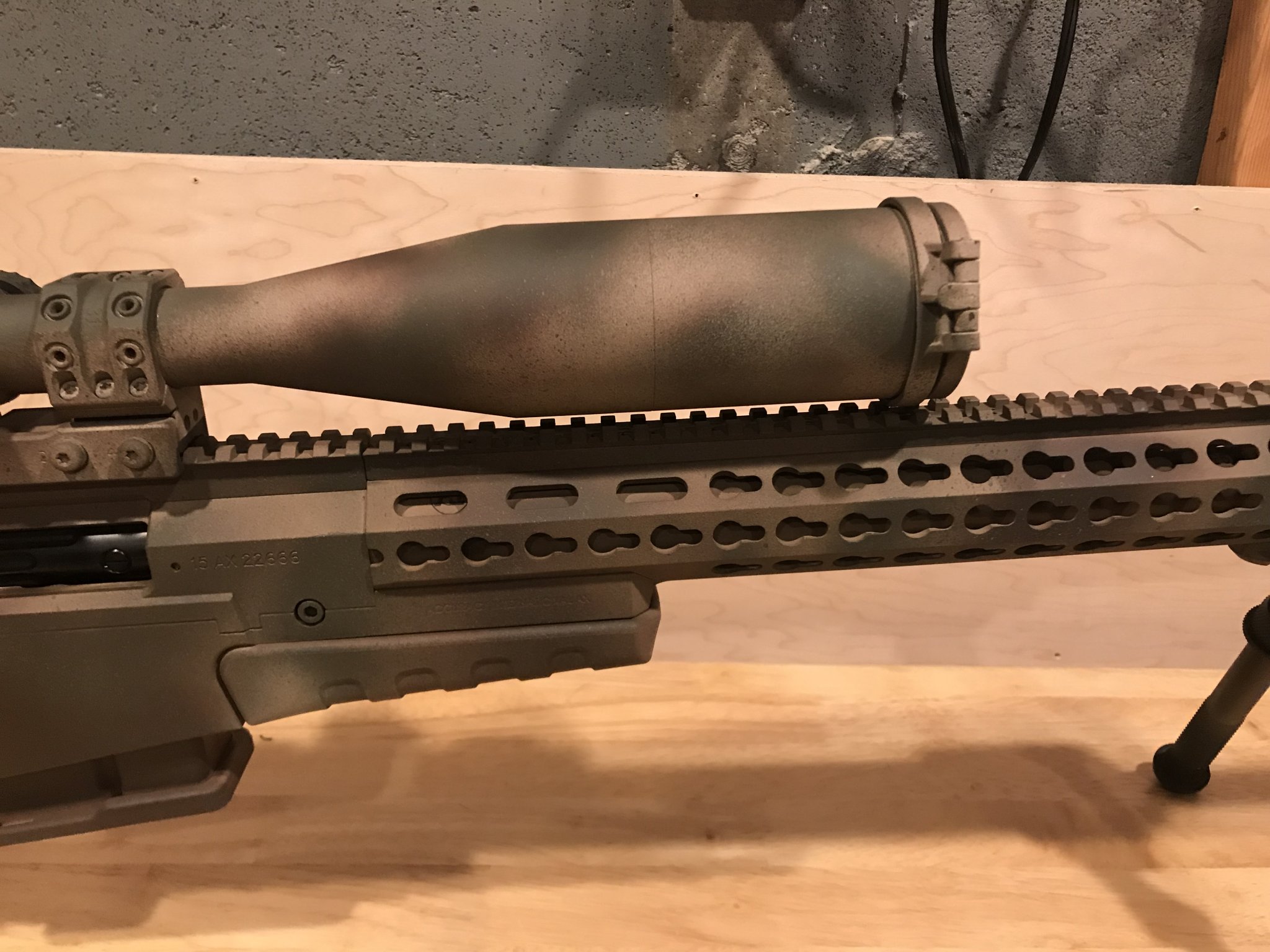

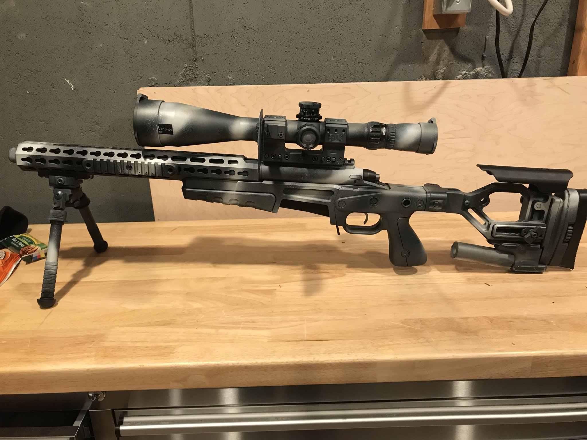

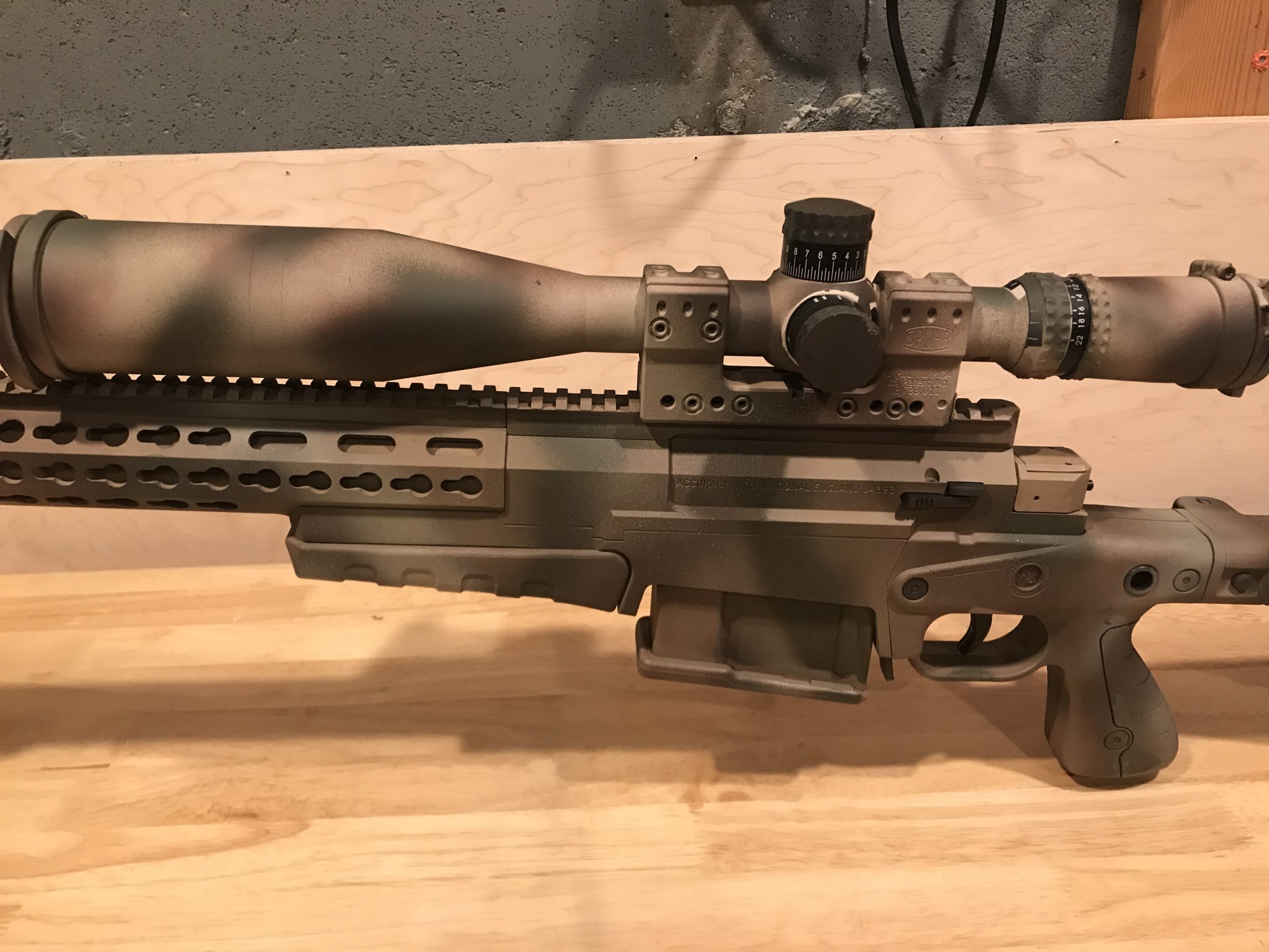

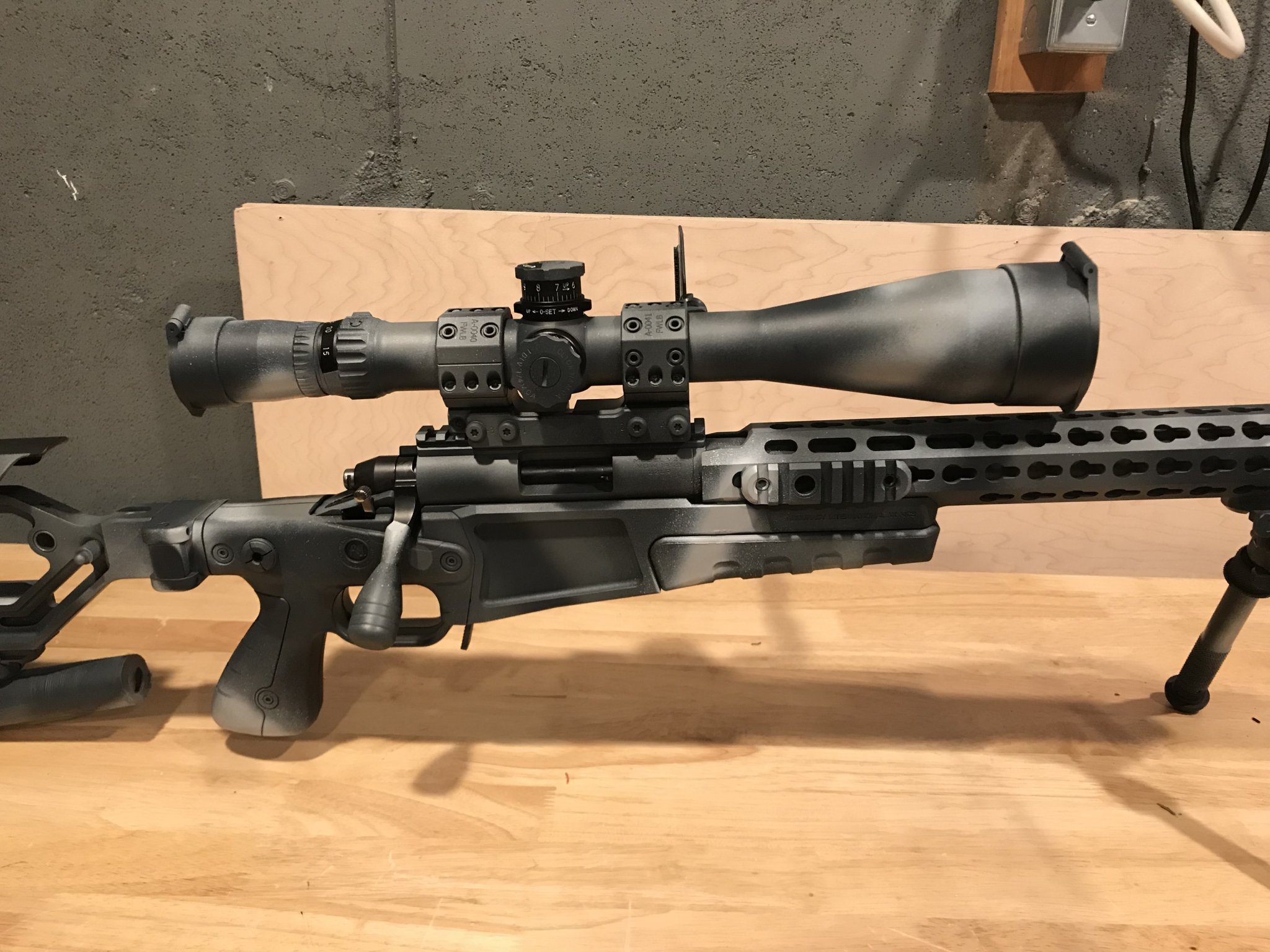

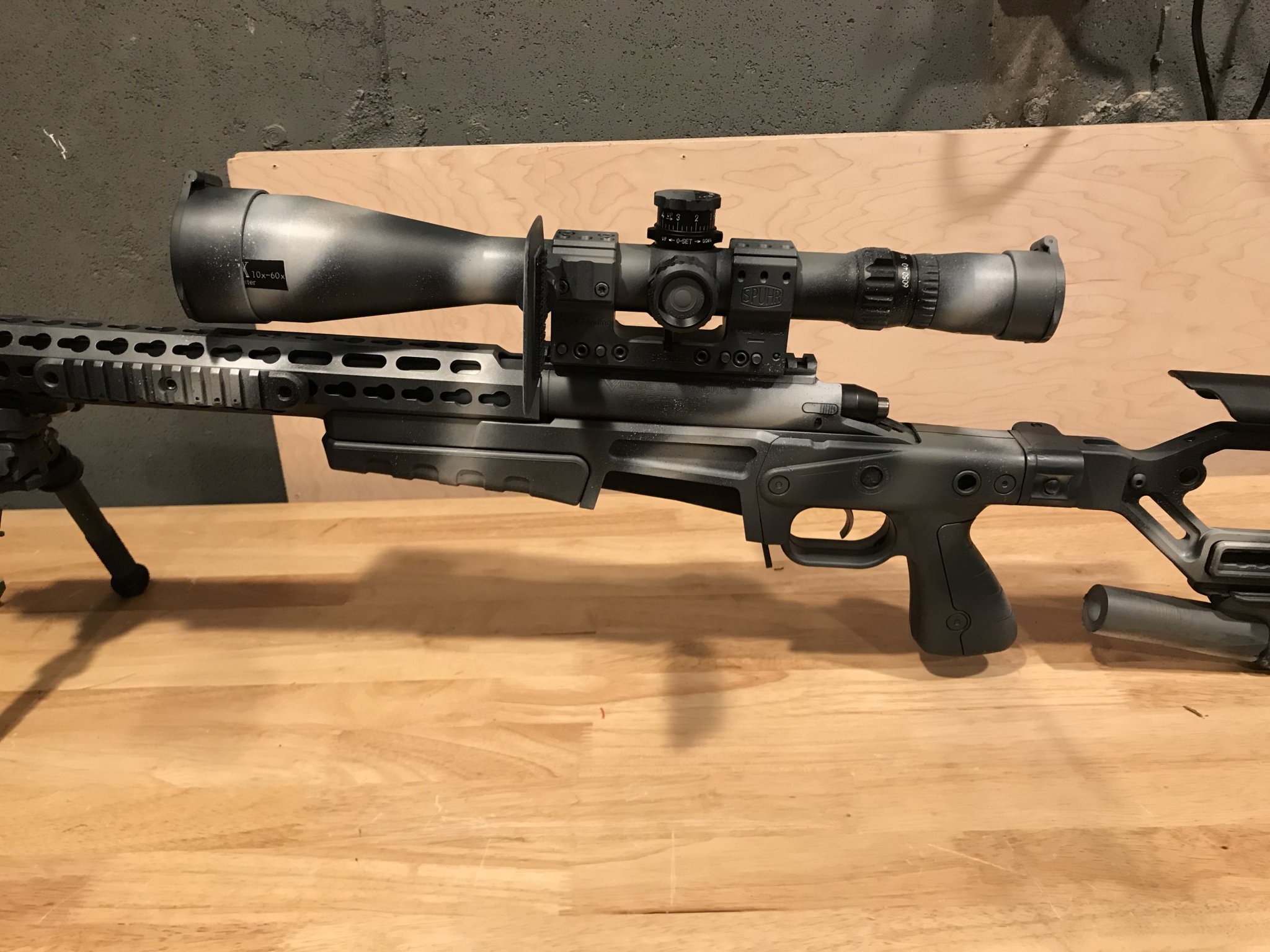

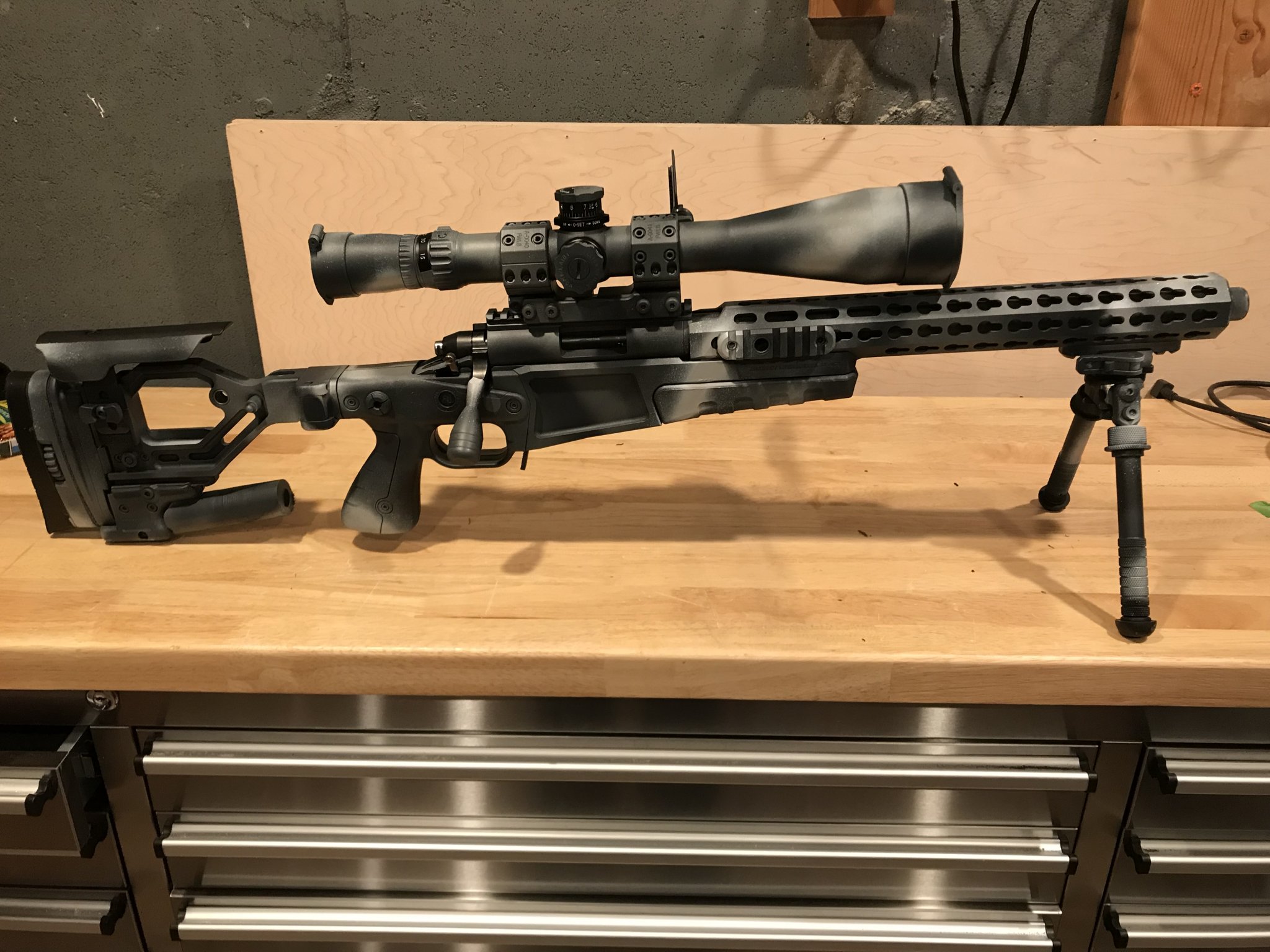

Little bit of krylon goes s long way.

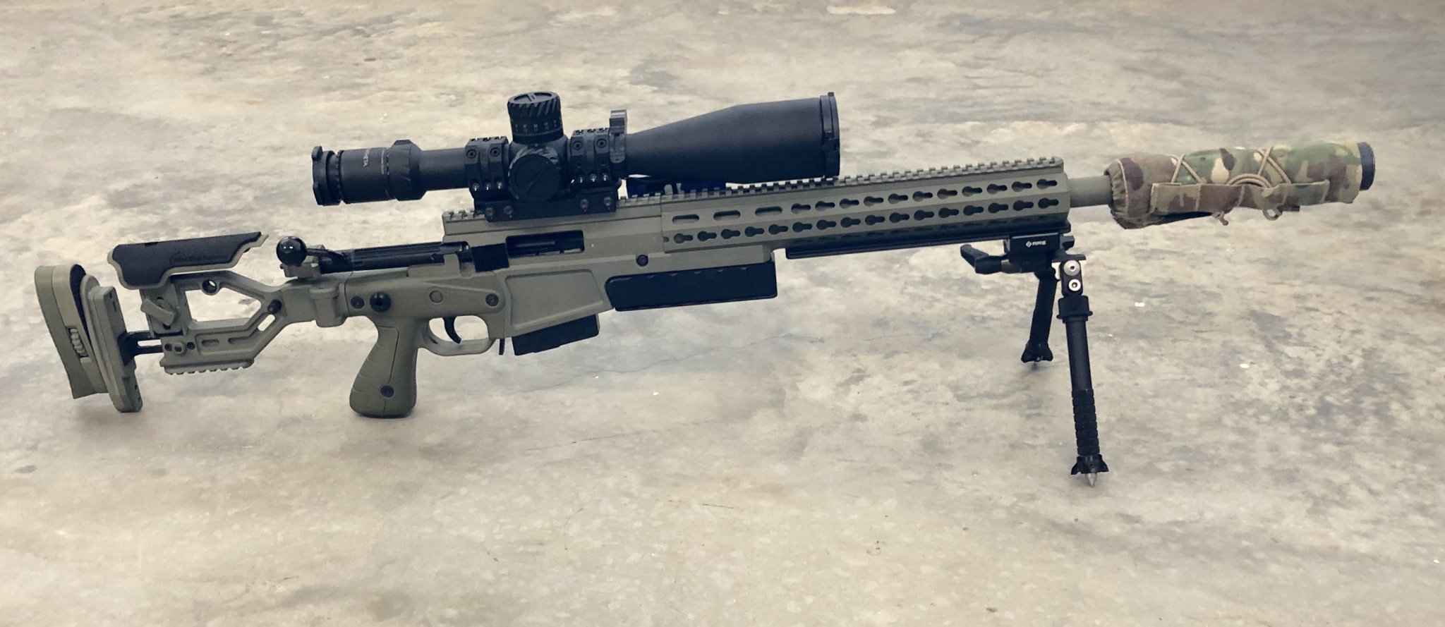

Going to hit my AXSA and ACMC this weekend if I get a chance.

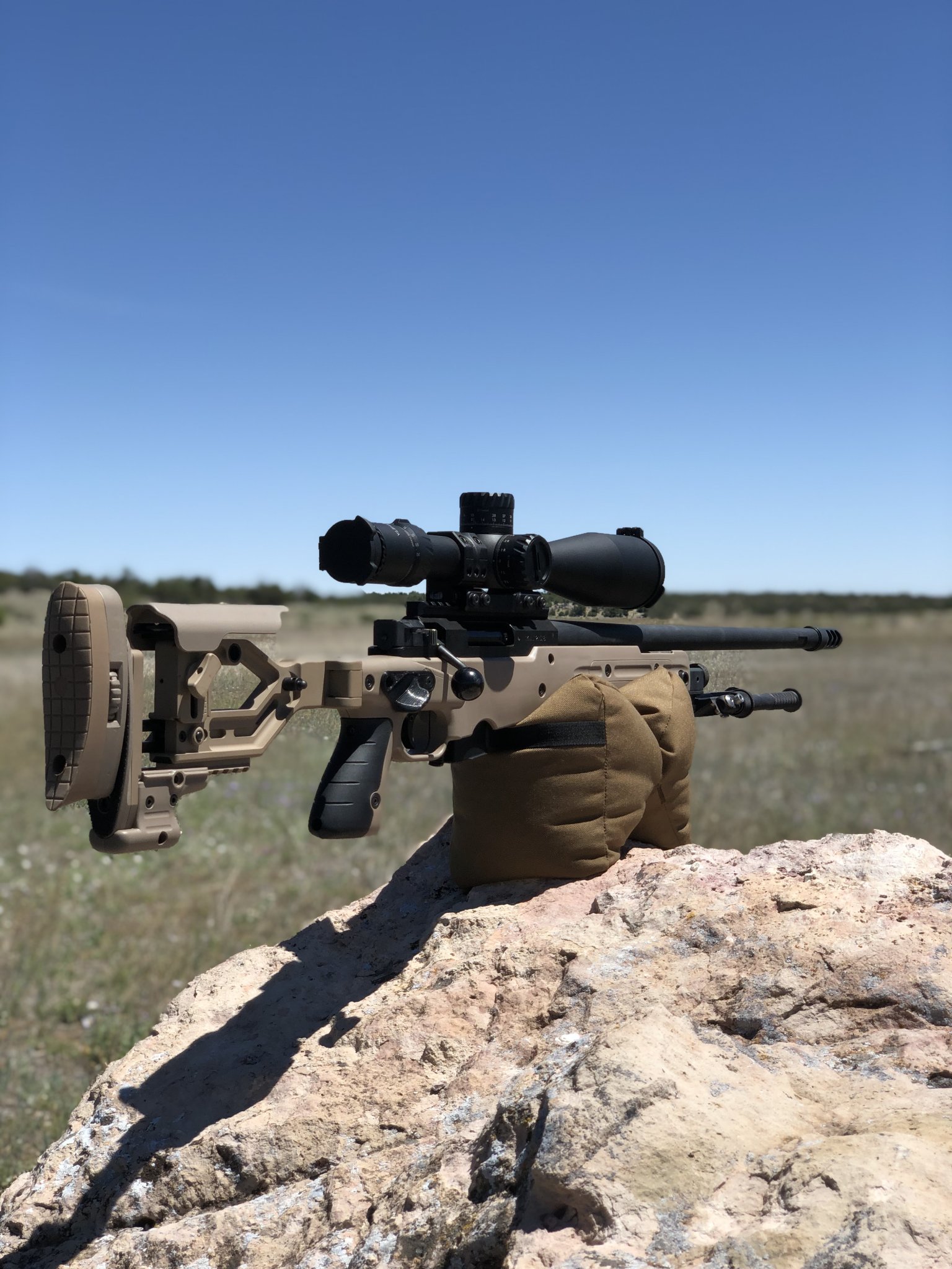

I’m feeling really happy after my morning shoot, I’ve been chasing my tail a little bit getting comfortable with an A.I.
I picked up an AIAT on a trade and shot it a couple times and couldn’t get comfortable. I had some issues loading for it with the large firing pin, I had bad primer flow and a couple pierced primers. I didn’t have a lot of money into the setup so I was willing to throw some money at the problem.
I sent the bolt out to Long Rifles Inc (LRI) to get bushed down (amazing process and fast turn around), my buddy @dirthead1 and I took a torch to it and installed the AX Buttstock. I got a new optic mounted on it and I’m to the point now where this might be my favorite rifle...

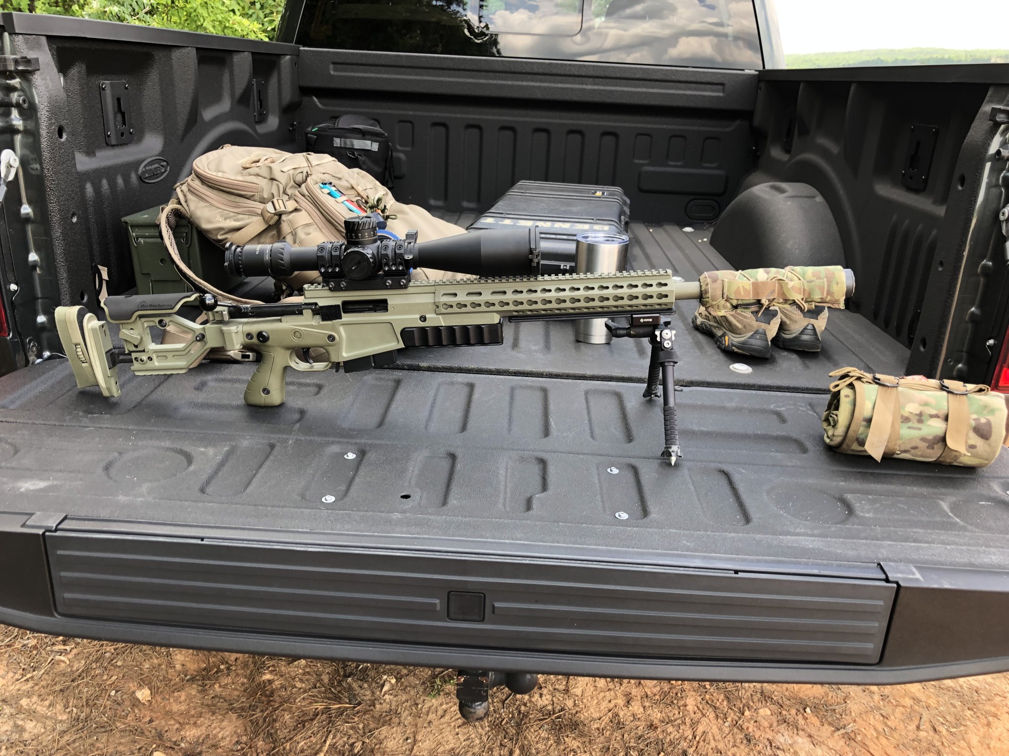

I’ve been calling it Frankenstein. I’m excited how it turned out and can’t wait to run it thru the paces this summer, shooting season is in full swing in the Arizona Mountains. Took it out to 1K this morning.

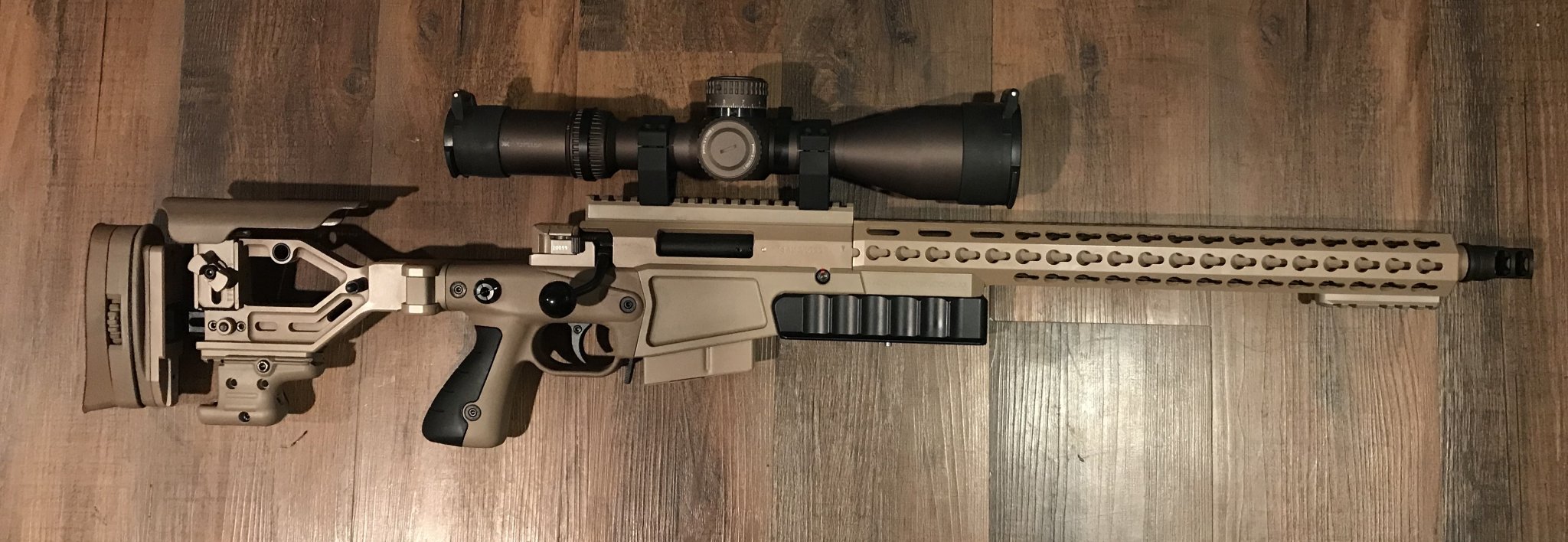

Specs:
2014 AIAT with AX Buttstock
Tangent Theta Gen 3XR
Spuhr 4006
Area 419 Hellfire
Long Rifles Inc bushed bolt
Atlas CAL and Atlas Spigot
@samb300 Thumbrest kit

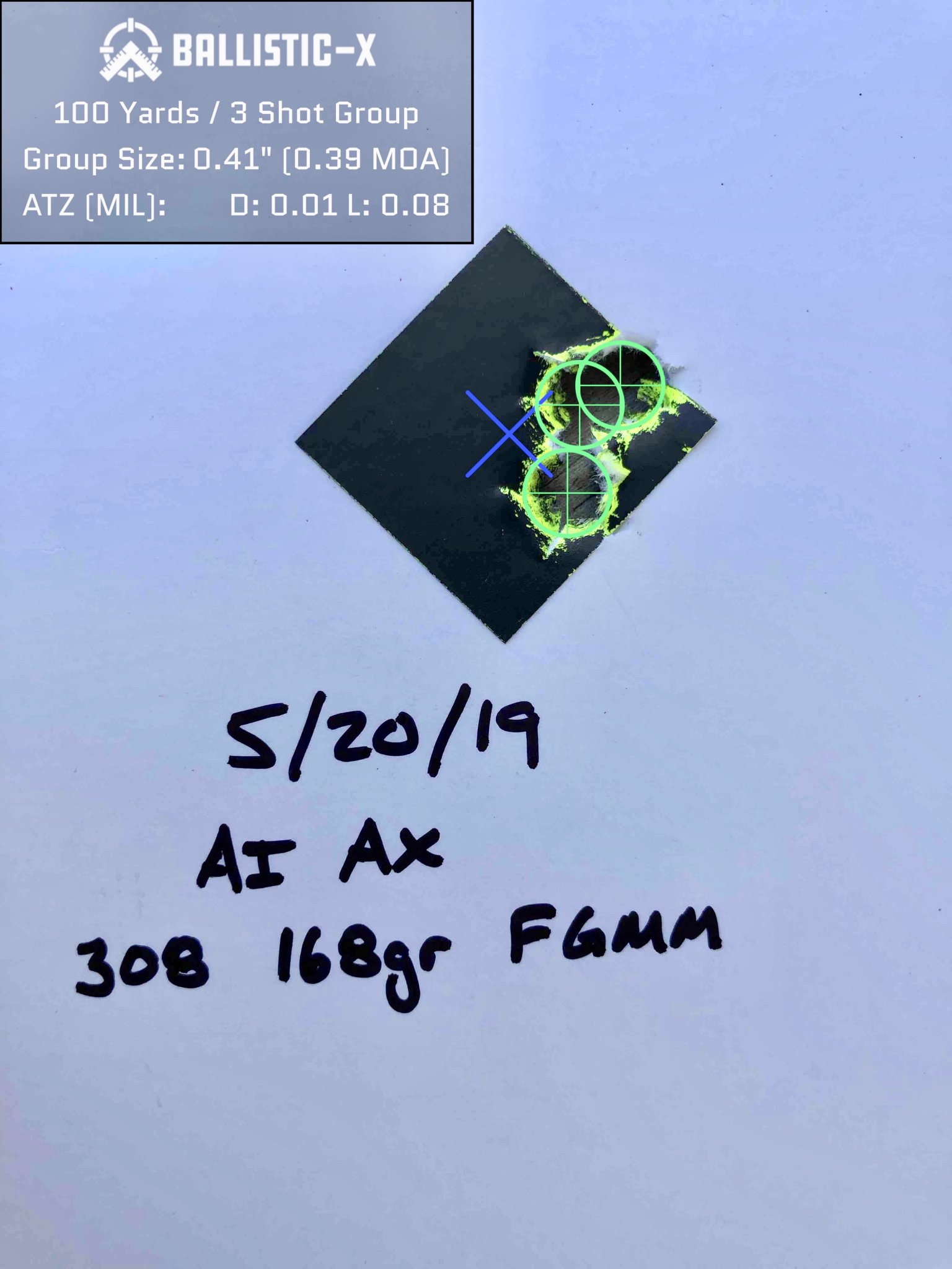

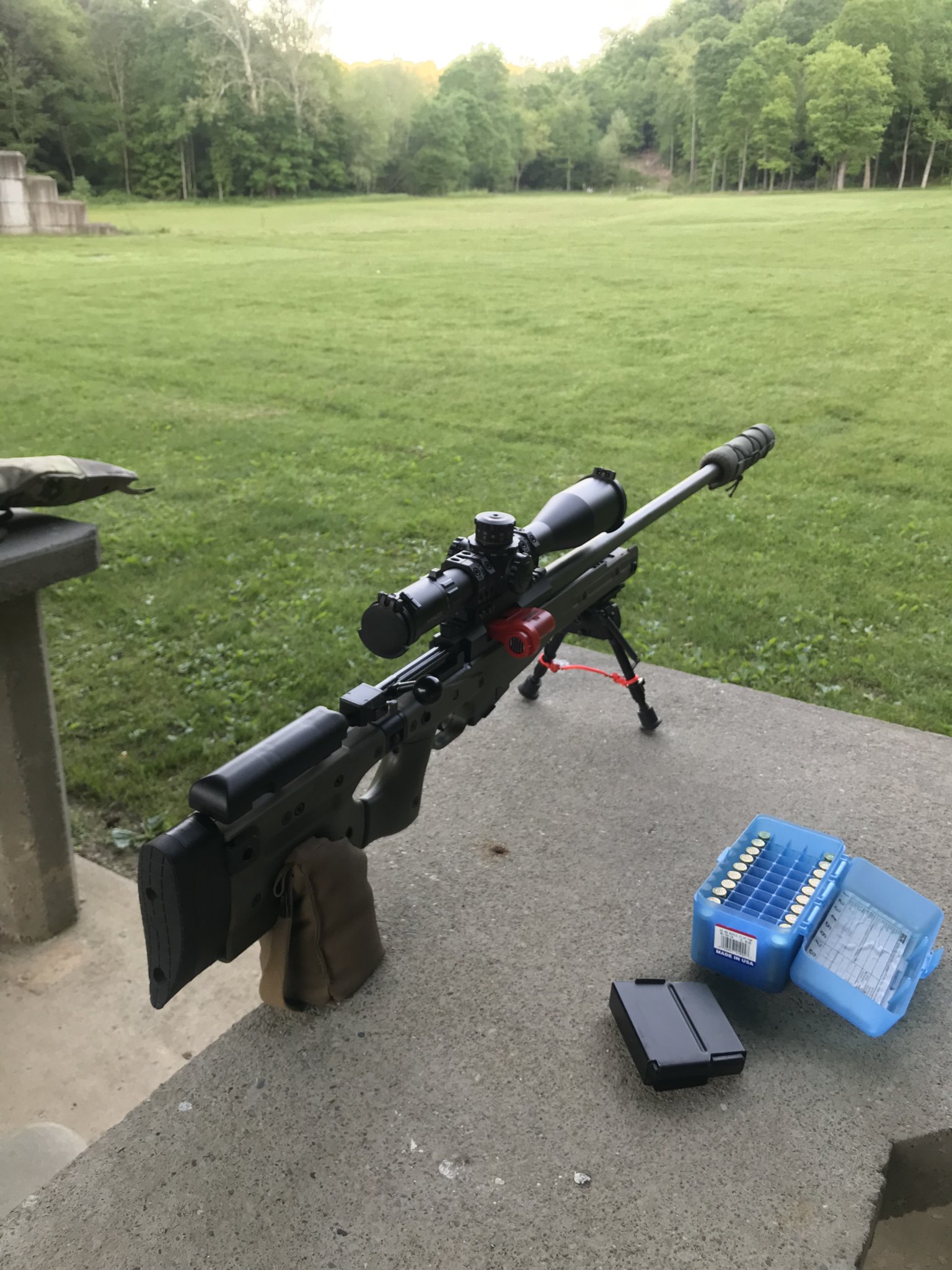

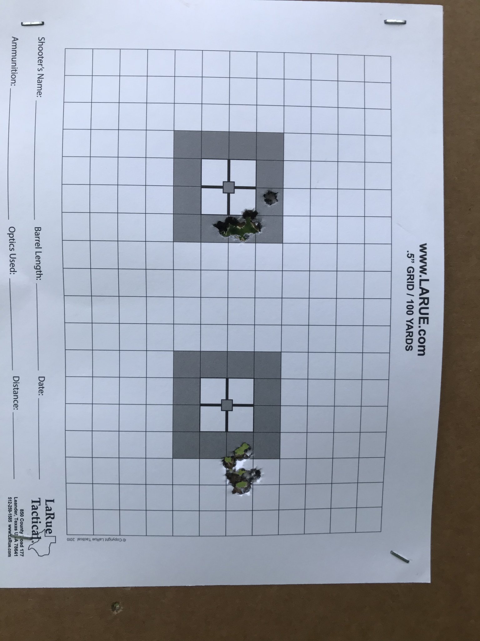

I wish I had the same day as you, but mine was very frustrating. I was going to set zero on the NF as well as test a variety of factory loads to see what this rifle prefers before I work some handloads. What I ended up with were marginal groups at best.
I was shooting the AI .260R at 100y, prone and off a concrete slab that is range 1 at Quantico. I switched to rubber feet on the Atlas and used the front tabs of the mat to load the bipod.
I had a variety of factory .260 including: Hornady 130 ELD-M, Berger 130, 136 and 140, FGMM in 142, Black Hills and McCourt.
I shot a CCB sighter at the center orange dot at 100 which was high, then adjusted down (top hit on the circle), and then two shots you see low and to the left a bit. I can usually shoot bugholes at 100 with my M5, so those got my attention. I continued in three shot strings with the Berger 136's, 140's and 130's, the some Prime 130gr (POA center of each square). I was simply hoping for better. Now, there were shooters left and right (one guy with a blackpowder and another pelting me with 5.56), but I can usually focus and shoot better.
I shot 3 of the BH's, FGMM and 2 of the McCourt (all I had) on the next target with the same results.
I then switched to suppressed hoping the groups would tighten up a bit, but nope.
I'm going take the scope off, check the rails and all the screws and re-install and re-torque. I'll clean and scope the barrel, remove and re-install it and then I'll remove the SOCOM 7.62-RC brake so I can test sans a brake or muzzle device in case it's introducing a variable. One thing I noticed was a lot of carbon on the underside of the barrel from the brake. I did install, tighten, rockset and time the brake (not my first rodeo) so that was a surprise to see the blowback.
I'll also check parallax, just in case, but I've been shooting this scope on a Mausingfield M5 with no issues.
Any thoughts from the hive (besides I suck :)) ?
ETA - I also had a shooting buddy who has an AX shoot a 3-shot string and he sucked too.
defender it could be your scope but f it’s not..
It seems to be up and down is the main issue, velocity won’t do that at 100
Where were the crosshairs when you come back after recoil
Can you get on a bench.
Possibility of a bad barrel they do happen to every maker and Smith
Anybody experience a cold bore shift? It takes 2 rounds then it's back dead nuts. .3 low .1 left at 100yards. Is this a torque issue on the quick change barrel bolt?

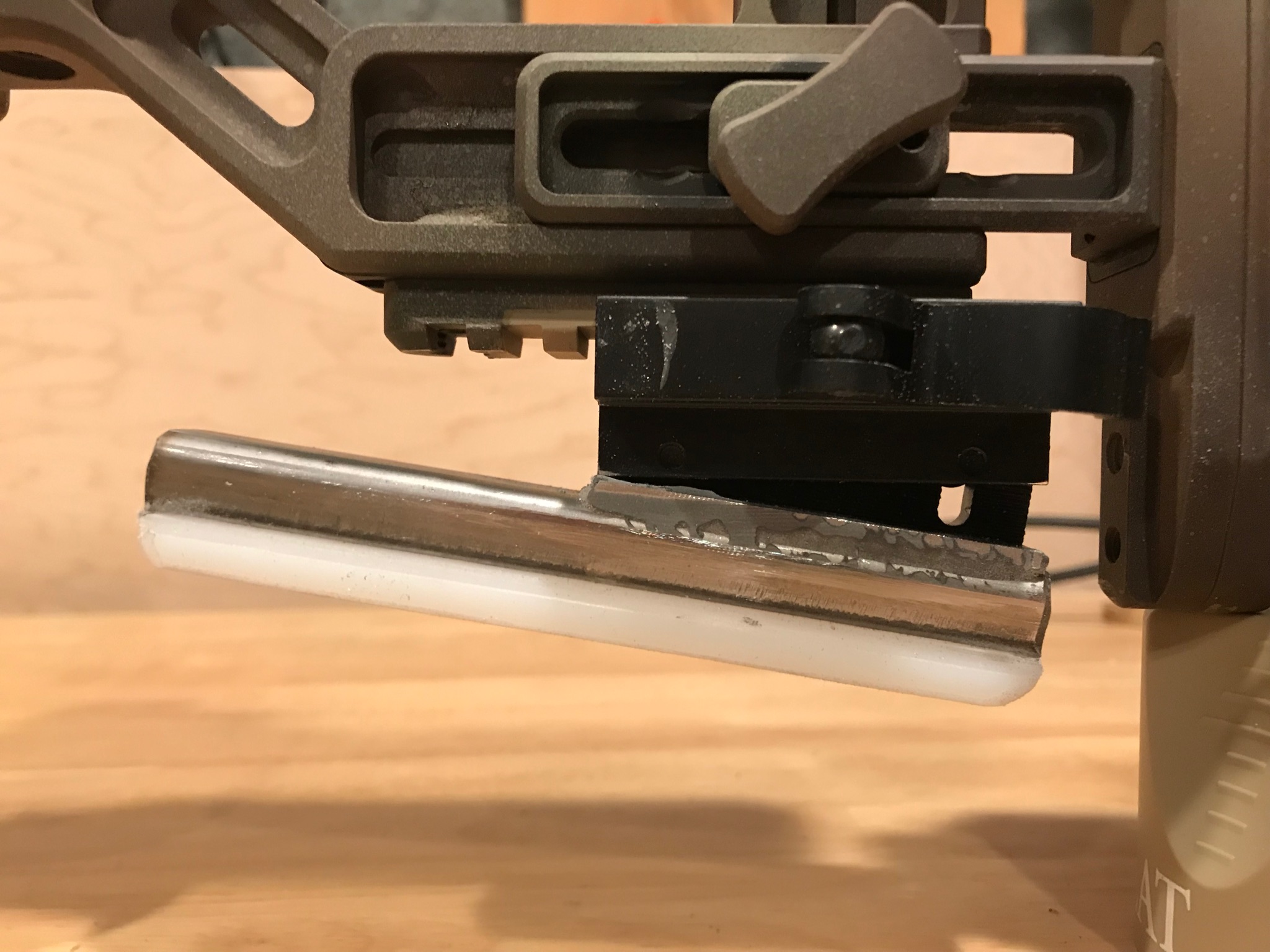

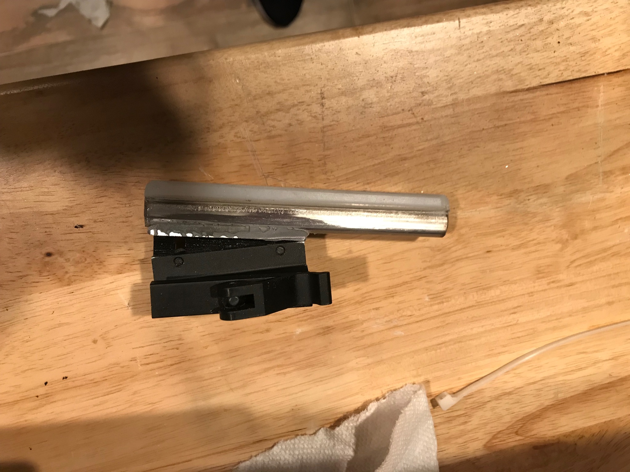

Nice, is that a piece of steel/nylon conveyor rail?
Yup. Think it’s a value guide rail.
Cheap adjustable qd mount off amazon and some jb weld.
If it’s a winner I’ll spend some time on better materials...unless I get lazy.
Already spray painted it, usually that means my lazy ass is done.
Had some pieces laying around at work.
Couldn’t find any plastic chunks that I could shape with out me spending forever.
Figure, I know it’s square off the bat and I would be able to bend it if needed.
Smooth, square, strong enough
Hopefully can’t miss

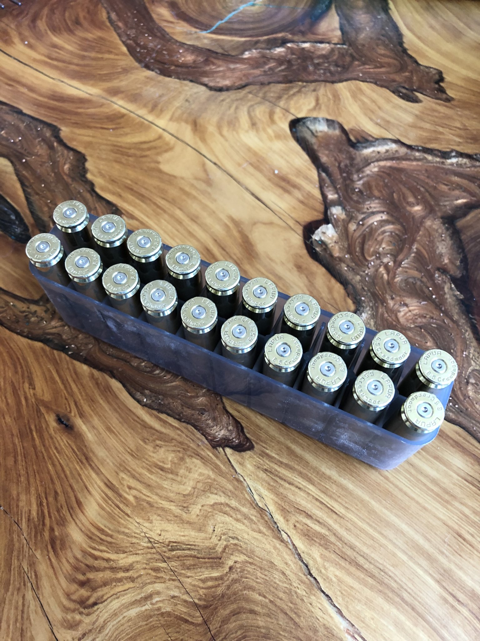

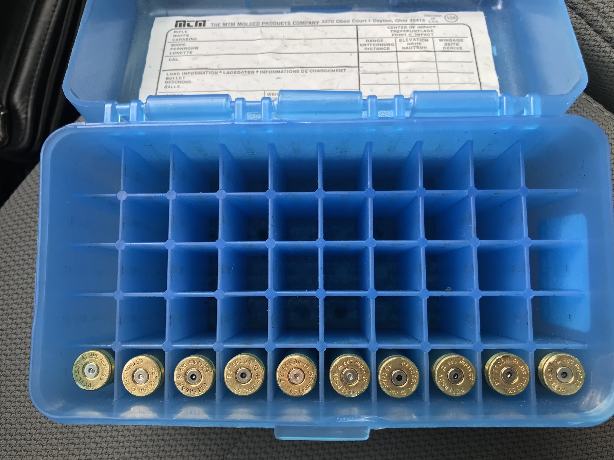

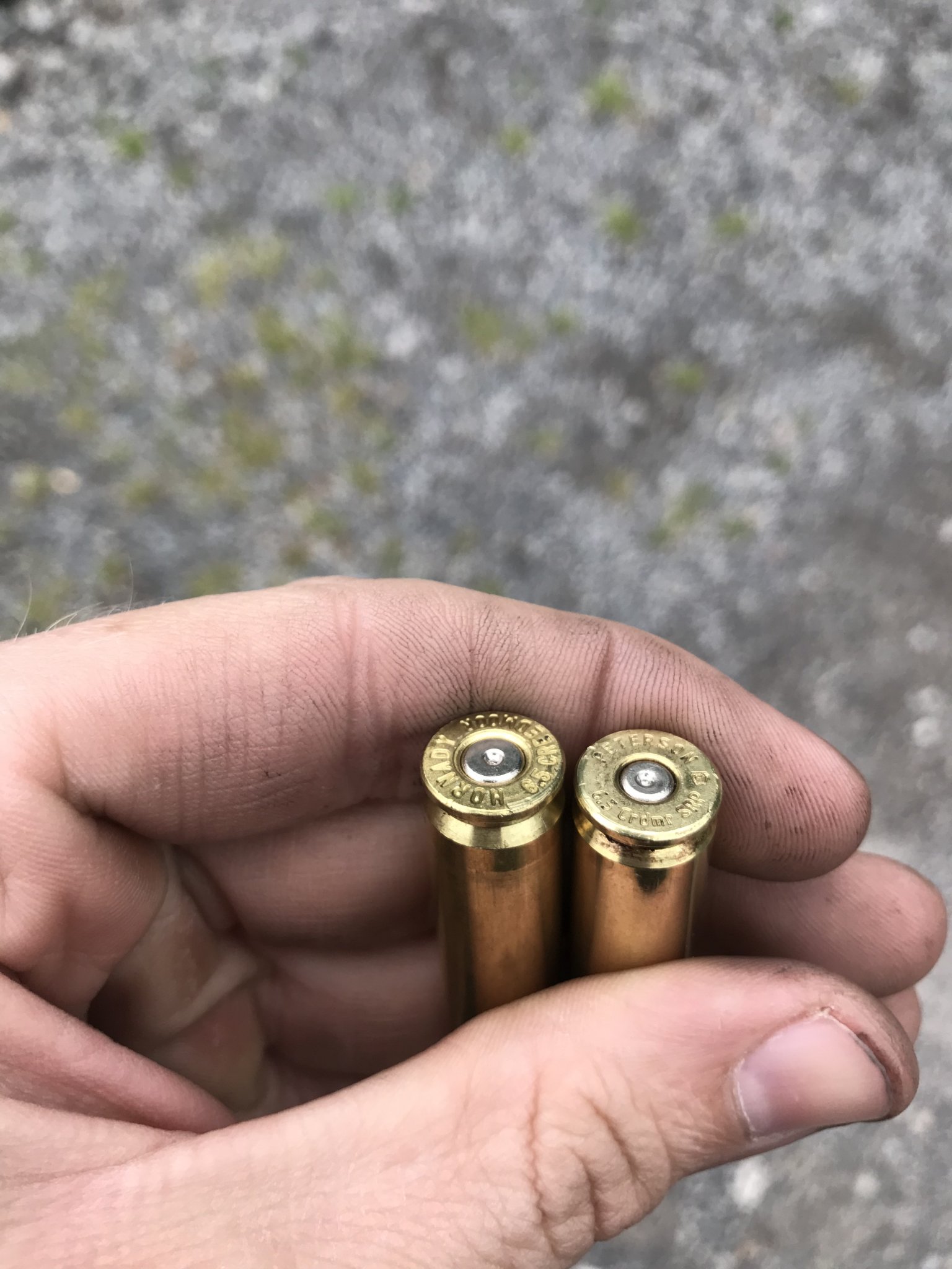

I wish I would’ve sent mine to LRI sooner, it came back perfect and my headspace was barely effected, about a thousandth.

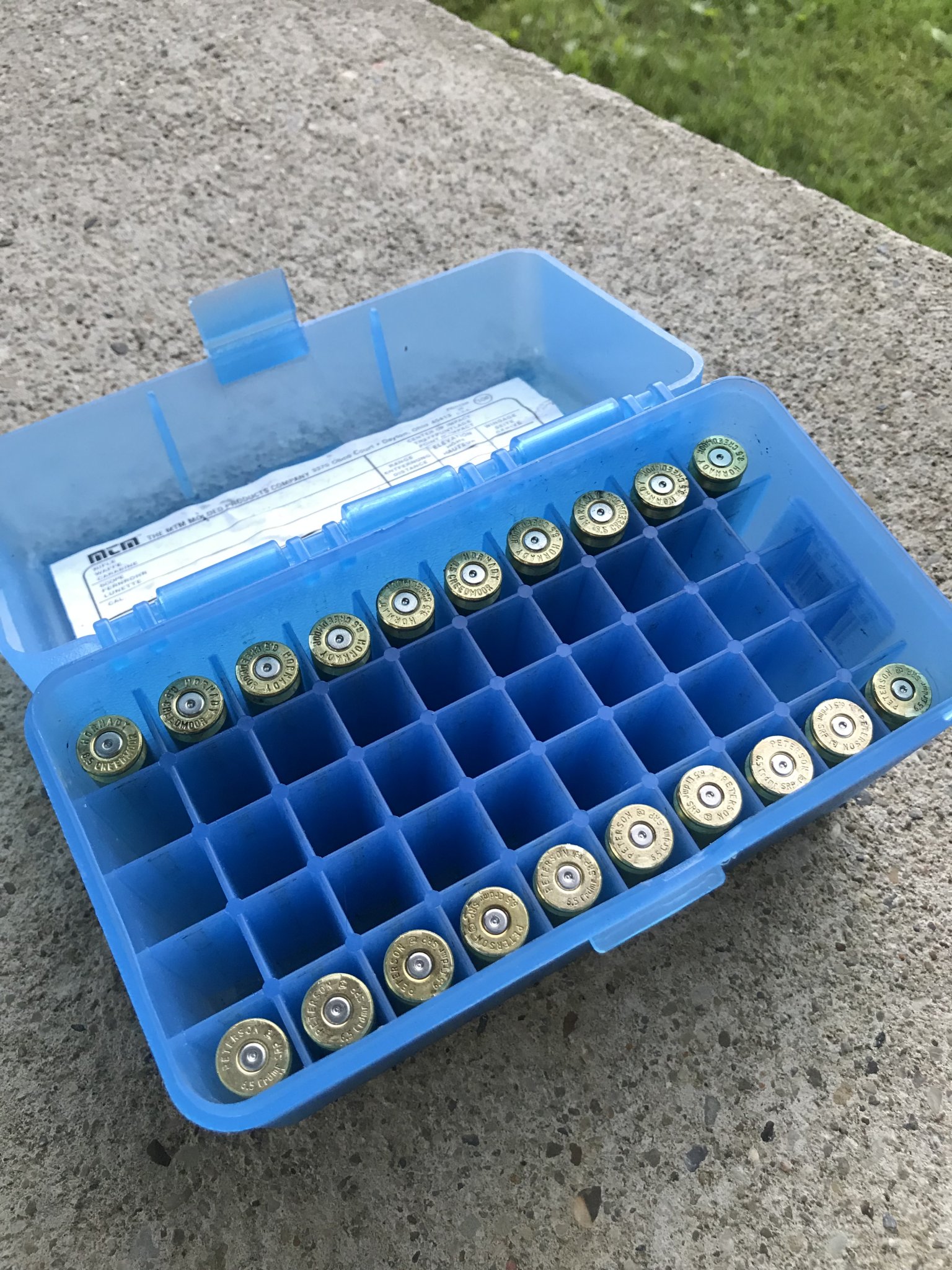

Here is some of this morning brass. Mild 6.5 CM load
That was my biggest concern I guess what headspace but I’ve recently read on their page it was .001-.0005 change. So not too bad. What was the lead time like?
I was quoted 5-10 day turnaround, I think it took 7 days. Less than 2 weeks including shipping both ways.
I’m really happy I did it, call them early in the morning around 7am CST and Chad will answer the phone and relive any headspace concerns you may have. I talked to him at length about it, they’ve got the process pretty well licked.
The balance in the Universe has been restored. Thanks to those who replied both in the thread and though PMs.
I did a complete clean and inspect of the rifle, removed the optic from the top rail and checked torque on all screws, removed the brake, removed the barrel (after cleaning) and reinstalled everything but the brake. As I said before, there was an excessive carbon blowback right at the 6 o'clock on the barrel, which is unusual for any of my SOCOMs, as were those groups.
I took the rifle back to Range 1 and again did the 100y zero. I first took 10 minutes to dryfire and check position, eyebox, cheek pressure and placement, etc. I then fired a Prime 130gr sighter at the center of the orange dot, which you see low left. I resighted and fired the center orange, then two more that are flanking on each side, again, with Prime. I reloaded with 130gr Bergers and shot the group to the left. Since each is exhibiting horizontal stringing, I'll check cheek rest and trigger pressure (I was using the three-finger method).
I'm convinced that brake was introducing a variable as what you now see is more my norm. Again, thanks to the hive.

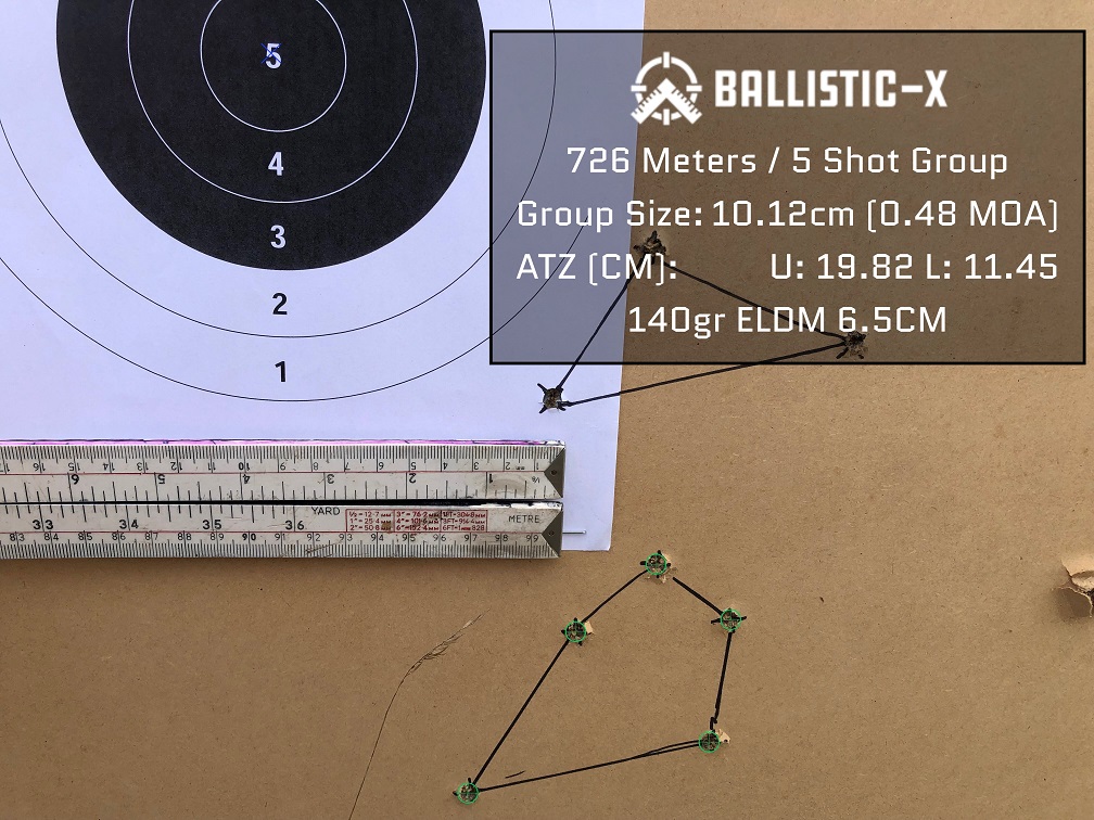

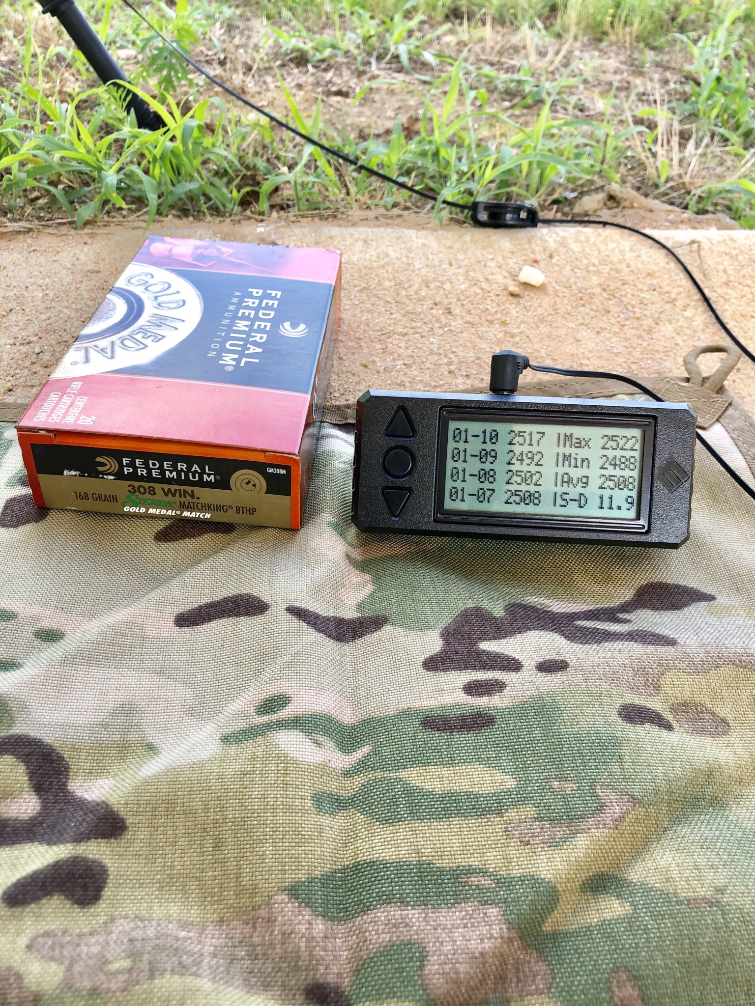

I had the opportunity to sneak away for a couple hours before vacation and the 16-3/4” barrel did not disappoint.
I have not had to tweak BCs or the AB custom curves much with the Kestrel 5700 Elite. This barrel and the 168gr’s I had to go from a G1 of 0.434 to 0.480. I thought it was odd, but everything lined up from 200-700yards and I was tagging 10-12” plates all the way.
Over the 30 rounds chrono’ed velocity was 2510fps, SD 10-12fps, ES 30-36.
There was one shot before this to figure out what the offset was after switching from 6.5CM to .308. This is the next 3 shots.

Worked all the way down to 37 grains. Still craters. Randomly pierced primers. Craters with factory loads too. Smh
I don't know if you can scope your bore, but you could have a carbon ring in the throat that's raising pressures. I was shooting my gas 260 and blowing primers with factory Hornady 130s ELD-Ms, which is a tame load. I scoped the bore and there was carbon buildup in the throat. Same could happen in a bolt rifle.
A clean barrel throat (4200 round count of 260):
Same area showing the carbon ring. I scrubbed out the ring and all went back to normal.
