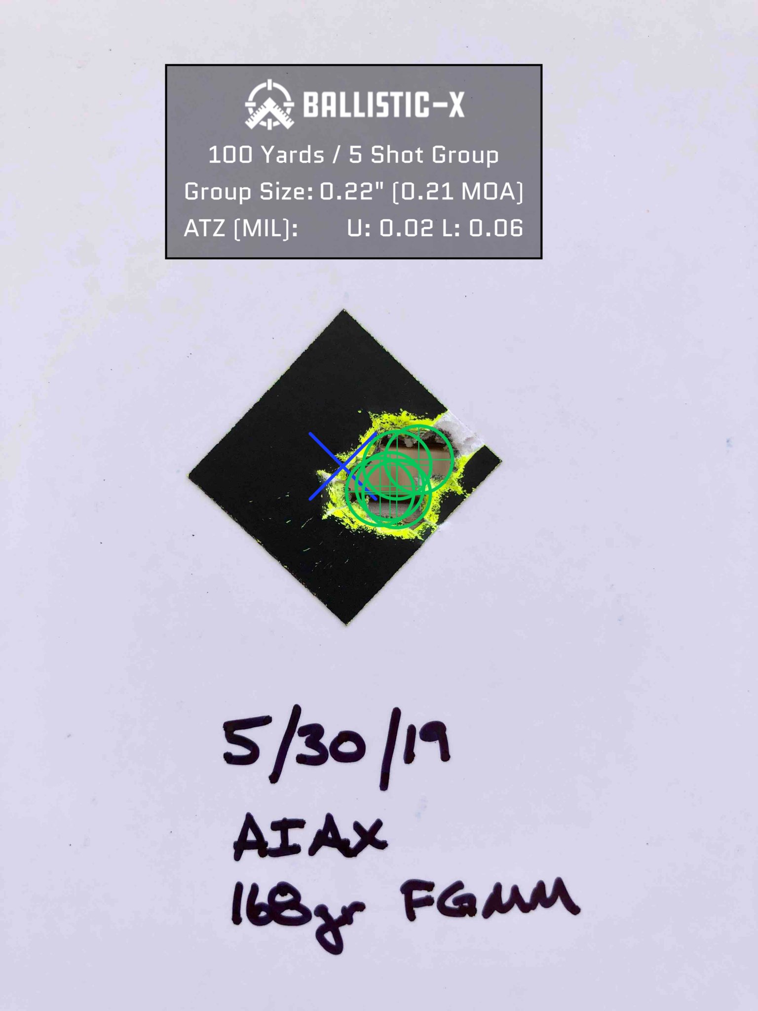

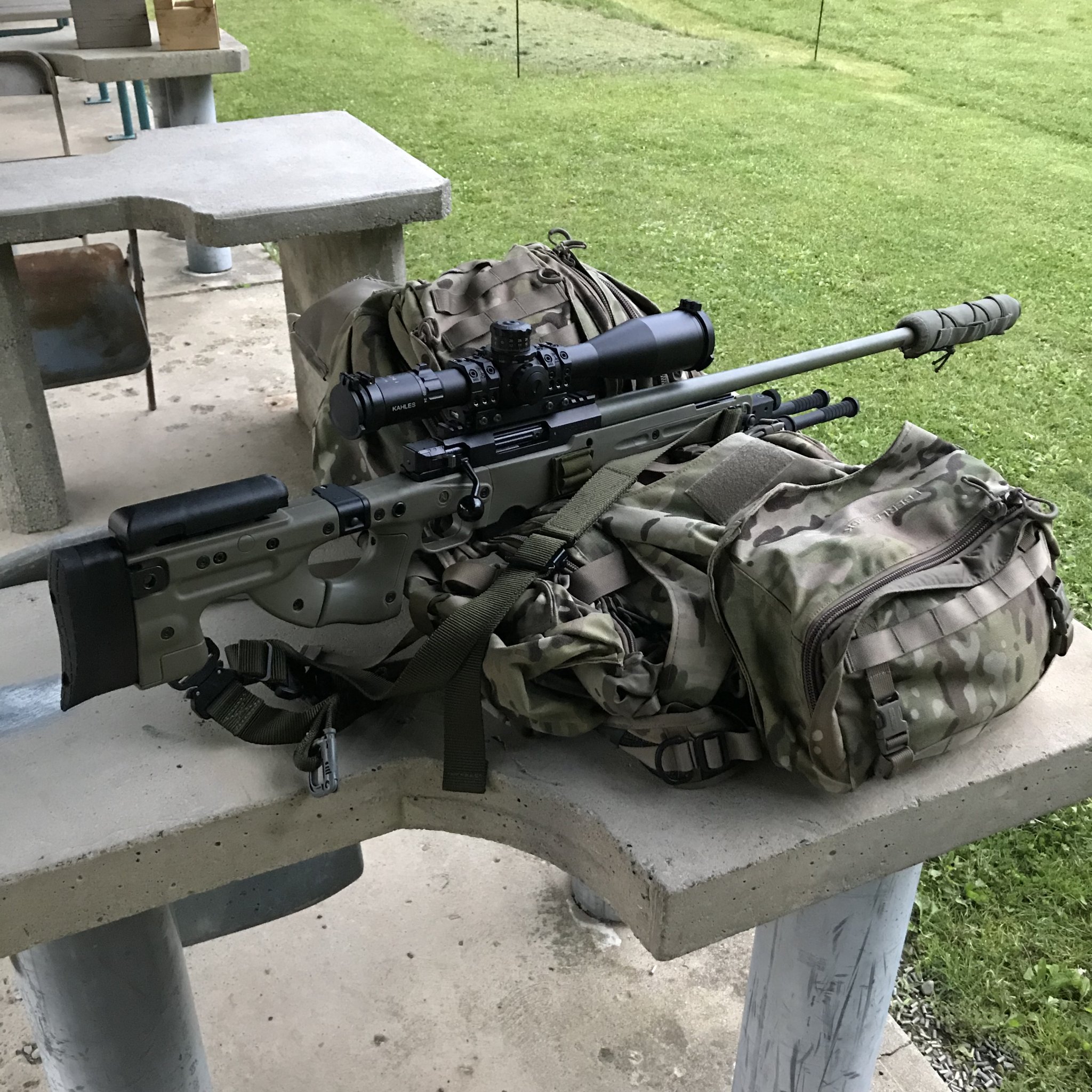

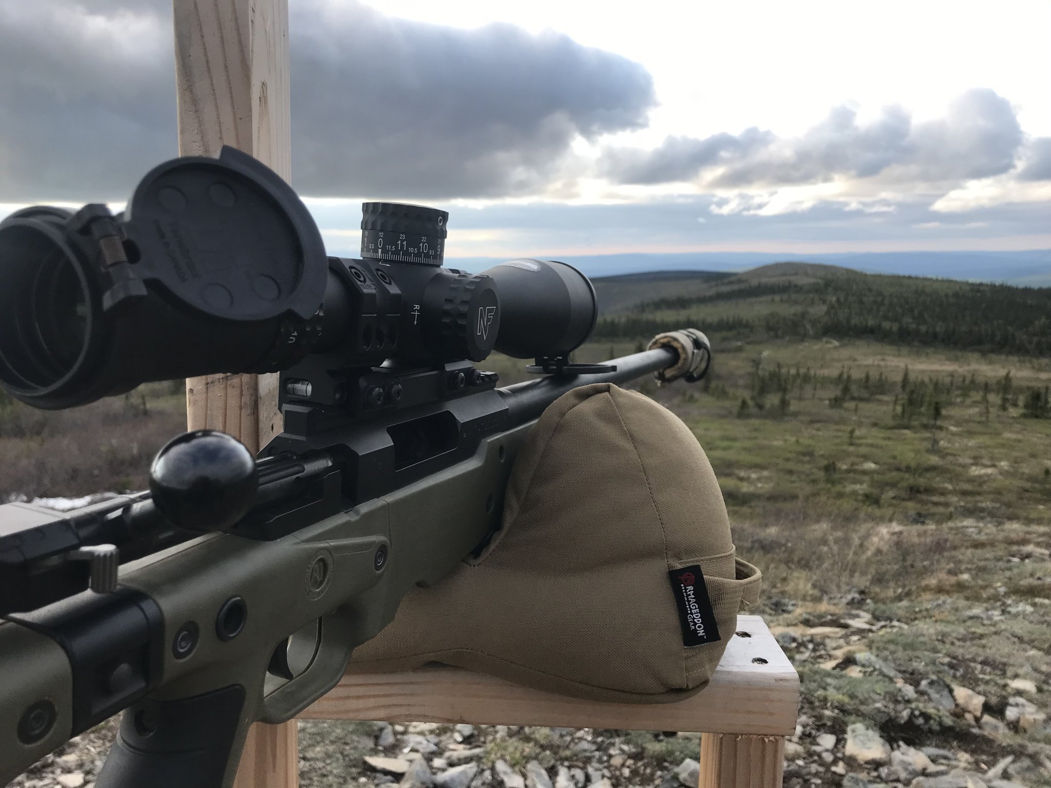

I had the opportunity to sneak away for a couple hours before vacation and the 16-3/4” barrel did not disappoint.
I have not had to tweak BCs or the AB custom curves much with the Kestrel 5700 Elite. This barrel and the 168gr’s I had to go from a G1 of 0.434 to 0.480. I thought it was odd, but everything lined up from 200-700yards and I was tagging 10-12” plates all the way.
Over the 30 rounds chrono’ed velocity was 2510fps, SD 10-12fps, ES 30-36.
There was one shot before this to figure out what the offset was after switching from 6.5CM to .308. This is the next 3 shots.
I was kinda rushed today so forgot to snag a pic on the line. This will have to do.

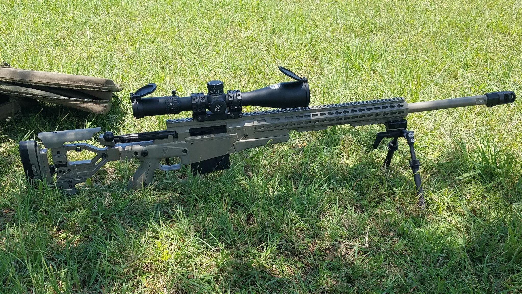

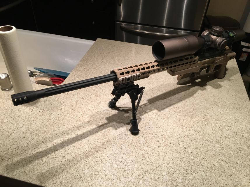

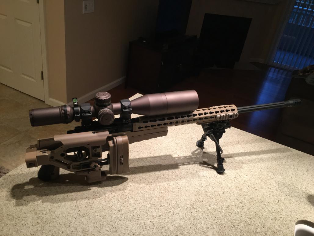

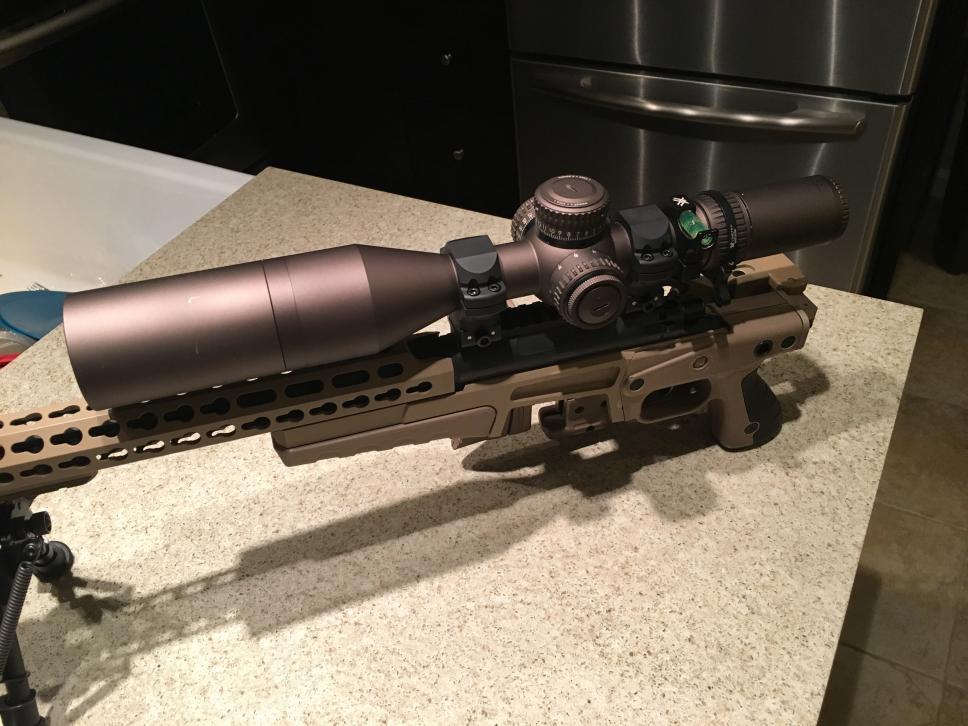

What color is this? Sage Green?

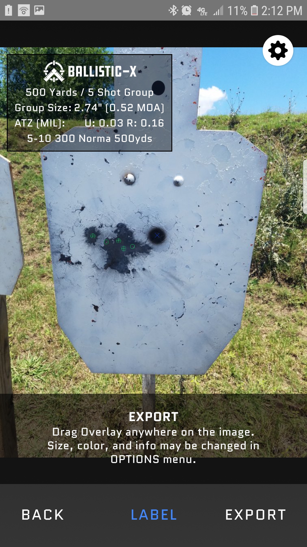

The 16-3/4” shorty loves the 168gr FGMM. Today’s results:
7086870
Winds were switchey and she held her own out to ~580yards. Past that I was really struggling. 10” and 12” circles at 620, 675, 695 yards were brutal. I definitely think I’ll finish off the 168gr’s and pick up some 175gr’s or the Berger 185gr Juggernauts.

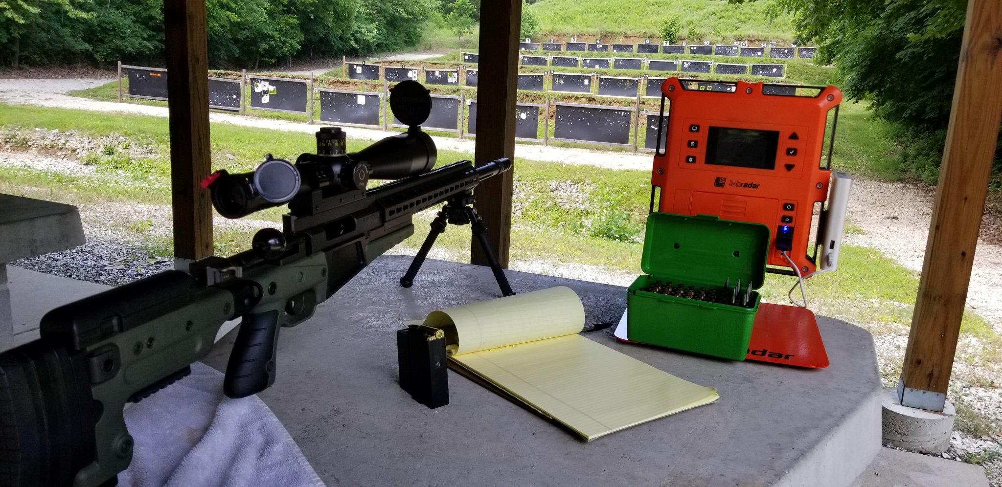

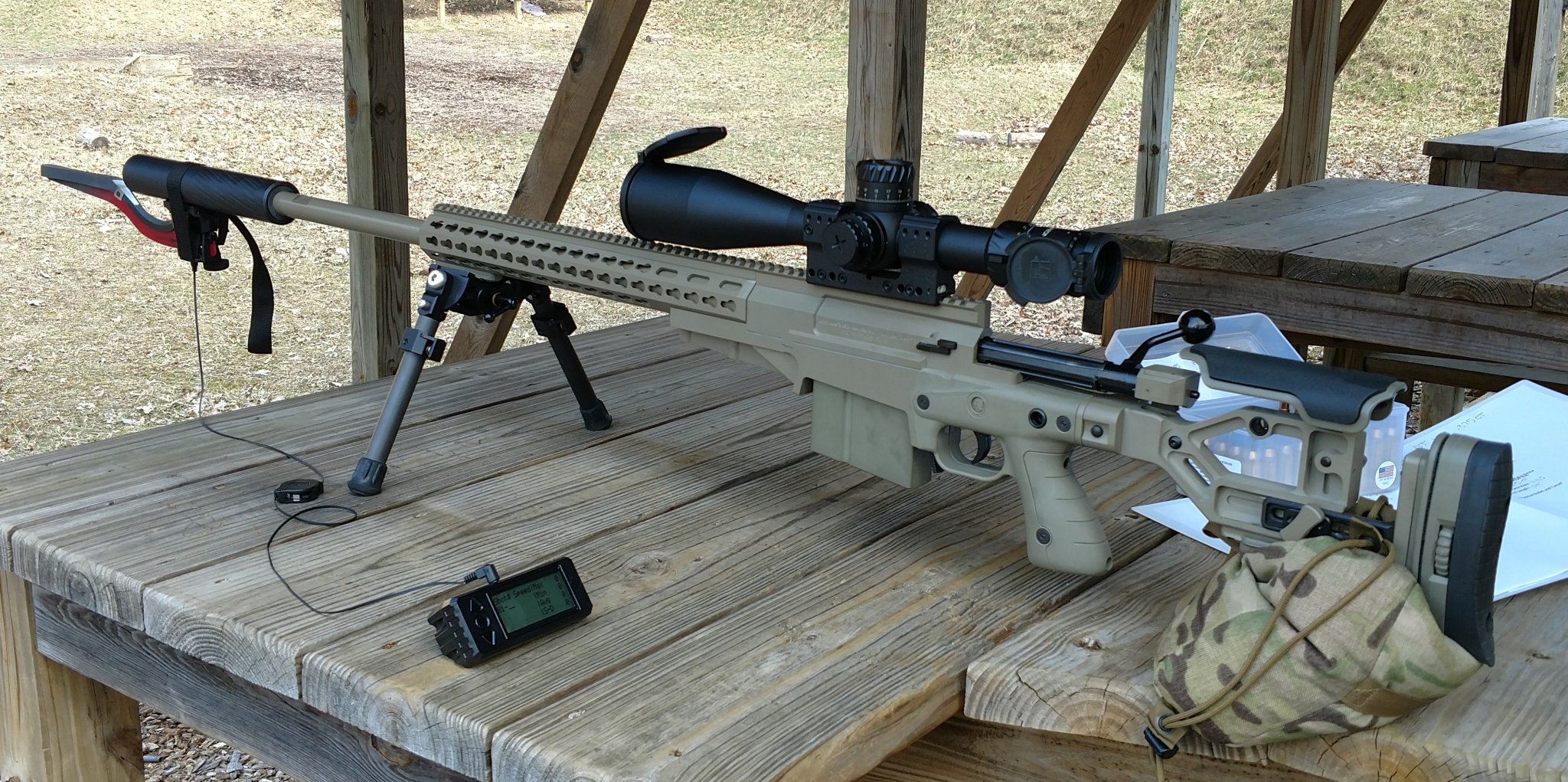

Took the AXMC out for the first time today.
7091378
1st 5 shots down the barrel. Shot 1 was high, 2nd was slightly left, then 3-5 stacked in nicely. This is factory Berger ammo with the 230gr Hybrid.
7091380
Plugged the info from the magneto speed into Ballistic Arc and went straight to 500yds. Shots 6-10
7091381
Overall, Ive extremely happy with this combo. Might be a week or two though before I can stretch her out past 1k.

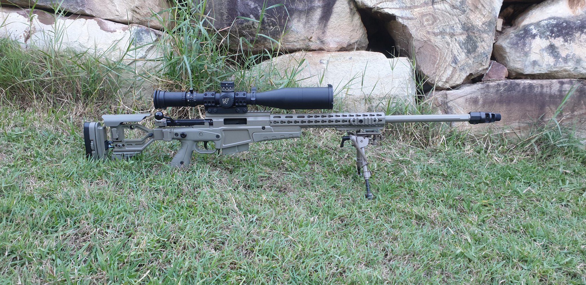

Well i finally joined the club. 2018 AX308 brand new from our local distributor here in Australia: Delta Tactical. Colour is Elite Sand; however, im painting it later this week. Up top is a Nightforce ATACR 7-35x56 with a Tremor3 reticle. This is going to be my new PRS rig. Currently has a 26inch 308 barrel; however, a 24 inch 6.5 creedmoor barrel is being spun up now from a bartlein blank i got from a prize table at the PRS here. Shooting it later this week.

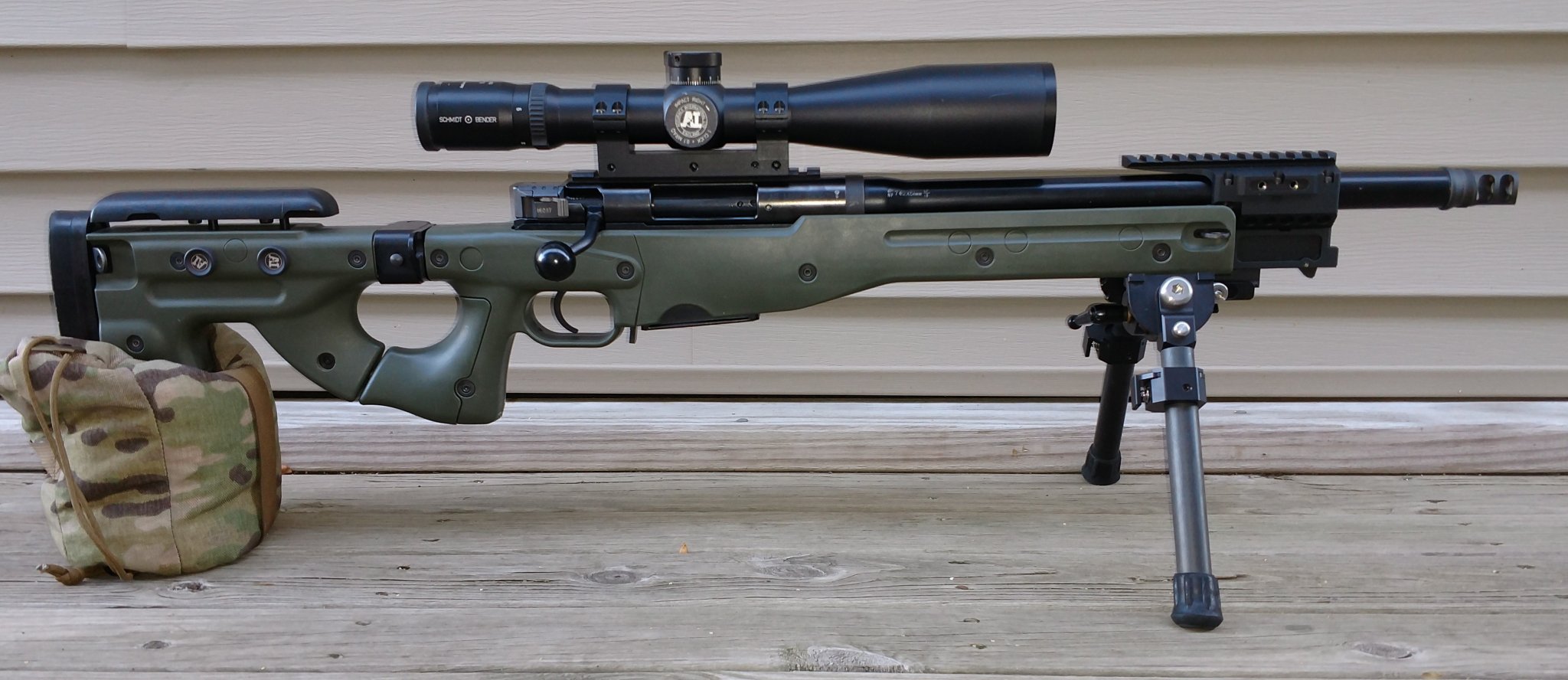

mkIII I just picked up from @roncar2008

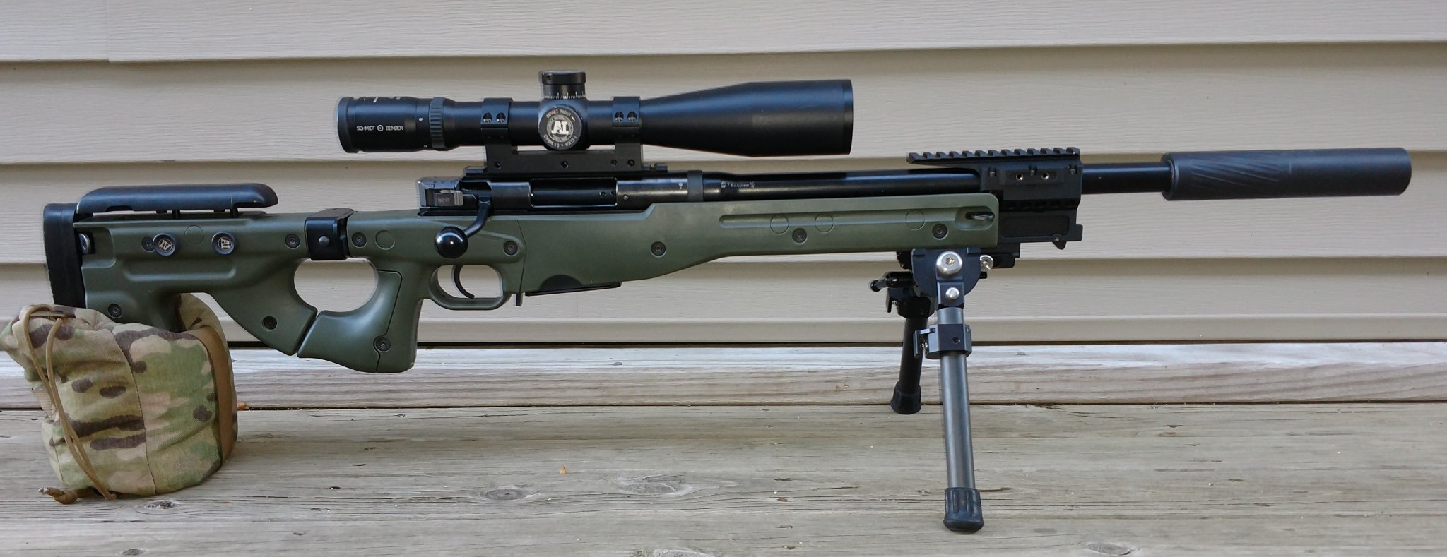

I just finished shortening the barrel to 16.25 and threading it 5/8-24. These AE's have some of the smoothest actions I have ever felt. Heading out to the range in a few to see how it performs!
Seeing pics of AW’s and AE’s with stubby barrels and cans like yours is what started me lusting after AI’s. Oddly enough I still haven’t picked up a stubby barrel for my AT.

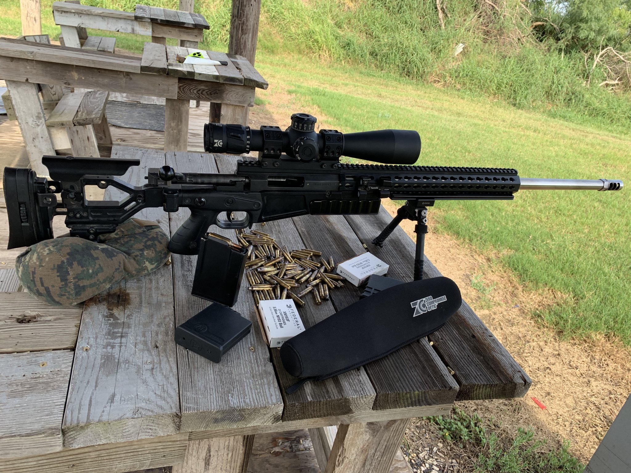

I’ll play, here’s my AX short action, 16” handguard, Zero Compromise MPCT2 in 26” 1-6.5 twist 223wylde.
Today I had a chance to run 100rds of XM193. I will say this ammo is crap out of this fast twist barrel struggled to maintain 2” at 100yds. This thing really loves 77 & 80.5 Berger’s.

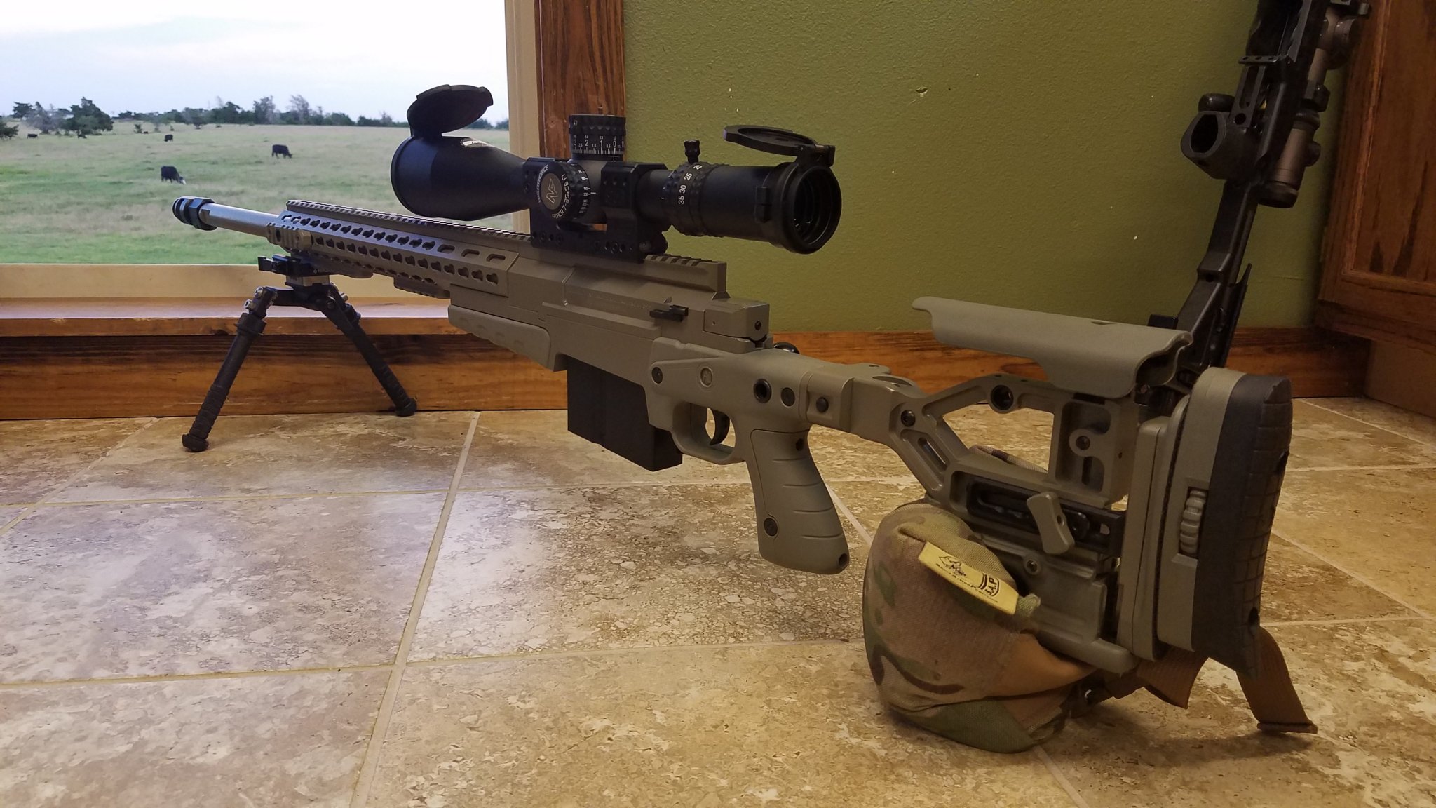

Those of you running a magnum caliber AXMC with the 30 MOA rail, and a Spuhr mount, did you go with a 0 cant rail or one with cant? I bought the 6mil/20.6 MOA Spuhr and with the zero stop set on my 7-35 Atacr, I have exactly 31.5 mils of elevation travel. I feel like my zero is pretty close the adjustment range limit. Should I run with this set up or opt for 0 MOA rail? With the 300 Norma I need approximately 22 mils to get to 2000 yards, which I feel will be the farthest I'll get an opportunity to shoot it.
I put a 0 mil spuhr (4006) on my 300NM because our local range is only 1000yd and that left me with 24.5mils on an M7xi. Looking at AB and Strelok I apparently need around 24mils at 2000 so I suppose this could be a problem at some point but I’m not even sure where I could shoot that far around here so I’ll cross that bridge when I come to it.
I haven't tested mine, but people are reporting 36-37 mils of total travel with a 7-35 ATACR. If I have 31.5 mils of remaining travel from my zero, I could assume I have at least 4.5 mils the other direction, correct? Is it safe to say I have enough of a buffer as to not be introducing any mechanical/optical issues by being totally topped out in the elevation travel?
Sounds reasonable. I have 37.1 total in mine.
The only down side of zeroing close to the edge of the travel is that there will be some shadowing on the top of the field of view when at zero.
So at 0 MOA you have 18 mils up and 18 mils down. 30 MOA cant is rougly 8.89 mils. 18 + 8.89 = 26.89 mils. You'd be fine with a zero MOA if you're having optical clarity issues with the 50 MOA total cant.
