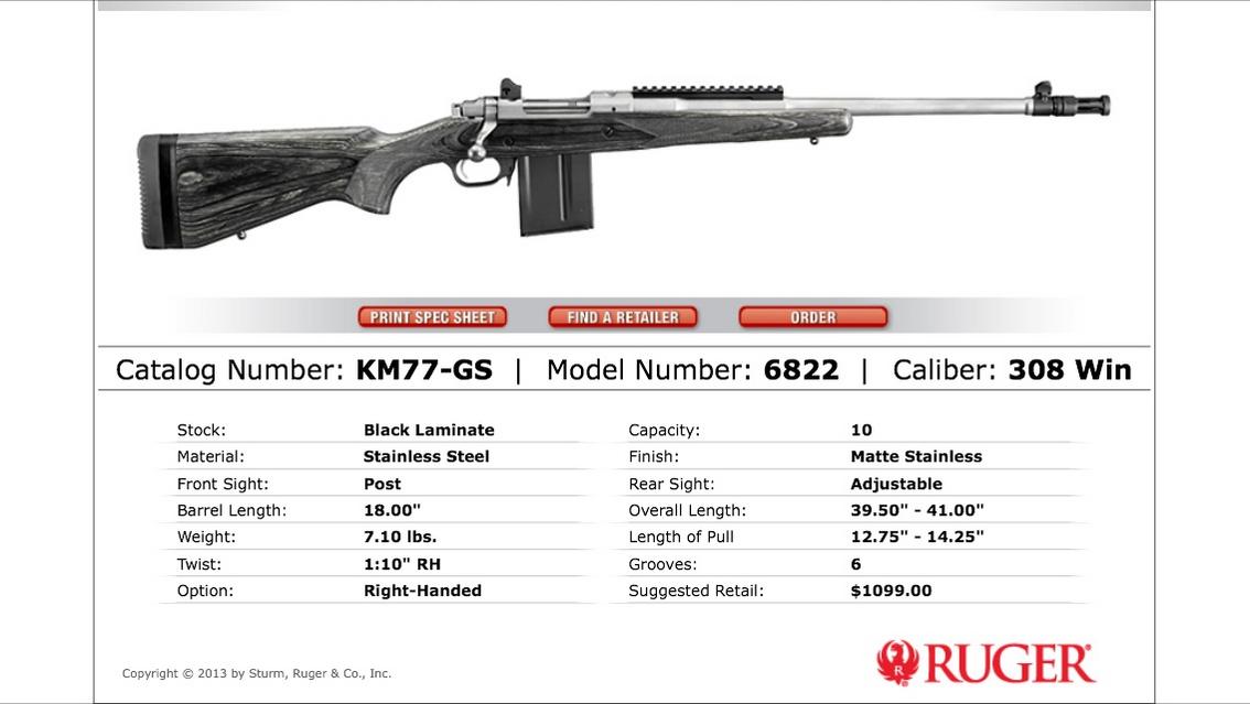

If you really want a scout optic type setup, the Ruger Gunsite Scout has forward picatinny mount, and 16.5" or 18" barrel in regular or stainless. 7.1 lbs, detachable mag, and great iron sights. I've seen them around $750-$850. Burris 2.75x scout scope and go hiking...:cool:

I almost bought one, and while it'll probably outshoot me, is accuracy not a sum of myself and the rifle? If I shoot 2 inches with a tack driver and someone that drives tacks shoots 2 inches with that rifle, should I not expect 4 inch groups? The reviews I've seen for that rifle come in about 1.5 MOA, why handicap myself?

Yeah, I've heard accuracy is hit and miss on the Ruger GSS. If it could be easily made into an honest 1moa gun, I think it would fill it's niche nicely. I'm curious if the pre-machined aluminum pillars that are available for them would make much difference, I'm guessing most of the accuracy issues are stock-fit related, but I dunno.
About scout scopes, I think Col. Jeff Cooper was on to something with the Scout rifle concept, the forward mounted optic does give more peripheral vision. But, eye-relief is directly proportional to field of view (all things being equal), so even with a low power setting you still have drastically smaller magnified filed of view. I find the only useful magnification on scout scopes is under 3x. With the 1-4x and 1-6x scopes being as good as they are these days, most guys prefer a true 1x for close range target acquisition, as it provides a seamless stereoscopic sight picture, and the 4x or 6x on the high end is more useful that the 2x-3x of useable top end of scout scopes....IMO. If you have't looked through a high quality 1-4x, check em out... I love the Trijicon 1-4x24 with amber triangle and would be my choice for a short, handy scout type rifle.

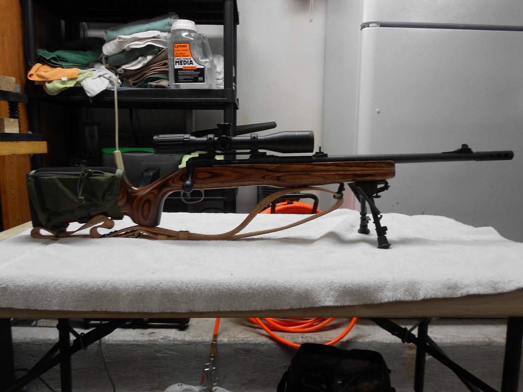

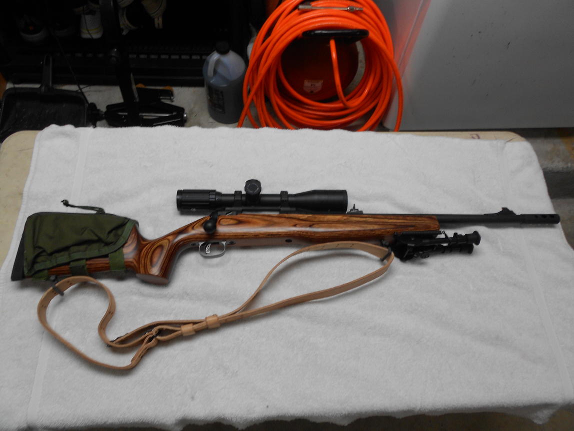

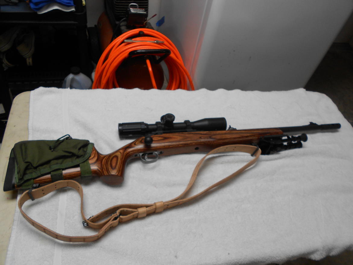

My GSS is about 2" at 100 yds with the irons and me behind it. Using just a Harris bipod on the front and shooting from a bench.
Remove rear sight and install 3x9 Leupold VX-3 in the factory rings that come with the gun and it is MOA or a little less under the same conditions. One change, 168 FGMM.
I tried 3 different scout scopes and never was able to get a satisfactory picture through the tube.
I have the option (spare scope) to mount a Trijicon 1-4x24 Accupoint with yellow post and chevron. Gonna use that for deer this season if I can get time off from work. Got one last year with the Leupold.
This makes a nice, handy hunting gun and the accuracy is more than adequate. Took the deer at about 175 with Hornady Zombie Max 165.

That is a very nice looking rifle, I hope it shoots as well as it looks.
Are the irons at least slightly usable with the scope and rings off but rail still attached? I do know sight picture will be degraded.
