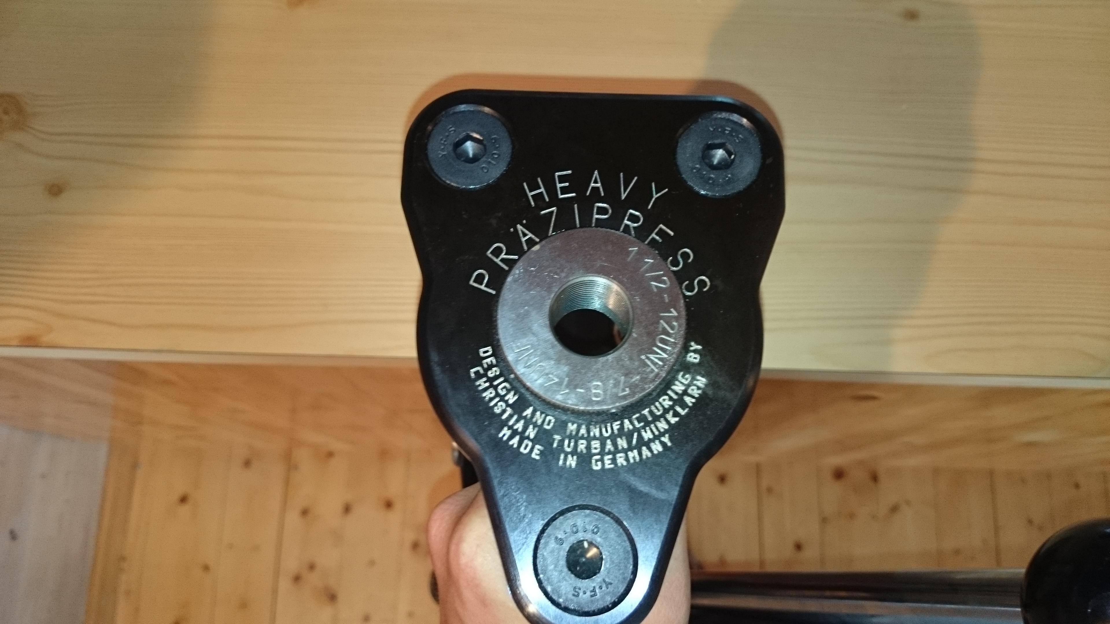

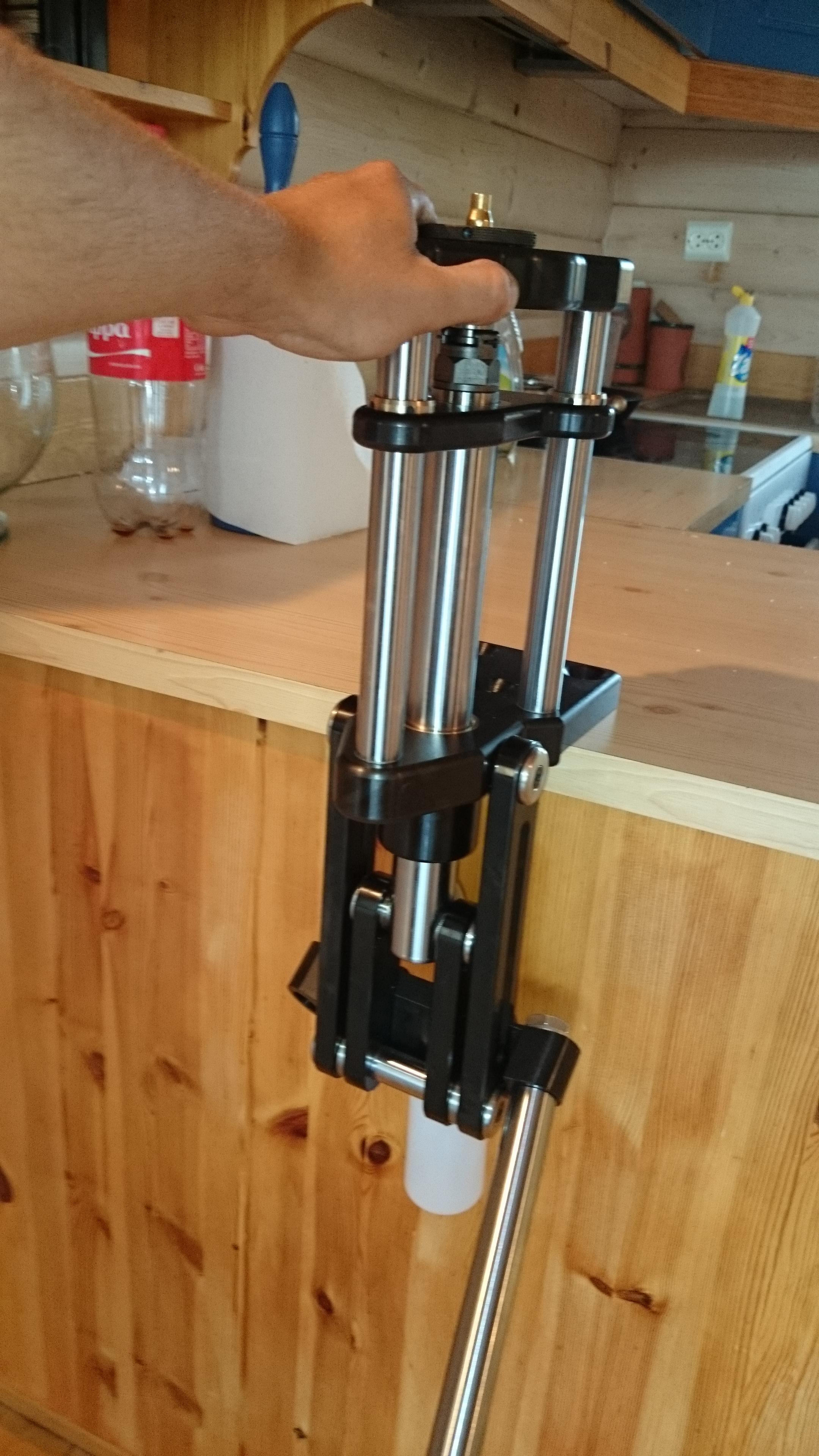

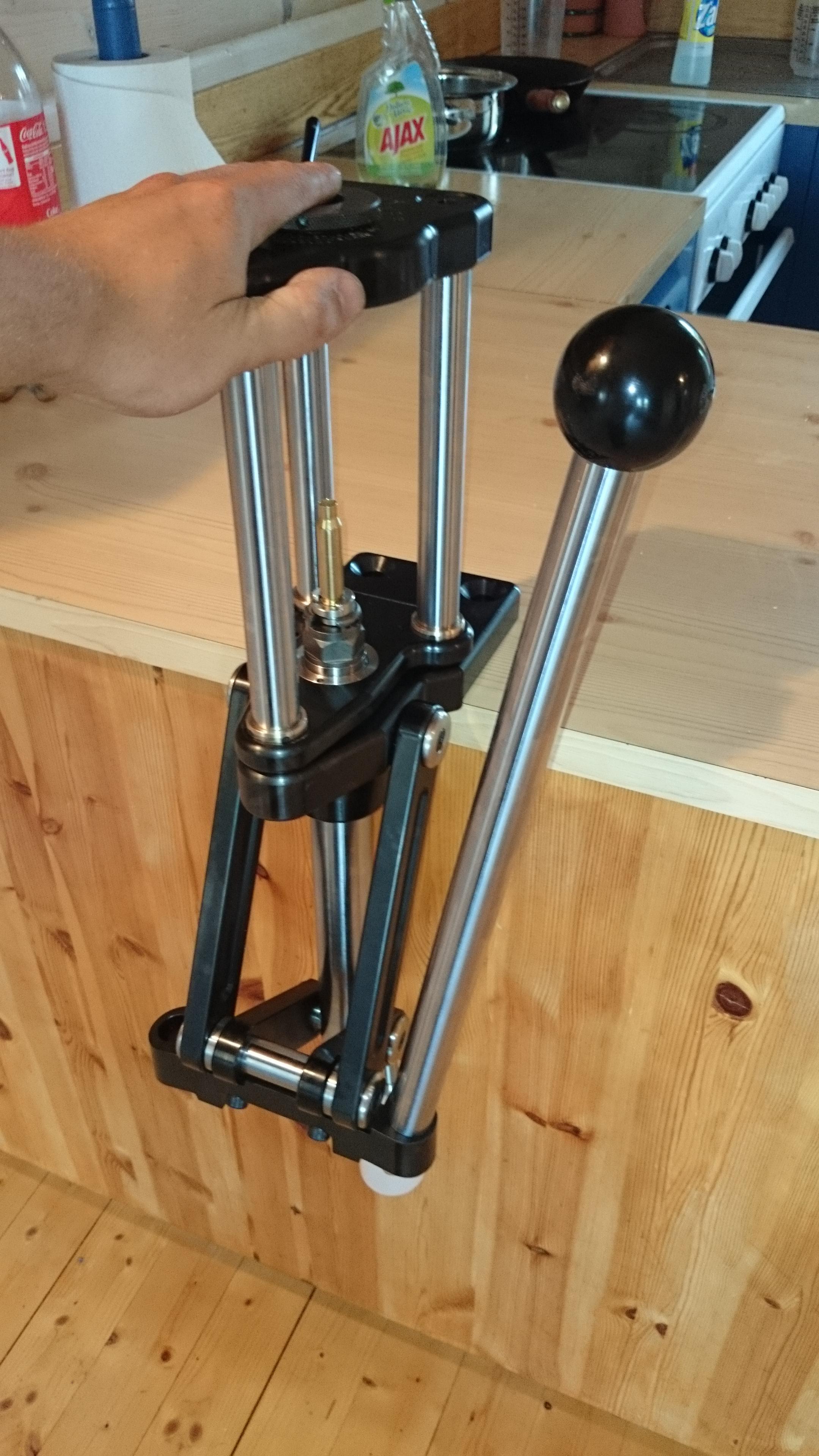

I currently have 2 single stage presses, but i do not believe they will fall into any of your categories.
I have chose them because i use mostly 1 1/4-12 threaded dies, and there are no alignment issues as with other presses.
They weight 37 pounds without dies, and all parts are CNC machined to very high tolerances from solid billet steel.
Except for the F.Misumi bushings.
As i have never seen it on the forums, i added some pictures from when i got the first one with a 308 case in the holder.
What i believe to be the best available currently, but the price tag is a bit hard to swallow.

@ powermac: thats one nice press, I came across those Turban Presses when researching. I guess everybody loves german precision engeneering, but at that point it would simply be overkill for my needs.
