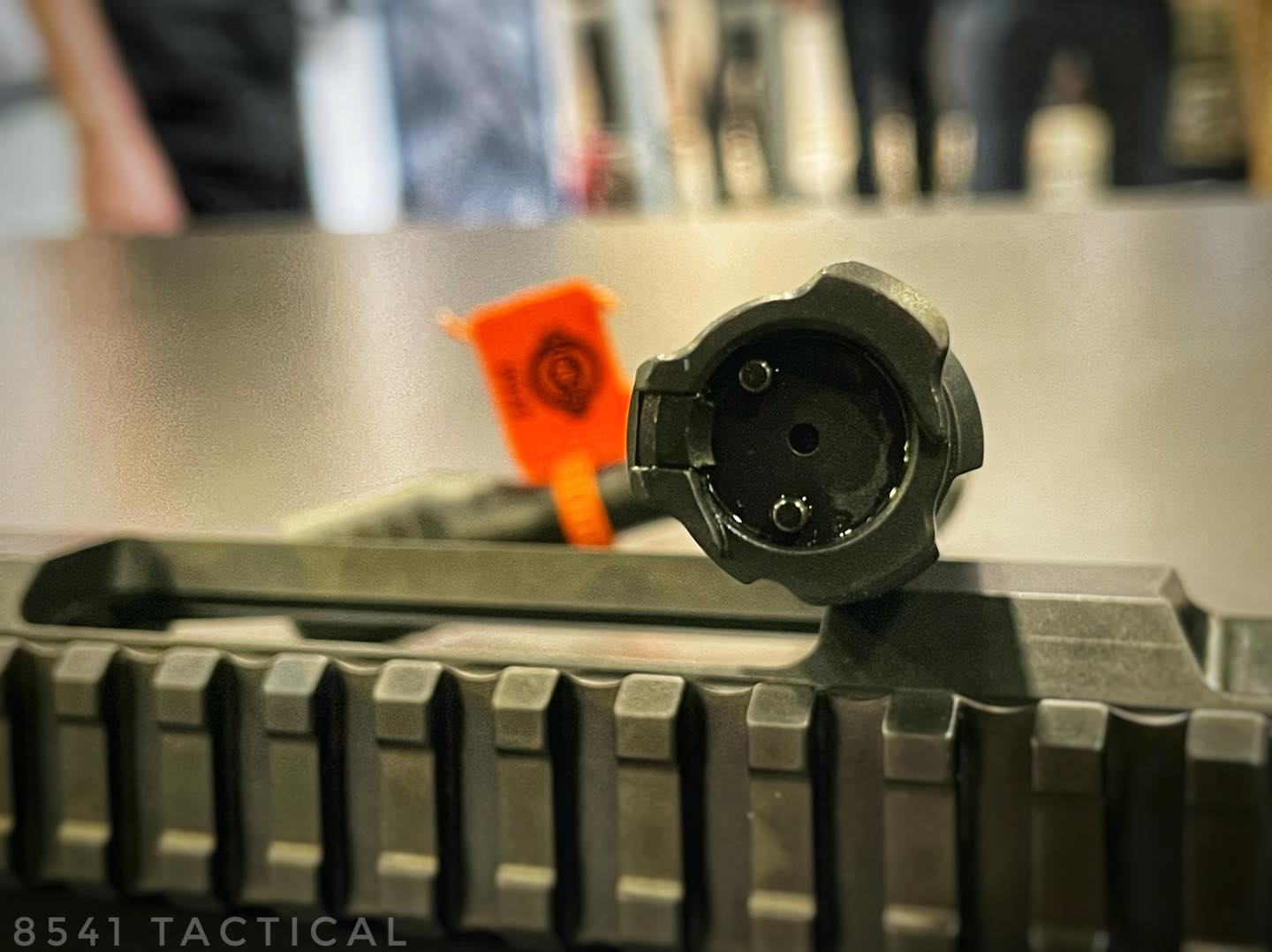

My best guess is that they had to make that recessed bolt face cut to enable the bolt stop to work in the confines of the action.
Another thing to note on another photo from 8541 is that it has dual cocking cams. Barely visible, but it is there.
Looking forward to the final product @Areo!
The biggest challenge that their engineers are going to face due to the layout they have chosen is reliable ejection. That must be the reason for the twin ejectors and strategic location of them.
