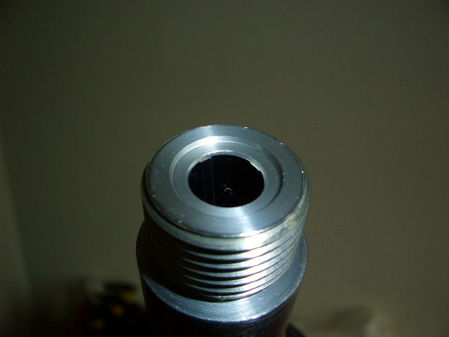

I've got a brand new AX 308 20" with 16" forend rail. Did not fire it yet, but I was a bit astonished about some things:
- the finish reminds me a bit the arsenal sar m1 - rugged, but with small scratches and not that perfect as I did expect for that rifle

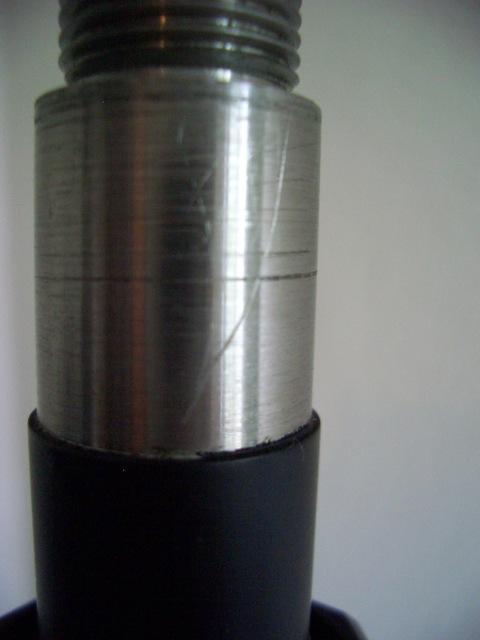

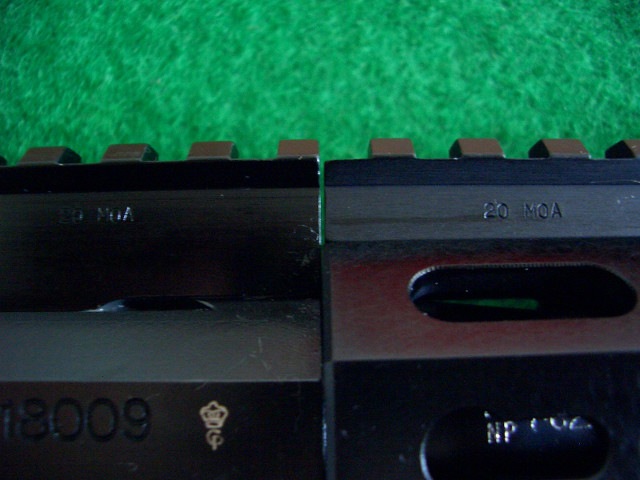

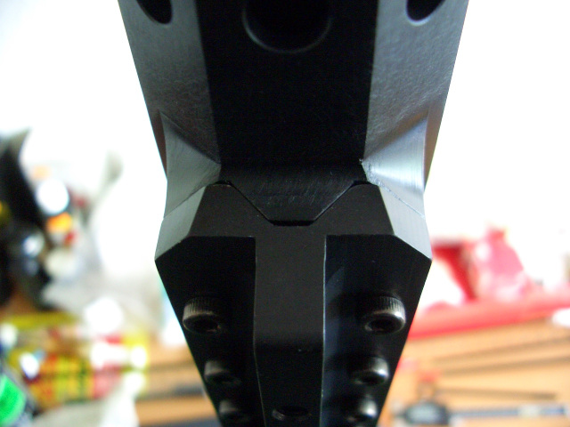

- the quad forend is off center at the top end .

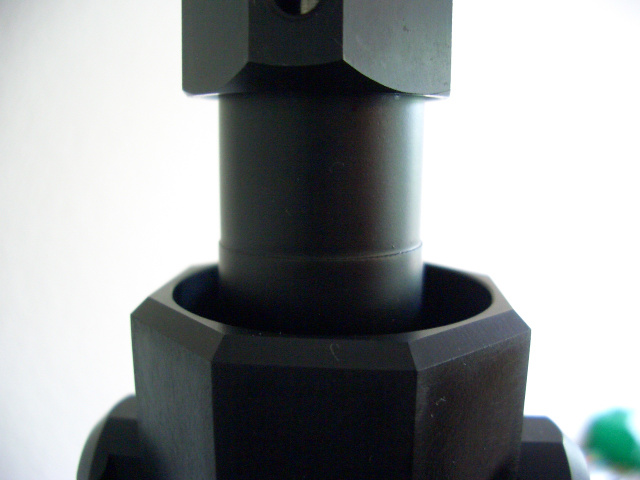

- there are lots of toolmarks at the barrel under the muzzlebrake and a little burr at the sink of the muzzle
Do you have similar experience with the AX rifles?

Checked the forend. It's secured by 6 screws. Loosened them a bit and tried to put the rail into the right place. But as soon as you tight the screws, it will end up like before because it is guided by the chassis.
Will take some pics.

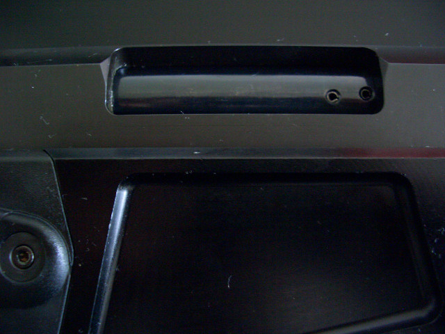

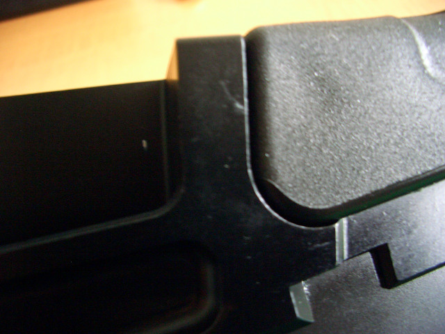

some pics: forend, barrel with brake removed, muzzle

Thats a new rifle? If so return it if possible as this is definitely not norm and further more i don't think any paying customer should accept this from ANY company/dealer...

That said, looking at your pics, the scratches do seem a bit excessive for a new rifle, and the handguard alignment is not acceptable. I would ship that rifle back.

Unacceptable even if it were a cheap rifle. Completely unacceptable for a rifle of that cost. It looks like a used rifle that was haphazzardly refurbished.

Don't think so. The forend itself seems even as I can see so far. The rail on top of the receiver also. But when you look from the top front, you can see the forend has got an angle to the side compared to the rail of the receiver. It's because of the guiderails either at the forend or the chassis or both.

As for the gun itself, I'd be most concerned about the rail. The tool marks in the turned down portion of the barrel look to be from the muzzle brake not where it was turned.
