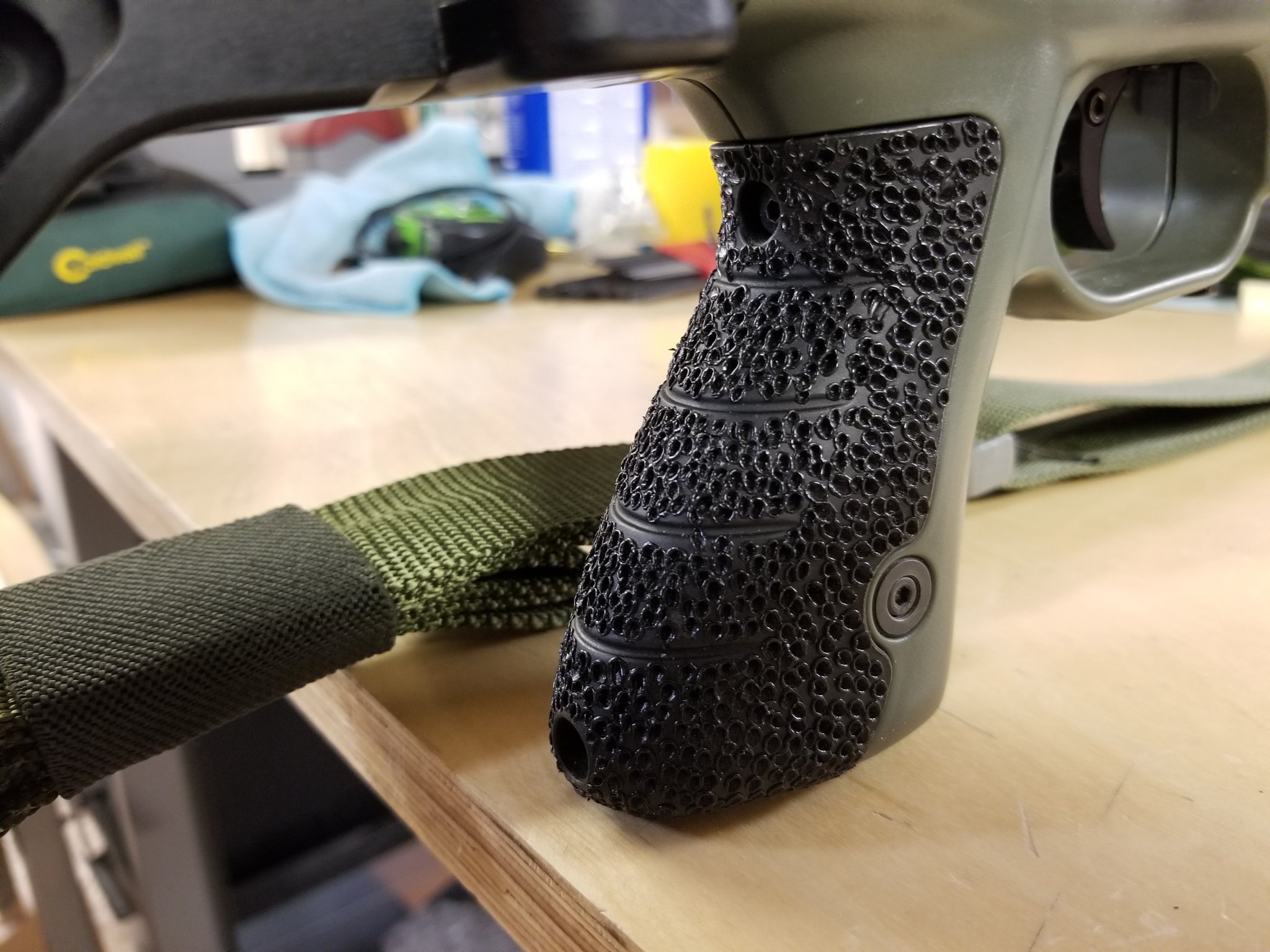

    I got asked about the texture on my AX grip backstrap, so I figured I might as well share so others can get ideas, maybe improve on this.
    I didn't like the "slick" surface on the grip of my AX when I got it, so I figured I have a couple ways to fix:
    - Use self-adhesive 1/16" closed-cell foam, similar to the cheek pads from Hoptic but thinner
    - break out the checkering files

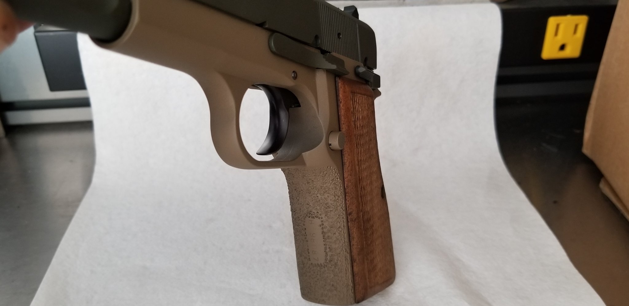

    - stipple, like I do to my 1911 frontstrap or my FEG BHP clone:
    So I looked at how the customizers & DIY-ers are doing the Glock frames, broke out my soldering iron and ... just in case ... bought a new backstrap from EuroOptic. Took under an hour after the iron warmed up.
    Result feels pretty good and works for me:
