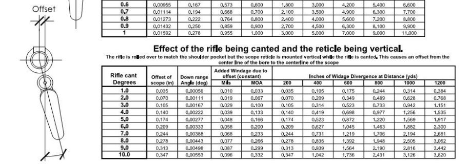

    Have a read on what needs to be level.
    So after reading 400(ish) posts about scope mounting and leveling I had to do the math.
    Every time a scope mounting or leveling thread is posted it usually leads to conversations about weather the rifle needs to be level when the scope is mounted level. And sometimes is goes into weather the scope needs to be mounted directly over the bore and not offset from the bore. Well, math 'never' lies. So... attached is a sheet I put together for the down range effects of...1) mounting your scope with an offset from the bore, 2) mounting the scope level with the rifle not level, and 3) effects of a canted reticle dues to not being mounted correctly or canting the entire system.
    I was very surprised to find the offsets due to mounting or rifle cant (with level scope) are very minimal. especially when compared to the canting of the scope. I could understand needing to worry much more about the offsets when shooting over... maybe 3000 yards, but even then its a strech then compaired to wind calls or actual scope cant.
    Conclusions:
    We need to have a level reticle or level tracking (not always the same) but don't fret over the mounting offsets (case 1) or canting the rifle with a level scope (case 2). Do worry about canting the scope.
    Reactions: rlarsen462

    effects-of-offset-and-cant-of-a-rifle-jpg.7074705

    Thank you Jack and I had read that post during my searches. The math definitely helps me understand. In my case, the action is the "rifle", correct, since it appears (if you trust the levels which is potentially suspect in and of itself) to be out of line with the stock? So as long as I have a level reticle with level scope mounted level, it probably doesn't matter much whether it's dead on level with either the stock or the action as the difference is going to be an inch or less at 1000 yards it seems? Which I think is basically what Lowlight already said I guess. :)(y)
    You are on it.
    Disregard the level in the stock and mount your level for your scope reticle. (I.e. mount the level on the scope tube, not the pic rail or a ring)

    Yep this was already the plan, to mount a level to the scope tube per one of your previous posts, then mount that scope/level assembly to the rifle/scope base...it was just a function of whether I was trying to level the scope/level assembly to the scope base/action, or to the level embedded in the stock, if that makes sense.
    Neither of these mater. You'll see in the math i did the stock or rifle action do not need to be plumb, but when you "mount your rifle" the reticle needs to be plumb. Some people pull the rifle into thier should with the stock at an angle and adjust thier scope to be level (shown below)
    But, if you want to plumb the action to the scope is fine as well.
    Doing this is still Okay. some people could have a 5 or 10 degrees rifle cant in extreme cases. As long as the reticle is level is all that matters.
    Cheers. good luck
