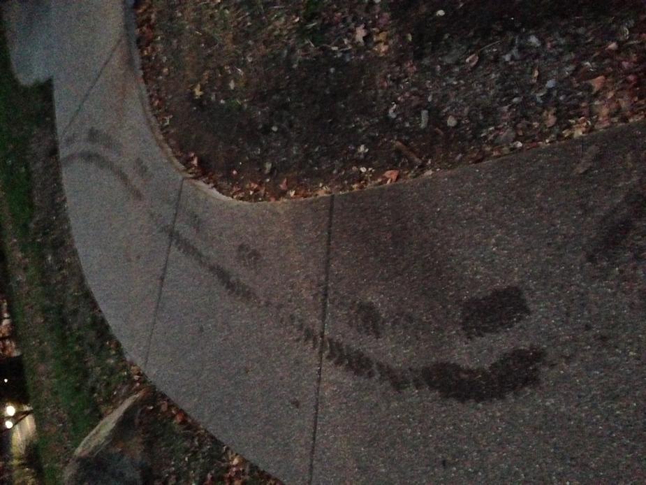

to make a long story short, my stump grinder blew a hydraulic hose today.
after it blew, instead of leaving the machine where it was, in a mulch bed that could have been easily cleaned up...no...the guy running the machine drove it over a NEW exposed aggregate sidewalk, leaving a 12' long by 6" wide hydraulic fluid stream across the sidewalk.
WTF really!?!
so, what can i do to clean it up?

I am a concrete guy and the only way on exposed agg to fix I would I think some kind of polishing stone but that might damage it to. Try pressure washing but other than that you might be fucked I still have hydrolic oil on my side walk when a hose blew on the skid steer from 3 years ago and most pressure washed off but I can still see the stain. What really makes it worse it is new side walk so still pretty porous.

I second the Muriatic Acid suggestion. This was told to me by a Concrete Plant Head Mixer, many years ago. You'll have to google/enquire exactly how to go about doing so, but when they are doing "layer" and whatnot, this is what they use to totally clean off the surface. And it soaks in somewhat, to help 'float' out the oil.
And, as suggested, you would need to neutralize the surface when you've completed it.
Just my $0.02, and worth about what you paid. Good luck, and remember this come 'performance review' time.
Well not a concrete guy but a pool guy. Do a lot of acid washes. I would first try whatever store bought degreaser you can on it. If this was anything other than exposed aggregate I would not suggest the muriatic acid, being that it's a new pour. If degreaser/cleaner doesn't work, go the acid route. The acid is basically stripping away a thin layer of the concrete, so you will likely want to treat the whole section between two expansion joints to keep things matching as well as you can.
Dilute the acid in a fresh 5 gallon bucket. 4 parts water to one part acid is good low consistency to start with. Add water to the bucket first, then the acid. Pour it low and don't breath it, obviously. Get a nylon pole brush and brush it on. Let it sit for 30-45 seconds at a time. Spray it off with a low psi pressure washer 2500ish psi. If you don't have a pressure washer the garden hose will work, just more slowely. Repeat the process till you get the result you want. After it's clean. Allow the area to dry a bit then get TSP at box store and mix in a new bucket and scrub with that. The TSP will neutralize the acid and your good to go.

Yes better detail with NMMX method. A garden hose is all I have ever used when working with exposed aggregate and a heavy duty brush. Dilute muratic acid like ^^^. And spray on, let sit a bit and brush.neutralize muratic acid by mixing water and baking powder. TSP works too. Spray that on. Wear rubber gloves and safety glasses. You can repeat until you eliminate the stain if you have too.
Go to the auto parts store, buy a few bags of oil absorbent. Similar to cat litter. Put it on, even grind it in a little with your feet. Sweep it up after 12 hours or so, then apply more. This soaks up the oil, and works very well. Subsequent applications help suck the oil out of the concrete.

I really hope it works out for you. That hyd fluid isn't that tough to clean, but if it's not raining, BAKING SODA will help pull it up where it can be shoveled out like cat sand then power washed with some good degreaser to totally remove it.

it's the fact the homeowner just moved in, had the sidewalk put in this september, and we fucked it up. it's an eyesore, and it's the right thing to do.
would you want to come home to that everyday?

i got together with the homeowner to discuss the stain.
the stain has come out about 95%. you can only see it if you knew it was there. other than that, if you never knew, you wouldn't be able to see it unless someone points it out.
the homeowner is happy with everything. we actually did $1000 worth more of work that he wanted to pay us for but i refused.
thanks for the input guys.
i took a pic with my phone of the after, and for some reason you can see it on the phone pic, but not standing there (unless you know where to look).
i posted a before pic on post #36.
