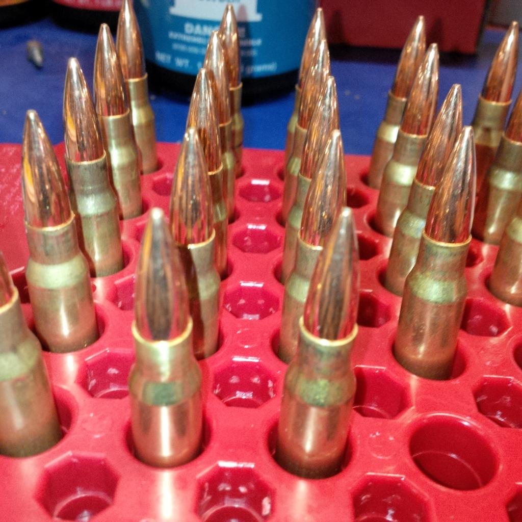

Ok, so I was sitting on about 700 pieces of .308 fire-formed brass and going broke trying to feed my rifle 200 round cases of FGMM. So after reading here for a few months, I set my wife off to BOLO for re-loading equipment at the many yard sales she goes to every weekend. She finally scored a few weeks ago. I picked up a used but well loved Lyman All-American turret press and some associated components at a yard sale for $75. Went out and got the .308 dies (RCBS), Ultrasonic cleaner, chamfer tool, primer pocket reamer, Flash Hole de-burring tool/uniformer, digital calipers, digital scale and on, and on...Powder is in decent supply in East TN at the moment so I have some IMR 3031, IMR 4064 and Varget. Got Berger OTM 175 Tacticals and some Hornady 150 FMJ BT that I got to practice loading dummy rounds until I got the seating right (those Berger's ain't cheap). Fast Forward to last night..
Got my first run of 175 Bergers and some 150's done, marked as to the load and ready to go....I have a reloading manual, researched here and online from the powder manuf websites and took my time and wrote everything I did down....so why am I nervous about pulling the trigger-literally?
Loads are;
175 Berger OTM Tactical
Fire-Formed Brass (various-FGMM, LC LR, Black Hills Match, Rem Match)
CCI BR-2 Primers
41.8 Gr of IMR 4064
2.801 COAL for mag feed
(also loaded 10 of the above substituting 44 gr of Varget to test as well)
150 Hornady FMJ-BT
Fire Formed Brass
CCI BR-2 primer
10 each of 41.5 gr 3031, 42 gr 3031, 42.5 gr 3031
2.801 COAL

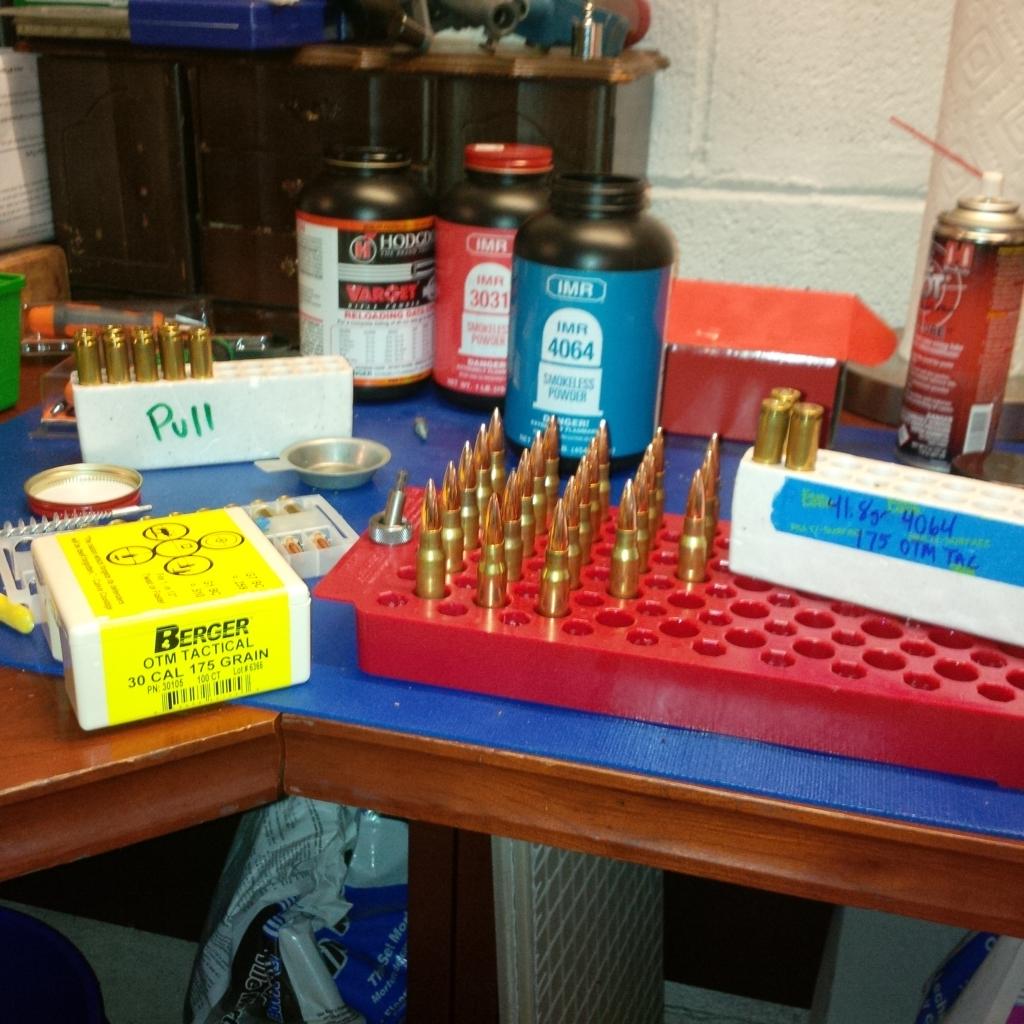

Def good advice. It wasnt for the pic..that is just where they happened to be. I have small containers marked with tape w/ name of powder. I pour the powder i am using into it from factory jug and use powder strictly from the marked container. I only work with one powder in a sitting and i segment my sessions ie; decapping/chamfer/sizing/cleaning only, priming only, powder and load only. May sound weird, but Otherwise, i would prob get mixed up...

Lots of good advice and comments guys..thanks. Range test went well. No FTF, no pressure signs, primers look good and no scars. I dont have a chrono yet but just comparing to Dope i have from Factory loaded 149 gr Nato, M118 LR, and FGMM i have found very good starting loads with my 150 gr FMJ BT Hornady loads for out to 600-700. My 175 OTM Tactical Berger load was hitting steel at 400, 450, 500 & 600 yds at .5 to .6 mils less elevation hold than w/ 175 FGMM at about same weather conditions and at same altitude. Chrono on the "to be purchased" list...
Just FYI:
Rifle is a R700 AAC-SD .308 20" barrel w/SF Socom brake
150 gr Hornady FMJBT Load
41.5 gr IMR 3031
BR2 CCI primers
fireformed 118LR, FC 12 and FGMM brass
175 Berger OTM Tactical Load
41.8 IMR 4064
Same primer, same brass
