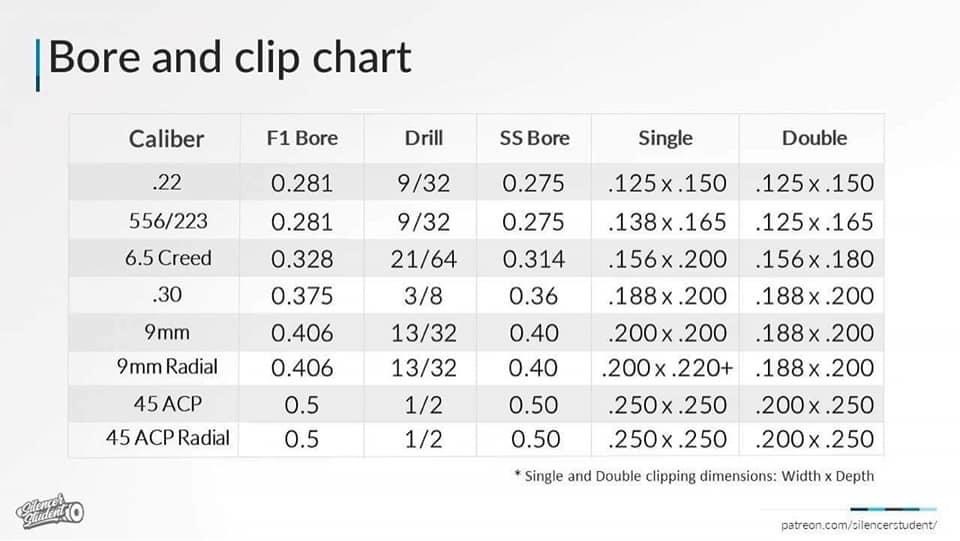

If you want a dedicated .22 cal can, bore with a 9/32” drill bit and clip the cones 0.125” wide by 0.150” deep.
If you want a .30 cal, drill with a 3/8” bit and clip 0.188” wide by 0.2” deep.
Try to align all the clips as best you can when assembling.

Those little notches are called clips. They act to disrupt laminar flow of the gas through the apertures in the cones. Laminar flow is the tendency of a fluid to stick together when exiting an aperture. Think of water flowing out a garden hose. It sticks together as one steady stream. Now think about when you block part of the hose off with your finger. The stream turns into a spray.
It’s a similar concept with the clips except that the notch directs part of the gas to shoot upward at an angle into the main jet of gas and disrupt its path through the holes. This causes the gas to kind of swirl around in the chambers created by the baffles for a while (like a few nanoseconds) allowing them to cool and slow down before exiting the distal hole in the silencer.

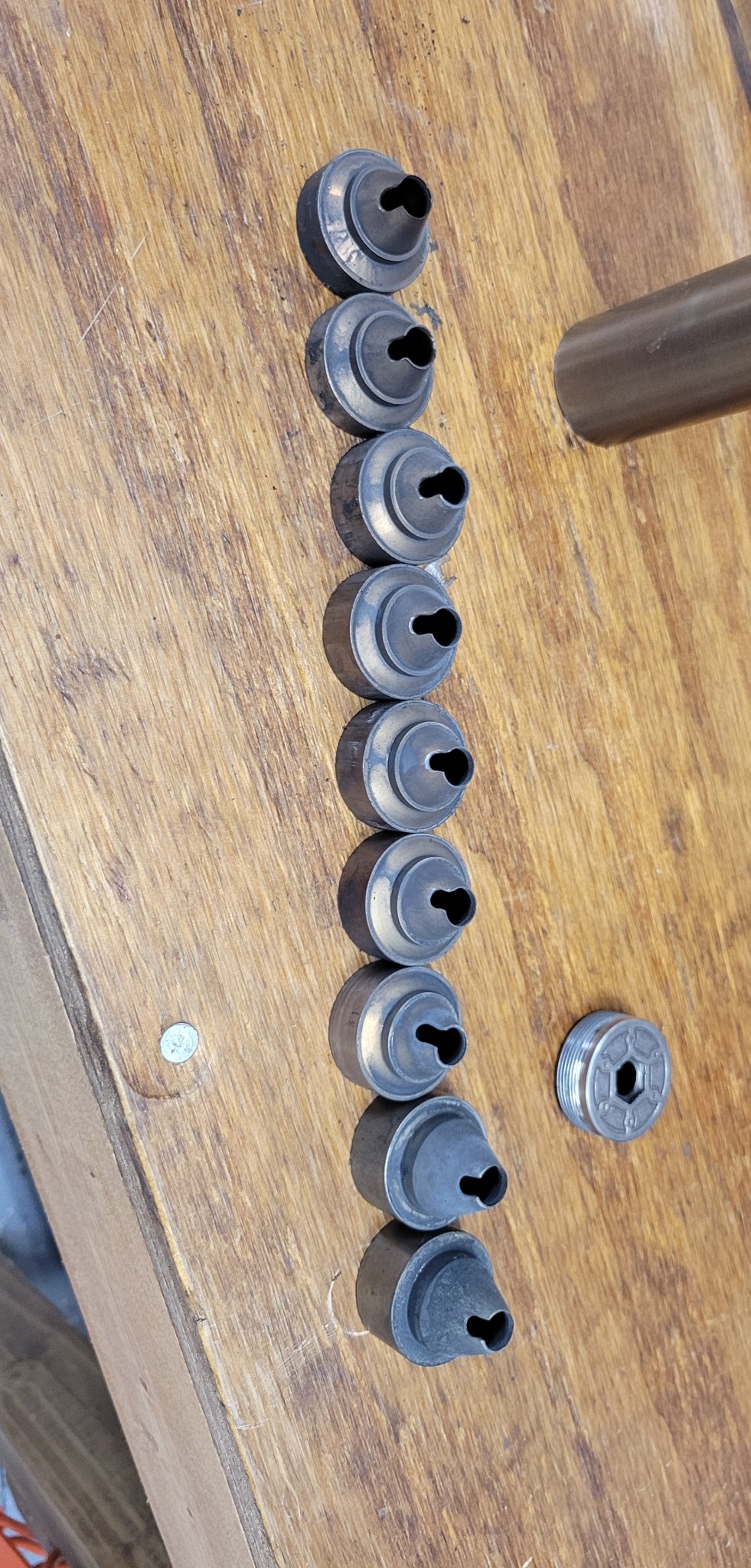

I did a mix of Pure Performance Armory 60deg (50s were sold out everywhere at the time) and White Trash Tactical step cones progressively spaced in my .30cal can. Maverick Precision Raven Ti 1.5" x 8" tube. Had a SOT 02/07 properly machine all the internals once I drilled the end cap thus making it a suppressor. Silencerco ASR Bravo mounting system. Performance is on par with commercial cans with supers, I'm very happy with it. Form 1 took less than 21 days if memory serves. You won't save any money if you do it right out of good materials, but you will save time.
What size hole did you drill in the cups?
Looks like 3/8” or .375 based on the cups he used. You generally want about 0.60” larger than the diameter of the largest bullet you’re shouting through it.
