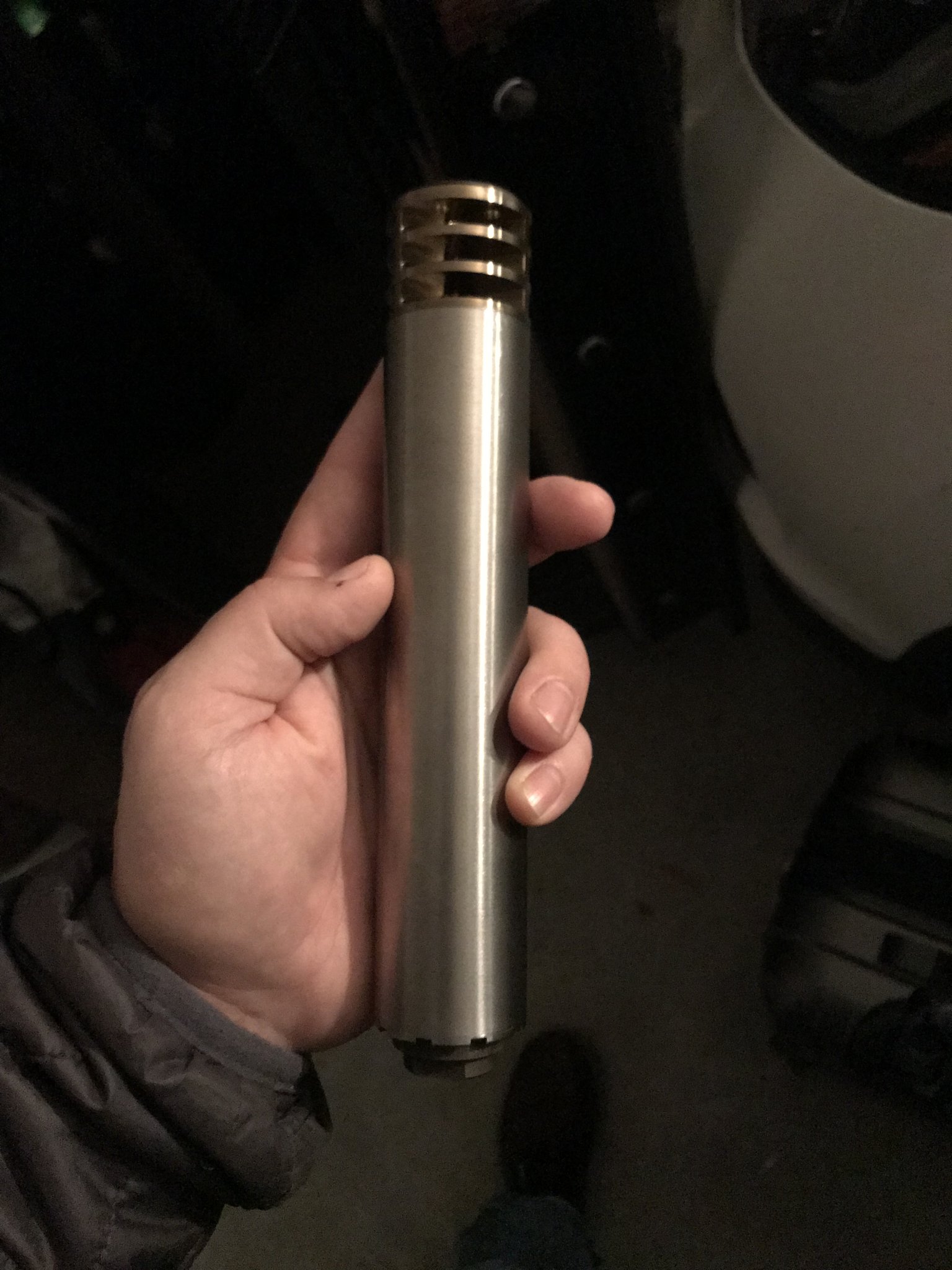

1.5 OD x 8.5" long tube with 9 single clipped Dino Precision Cones. 3.25" ish BC, progressive spacing from .75" down to .375. is what I use on my Bergara 6.5 CM. Use a Dino medium for your BB. They weren't around when I built mine.

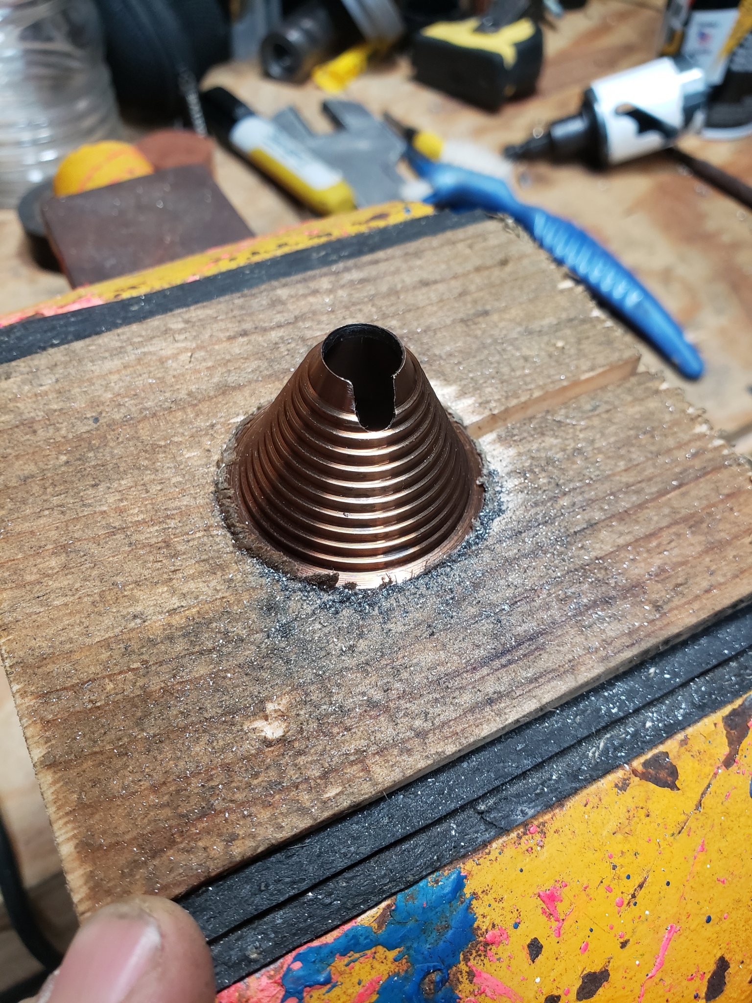

Did my first with a holder made from wood, a junky drill press, some round files, a drill, a pipe cutter, and sandpaper on a counter top.

This was mine; .375 bore on the cone in the holder. Done with a step bit, and a Craftsman drill press that I can almost stop with my hand.....
