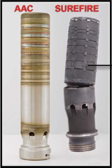

It sounds like you're confused on the construction differences of the silencers in question. The Full Nelson for example has 16 separate parts, combined with 15 full circumferential welds created in rapid succession.
The PSR contract you bring up was with an AAC silencer that had 2 separate parts because it was a monocore. One core and one tube. It may as well be considered one piece. Those two parts are combined with 2 full circumferential welds at opposite ends of the silencer and, depending on the exact model, possibly with small plug welds in between. With the silencer acting as a heat sink and the minimal purge gas from the tiny cup being used to weld the silencer, the welds were already silvery and colorless by default. You can google "aac titan welded" and see a picture of it yourself.
So you wonder why it didn't fail the drop test like most of the others, the reason is because it's pretty much one piece, and because the welds were properly done on that particular series of silencer.
That's completely false. I know because I was there, and actually in charge, with knowledge of what was delivered (not just read about it Google). We tested all of the welding theories. We hired consultants. Tested different configurations with SOCOM. You have to do actual physical testing to know if your welds are good. We did and do that. I'm comfortable with our products, through actual experience, testing, selling thousands of welded Ti silencers, and winning numerous .mil contracts (both mono core and individual baffle configurations).
Hi,
No confusion on my part. Confusion lays with you knowing what you read about the PSR testing phases and me knowing what I saw during the testing phases :)

Being present doesn't negate factual information about a silencers construction. If it was indeed a TiTan silencer, then that is how they were constructed, that is how they were welded and why the welds were colorless, and that's it why they passed the drop test with better results than other silencers. No one's disagreeing with you, just explaining to you that construction method and weld pattern/location made for good welds on that particular silencer, for which its method can't be universally applied, like when you have rapid succession welds 3/8" apart right next to each other.
That's completely false. I know because I was there, and actually in charge, with knowledge of what was delivered (not just read about it Google). We tested all of the welding theories. We hired consultants. Tested different configurations with SOCOM. You have to do actual physical testing to know if your welds are good. We did and do that.a I'm comfortable with our products, through actual experience, testing, selling thousands of welded Ti silencers, and winning numerous .mil contracts (both mono core and individual baffle configurations).
I'm only discussing the AAC PSR silencer.
Are you saying that TiTans, which are two part silencers, were not submitted to PSR trials, or that the welds were not done properly? I said the welds were properly done, and for the reasons I stated above that is why they were properly done. I'm sure your consultants told you the welds were good on that silencer, because they were. I don't see anyone saying that TiTan welds were incorrect, only people that are confusing the different types of construction and welding patterns of silencers and trying to universally apply the principles which isn't how it works.
You two are both welcome to point out where I'm incorrect, and I'll retract my statement if proven false. If TiTans are what was submitted, the welds were properly done for the reasons I stated. If it was a TiTan that passed the PSR drop test, then it passed for the reasons I stated. The TiTan has proper welds, and it was strong because it's one solid piece of metal with a tube around it, and I'm assuming it was the QD model so it had strong stube ACME threads in the mount. So unless it wasn't a TiTan that was submitted for PSR with welds in those locations, then go ahead and tell everyone what was submitted at AAC for the PSR, because that's all I'm talking about. Not your new stuff. I have no doubt you physically test your welds.
