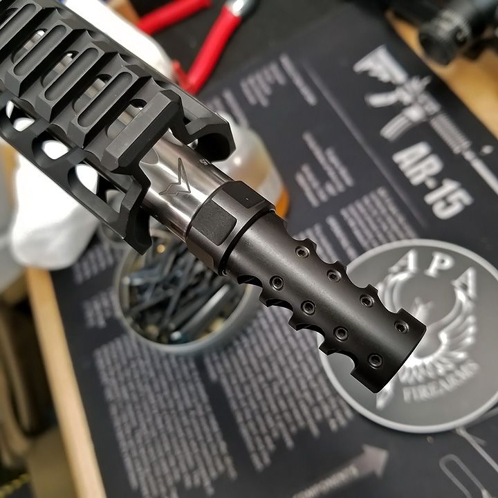

Started testing APA with all 8 comp ports plugged. Dot moved up and right as expected for me being a right hand shooter.
Removed two plugs closest to the barrel (one left, one right). Per APA, ports closest to the barrel will have more dramatic effect as they have more pressure and it makes sense.
Things got MUCH better, still some light up and down with some movement to the right. (about the same as SJC at this point, Very Very similar)
So I removed Two more plugs on the Right side. Did few runs. Movement to the right stopped, but now it stared to overcompensate and was pushing dot and shots down, but very so slightly.
I plugged one port on the right..... and it was Perfect. Final setup for me was Removed Plugs - One on the left closest to the barrel and Two on the right closes to the barrel.
Next few runs I had minimal Dot movement. It didnt really move... for the lack of better term it kind of wiggled/shudder in the center without moving up or right. I was constantly printing 1-2 inch pairs at 50 yards with pulling trigger as fast as I could during transitions.

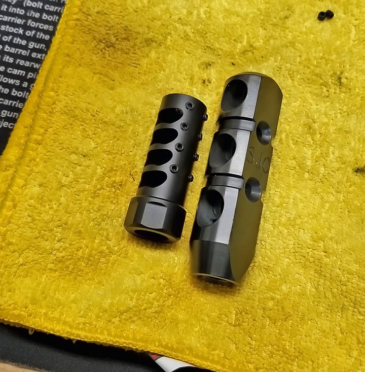

In short... I liked it! Is it better than SJC Titan? Its different.
SJC in my opinion is little bit softer shooting, but APA is extremely tune-able with 8 Compensating ports so you can tune the movement of the dot to your grip and style of shooting. Also its SO much lighter if that is your thing of concern. SJC comes in at 5.8 oz and APA at 2.3 oz. APA is almost 3 times lighter.

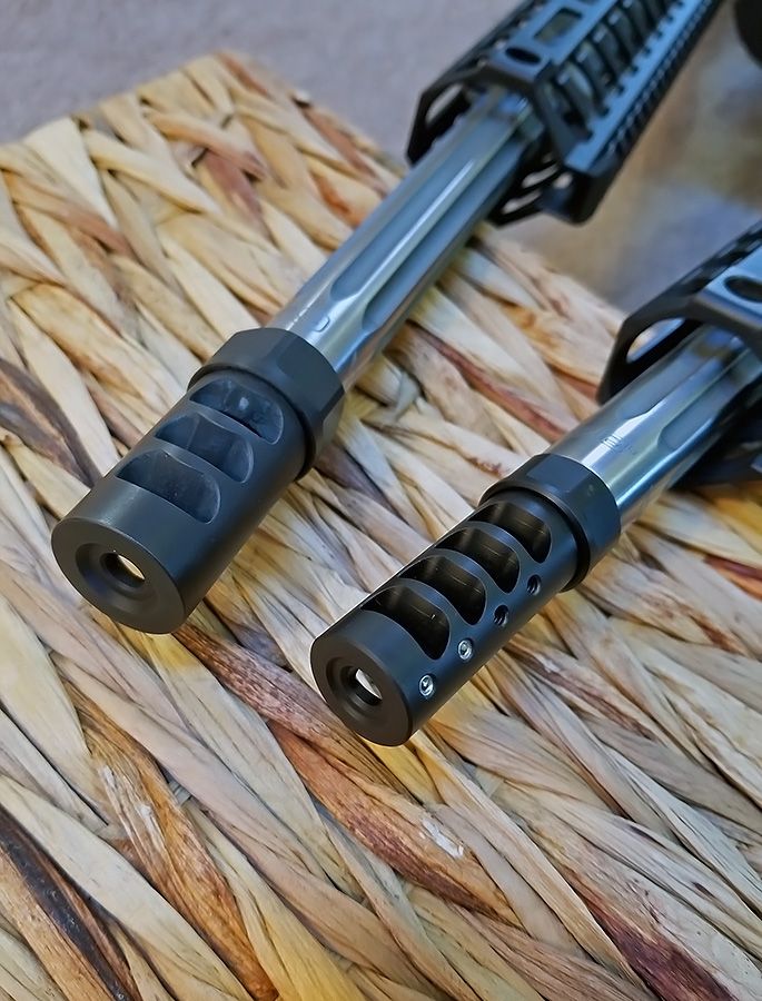

Here is a picture of the Answer brake on my 223 compared to Little Bastard on my 6.5CM and couple videos.
APA The Answer
SJC Titan
APA The Answer
SJC Titan
