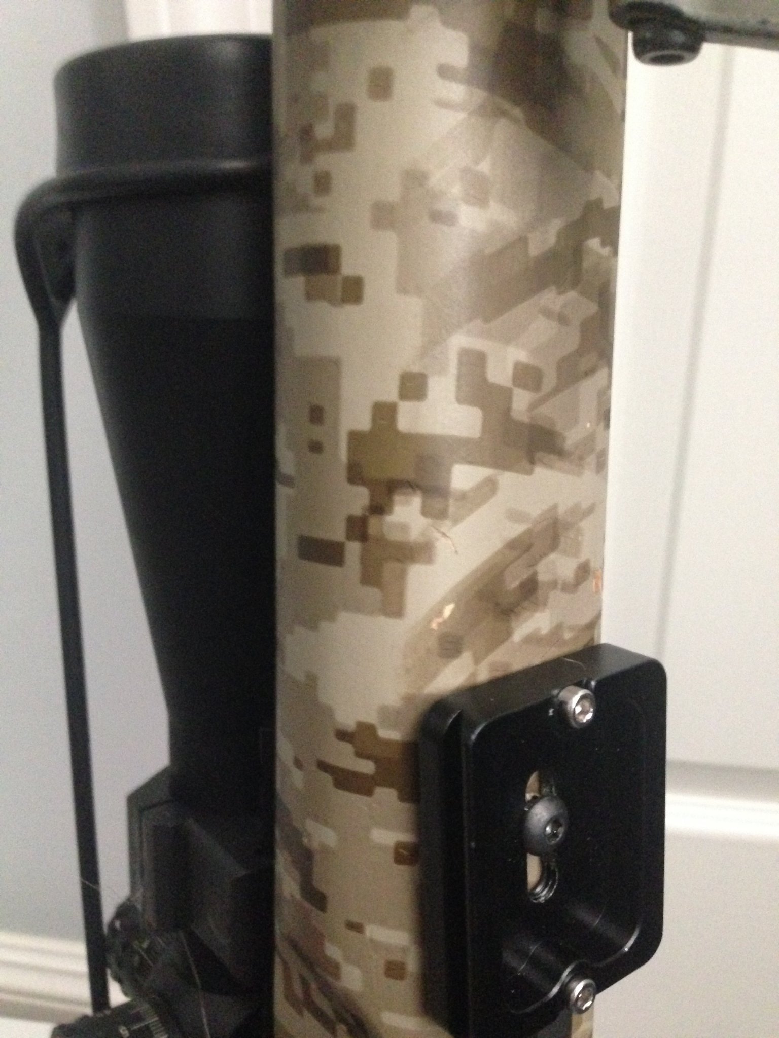

So im not a competition shooter but I bought me first tripod mainly for backpack hunts.
Whats the best way to mount an ARCA type rail to my hunting rifle? I do not need or want a full length rail (like the 419) just something small. No need for a new stock as mine is composite with aluminum bedding from the back to the front.
So far all I have found is a ARCA keyMOD mount from Field Optics Research. I was thinking about drilling and tapping the stock for this mount.
Rifle is a Sako A7
I just did this not to long ago on my .22. Just picked up a small dovetail mount off Amazon and the Atlas fastner, drilled a hole and used a spade bit for the fastner to fit into.

I have installed simple t bolts in most of my stocks and the acra plate just screws to them.
super simple

I'd just run a full rail were it me. This way a bipod is an option, in addition to the tripod. I think Sawtooth Rifles made one for @hic28 's rifle, and we installed that in about 30 mins. Just had to drill holes in the stock, and use a forstner bit to cut/radius the drilled hole larger for the fasterner to rest in. As with most things, proper prep work (measuring and marking) ensures a fast and easy installation.
If your stock is flat on the bottom, get one of the longer plates off Amazon and use 2 screws to mount it. Direct mount into a leveling base is alot more solid than a pig/hog saddle, plus it weighs less, and 15* is more than you think. The cheaper ball heads flex alot also.

Check out sawtooth rifles.
They have arca swiss rails for alot of different rifle configurations.
They also may be able to make you one specific for your application
