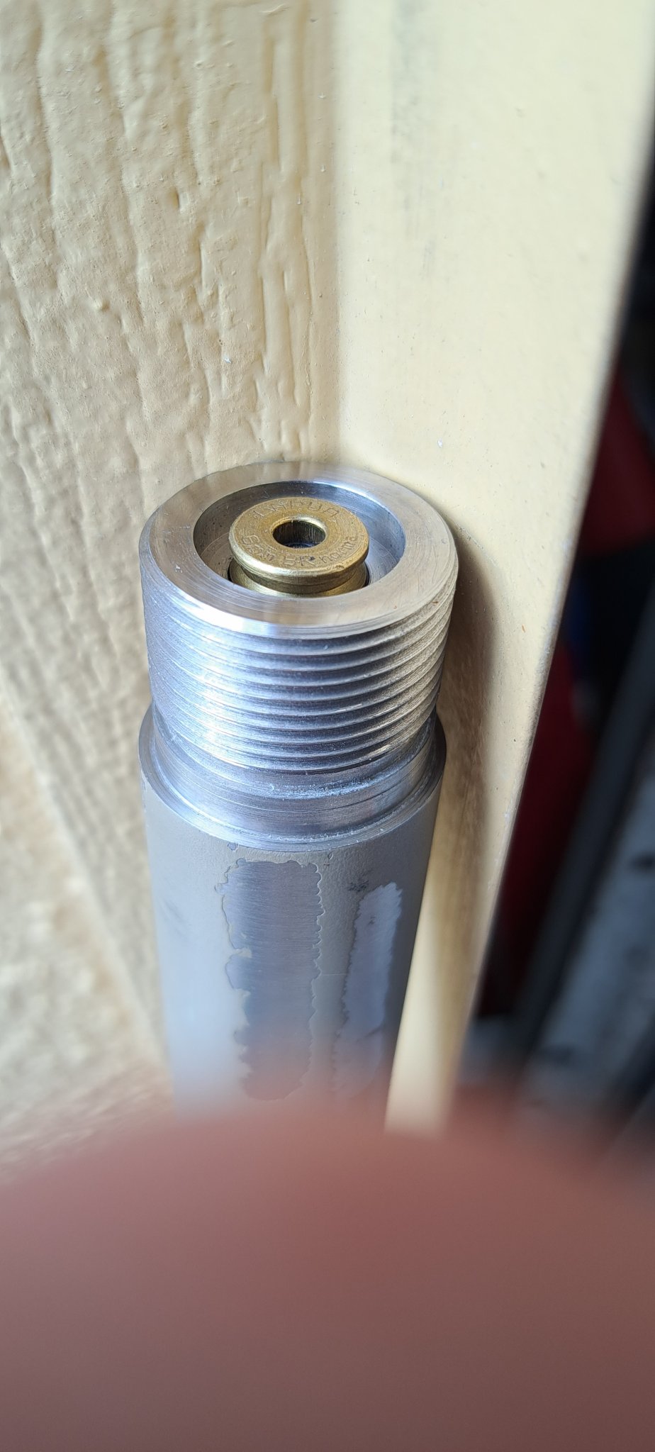

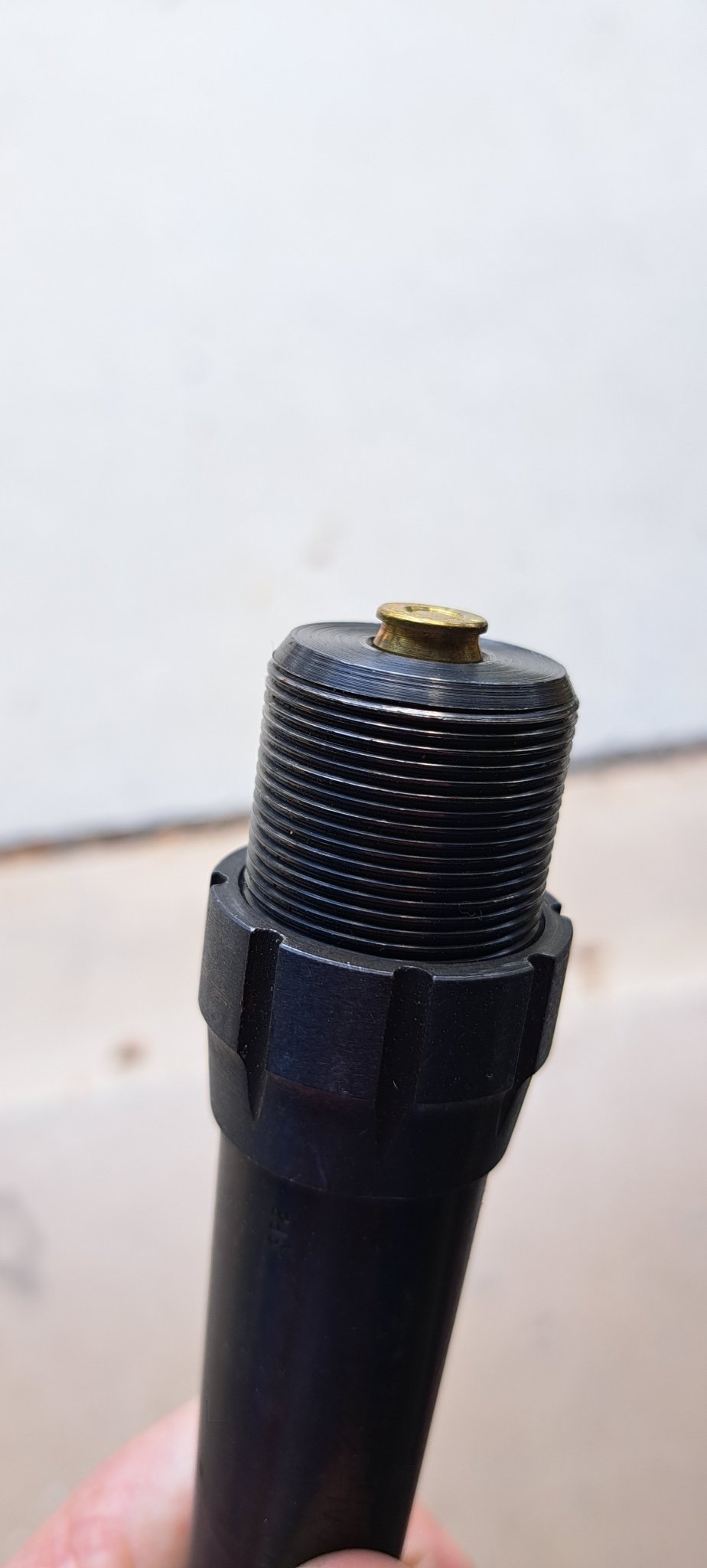

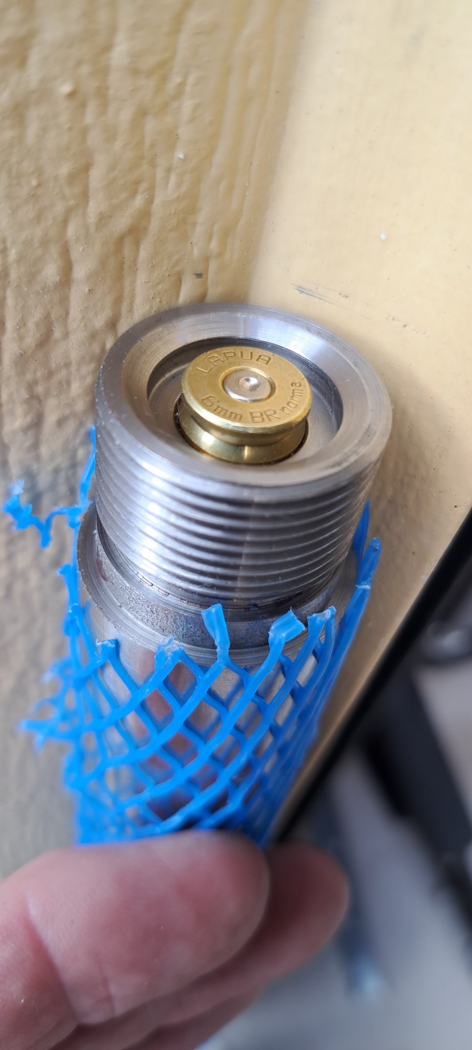

The cone extends the length of the tenon by the depth of the cone. Here's a couple of pics to help.
Flat breech. Savage and Origin style.
Notice where the extractor groove ends and the body of the cartridge begins.
Coned breech. It's been modified to work with a Remington 700 bolt nose.
Remington 700 "3 rings of steel" style.

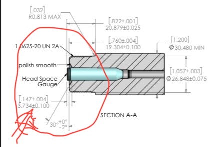

If that picture of the CDG tenon is accurate it seems that quite a bit of the case head is unsupported.
No, it looks like there is .147”+-.004 of case head protrusion.
So yeah, that much is “unsupported” but that’s also why the case head exists.
Pretty standard. It’s got to stick out enough for the extractor to grab onto. Case heads are thicker so it still extends further forward than just the extractor groove.

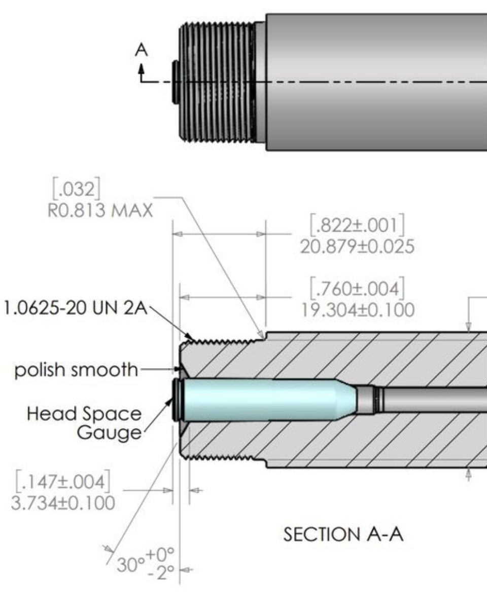

This has been covered many times in the CDG thread. The case head exposure is exactly the same on the coned breach. Here’s a diagram of both types of breach.
Do the math and you’ll see that the case head protrusion from chamber face is exactly the same. Bottom left and bottom right diagrams.
Reactions: FimRire RongLifle
Coned breach: 0.147” unsupported case head
Flat breach: 0.822 - 0.675 = 0.147” unsupported case head.
Exactly the same. One could argue that the coned breach leads to a stronger system due to the fact that the cone led part of the barrel supports the bolt nose and extractor.
