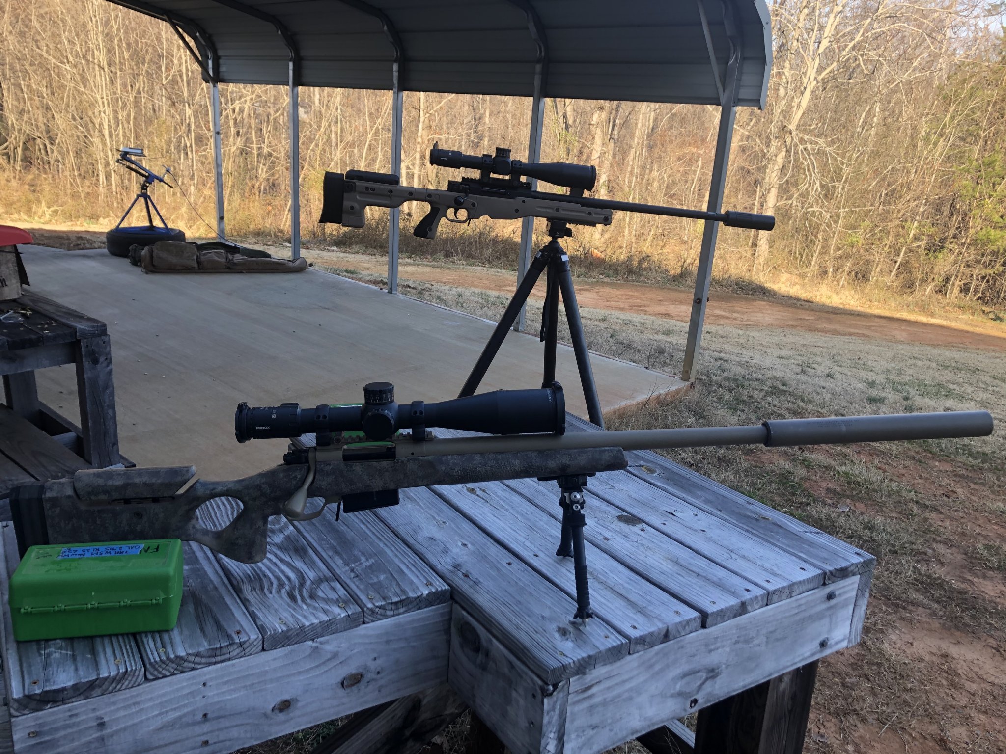

Just spent the afternoon fitting barreled action of my A5M XP into the a hogue stock with full length aluminum chassis. The reason for the switch is that I’m trying to compare the accuracy difference between factory bedded Fiberglass McMillan stock and full aluminum chassis stock such as manners. The hogue is considered to be a cheaper alternative.
This hogue stock is originally designed for FN PBR line which shares the same action as SPR line. The barrel channel, on the other hand, is different. Took some time to file both side of fore end of the stock to make the barrel free float. Will update after the range trip. It’s been raining the whole week in Houston.
Just coming back from the range. Was on a short time budget so only did 3 five shot groups with 3 brand ammo - wolf steel case 147gr FMJ (1.6 MOA), Federal non-typical 150gr SP(.9 MOA), and sig sauer 168gr OTM(.35MOA). The good news is the accuracy of 168gr is significantly better with Hogue (chassis stock). I have not yet been able to get any 168gr factory match ammo (FGMM,PPU,Sig,GGG) to group within .5MOA 5 shots on the factory McMillan. I may need to do more test with this new stock in the near future, probably August when my schedule free up a bit.

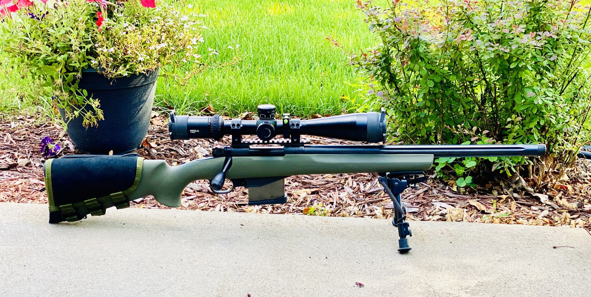

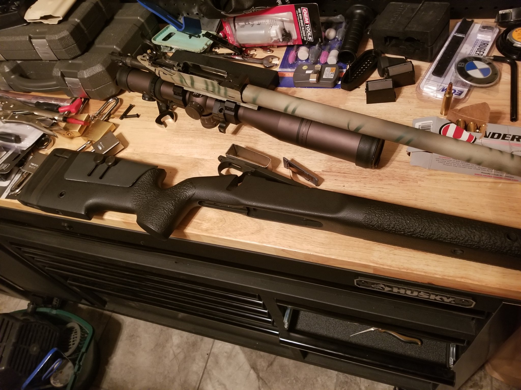

Just purchased a set of MDT LSS chassis from the hide. Dropped my A5M XP barred action in with no issue. Only have to sand a tiny spot on the rail to make the barrel completely free float. Still waiting on the magazine from Opticplanet. From what I researched some work needs to be done on the feeding lip in order to clear the large claw extractor on the SPR bolt. Will update once done.

What does the complete package weigh? Looks pretty nice. Well, except your scope mount is on backwards……😂😂
Reactions: Frontseeker
12.8 pounds with the scope and mount included. I intentionally installed the mount backward to offset the 20 MOA factory rail (it's a 20 MOA mount).

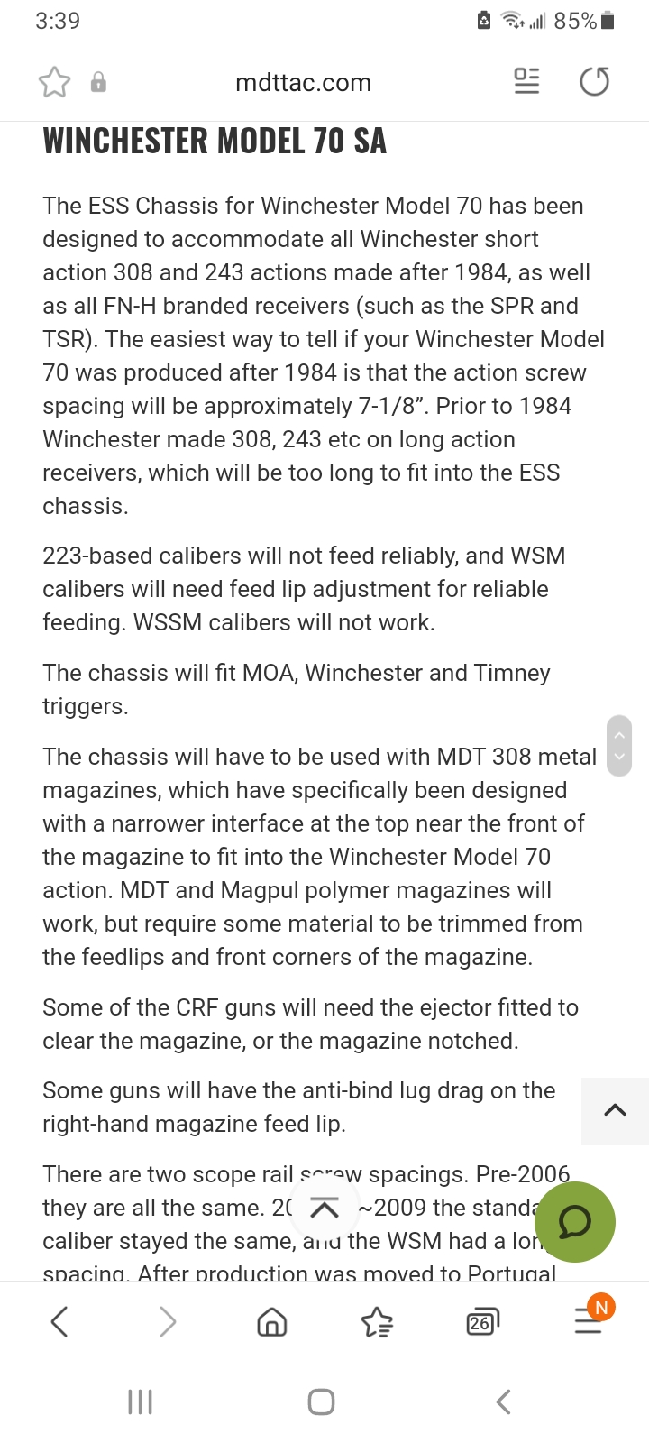

However, I have taken a screenshot from MDT website where it says they have designed their metal 308 AICS mags to specifically work with short action model 70s.
Take a look for yourself.
Link to that screenshot down below...

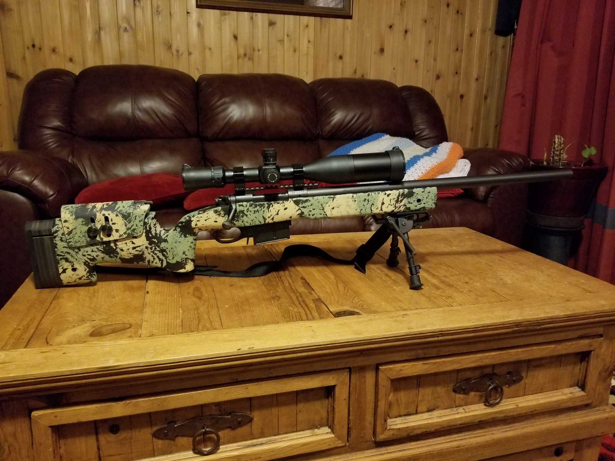

7WSM, FN SPR with Broughton 1/9 twist with custom OTB Titanium suppressor.
CDI DBM, Manners T5-A, Minox ZP5 MR4.
Barrel is about gone and when it goes I’m going to send it to LRI to be retubed.
stock paint by Scimitar

Still one of my very favorite rifles on here. I do gotta correct you though, that's not a T4-a stock. I could be wrong but I think it's the T-5a, and that thumbhole stock is why I like the rifle lol.
Yep, typo. I’ve got a few T4-As and only the one T5-A now. I think about ordering a T5 for one of my other rifles.

Quick update. I received the MDT mag.
I tried inserting it into the bottom metal, but it looks like it’s too long to fit.
I just got home and it’s late so I’ll mess with it more tomorrow, but not off to a good start.

The MDT mag is about .060” longer than the FN mag.
Still trying to figure it out but some bottom metal has to be removed. But if I do that, then I’m fully committed to MDT mags because I don’t think the FN mag would work after that.

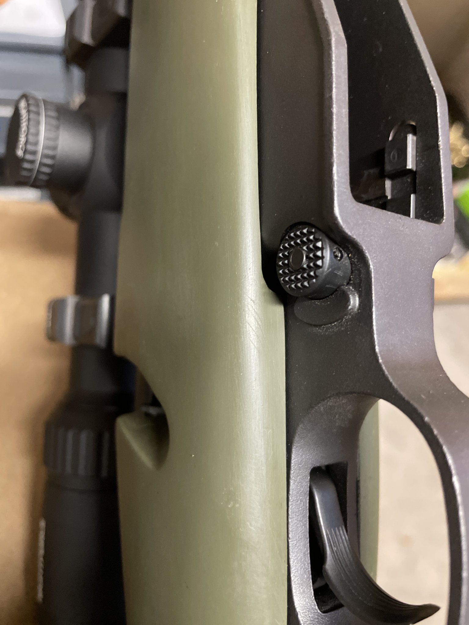

So is the inlet differnt? Can the dbm mcmillian be opened up for the tbm bottom metal?
The inlet is slightly different but it will work.
I went the cheap route, so there is two small gaps near the mag release button, but they don’t bother me.
They could be filled in but I didn’t want to paint or cerakote the stock quite yet.
