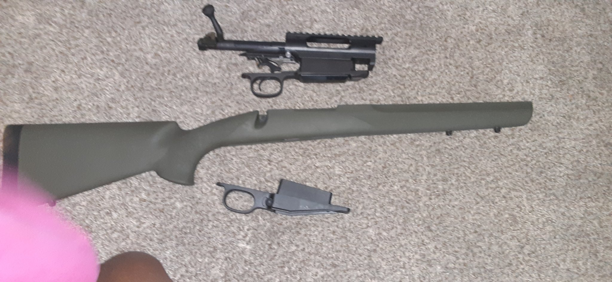

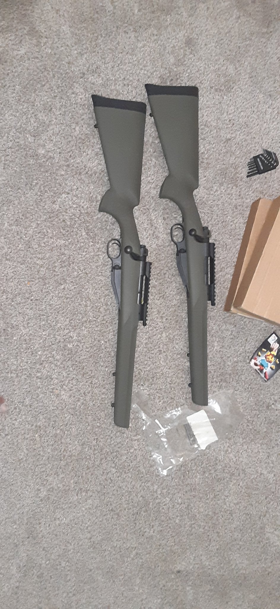

Is this what you are looking for ? I doubt it but made me think someone on this thread might likey. This bottom metal came off my gun. I forgot I changed the bottom metal to mag box.
. PM if anyone has interest. Someone thought I was selling the gun. I just have these spare parts in case someone needs them.
PB
PB
That's not the one he is talking about. The one you have pictured is the factory TBM from FN. It takes proprietary mags.
The one he is asking about is one CDI used to make, that one worked with AI mags. Your TBM is still such a solid DBM and a very good product but unfortunately, it does not take AI type mags.

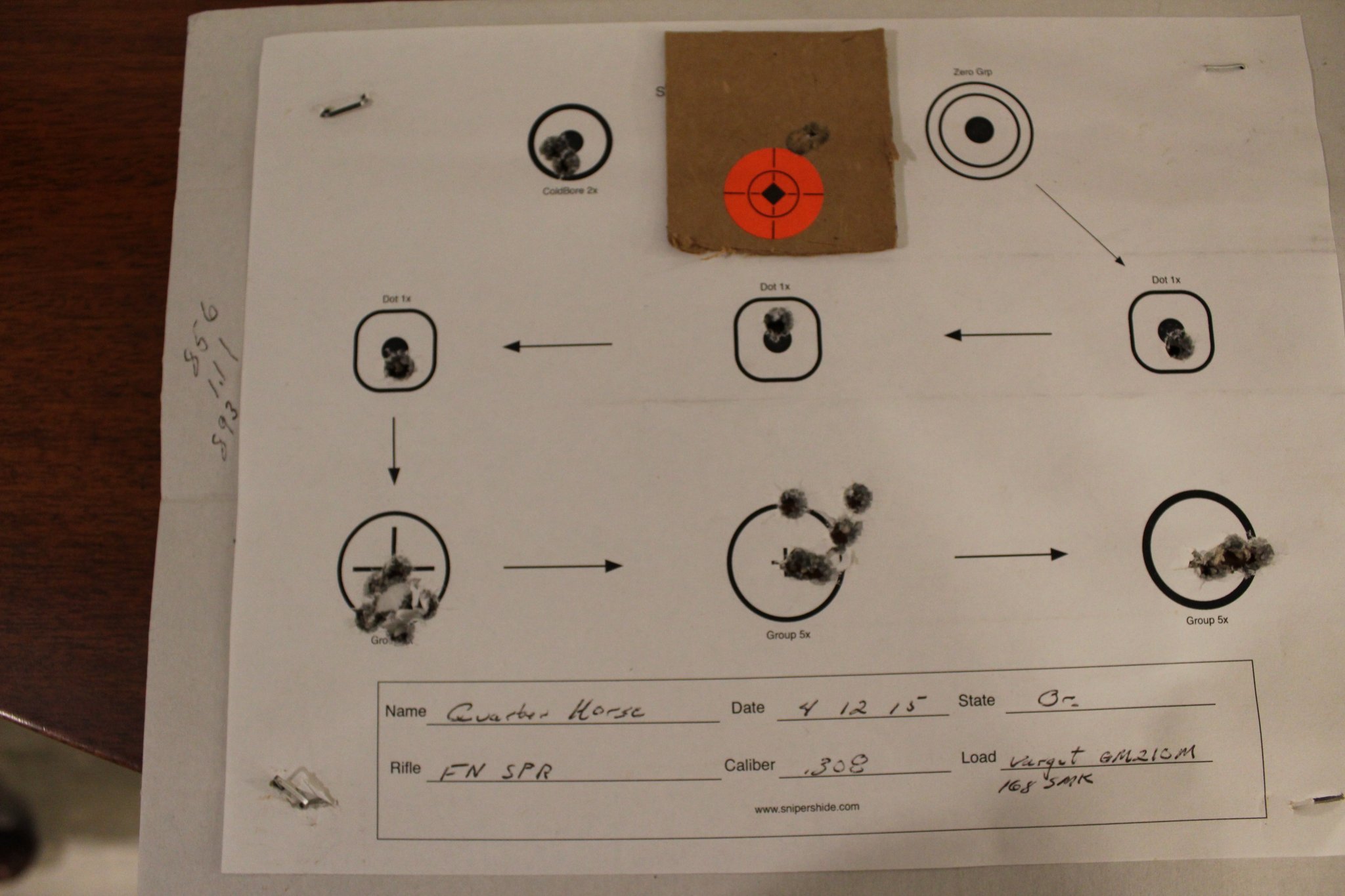

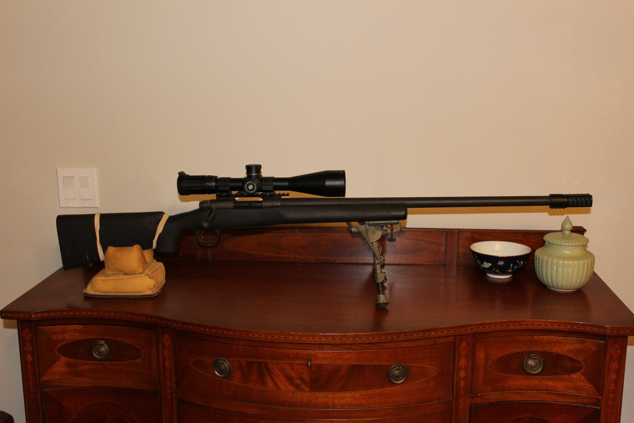

Here's the OG (Original Gangsta') SPR. It's had minor changes. It's in the original HS Precision stock with an aluminum bedding block. The OGs did not come with a rail and this has a 20MOA Seekins. The bottom metal on these is aluminum and I swapped out a later DBM in steel. It has a trigger spring and a Witt Machine clamp on brake and that's about it. These first SPRs had 26" barrels and are reputedly made from M240 blanks. Future iterations had barrels that maxed at 24" and were made from hammer forged blanks specific to the later guns.
Now to the targets. The wallet group is exactly that. They happen when they happen. In this case it was during load development. The large target is from a comp. that LL did because he was pissed about 5X5s. The rifle shoots coldbore to point of aim and continues to do so. I shot this target when I was 68 years old. I had been fully disabled for over ten years. The bench was a 16# round patio table with four legs set on a rock driveway and never had more than three legs on the ground at any one time. You can see that I completely blew the target on the second five shot group. That is entirely on me and not the rifle. https://www.snipershide.com/shooting/threads/sh-100-yard-challenge.6252669/ The OG deserves better.

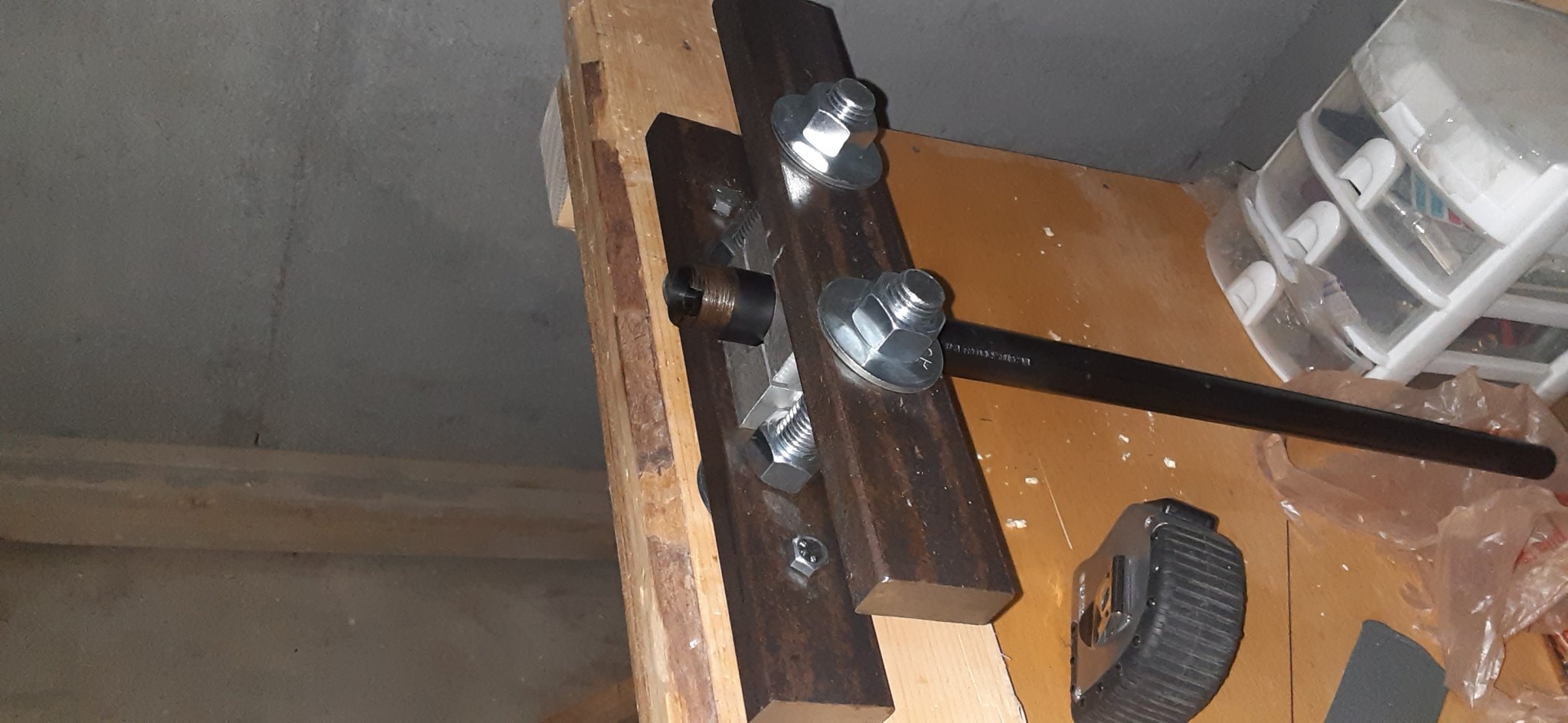

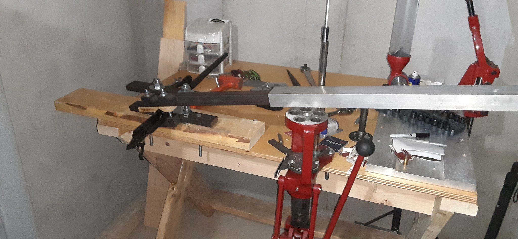

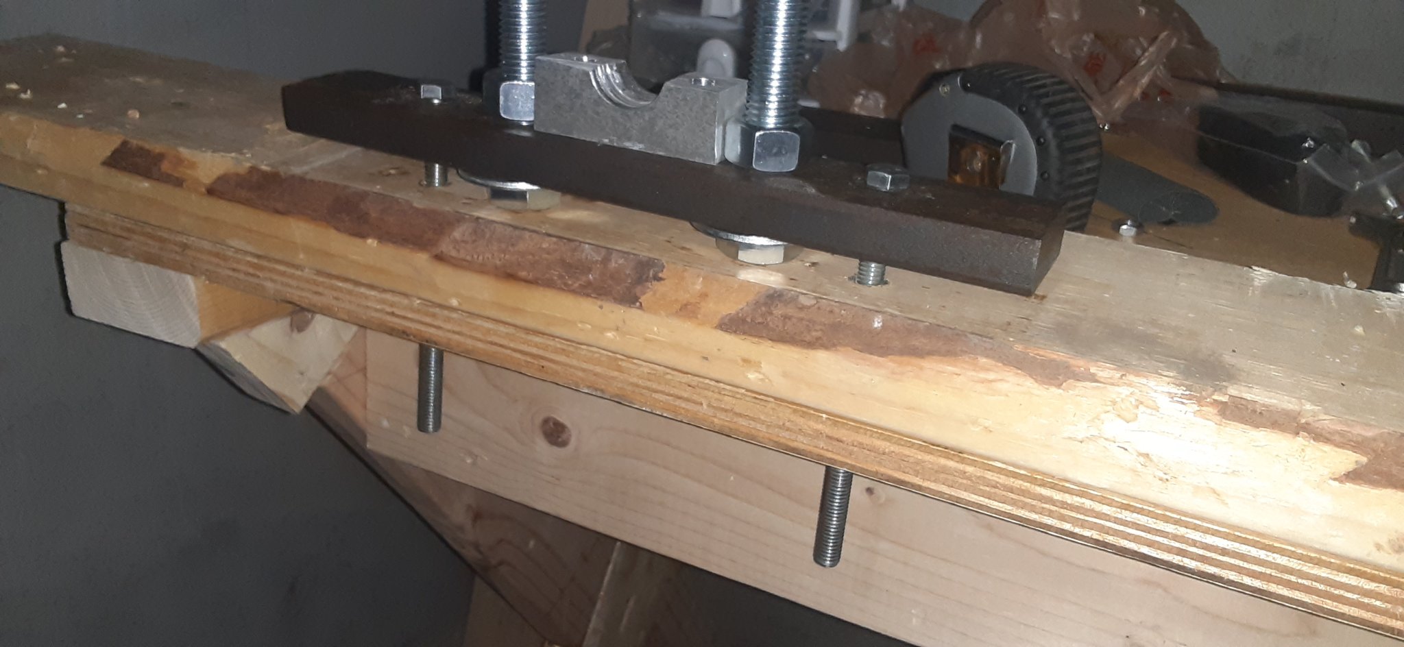

Howdy.
So a while back I bought 2 fn action, one stamped spr and the other pbr xp. Along with 2 hogue stocks and fn bottom metal.
I finally got 2 fn takeoff barrels.
Managed to install one.
Function checks with new ammo , feeds and ejects great.
Next step is to get head space checked and then shoot.
I did this the hard way cos I am an idiot with an engineering degree and decided to built my own tools, just to see if I could do it. So I built my own barrel vice, barrwl wrench and barrel block.
Here are some pictures .
Will take a picture of the completed pbr when I get home.

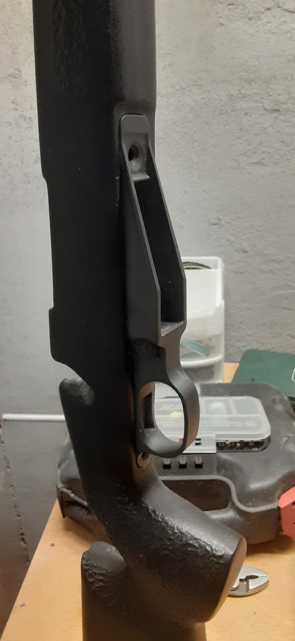

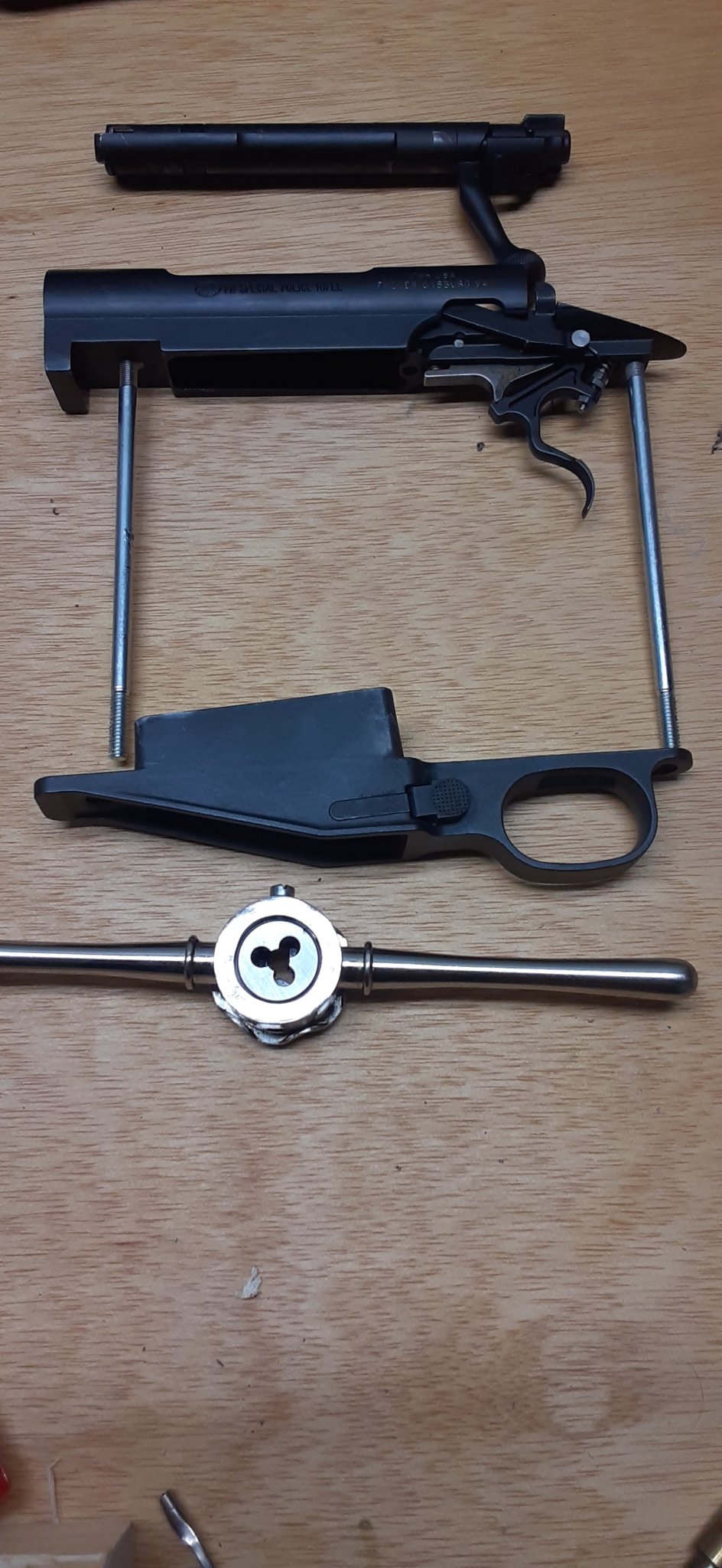

Currently working on inletting a mcmillian for the fn bottom metal with a lot of help from a member on here.
So the extra long is just a function of what i had available. I couldn't find actual inletting screws for the mod70/spr in stock anywhere. So I had to.make my own hence the die.
Just using those to line up the receiver, stock and bottom metal. I have started letting the stock for the bottom metal. Will post pictures this evening.
The stock is a mcmillian which has some wear and tear on it, so I am giving the inletting the diy effort. If I screw it up, it's not a huge loss. In all this I am leaving the action and bottom metal unmolested
I'd say gonna glass bed it maybe. No idea why the screws are that long. I also use studs when I do that tho, wrapped it surgical tubing.
Pillar and glass bedding if definitely the next step. Thinking of going the score high route. Buy debating between using their probed 2000 or marine tex
I still enjoy mine. Bought it through the classifieds here many years ago. Have two actions still waiting to do something with that I picked up when Winchester shut down New Haven. My only complaint is I always seem to be broke when a bunch of stocks hit the market.
Great actions. What length actions are they?
Also this was before the final pass. So its a bit more flush now.
Lesson:I need a mill or access to a creator space with a mill
Pretty good for a first shot. Bed it with some devcon and sand it flush. Will look as good as they ever did from the factory.
Mine came bedded. Did anyone elses?
Yeah, definitely bedded it (action and bottom metal). Thanks

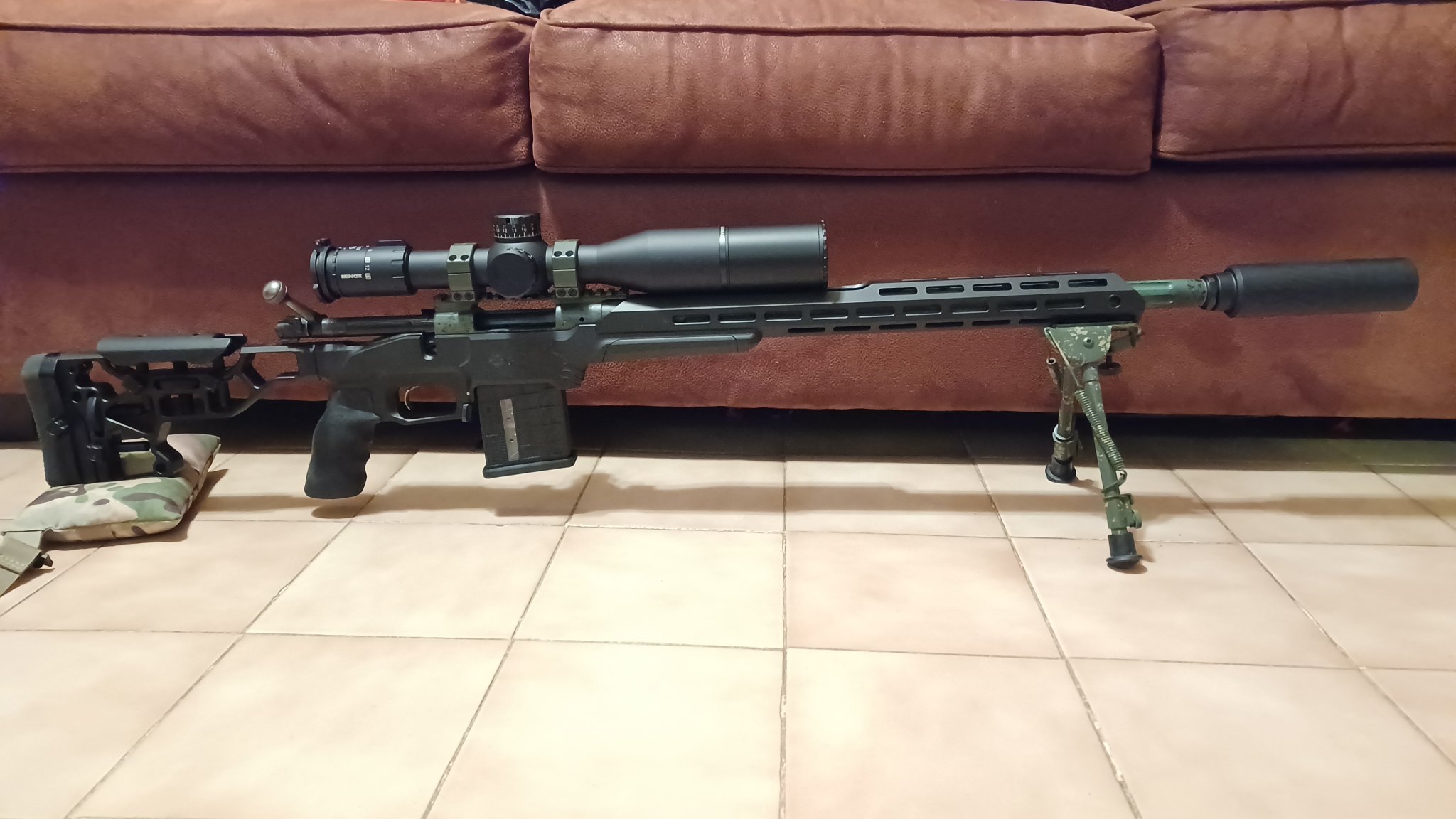

Finally got my MDT plastic/metal mags in the mail.
I can finally say that I feel good to take this thing on a hunt. Before, I had so many magazine & feeding issues. These mags solve most problems. The magazines actually sit at the same height/depth every time very consistently with no wobble.
Where I do have trouble every now and then is getting the bolt to close into battery. Most rounds will chamber and the bolt will close just fine. However, when it doesn't, a round goes in to the chamber and the bolt will not close down all the way. I'm not too savvy on these things. Though I would have to assume the extractor is not able to go over the case rim.
The weird part is, I can pull the bolt back and try again a million times with no success. If I point the rifle up so the round comes down and out of the chamber area, I can load a new round just fine and the bolt will close.
Anyone have any ideas?
Also, I'll probably look for an MPA or MDT mount next so I can get my scope up higher a bit. Not that it's making contact, but I now have the luxury of adjusting comb height with a chassis. Woohoo!!!
Good looking rifle.
is it a factory barrel (chamber)? What ammo is doing that?
ive had a few tight match 308 chambers(including a FN) and if the case sizing was off by a bit, it would do it every time. FGMM run like a charm, but throw some 7.62 milsurp in there and damn. If it would have been a silver s. Remmy bolt I would’ve broke the handle off more than a few times.
Reactions: Westcoast308
Good looking rifle.
It's not a factory barrel. I bought the rifle with this custom barrel.
If I remember correctly, the original for sale posting from this rifle had all the details listed and mentioned Shilen Select match barrel. Reamer used was PT&G for this chamber.
However, the problem only exists when feeding from magazines. I've tried other MDT mags before but they had a wobbly fit and never sat at the same height. If I manually held or placed the mag properly where it could feed, it would do the same thing. Some rounds would chamber fine, others would not allow the bolt to fully close. I could try forcing the bolt, but if I did that, it would loosen the bullet in the case neck. I say that because on the rounds that did that and i forced bolt close, now have loose enough neck tension to where I can manually push or pull the bullet.
These new mags work wonderful in the sense that they always latch properly at the perfect height. I don't have to worry about that and they feed rounds just fine up the feed ramp, etc. My only problem is the one mentioned previously where some rounds won't allow bolt to fully close.
Before that, in a traditional stock, this problem never occurred. So I can confidently say the problem is unique to magazine feeding.
Beautiful rifle! The ESS makes it a real pleasure to shoot. As far as feeding is concerned, with controlled round feed the cartridge has to rise up into the bolt face before it goes into the chamber. The extractor won't snap over the case lip. This is a timing issue that usually can be remedied by adjusting the feed lips on your magazine.
Reactions: 7WSMShooter
This freaking awesome. That means I get to play around with the magazine a bit and the remedy is free of charge to my wallet.
Thanks for chiming in...
And thanks to both of you for complimenting my rifle. She sure looks good chassis-ed up...
