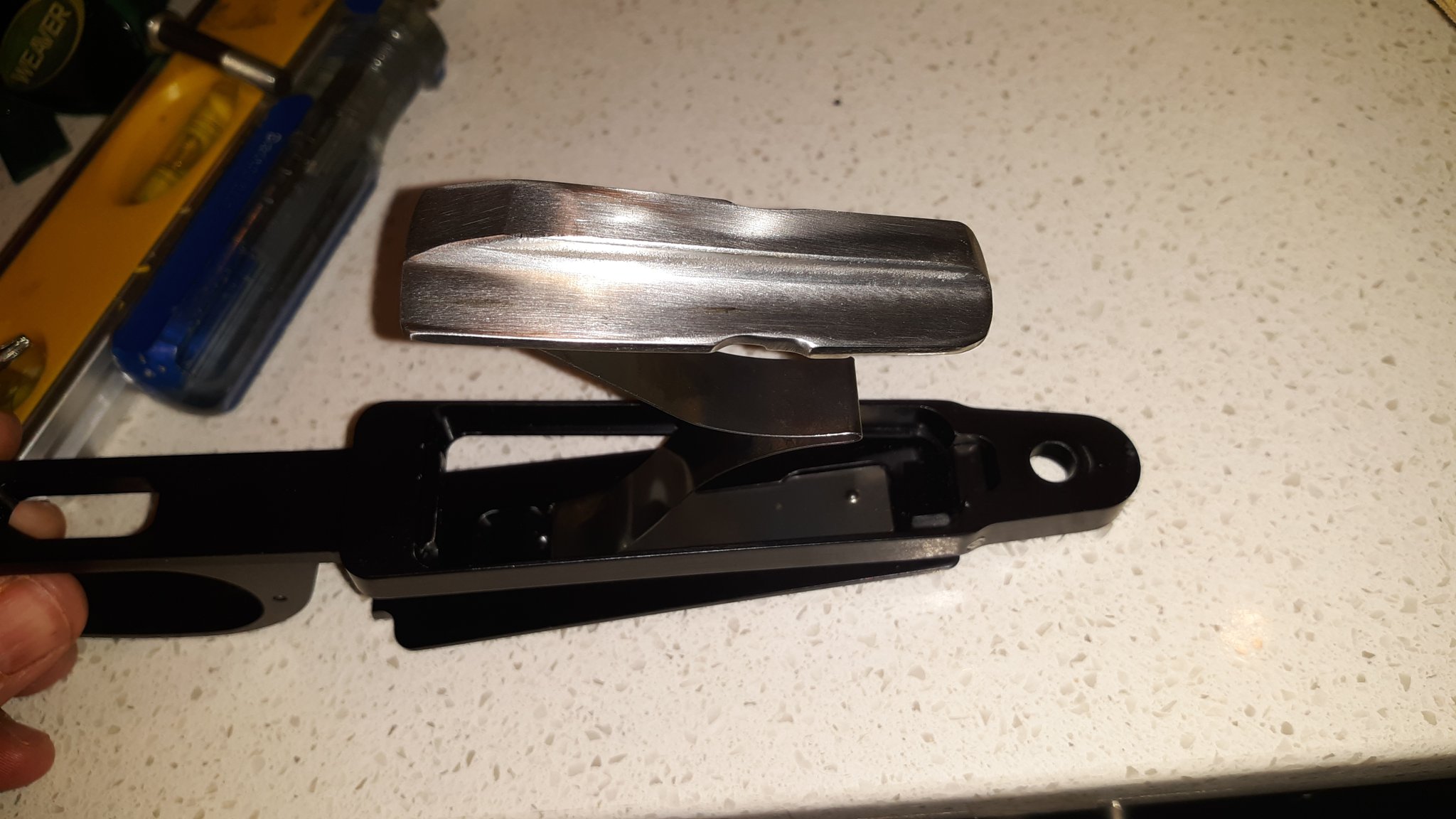

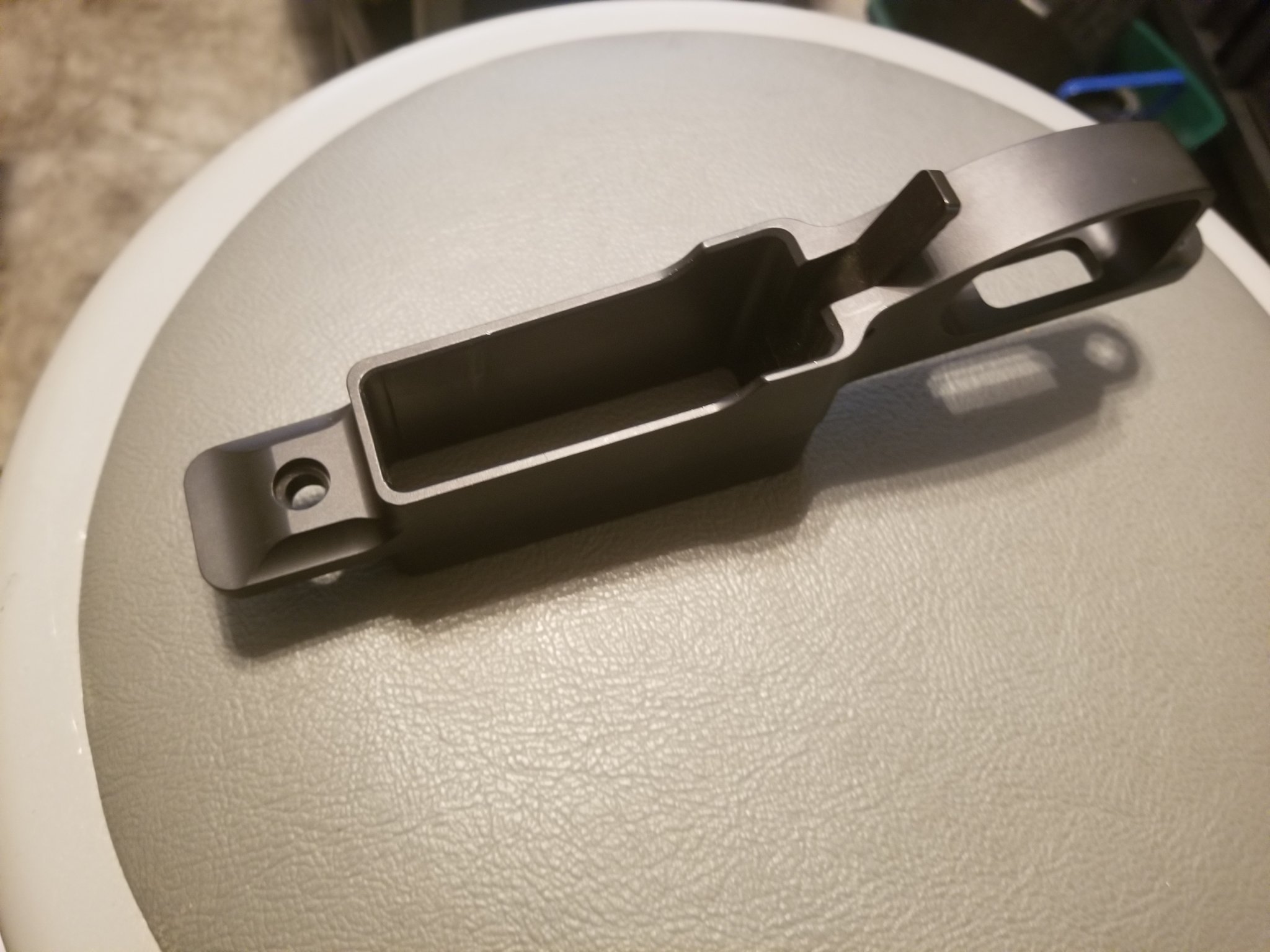

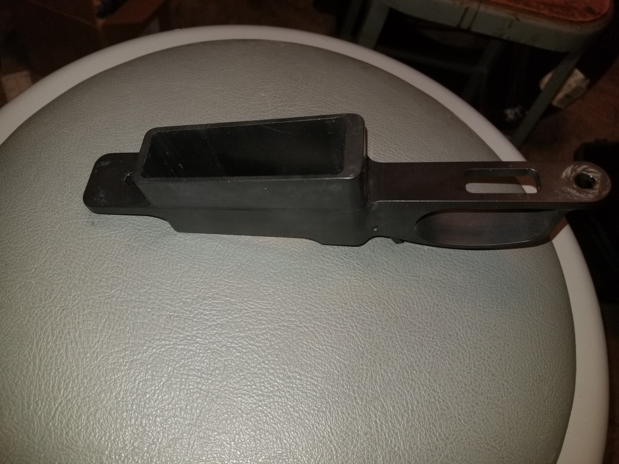

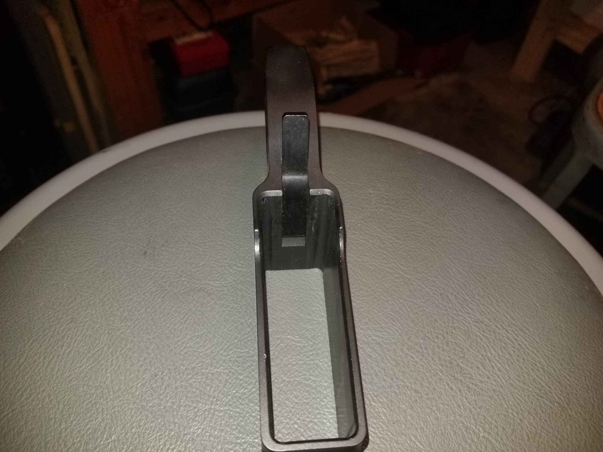

What about the bottom metal shown in the pic's on this thread.
It's a PTG bottom metal, that looks like it fits (one of) the standard FN bottom metal cutout...but uses AICS mags.
I don't see it on the PTG website. Is this new or old?
I have a PTG bottom metal that fit the FN factory inlet of my SPR. Edit: It appears to be the same one. Pics attached.

@kimber.204 is this the bottom metal you’re looking for?
@Twinsen thank you for posting this.
Yes, this is the bottom metal I was asking about. I never knew that PTG made this.
If someone has one of these for sale I may be interested in buying (preferred) or borrowing it.
This is different from the CDI bottom metal - which I'm also, still interested in obtaining.
Let me know folks!

PTG has always made a model 70 bottom metal that takes AICS. You can find it online if you look for it.
@stello1001 I've looked at their website a dozen times recently looking for that and I couldn't find it....I looked again, and sure enough, it was right there.
I feel like an idiot...guess these new fangled webernet's are too complicated for an aging millennial.
Reactions: stello1001
I've got one on order now, should be here mid next week. I'll test fit it on my A5 XP (since the stock already has the correct inletting). If I like it, then I'll probably have one installed in the modified A3 I picked up a while back.

Finally had a chance to play with my PTG bottom metal (for AICS mags).
I need a longer front screw - it didn't even come close to starting. I did hold it in place while I cycled some dummy rounds and it did well with the American Rifle Co magazine that I had laying near by.

Try the rear action screw on the front. It is slightly longer. It could be your solution just to get a second rear screw. If it is too long, it will interfere with the bolt locking lug on closing. If so, just shorten it as needed.

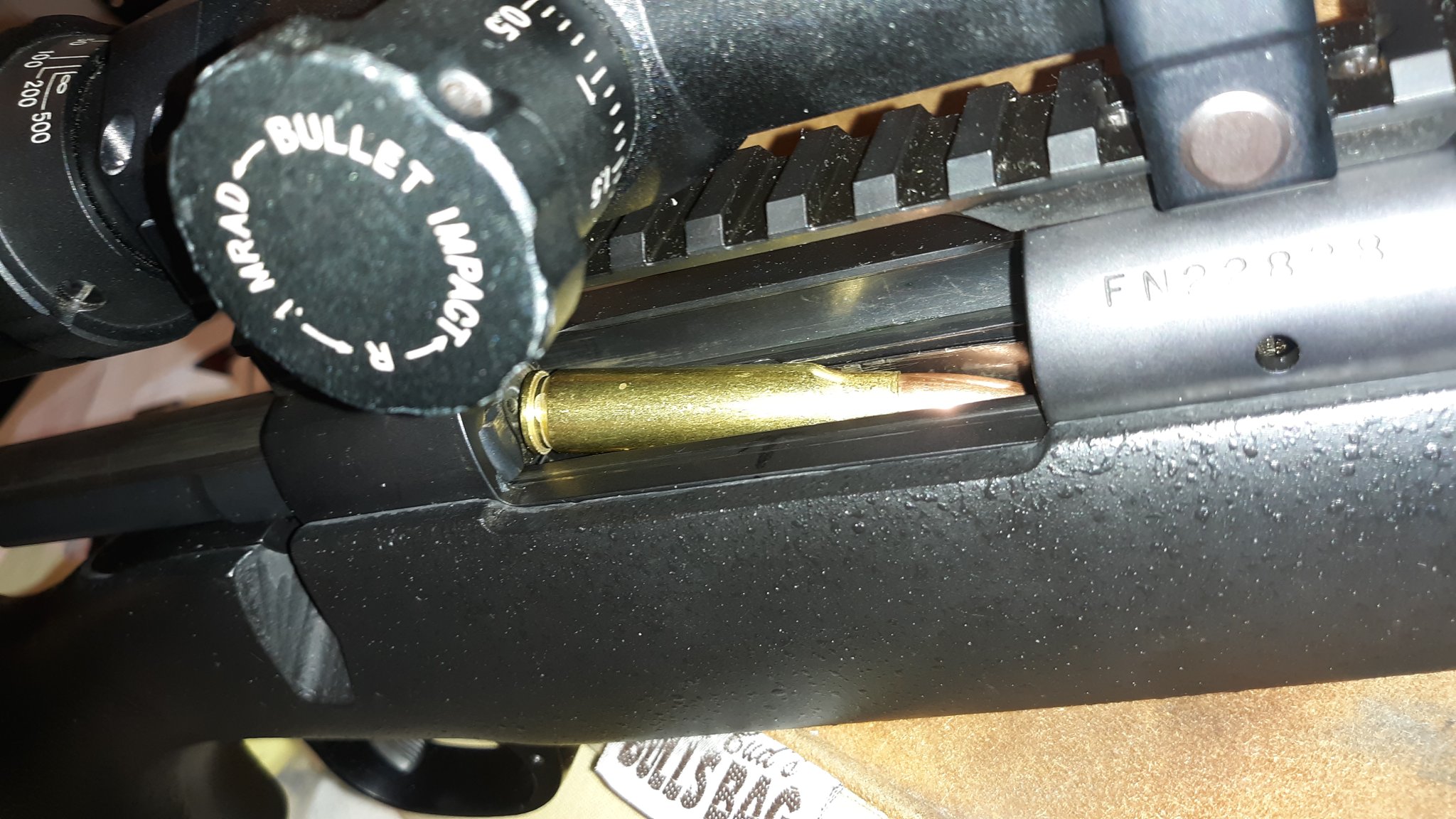

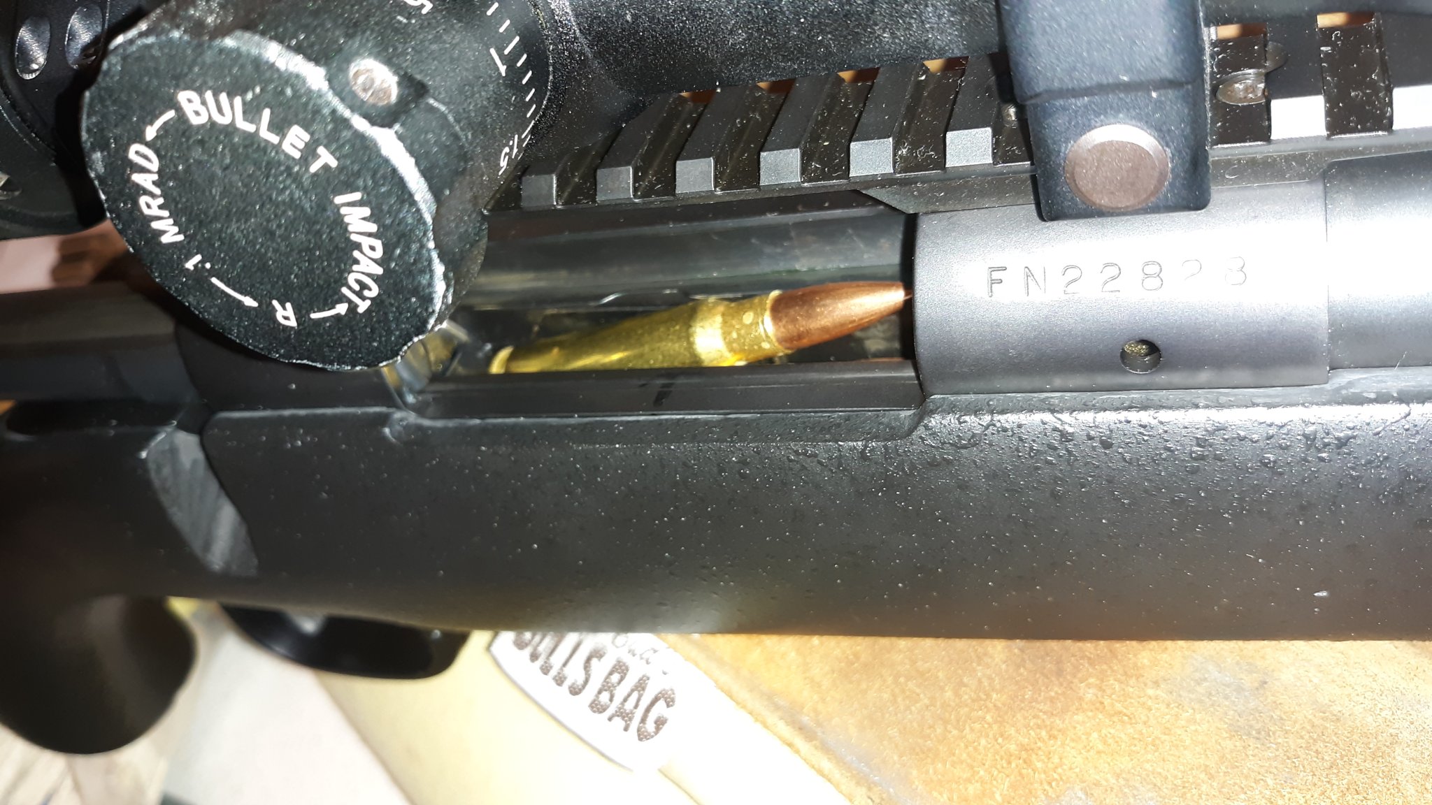

This is an FN PBR I bought recently from a local seller. It's a control round feed action, that originally came in teh Hogue stock with the DBM.
Had my local smith, Barlow Custom in the SLC area, pillar and glass bed it in a Mcmillan stock I had gotten from Midwest when they were closing them out. Threaded and installed the Surefire 3P adapter and adjusted the trigger. I had a hinged floorplate on hand also, I think its a CDI...smith had a follower and spring on hand, but had some issued finding the correct box....it may not be..
Scope is an SS 12X in TSR rings and factory base.
Finally got to shoot it today, at an indoor 100yd tunnel...well 98yds...using Remington and Fiochii 175Grn match, it shot around 1", which is probably as good as I can do. I'm sure it can do better in more competent hands.

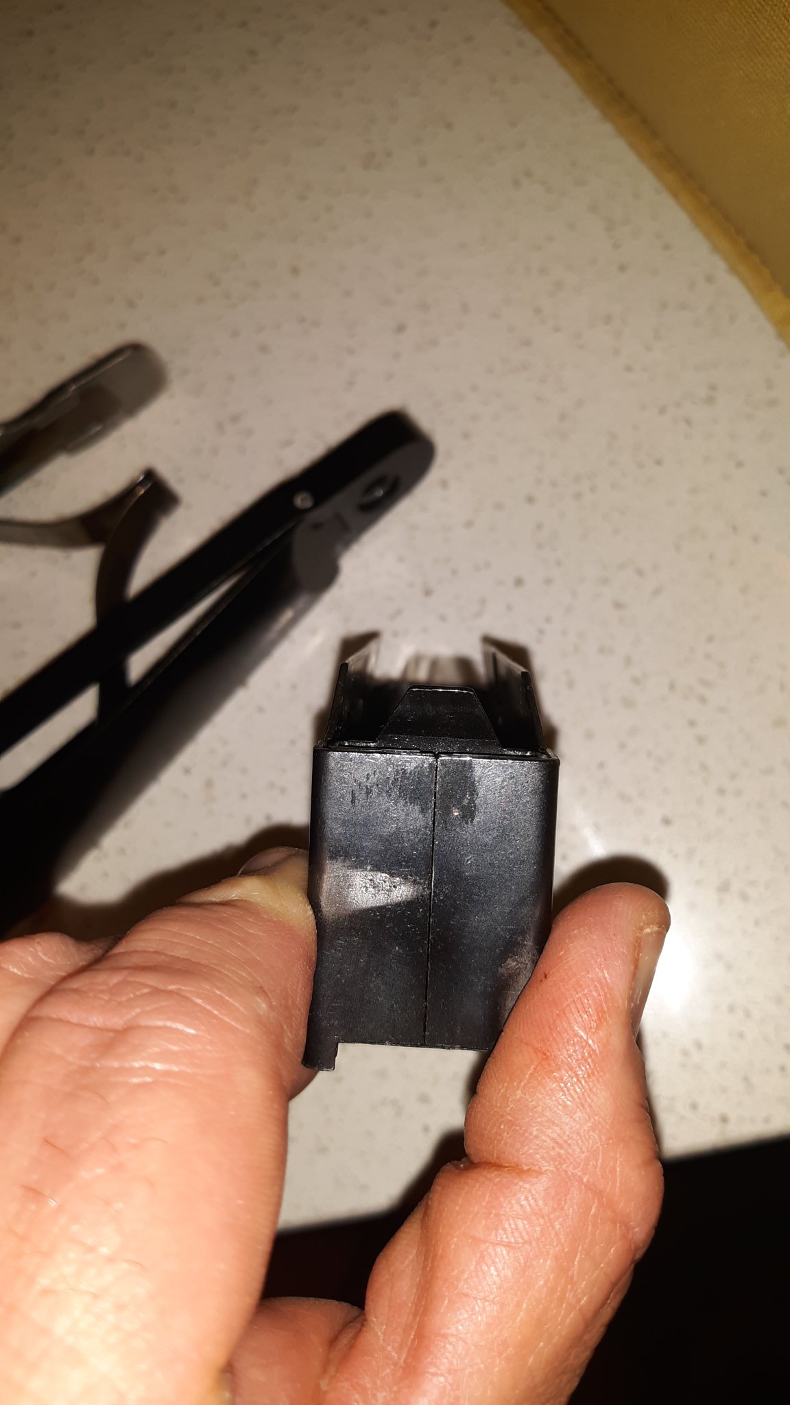

The mag box...anyone know what should be the correct one? This one is marked ASL, the follower is not marked, but appears the same as the one on Midwest site. When I first got the rifle back, the smith said he had a hard time finding the correct one,something about one not being supported properly and the stock being inlet for the DBM originally. Or at least thats what McMillan tod him.
But, I was getting feed issues if I loaded more then two rounds, the 3rd and 4th rounds loaded..ie: the top ones in the mag...will almost teeter at the shoulder, and the base will drop down and the bolt will override it.
Brought it by the smith and he said it's a 3 round mag, which Im fairly sure it ain't. But, he has done a lot of work for me in the past, with out issue, maybe he just got confused on what gun/caliber...or was busy, etc.
I'm hoping a simple swap of follower and/or box will fix it.

The last two pics are the 4th loaded cartridge, and how it pivots in the mag well, the next round will do the same..the last two..ie: first two loaded seem to work be ok
Could it be the wrong follower?
ETA: There is also about 1/4" of room behind the follower in the box...the follower can slide back and forth about 1/4"

WSM follower perhaps...? I'm just going off the top of my head, mine's at LRI so I can't check it to see.
@Action Guy can probably tell you for sure just by looking at your pictures.
It does not look like the follower in my PBR , that one had a scallop in the middle of the highest portion. It had a lot of play also. I had WTO modify my PBR while re-barreling to 7SAW and used a follower for 7mm Mauser and it feeds perfectly , midwest gunwerks still has them in stock last time I checked! 40 dollars or so if I remember correctly. The Mauser follower reduced the play in the mag well to less than an eighth of an inch total , seems to have solved the problem although you may have to cut a slot in the follower on both sides to match the crimps in the mag well .
@R Moran
The magazine box appears to be correct for a short action cartridge. The ASLS will also work. Its the same, but stainless. Your follower is not correct. As Wipiti16b states, it should have a scallop in the top ridge at about its midpoint. The correct short action follower will be marked with a "B" on the bottom side. It will be a machined part. It works for .308 class and WSM. There is a different magazine box for WSM, marked "1340".
Check Midwest Gun Works for Winchester parts, they're the same as the FN parts. You are looking for:
Follower "B" - Winchester part number: U353601170
Magazine Box "ASLS" - Winchester part number: U353071150
Spring - Winchester part number: U356421040
Hope this helps. Good luck.
