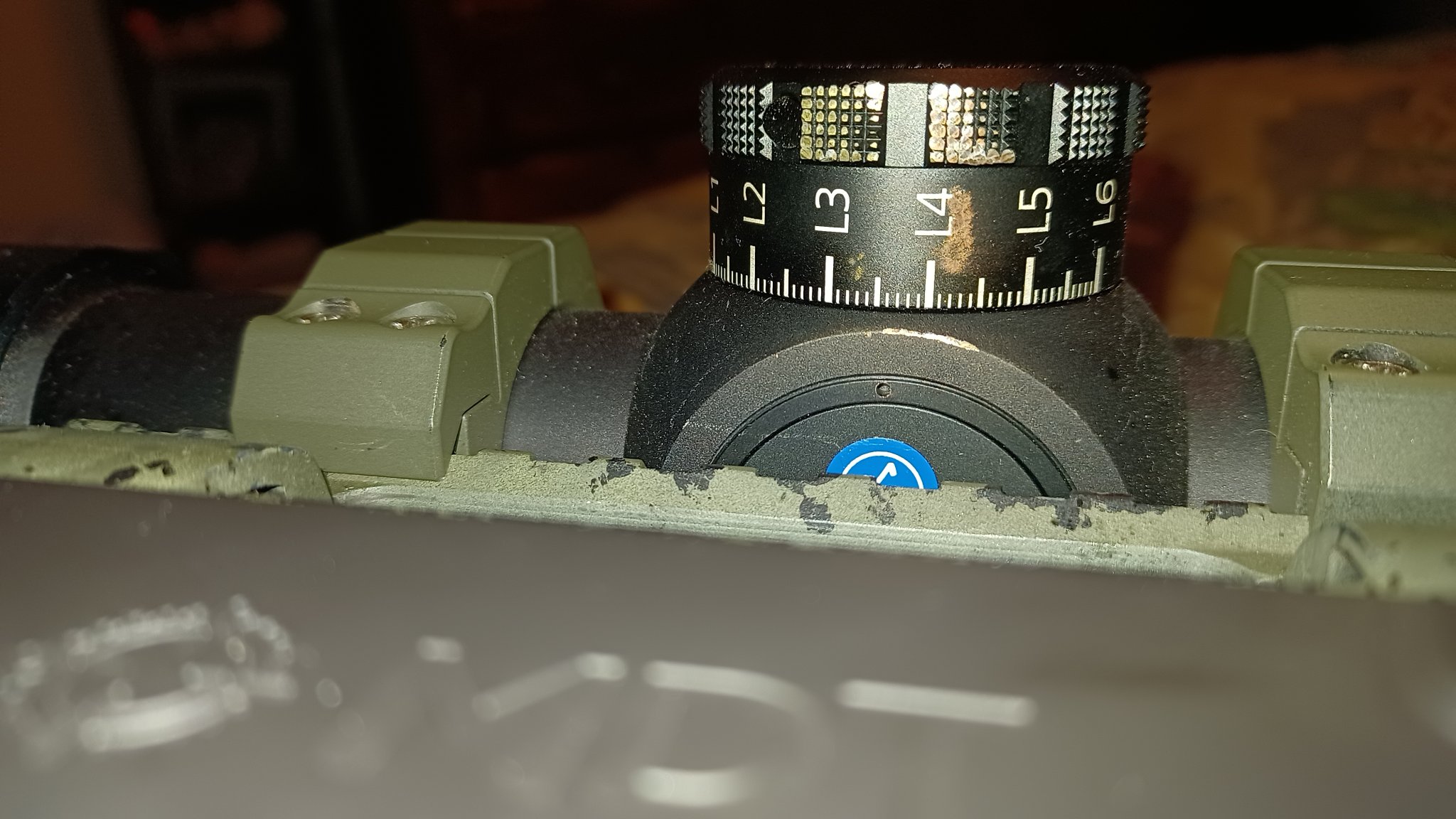

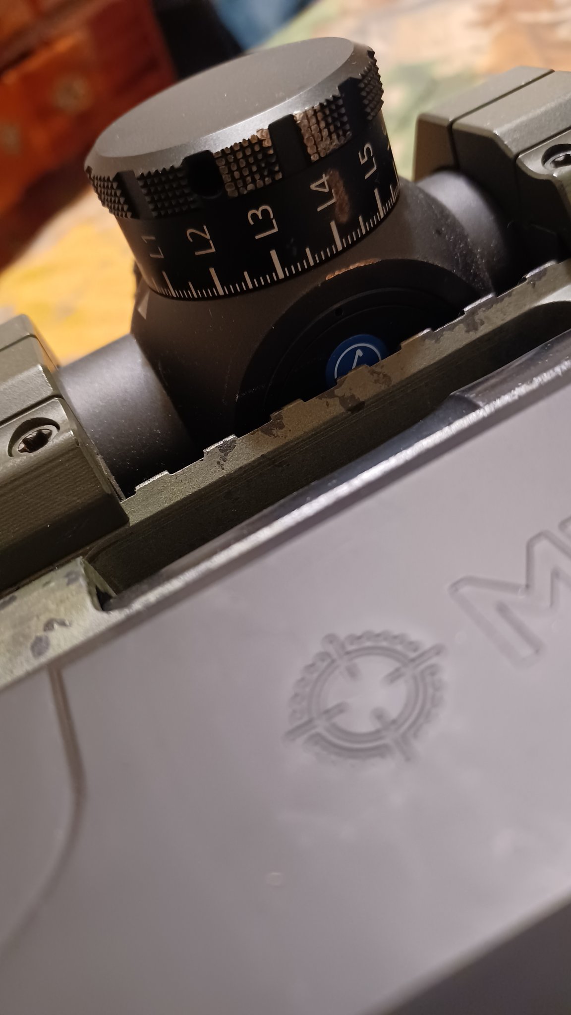

I just realized my elections are beating up my scope turret. I can't tell if is the copper (bullet) or brass. Since I've been playing around with tweaking the feed lips (I've pretty much got very reliable feeding now) I have been feeding and ejecting live loaded rounds.
I'll have to look for some spent brass and play with that and pay close attention to see if it hits my turret or not.
I know with these actions how much force I run the bolt will dictate how hard or fast the brass comes flying out. Anybody else running into this issue?
I will however be looking for a slightly taller setup. These are low seekins rings and I want a medium MPA mount.

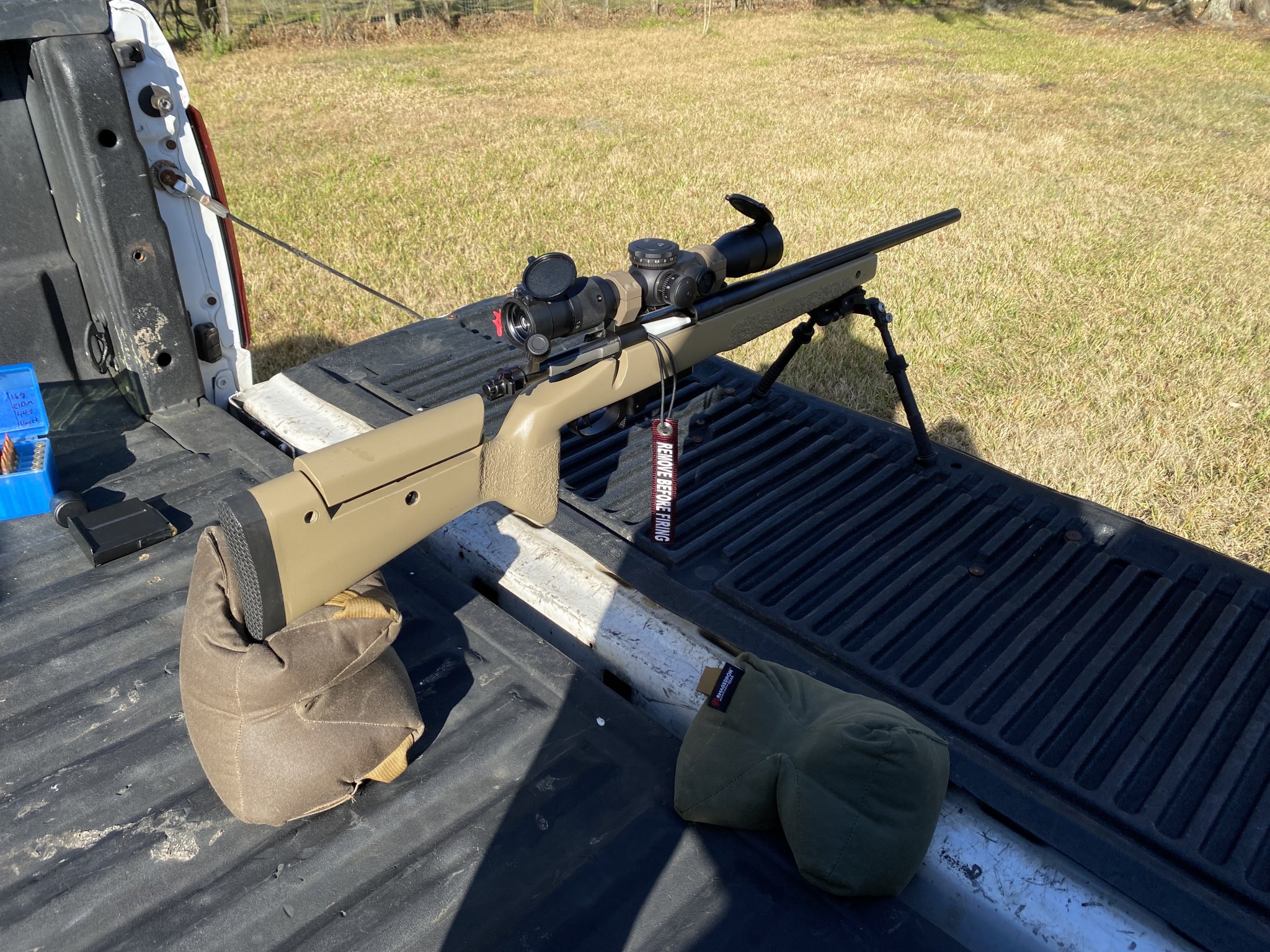

Took my FN SPR out and tried some Norma 168's, it shot quite well. Going to try 175's next week.
When buying the 223 ammo, I grabbed some 308 in 168's and 175's to play with and keep the brass. We shot the 168's this Sunday. We shot out of the DD D5 and the FN SPR. Couldnt get solid/ comfortable on the DD gun so that group will probably close up on another Sunday, but we still got some decent groups.
This was the FN group
This was DD D5
Sub MOA ammo, it was also windy as fck. Going to shoot the 175's next week. So if you need some decent 308, I bought directly from Norma. Just an FYI.
