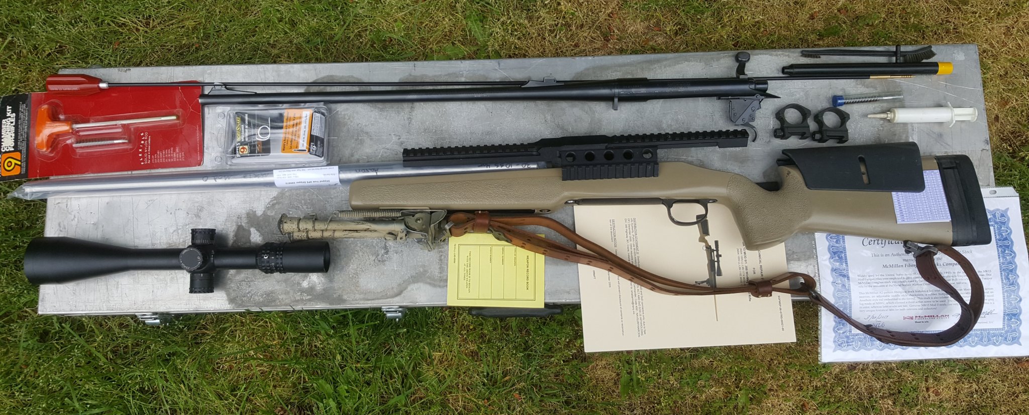

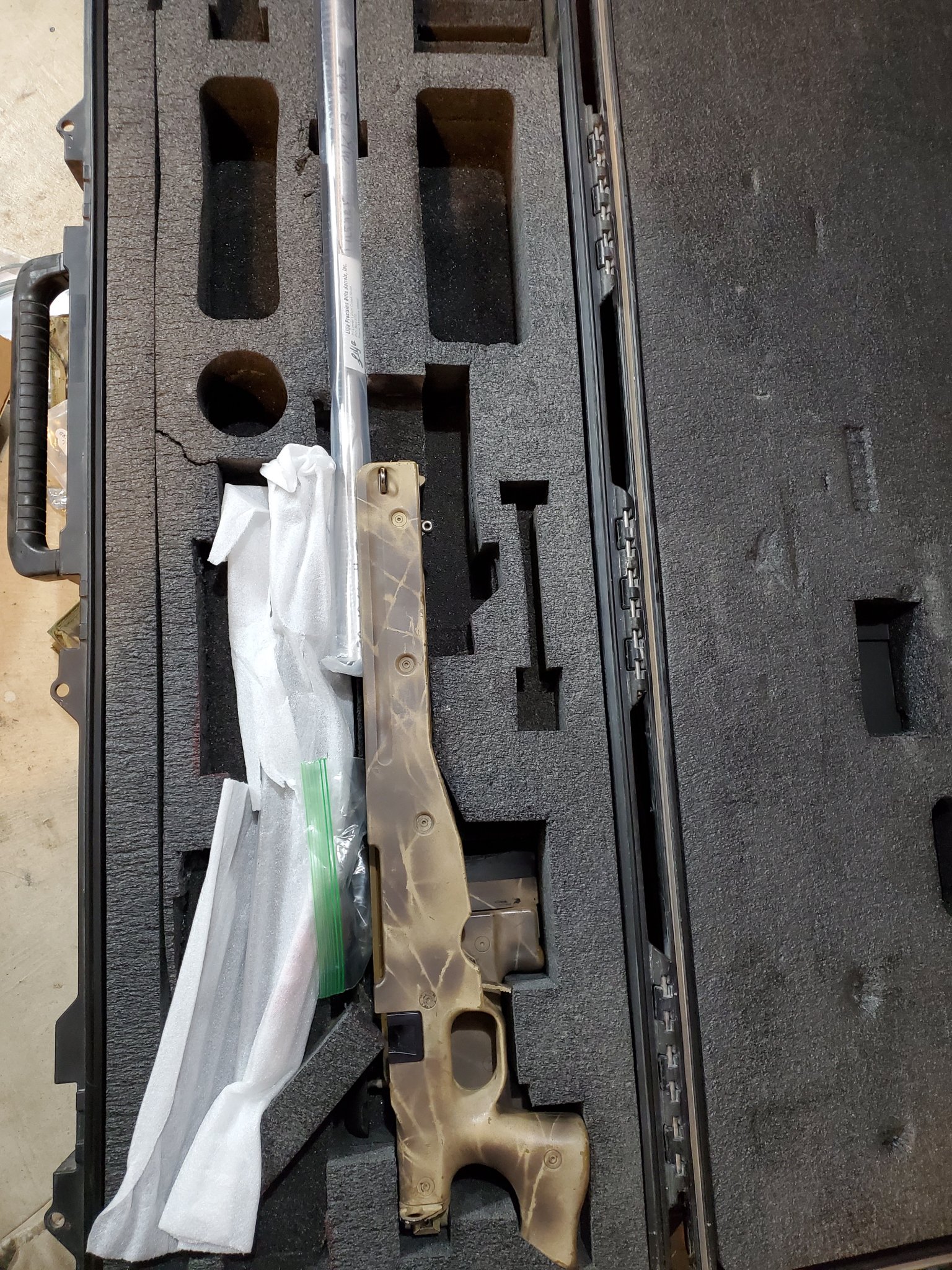

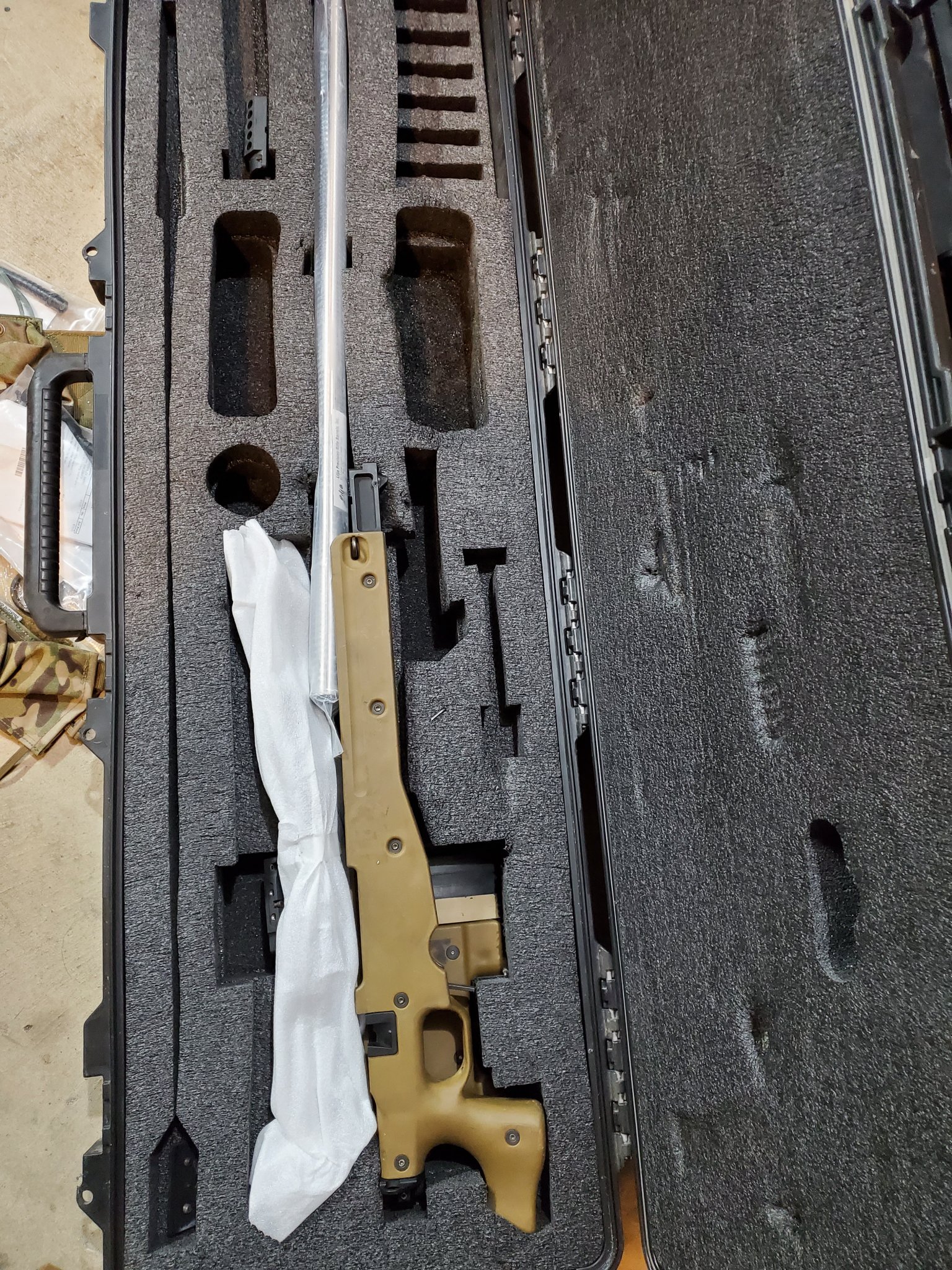

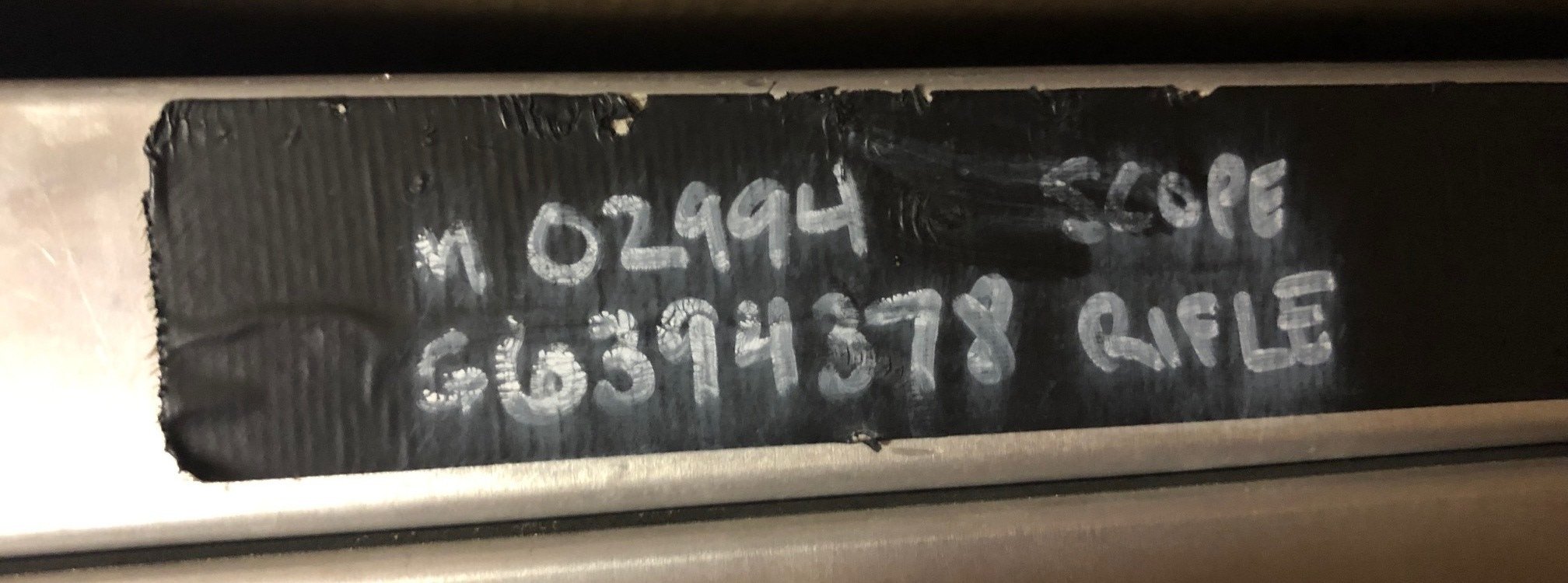

A Mk13 case sold a few months back and my buddy just sent me pics. 2 names on it, Lacz and Chris. Both Chris Kyle and Kevin Lacz were snipers and teammates in SEAL Team 3, so this case was issued to one or both of them!
Their rifle's serial number is G63944xx, unfortunately the last 2 digits are obscured, so I have no idea if I had the stock from this Mk13.
However, the other case that was for sale does have a full serial number visible, it's G6394330. I don't know if there's any names on this case, but I sold stock number 4330 back in 2016. Can't find any pics of it, but it was painted up and looked awesome!!
Amazing pieces of history!
That’s quite a rare combo if that providence is correct(!). Thanks for sharing those pics. My guess is they might be Mk 13 Mod 3 (suppressed) serial numbers as well. My DRMO Mk 13 case has no names but serial number is quite similar (G6394378).

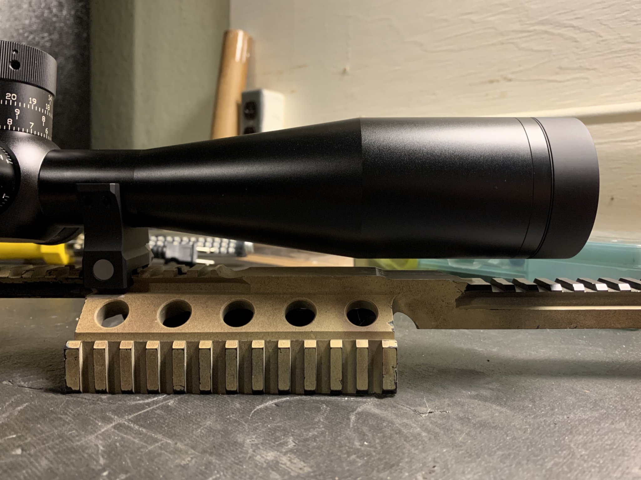

Thanks for the other pic, first time I have seen a Mk 13 Mod 1 (left handed version). (On edit: I found the 2-piece scope bases interesting too).

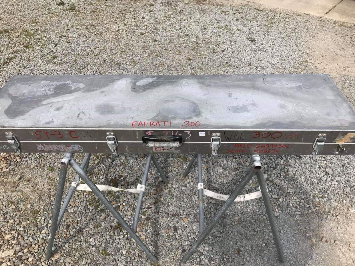

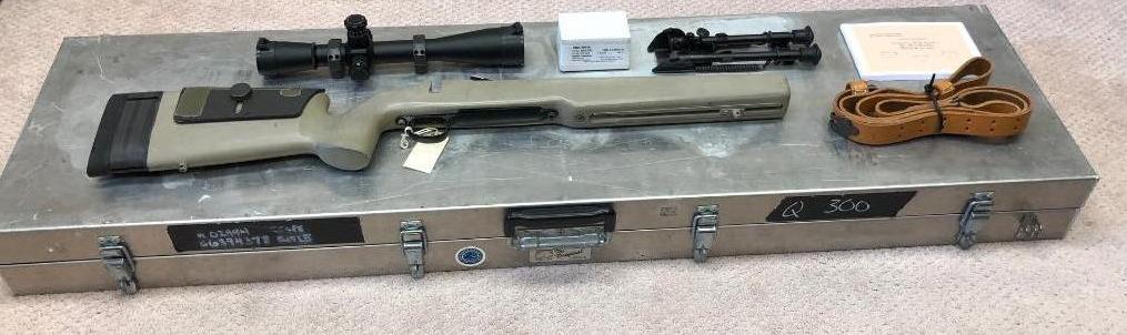

Tony Eafrati's Mk13 stock and matching case. He was Kyle and Lacz's platoon chief at Team 3.

Wow, matching transport case with the take-off stock(!). That's going to be a nice build with incredible providence.
What is your take on all of these G63xxxx serial block cases? Were some Mod 0s possibly converted to Mod 3s?
(I ask that based on Chris Kyle's documented us of a Mod 3 in combat, but these G-prefix cases could predate that tour).
I know for sure that G6394309 and G6553921 existed as Mk13 Mod 3s at an NSW armory on the east coast in 2009. At that same armory there were some Mk13 Mod 5s (G6553886 and G6553901) with serials lower than the highest Mod 3. One could deduce that they were from the same order of actions from Remington. The G6394XXX and G6553XXX serials represent the very last block of builds of McMillan stocked Mk13s before the Mod 5's took over.

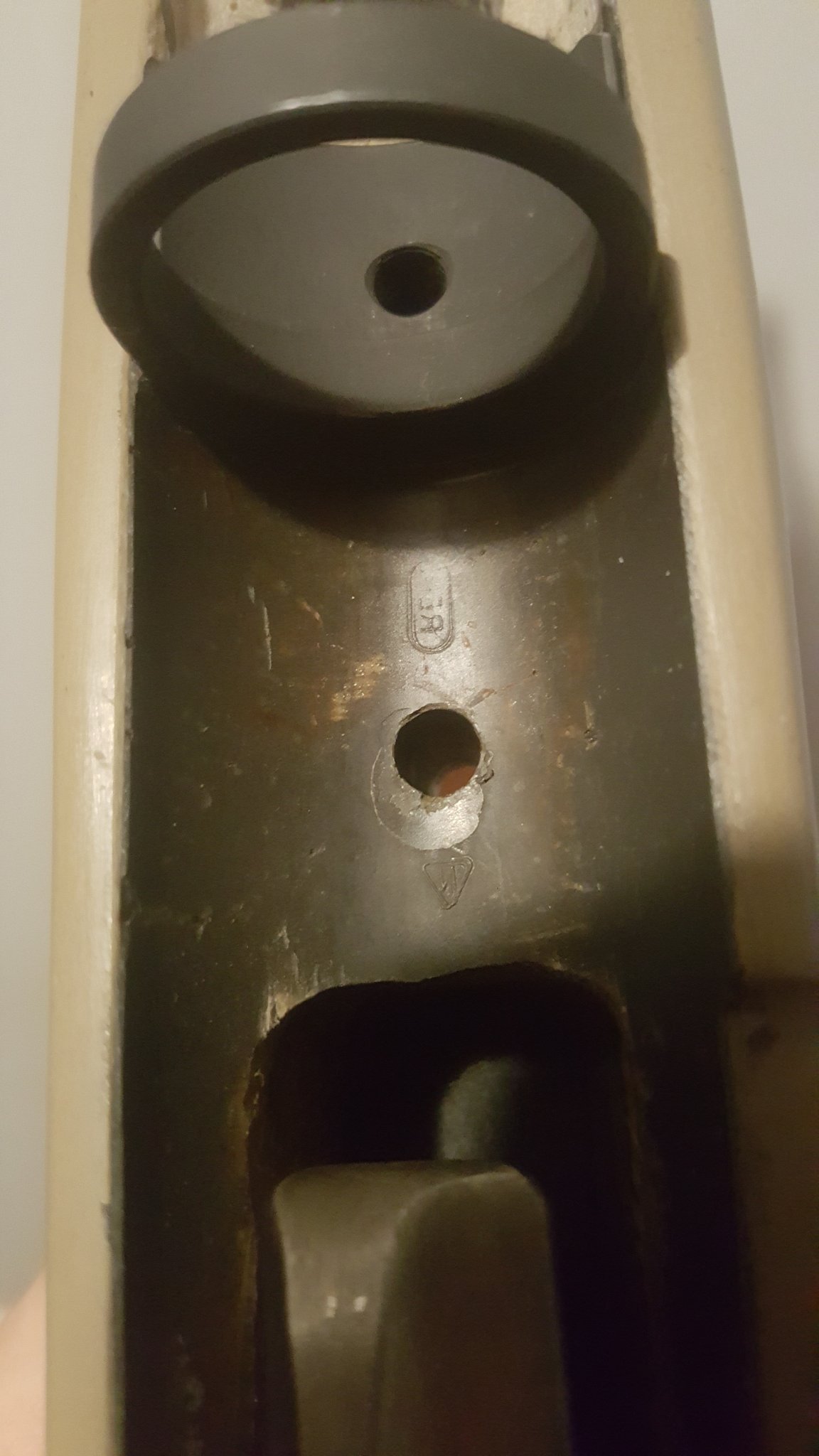

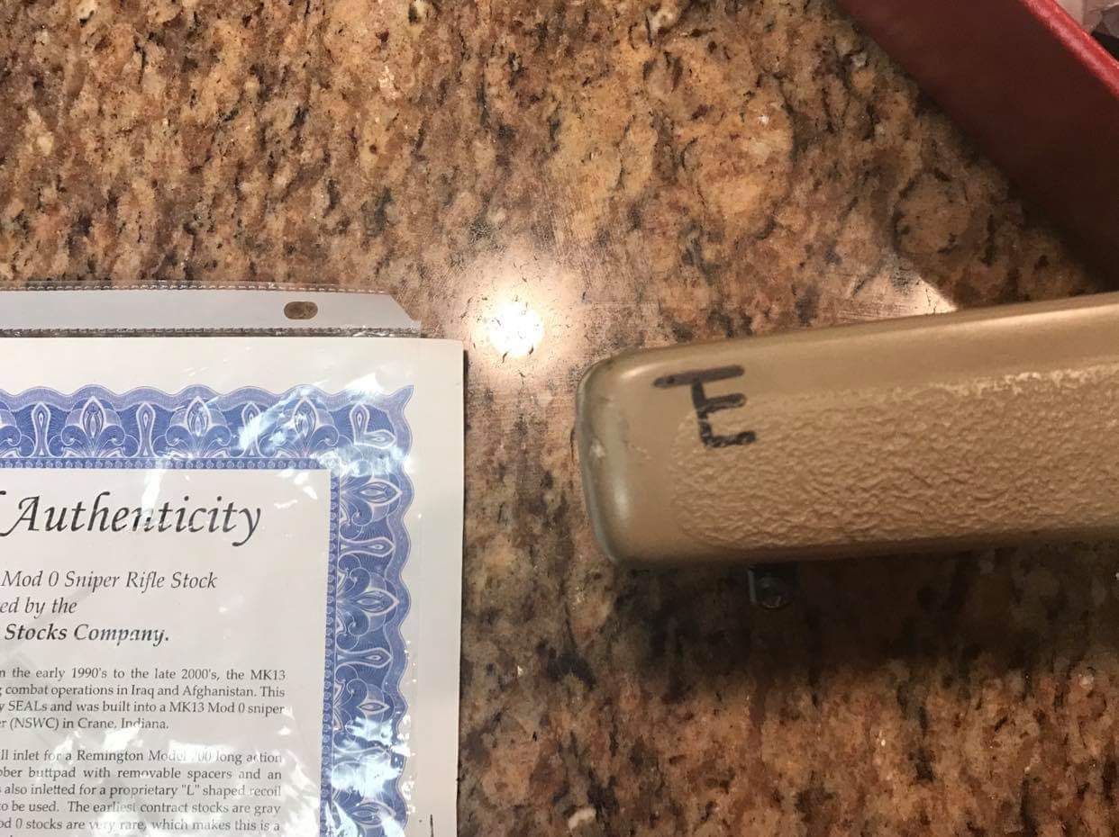

Just a little tidbit for those curious about what prefix action their stock may have had:
G prefix actions (late builds) have a small REM stamp on the bottom forward of the action screw. C and E do not. That stamp will be visible in the bedding. Having a Mod 0 stock with a G prefix points to being a Mod 3. Seen a couple like this so far to include an earlier grey that was a rebuild.

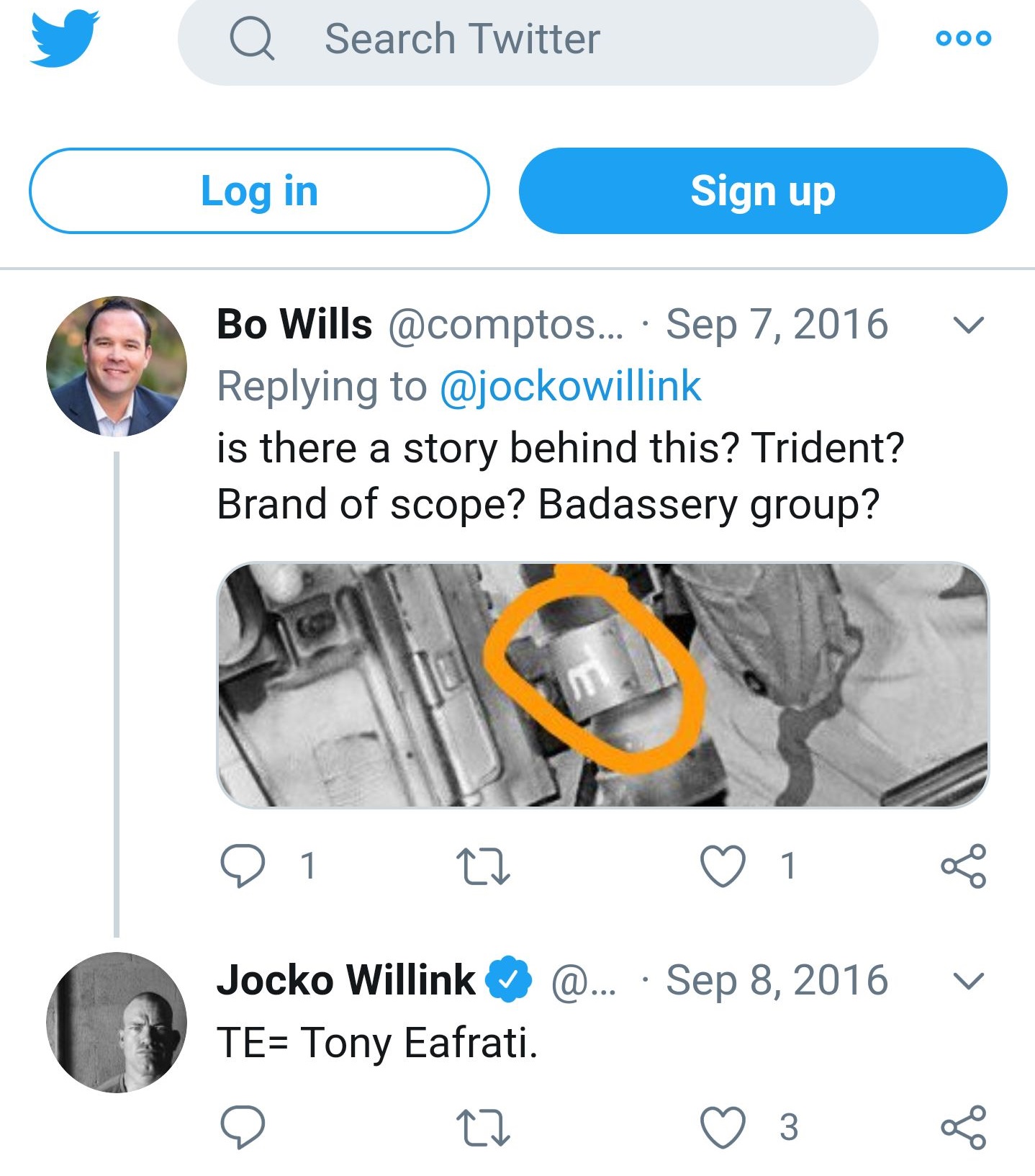

That is some serious cool factor right there. Excellent Jocko podcast with Tony out there - dude is a character.
I wonder what the Twittersphere gods could reveal about other names on rifles - I'm still empty handed on my search.
Speaking of Eafrati and Mk 13 rifles, I googled that interview: https://radiopublic.com/jocko-podcast-6Nl1Kl/s1!0444a

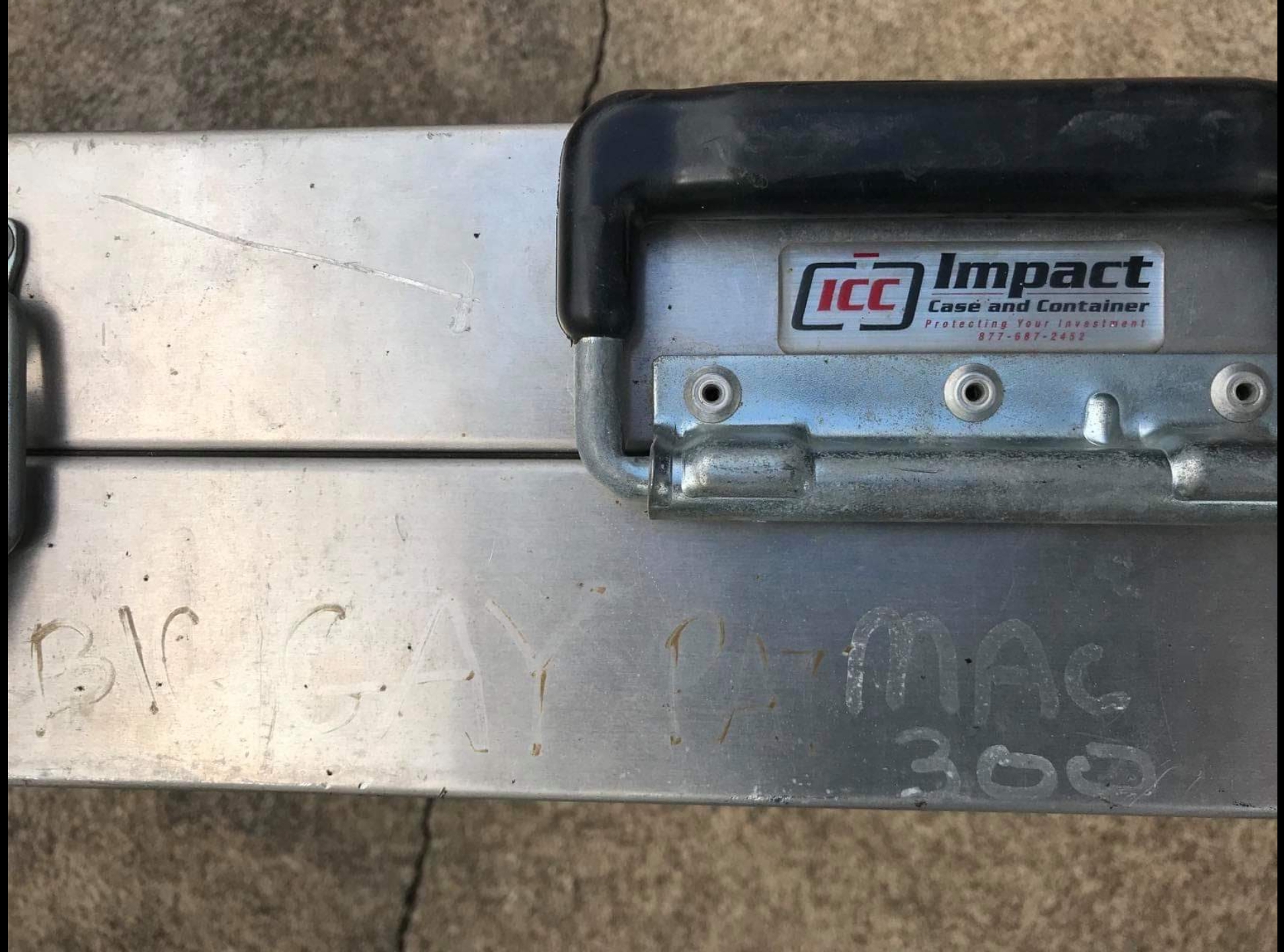

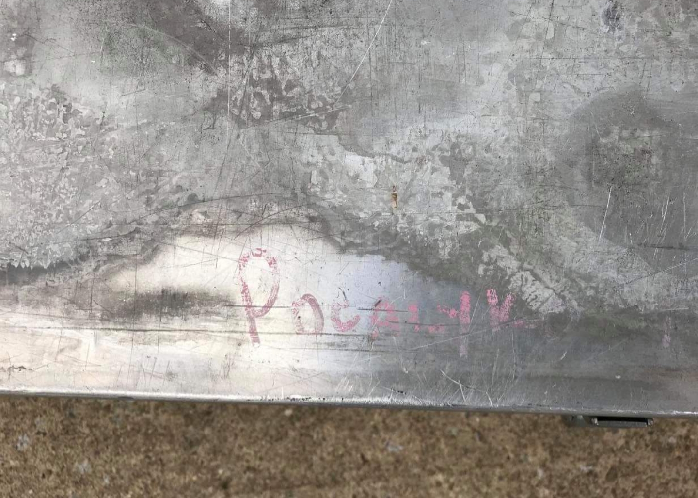

My stock isn't named but my case is.
Pat Pocalyko. Front of case is tagged "Big Gay Pat" lol.
There's a 2nd last name of McDaniels crossed out and Task Unit 2 as well

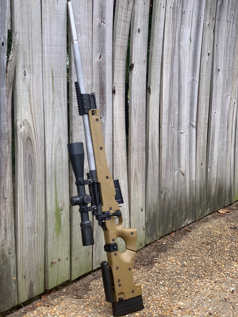

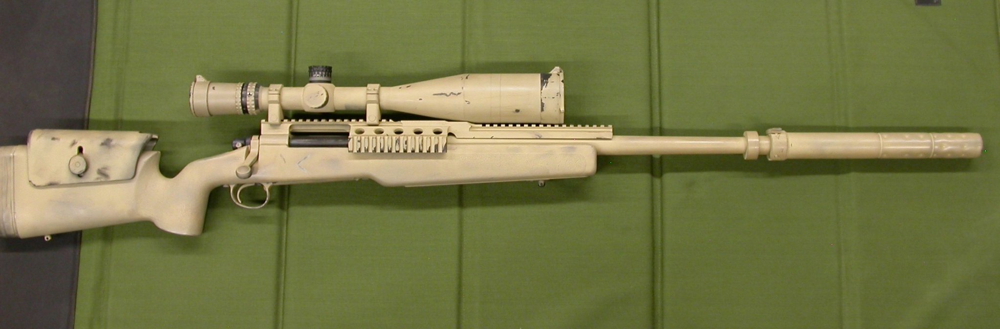

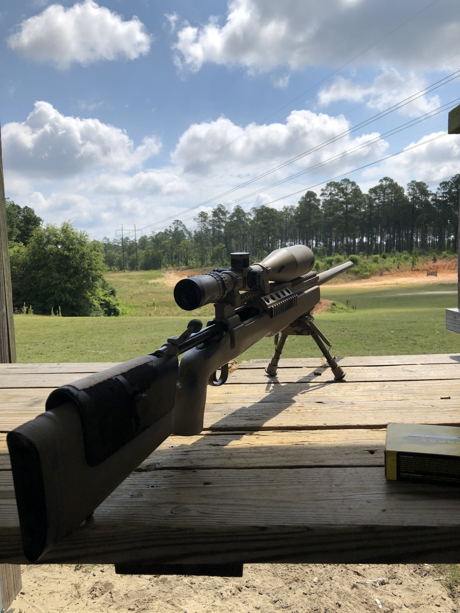

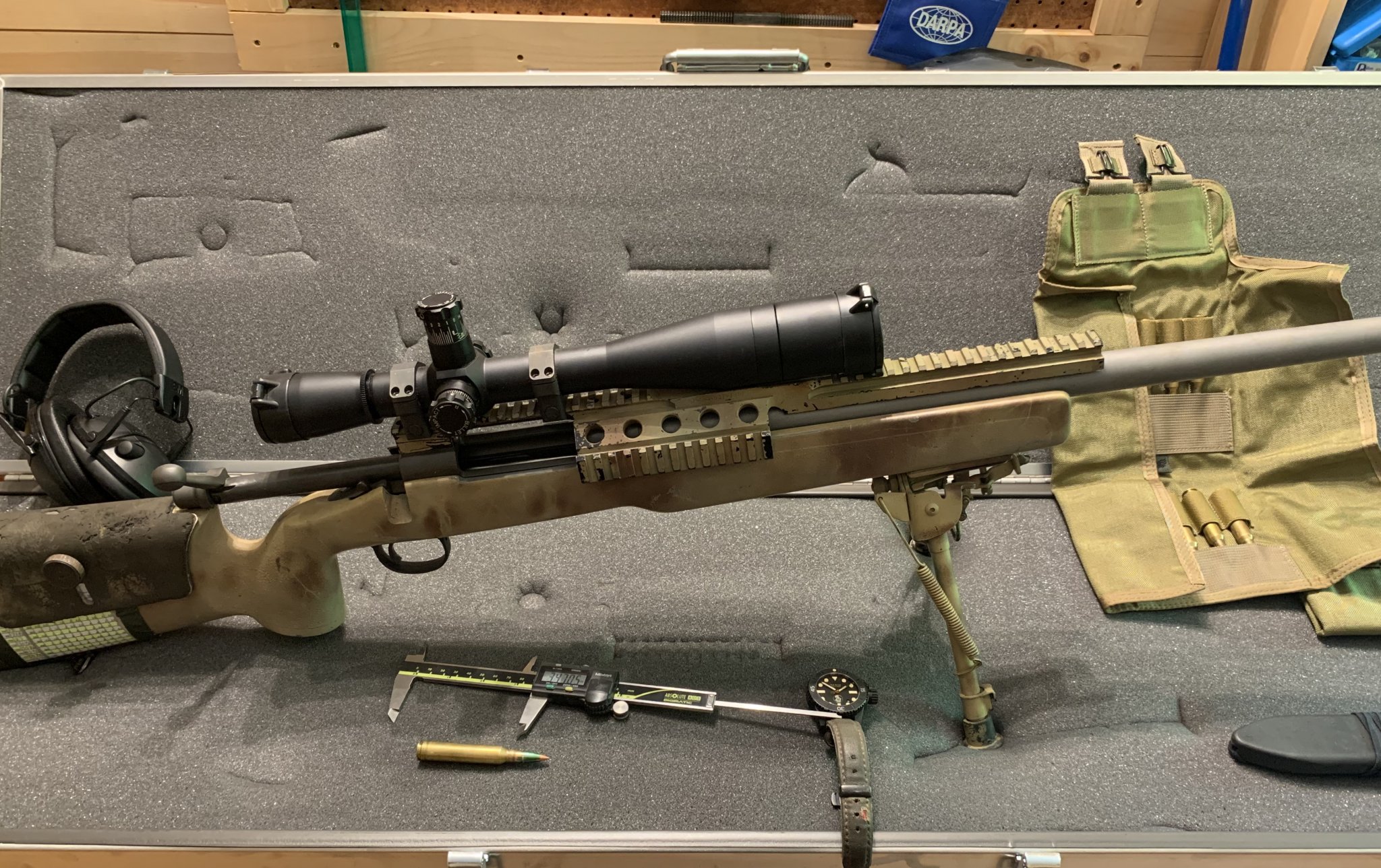

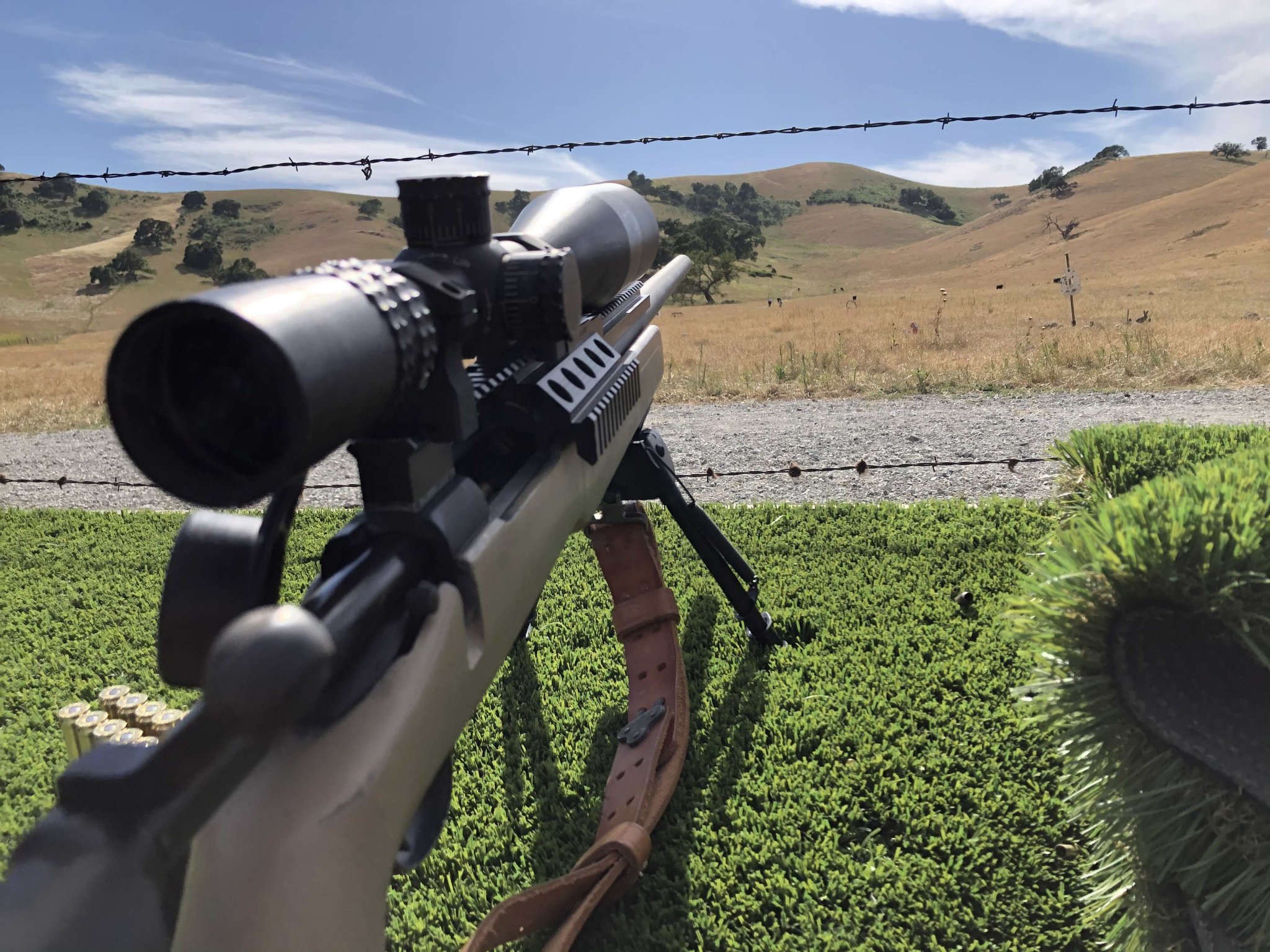

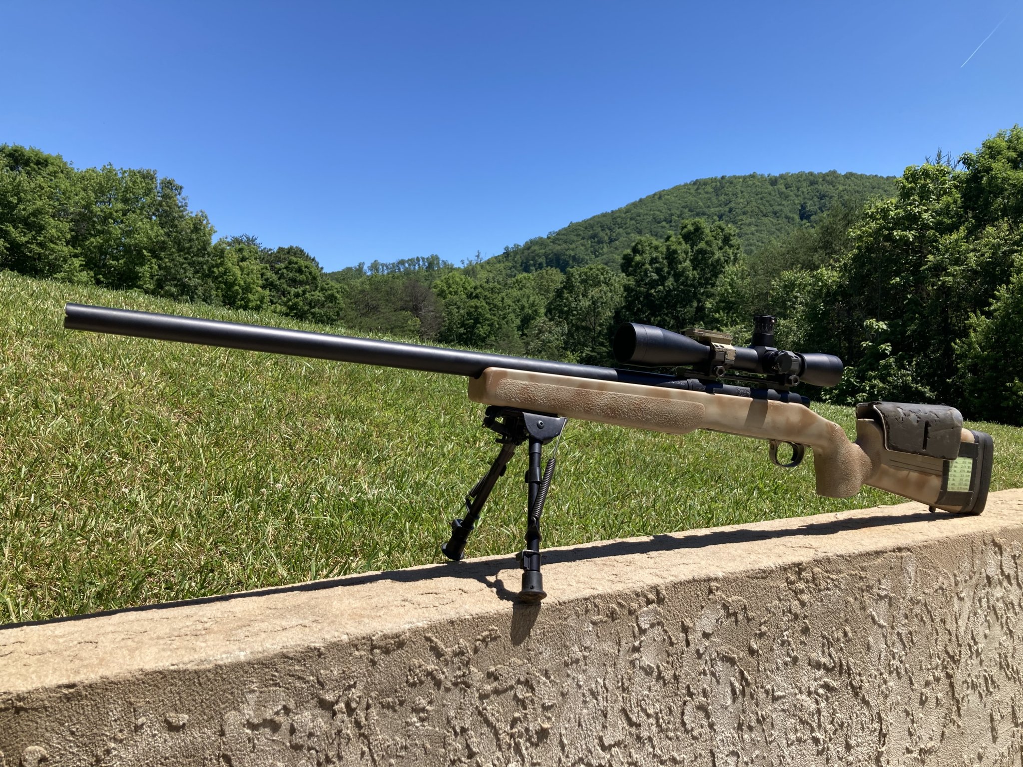

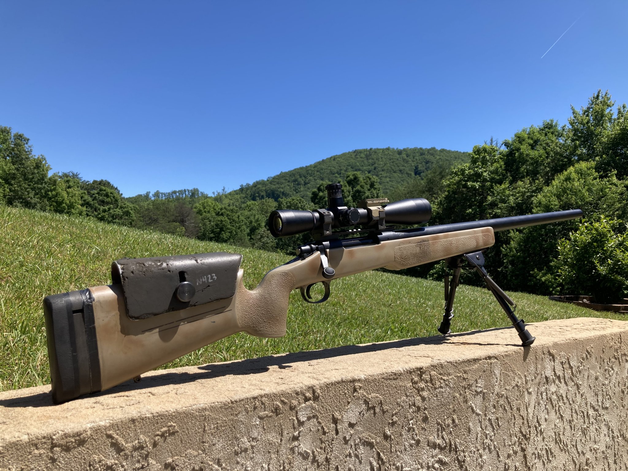

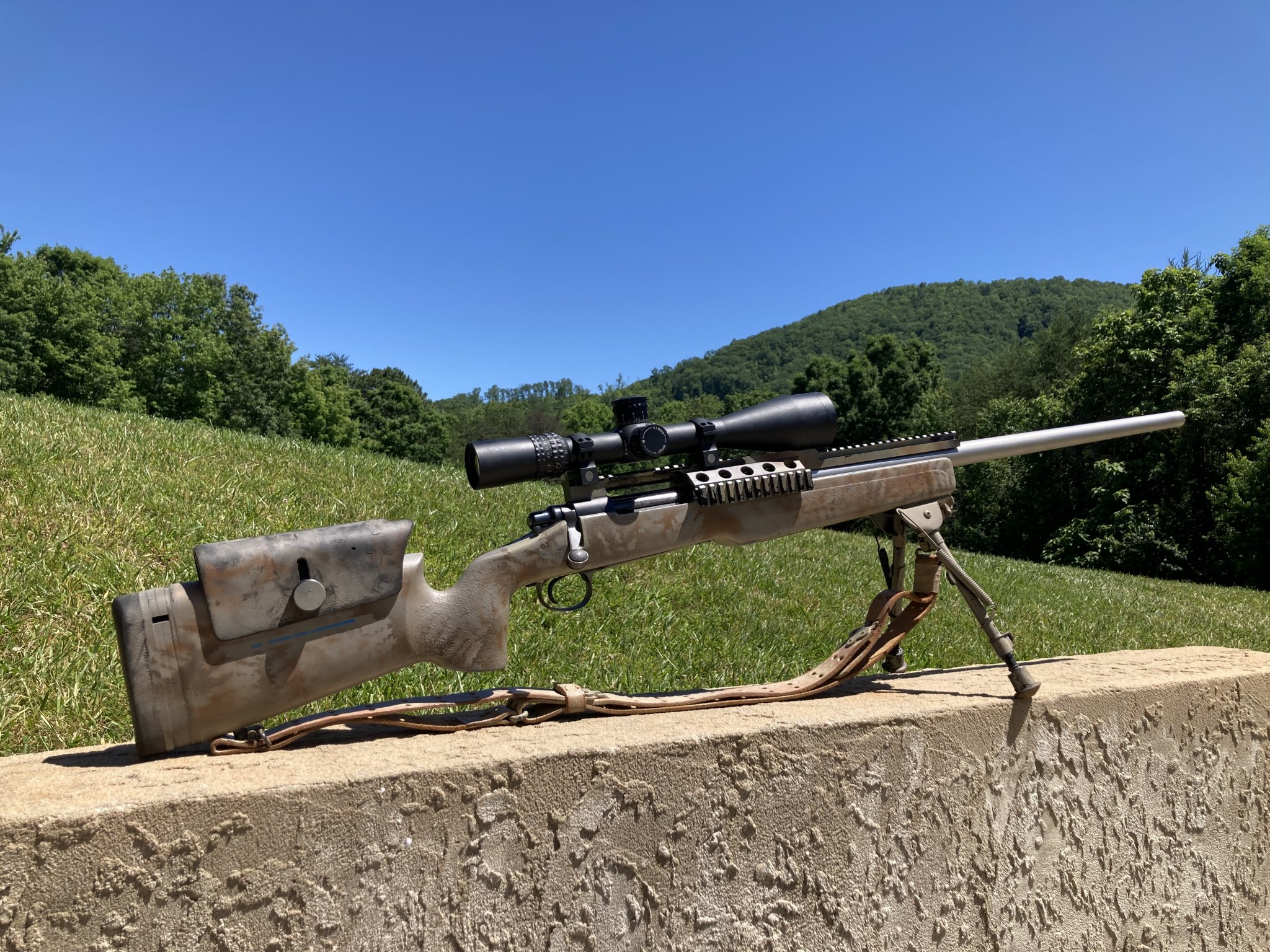

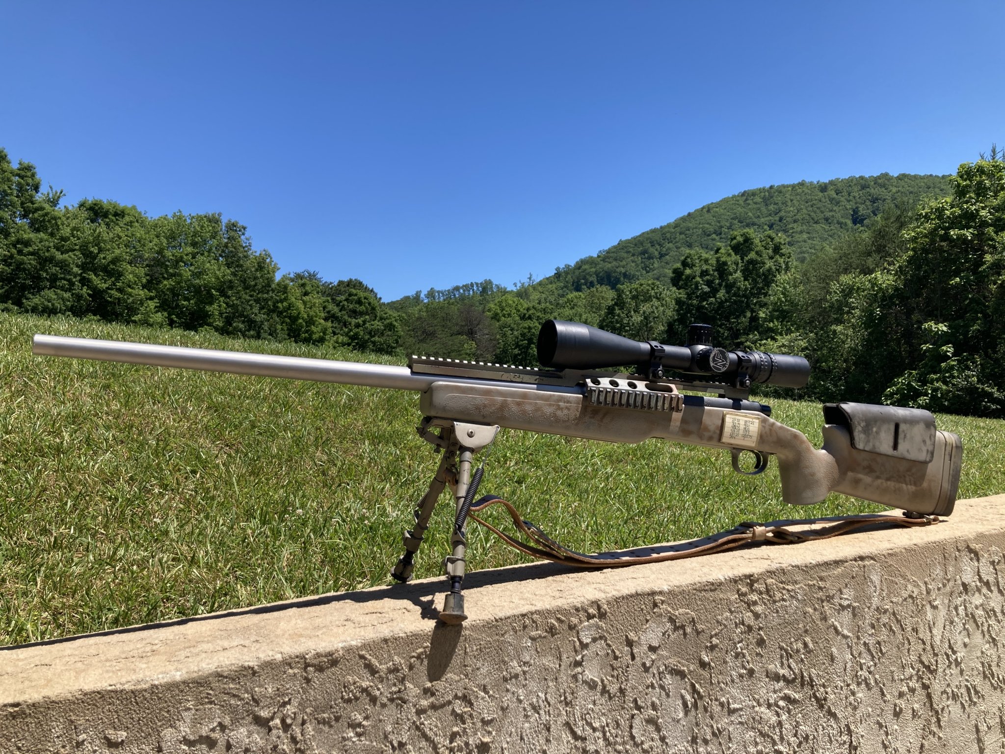

Had these two out today for a little trigger time. First one is chambered in 300WM and the second is chambered in 6.5x55. LRI did the machine work on both and they both hammer. Raven Rifles did the bedding work.
Rifle 1:
Original- Stock, Btm metal, Rail, Early bolt without extractor mod, Bipod and Sling. The rest of the parts were sourced new/used. NF 5.5x22 and 40x trigger.
Rifle 2:
Original- Stock, Btm metal and Bipod. Issued SIMRAD cap and Ultra rings for who knows what system. The rest was sourced new/used. Mk4 16x and 40x trigger.
Thanks for the help along the way!

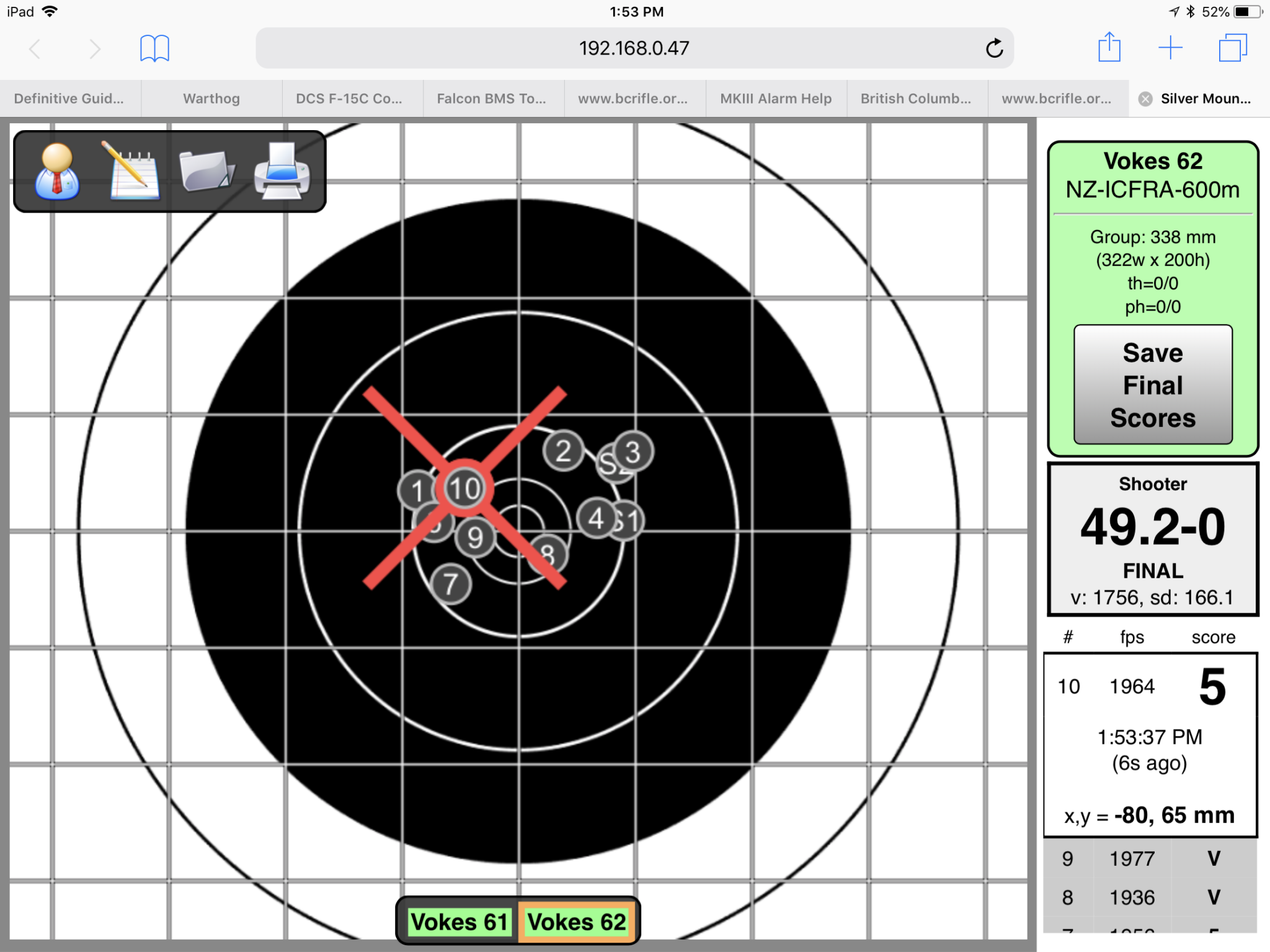

Thats what I’ve heard, basically have a spent brass bucket next to your rifle. I haven’t chrono’d the 74 grain load at the muzzle but it’s still just shy of 2000 fps at 600m and the brass is good.

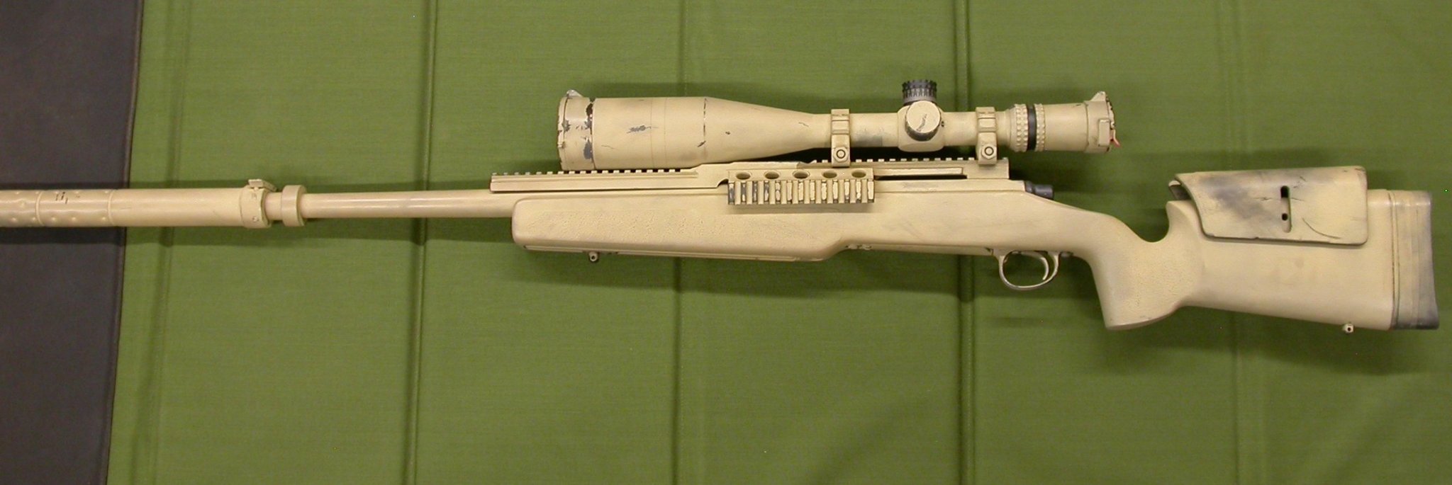

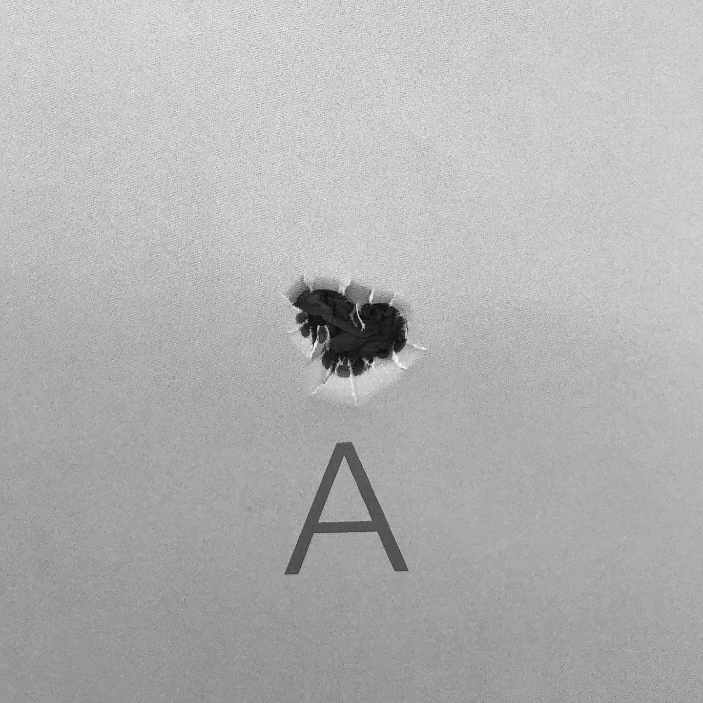

This is 5 shots each from 2 different rifles, my Mk13 is shots 6 thru 10. ( shot 6 is underneath shot 10)

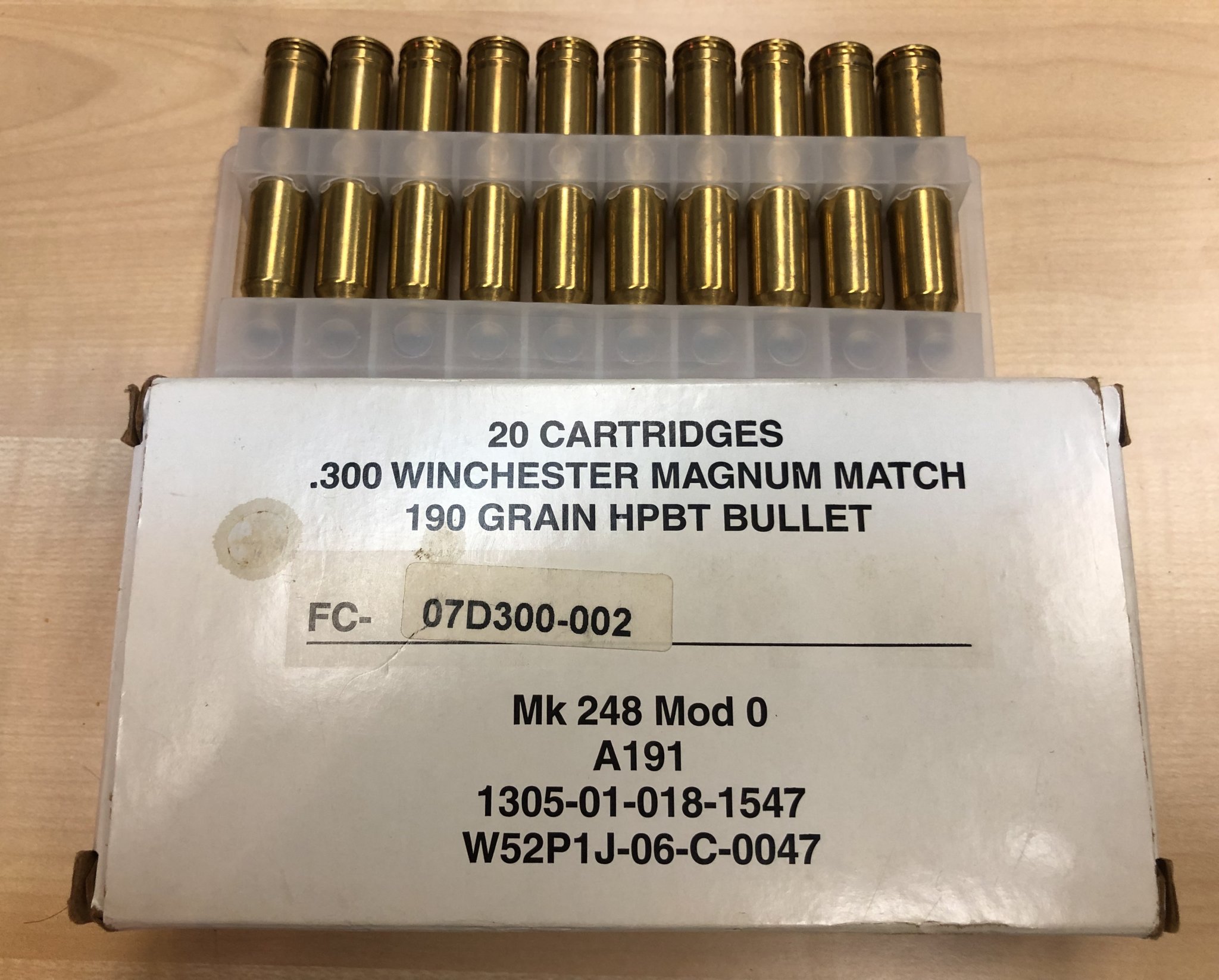

If anyone has a box or two, even empty (191 as well), I'd love to pick some up for display.
I try and get all the various kit items for my rifles to include ammo. The 248 and 191 have proven tough to find so far.

Not sure that exists. The contract for Mk248 went to Federal, and the brass I’ve seen is marked as such. Here’s some good history of the military 300 WinMag cartridge development:
(IMO, reloading Mk 248 Mod 1 is a mistake given the stress of the original loading. I’d guess Mod 0 is more reloadable due to milder load, but I’d still be reluctant. I’ll defer to others.)

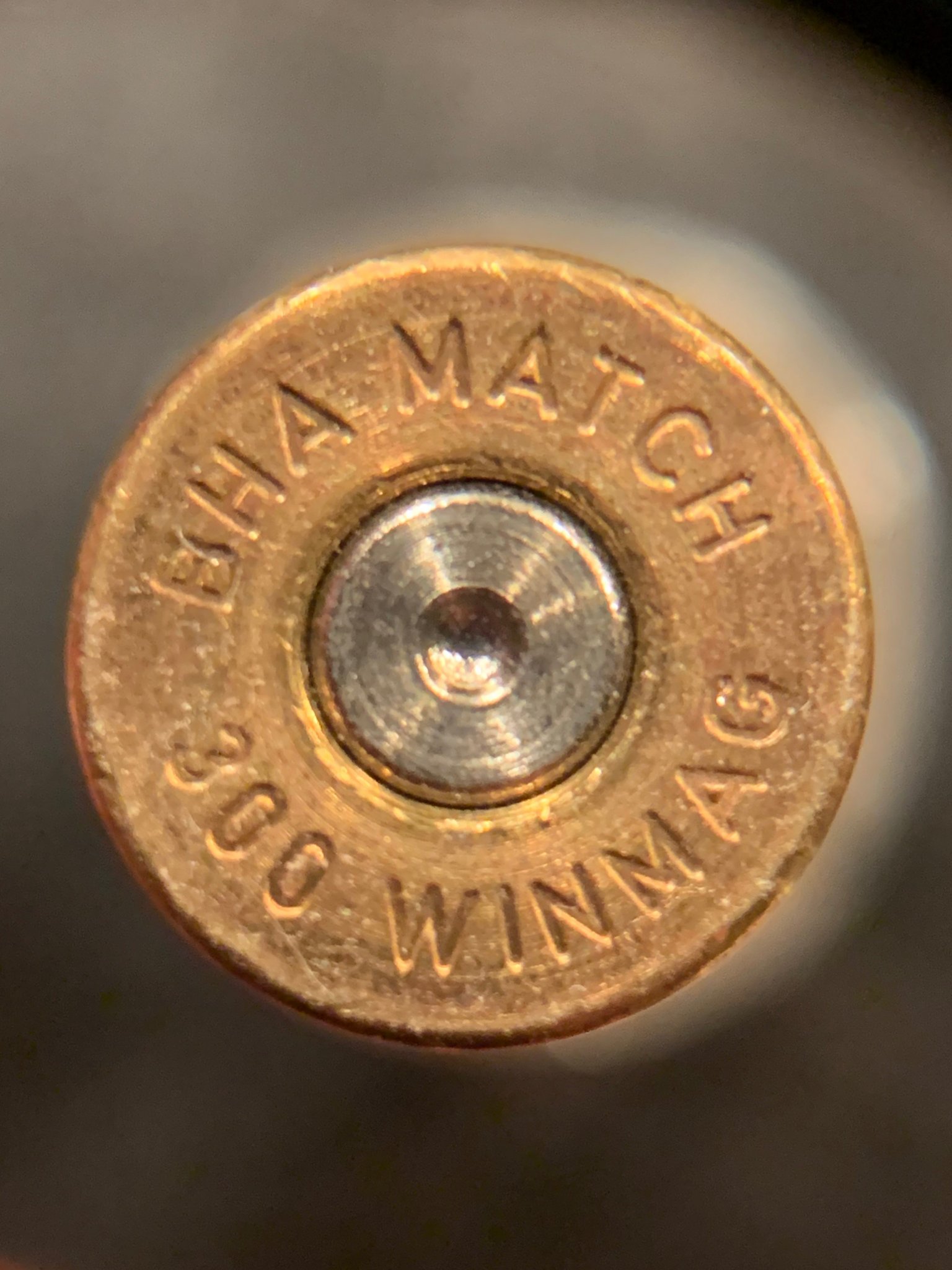

I’ll have a look at what I have. For whatever reason the 500 Black Hills Match cases I bought have some Lake City 300 WM cases mixed in, however the date stamps are all mixed, from LC08 up to LC11. So I’m not sure I could hobble together 100 of the same year head stamp but I will check.
Im also assuming that the only source of once fired lake city 300 WM brass would be Mk248 ammunition?
