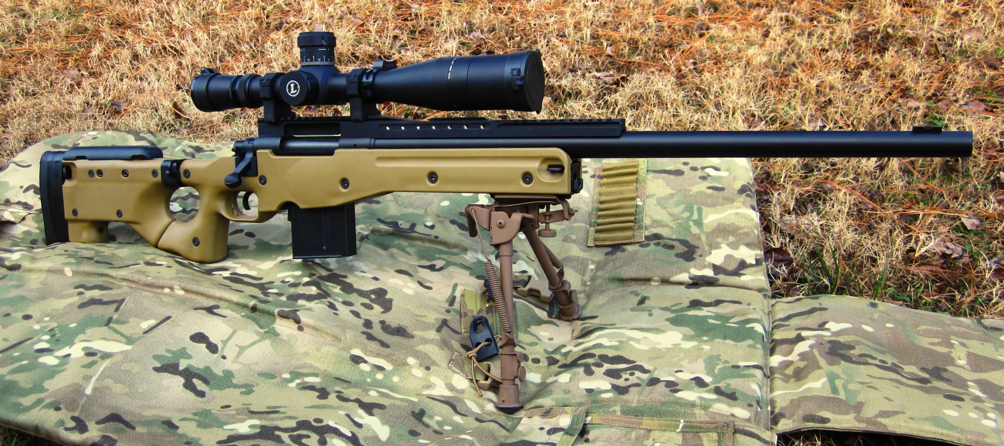

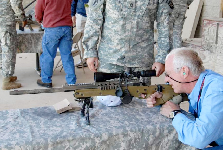

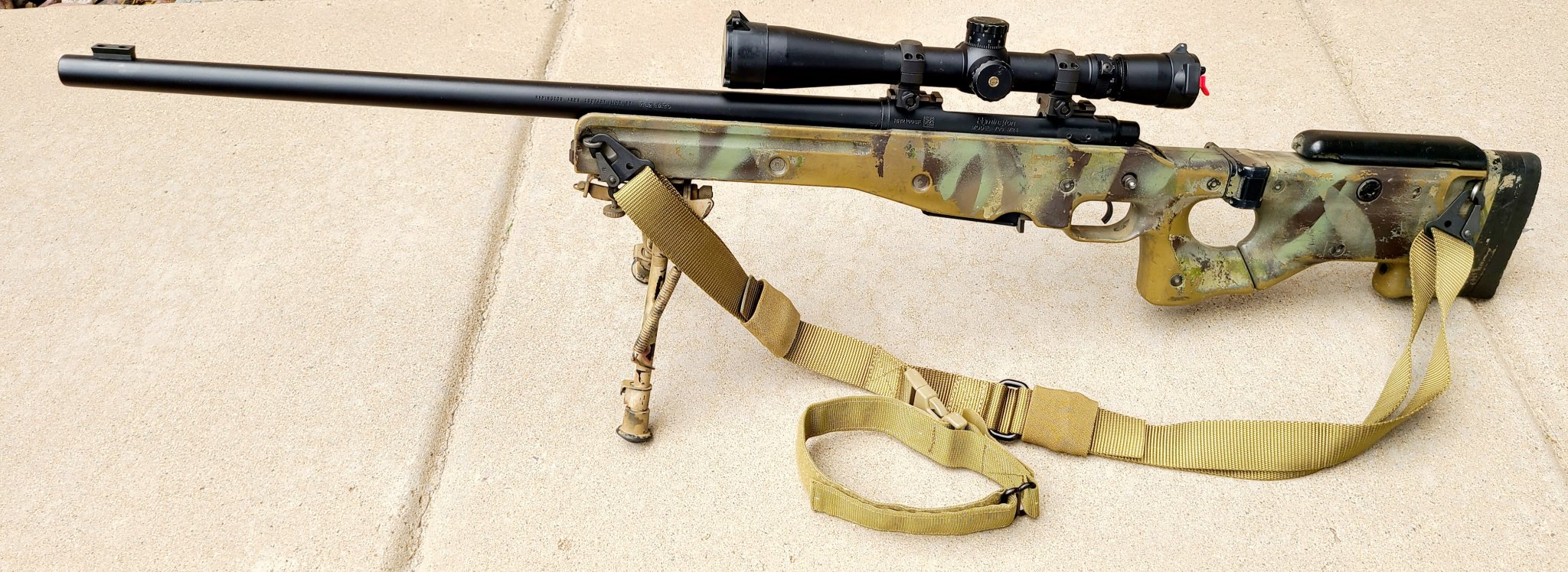

Does anyone have any information about an Accuracy International stock that was being considered for the M24?
Yes. 50 were made for Socom mid 2ks. They were more than considered, they were and are still used. Both down range and in Schoolhouse/Comp settings.

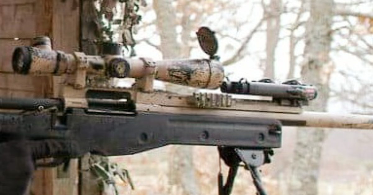

Here's one
MARS with PEQ-2 on the top rail, is that set up for use with a helmet mounted monocular like a PVS-14 that looks thru the scope. Or is it meant to be used with a PVS-10?
Havnt seen a top Pic mounted laser before on MARS/MIR, like you said its occluded, even with that Mark 4 Super High ringset. It would be tits with a PVS-10 if you could get them both aligned. But I assume these AI stocked rifles were issued after the PVS-10

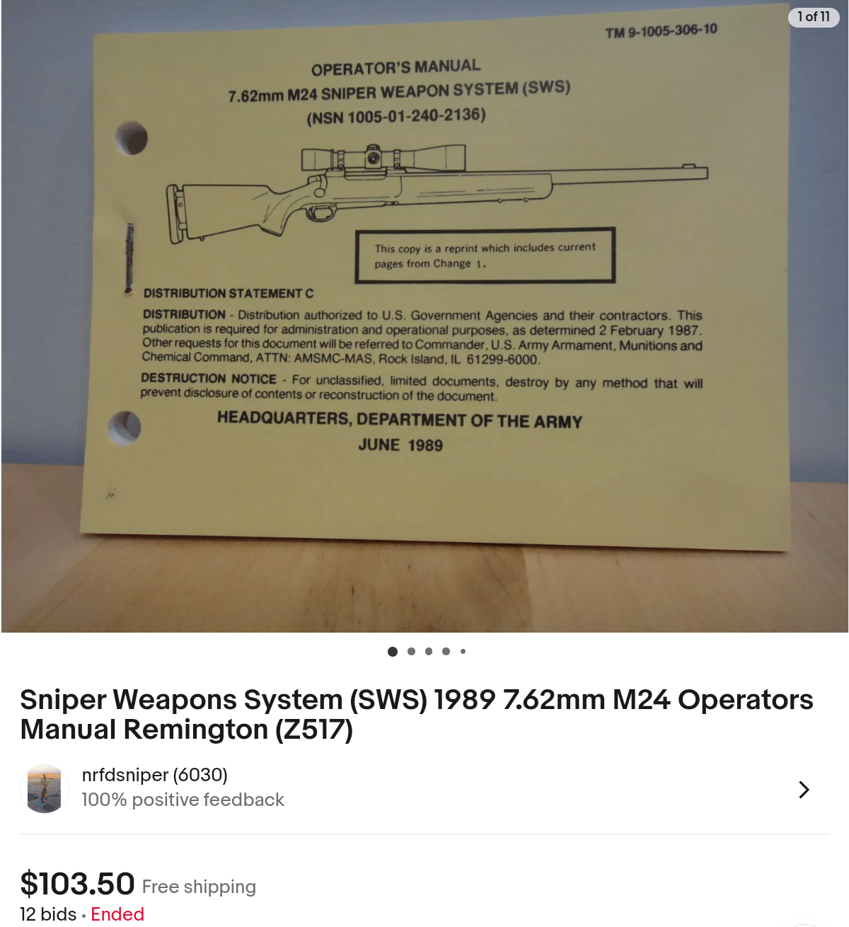

Does the green on the covers make it a super special forces ninja sniper collector’s edition manual? Otherwise I’m baffled at the going price for this…
It is an original issue manual dated February 1989. Here is what is commonly found, a reproduction. Maybe speculative, but now that Illion NY is closed, its possible there will be a lot of M24 items hitting the market soon.

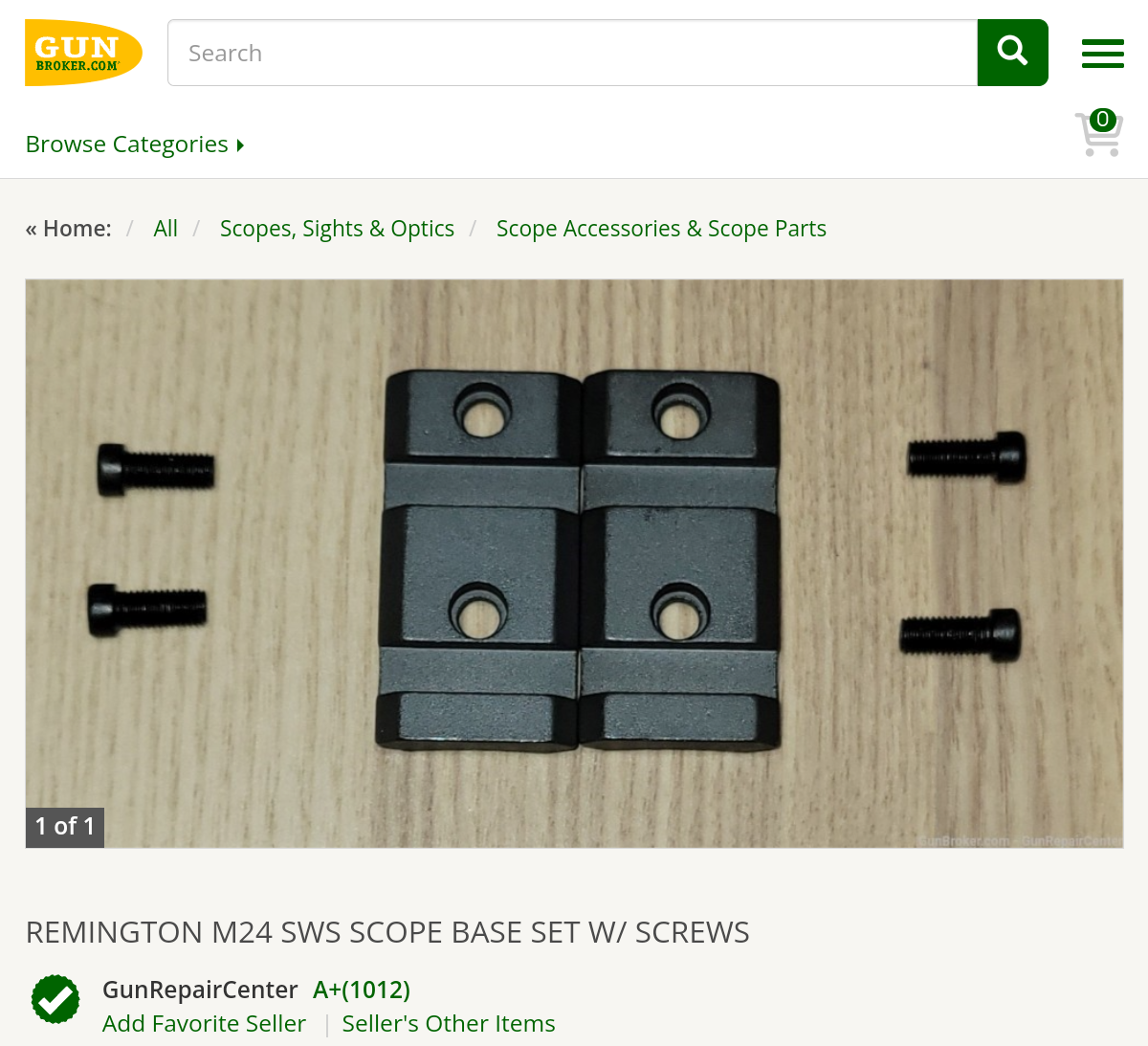

I just read this whole thread and I didn’t see much about the 2 piece bases maybe I missed it. What is the part number for them. I am assuming they are Leupold.
Leupold Mark 4 2-Piece Base Remington 700 Long Action Models, Right Hand, Matte Finish PN#61983
These require 8-40 threaded reciever holes

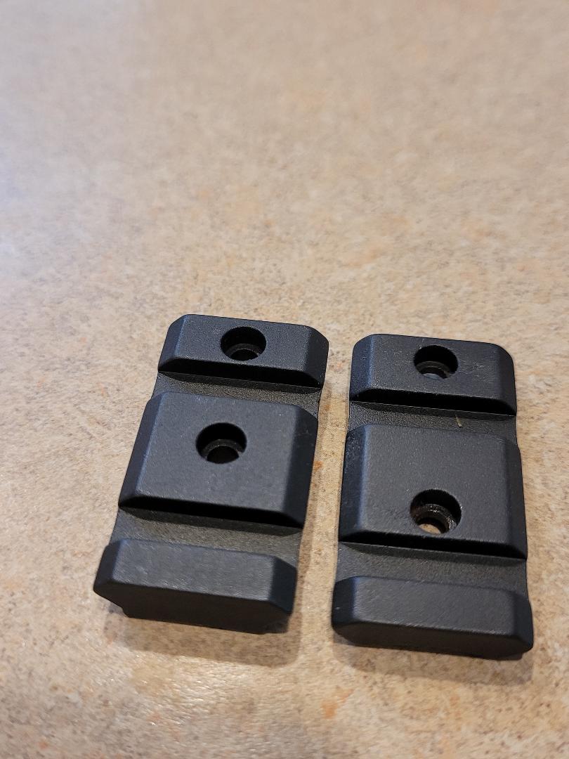

That picture got me thinking, and it looks like the gunbroker seller has a pair of front bases listed, not a front and rear. Hole spacing should be different between the two, and in the picture they aren’t.
@lockedandloaded Leupold #61983 is discontinued, do you know if #59230 is the replacement? They look identical, but not sure if you knew of certain.

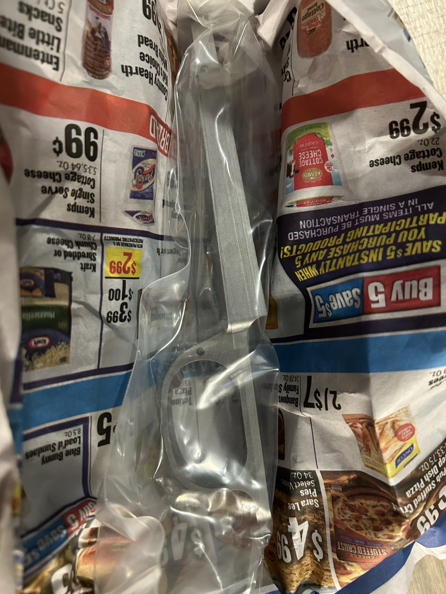

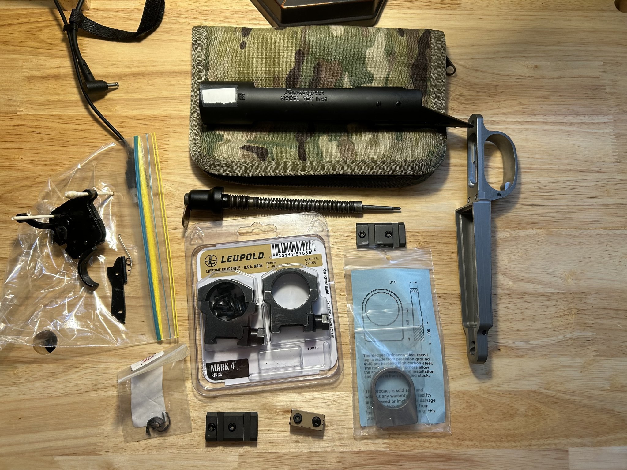

Look at what the nice people at Sunnyhill shipped me….
With that said, 2 questions.
1. Does anyone have the dimensions for the RPA front sight mounting block (How far should it sit compared to the end of the barrel?) I see the dimensions in the thread but are the redfields mounted the same as the RPA? Do you think any decent smith can mount it or do I need a specialist?
2. How close are the PRI made rails to Remington MARs rails? They look extremely similar, but winder if they are functional.

I talked with Badger Ordinance about them when I was starting to collect parts for an A2 build. BO told me that the PRI mounts are about an 80% copy of their design.

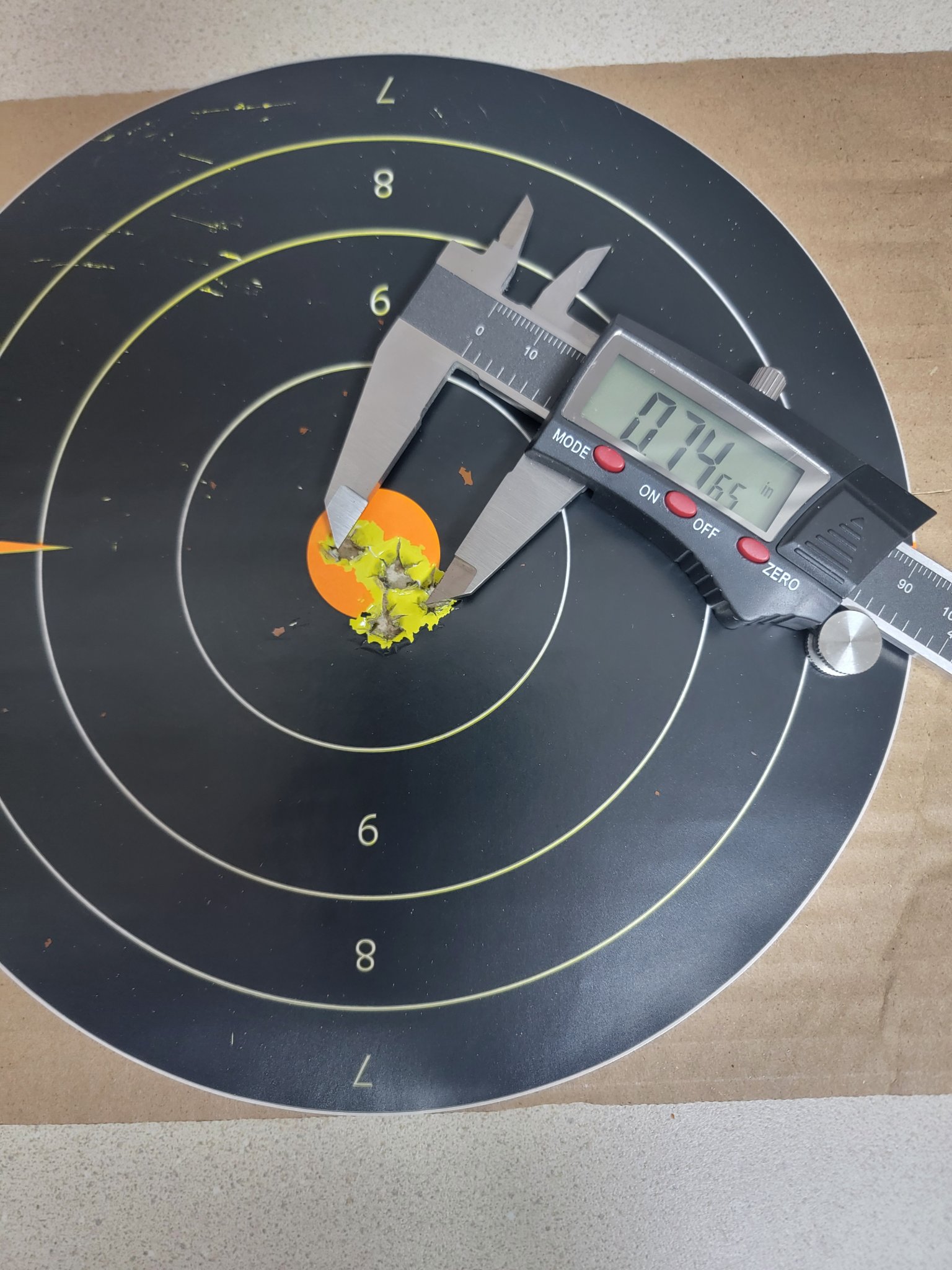

Does anyone shoot hand loads out of an M24 or do the rifles like factory loads only? I ask because I tried to shoot a hand load this weekend, and I couldn’t get the bolt locked in the whole way.
You probably need to bump the case shoulder back. Do it a little at a time so that it just fits nice. I primarily shoot handloads from mine and I have it down to less than .4 MOA at 800m and about .4-.5 MOA out to 1000m.
Ya as mentioned above, what's the condition of the brass you are using, new, previously fired in something else, etc. I found the throat in my rifle fairly long, so I was taking advantage of the long action and loading the bullets longer than a typical short action 308.
Reactions: lockedandloaded
@1968 The case measured length was 2.001, and the final overall length was 2.786. I’m using Barnes 168gr TTSX BT (Because they were on sale and my LGS was out of SMK).
@eodsix How much to a time? As I said in another thread, this is my first foray into match ammo reloading.
@mjh30 the brass is once fired FGGM.
Well the dies I use are Redding match Neck Only resizing dies. Do a little reading about Neck Sizing dies and the bushings they use which are a separate purchase from the dies. There are some videos, (DVDs) that can walk you through the whole process of match reloading. I can't remember at present whether mine is a Redding or Sierra DVD but it taught me just about everything I needed to know. Most of the equipment and tools I use are the same as those on the Army Marksmanship Unit reloading bench. Usually you buy 3 bushings to bracket the size you settle on which will change over time as the case neck wears. Once you have your shoulders bumped back so the bolt will close, and you fire the reload, the case is fire formed to the chamber. It will take very little sizing for future loads so long as you only use that brass for that rifle. There is a very minor difference in the chambers of my M24 and my M24A2 so I can get away with shooting those rounds in both rifles. I cannot use brass from my M110 or M14 without going through the sizing process we've been discussing.

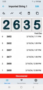

Just started using the newest Sierra 169gr SMK. Anyone have a pet powder charge they use it with in an M-24?
Well my loads are both using the Sierra 175gr SMK; 43.9gr of RL15 for a M118LR load and 43.0gr of IMR 4064 for a Mk316 load. Reloader 15 is a close facsimile to the blended powder in M118LR but IMR 4064 is actually spec for Mk316. Both loads are improved performance in my rifles than their Lake City equivalents. I strive for 2,650 FPS. Your mileage may vary, as mine does from lot to lot of powder.
Im having trouble obtaining certain powders, and when I do, they cost over $100/pd with haz, s/h, tax, etc. So currently using Varget/43.0gr which gets me to 4635fps while still fire forming the lot of M852 brass. Problem is its a compressed load that Im not totally pleased with.
