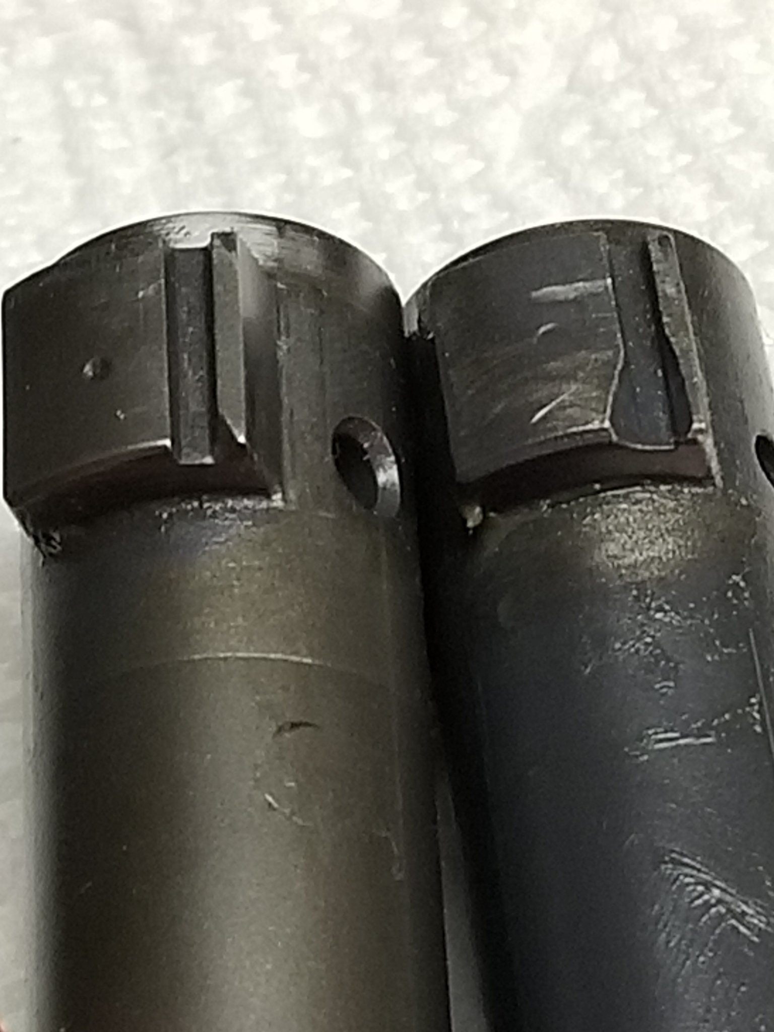

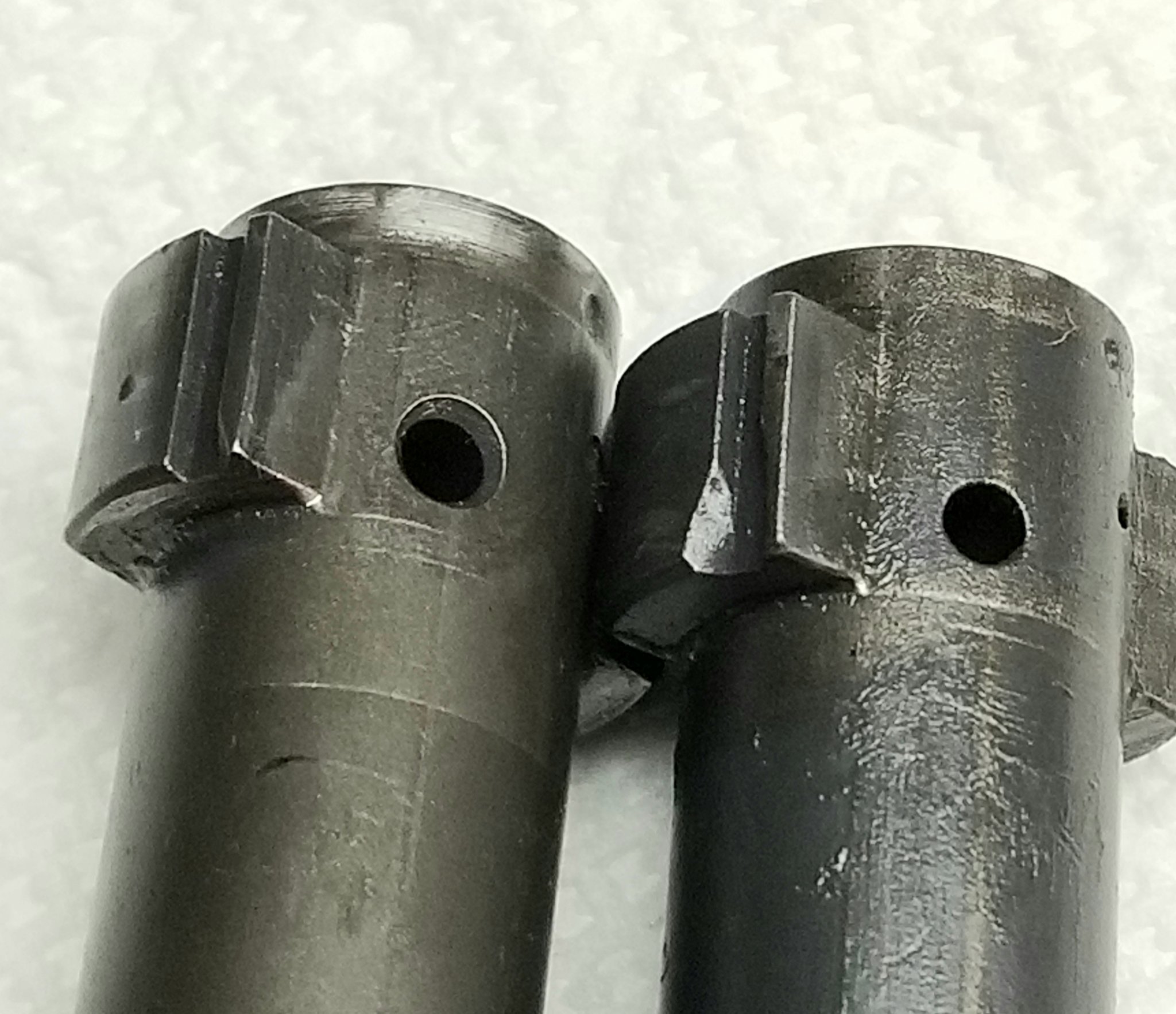

Left bolt is Remington Defense M24
Right bolt is EuroOptic ASA M24
What is the reason Remington widened the EuroOptic lug rail channel?
What is the reason Remington used a smaller diameter & non-chamfered gas escape port on the EuroOptic bolt?
Both receiver gas ports are the same diameter

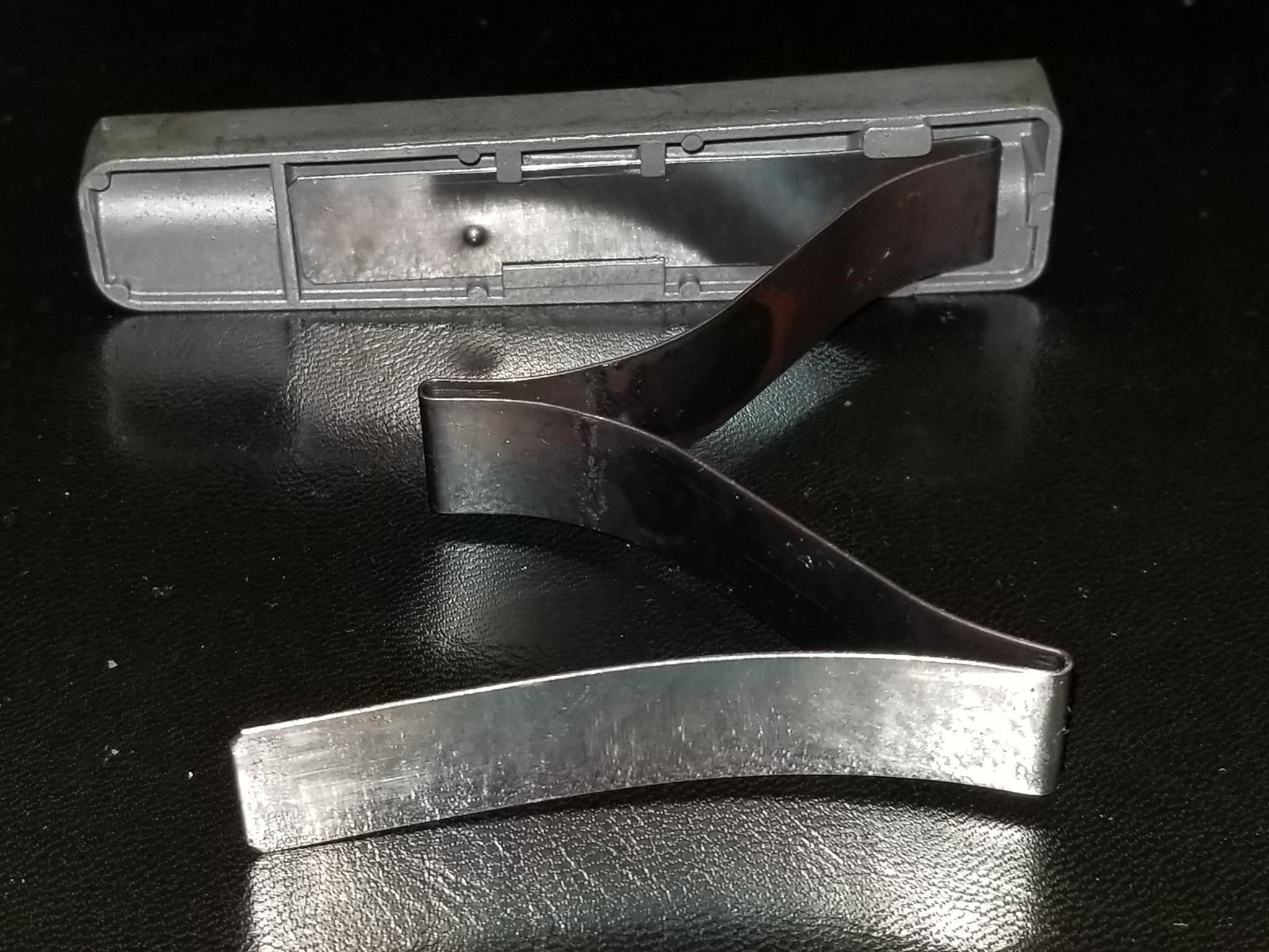

The factory OM describes how to install the mag follower spring after identifying the longer leg by compressing it. But it does not mention the tactile dimple stamped onto that leg.

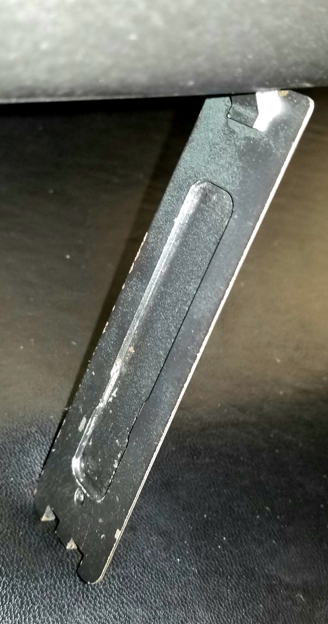

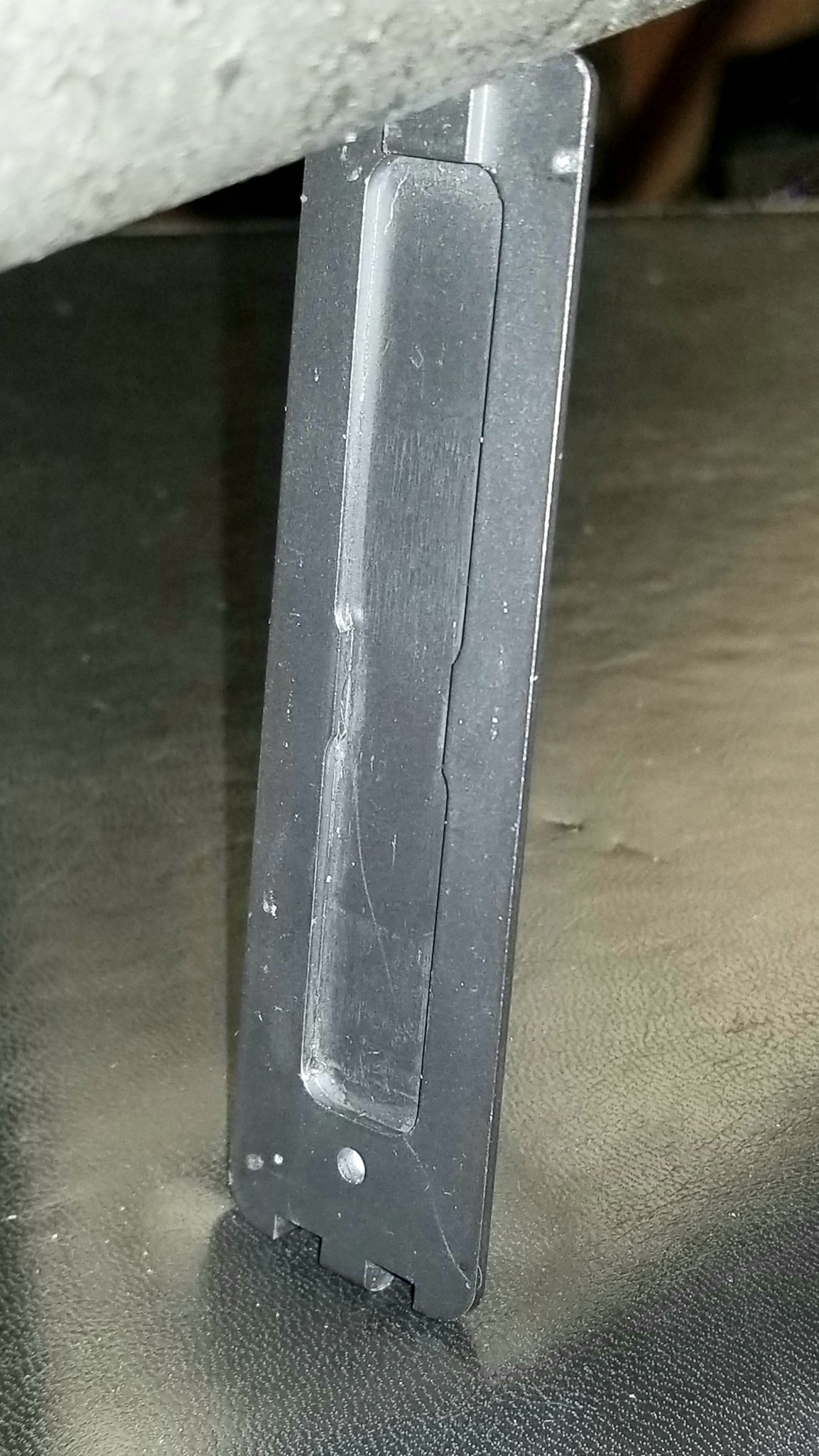

There is also a difference between the floorplates of the 2 contractors who built them. The 2-piece bottom metal variant has an elongated floorplate spring channel on the EuroOptic ASA M24 on the right side picture below. This allows the spring to seat farther forward. Not sure if that was the intended purpose. I cant feel any difference in pressure between the two. Both are still a bitch to load

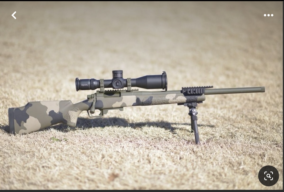

Not sure if this is the place to post something like this but I am trying to identify two parts on this rifle. First the stock and secondly the bridge. I have a Remington 700 SPS Tactical Heavy barrel 308 that I would like to rig out similar to this rifle. Any help would be appreciated.

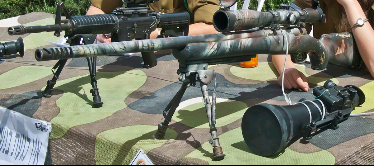

IDF 933 Nahal Brigade M24 in service

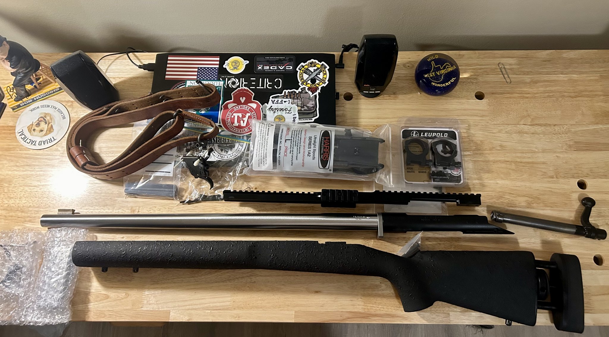

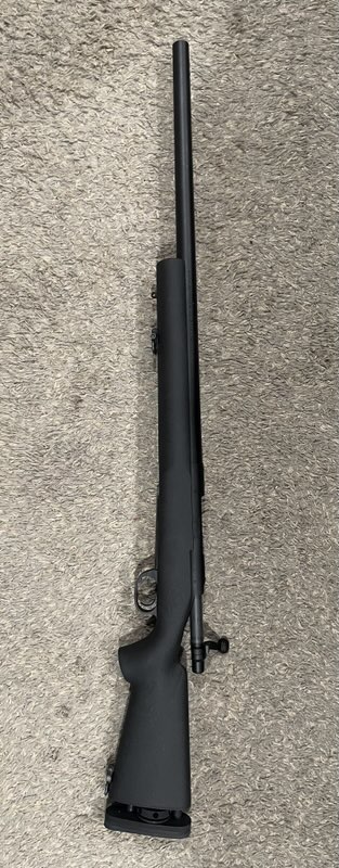

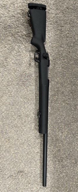

So freaking close… Stock came in, of course textured and has that fat buttpad… is it hard to get a more correct looking pad ground to shape? But right otherwise.
Need to open the lug pocket up to fit the oversized lug (badger ordinance m40a3, fatter but the same height thankfully)… floor plate is at the cerakoters.
Looks good! You can easily sand off that webbing and just paint it flat black.

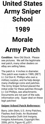

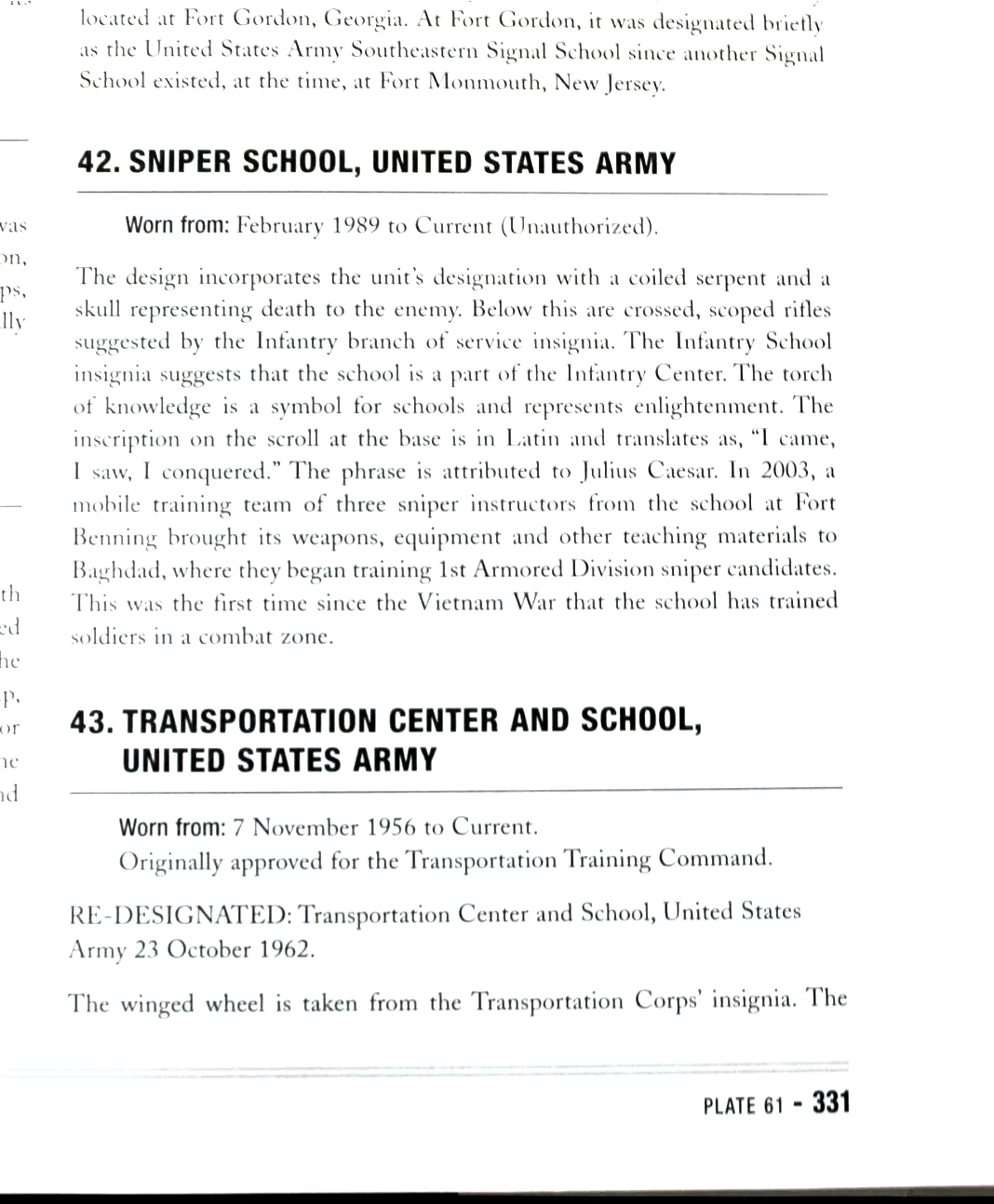

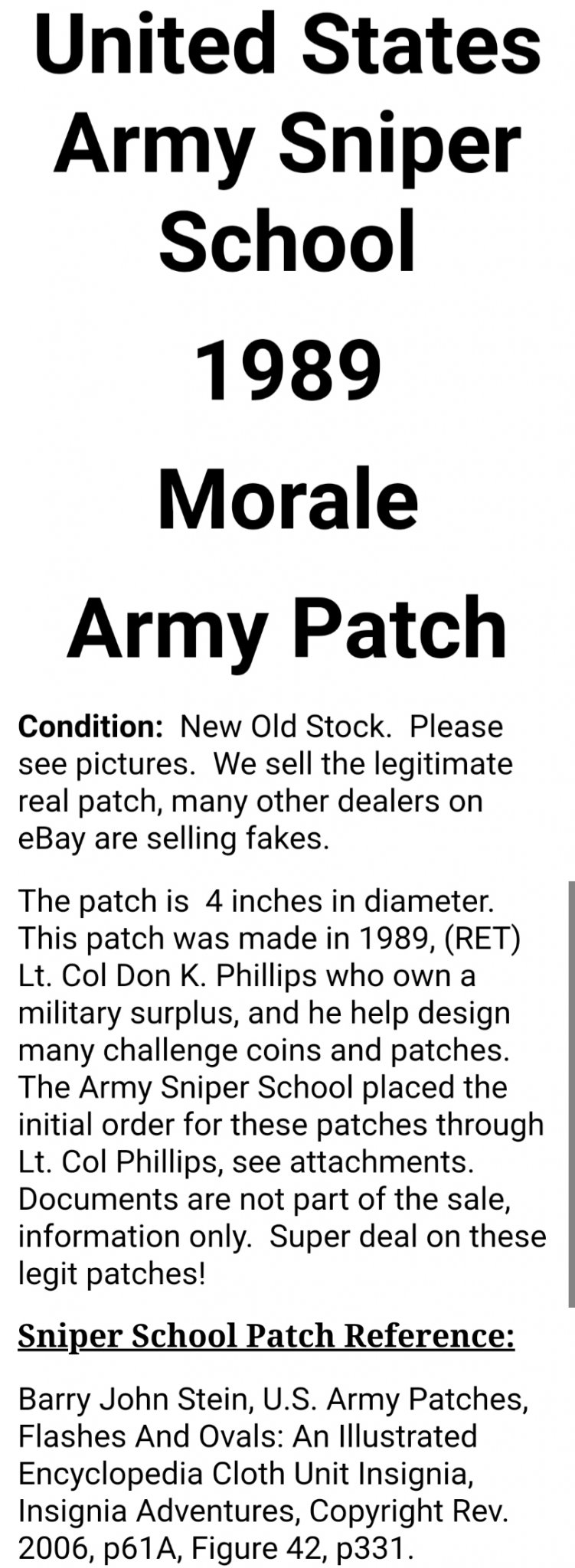

December 1988 U.S. Army Sniper School patch. This is an original (unofficial) issued moral patch being offered on eBay. The seller provides documentation on the history behind it. There are multiple clones available, but not the correct size or pattern, some even having period incorrect velcro. The original is shown with a ruler. Class of '88 had a lower number of passing students, 7 total graduates instead of normally 20, and that is why so many original unissued patches remain. This was early M24 era. Interesting that the Harris bipod is mounted backwards.
Im thinking about it. I have a can of flat black alumahyde I might dump on it.
You won’t notice the difference. The flat black even shines up with hand oils the way the normal HS precision coating does. If you do sand it though make sure you sand with a sanding block or other hard surface backing the sandpaper. That will keep it from flexing and only hit the high spots.

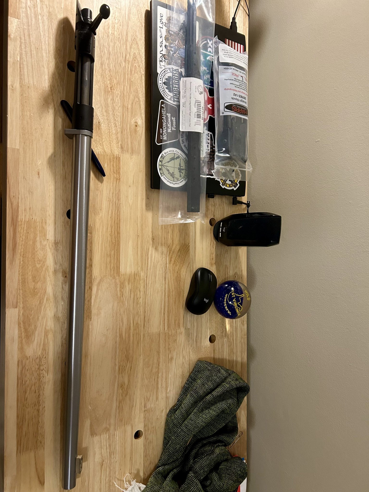

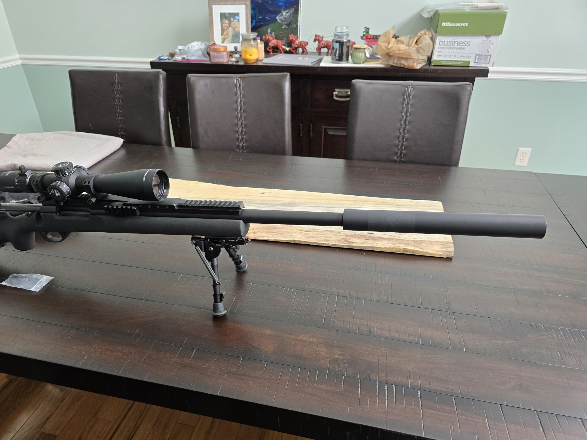

Mostly done. Using a PRI Rail as a stand in until I get the stash rebuild to get a MARS or MIRS rail. I did notice that the PRI rail does make contact where the side rails are. Is this normal? I emailed PRI this afternoon, but curious if anyone knows...
Reactions: kft101

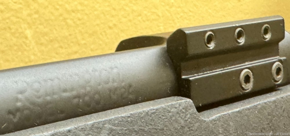

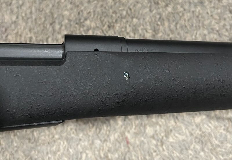

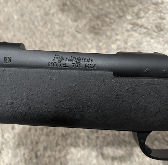

I realize I'm late to the party on easily getting an M24. I had a couple of questions for anyone that can help. First is regarding the receiver markings. I came across a rifle with shallow receiver markings that don't look like the clean receiver markings I remember from the M24 (attached photo). It's the best photo I have at the moment, but is that something to look into further if I want to buy this gun?
Second, typical newcomer question, what is the best and/or easiest way to get ahold of an M24? Money isn't an issue as long as it is a fair price. Should I post and hunt around for an older Remington release or just order through GAP?
That one looks like it just has extra thick coating over the old stamped markings.
Does GAP use m24 receivers? If not, I wouldn’t bother. Keep an eye out here and GB for one of the newer ASA m24s
Reactions: tostado22
That “M24” has some weird carbon barrel on it. Is that the one JFE USA is selling? I’d probably avoid that one.
Yeah I did some searching online and thought it sounded like BS. But the markings were odd as well.
I'm looking into an RR prefix M24 marked gun that is supposedly a police trade-in. Appears to be in great shape, but it doesn't have the iron sight bases. Looking into the RR prefix and police ones now
EDIT: as far as I can tell, RR prefixes were part of law enforcement sales as well as the reissue or commercial sale programs? This one I'm looking at is in very good shape with correct receiver markings and I believe all of the proof marks as well.
Looks like a legit Remington Defense or Remington Law Enforcement release. Double check it has their 5R 11.25" twist rate barrel, and you're gtg. One minor detail is the buttpad is the heavier commercial version of the HS Precision stock, so its probably stamped with "HS Precision" versus the "Remington" logo, but that wouldnt be a deal breaker to me. Let us know what you decide
