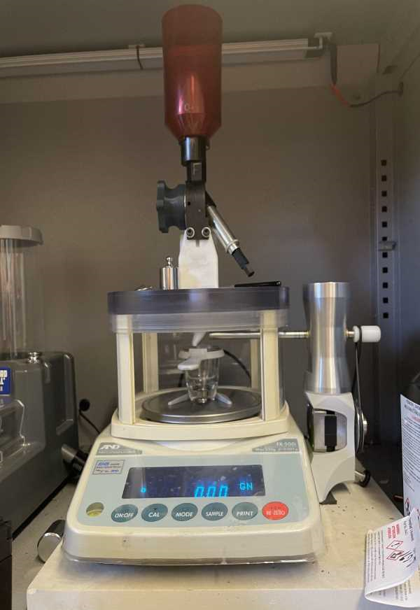

I know 2 guys up north here that use a Lee perfect powder measure to manually dump most of the charge. Then they use the trickler to achieve the target. One fellow mounted the Lee above on a shelf with a clear tube down to the top cover. He has 3D printed a funnel that the hose attaches to.
EDIT: sorry, it‘s an RCBS unit. Here’s a picture...

Here's another option to the hose etc.. I mounted a Lee measure permanently. I uploaded the files to Thingyverse if you want to print it. It works really well, there was a bit of work on the funnel to get it to drop so the powder didn't bounce out of the cup but it's spot-on now. There's also a knob for the thrower and a spacer to use with a thinner lid.
https://www.thingiverse.com/thing:4762745
